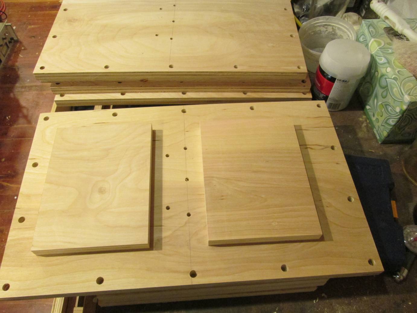

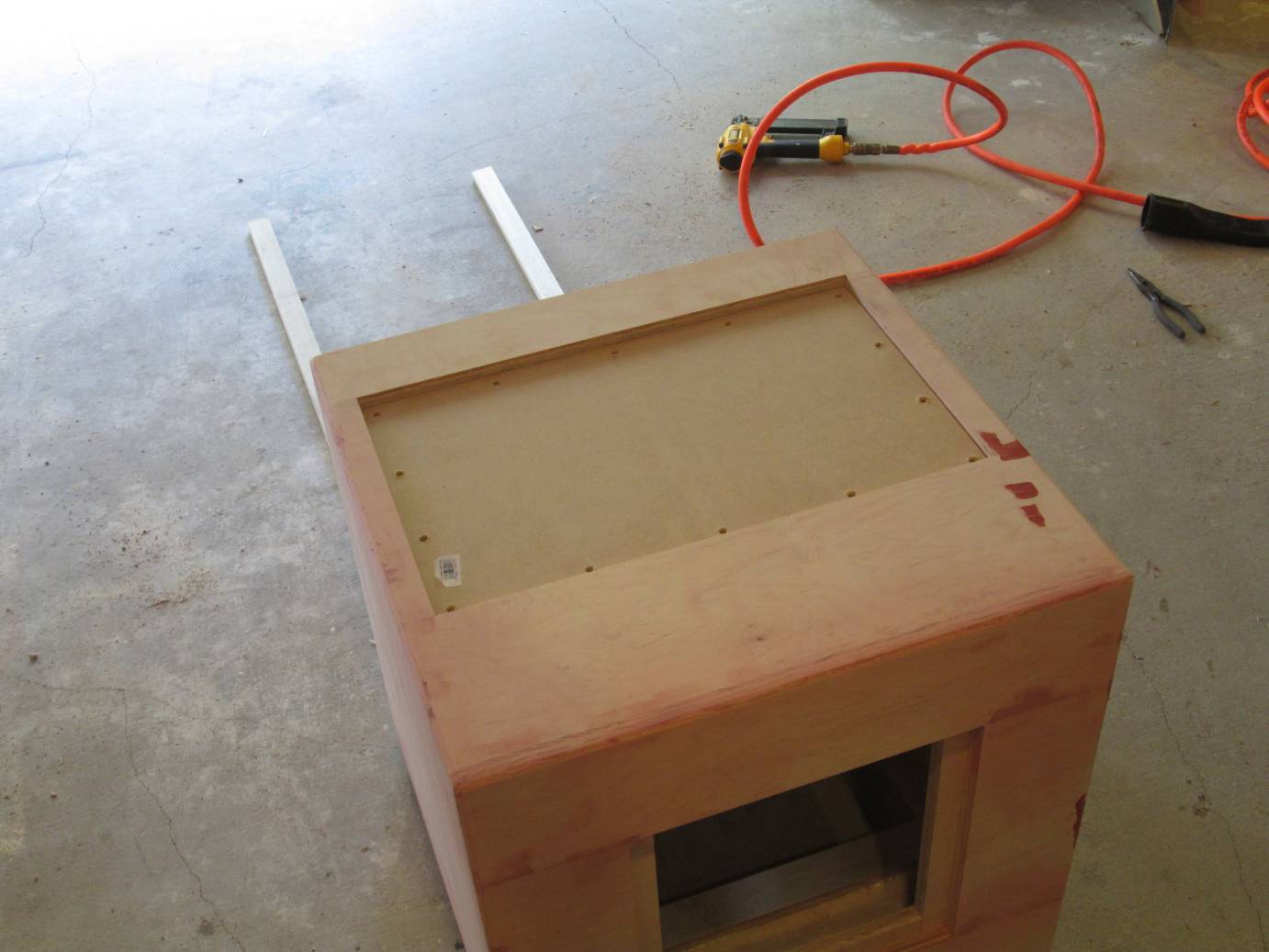

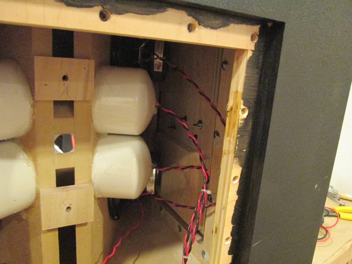

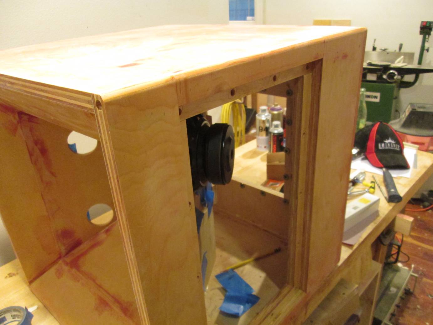

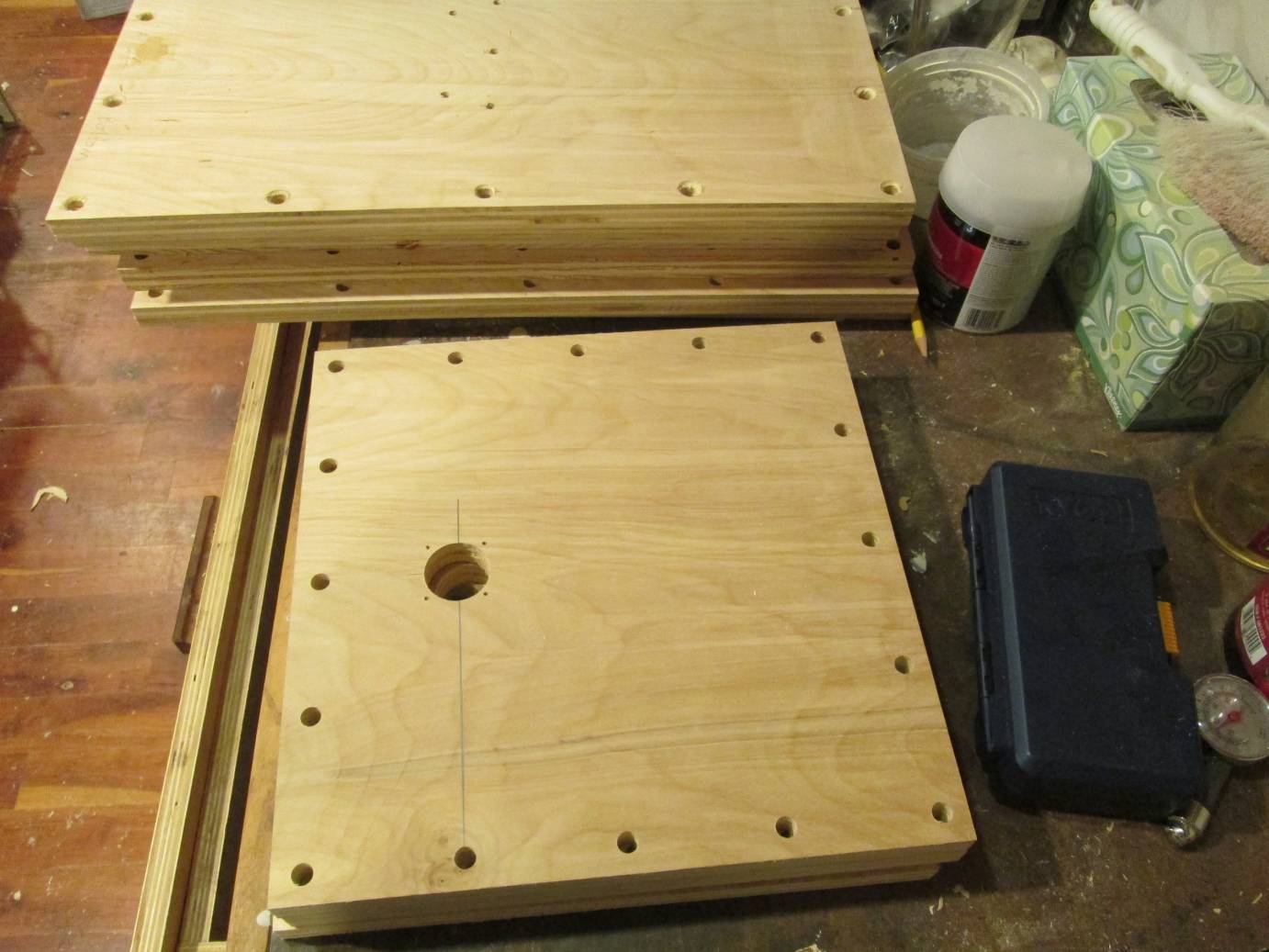

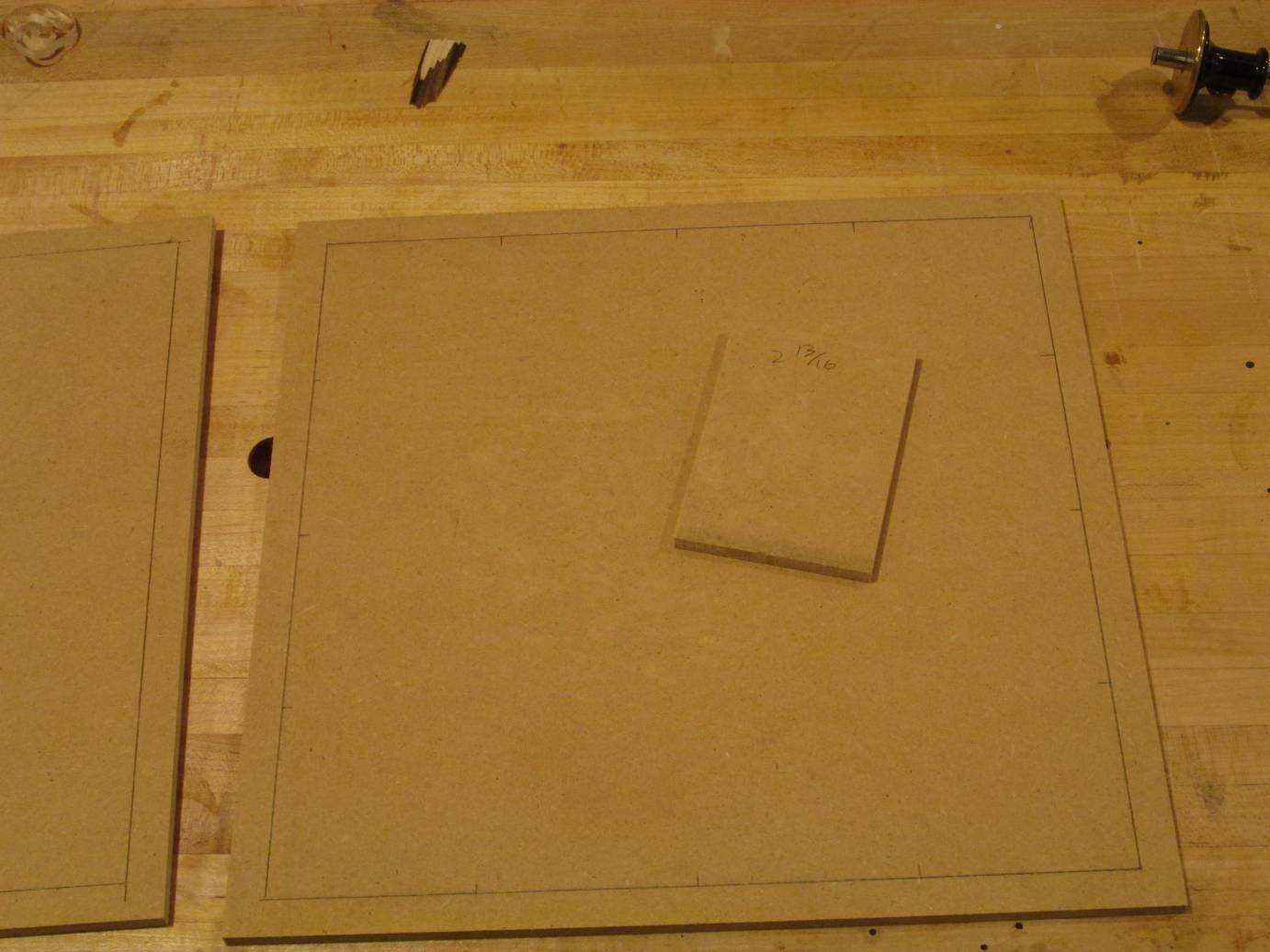

Sorry for the long pause..work and life got very busy. Here's a bunch more construction photos.....

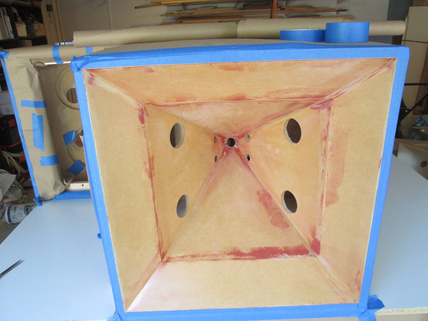

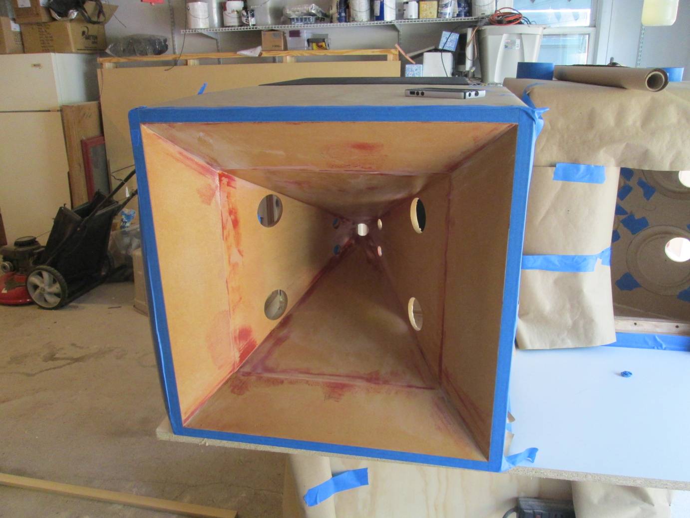

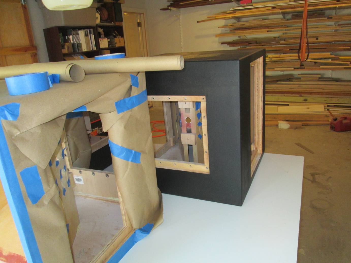

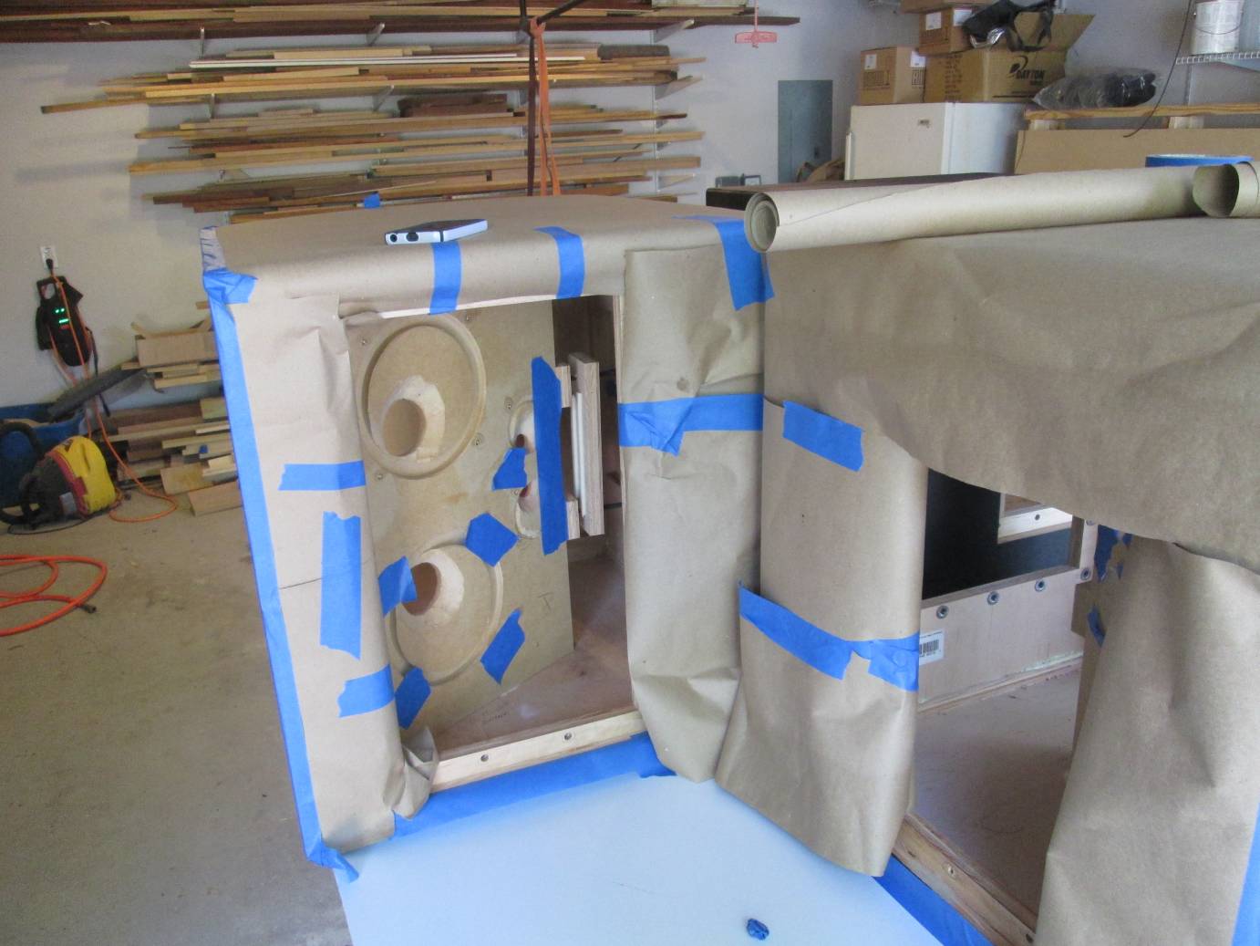

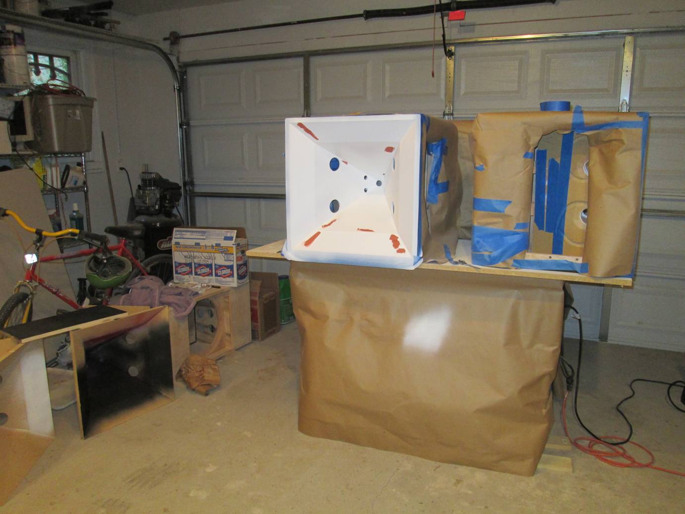

One thing that might be asked is my finishing schedule. I'm a fan of the following:
1. Seal multiple spray coats of de-waxed shellac. I use a $15 Harbor Freight gun for most spraying jobs. I've owned fancier guns...and they do a better job. Not 20X better. I use automotive glazing compound to cover any scratches or rubs. (That's the pink stuff.)
2. Sand, down to ~300 grit...do not skip grits...do not rush...go slow. It will go faster in the long run.
3. Seal one more very light coat.
4. Build coats of finish with the recommended adhere coat...this will also expose any spots you missed in 1 and 2 for glazing and sanding.
5. Start with glazing and go to 2 again...repeat until you're happy.
I love Target Coatings products....they always work very well. The horns are as follows:
De-Waxed Shellac.
Glazing
De-Waxed Shellac (alcohol based).
Target Shellac as a bond coat (water based)
Target White Lacquer (roughly 3 coats...more glazing, sealer of Target water based shellac and 10 more coats of lacquer)
Yes...there are 14 (ish) coats of lacquer on the horns, and with the water based stuff it only took a long weekend.
And yes I used the $15 Harbor Freight HVLP gun, and I didn't build a booth.
De-Waxed Shellac.
Glazing

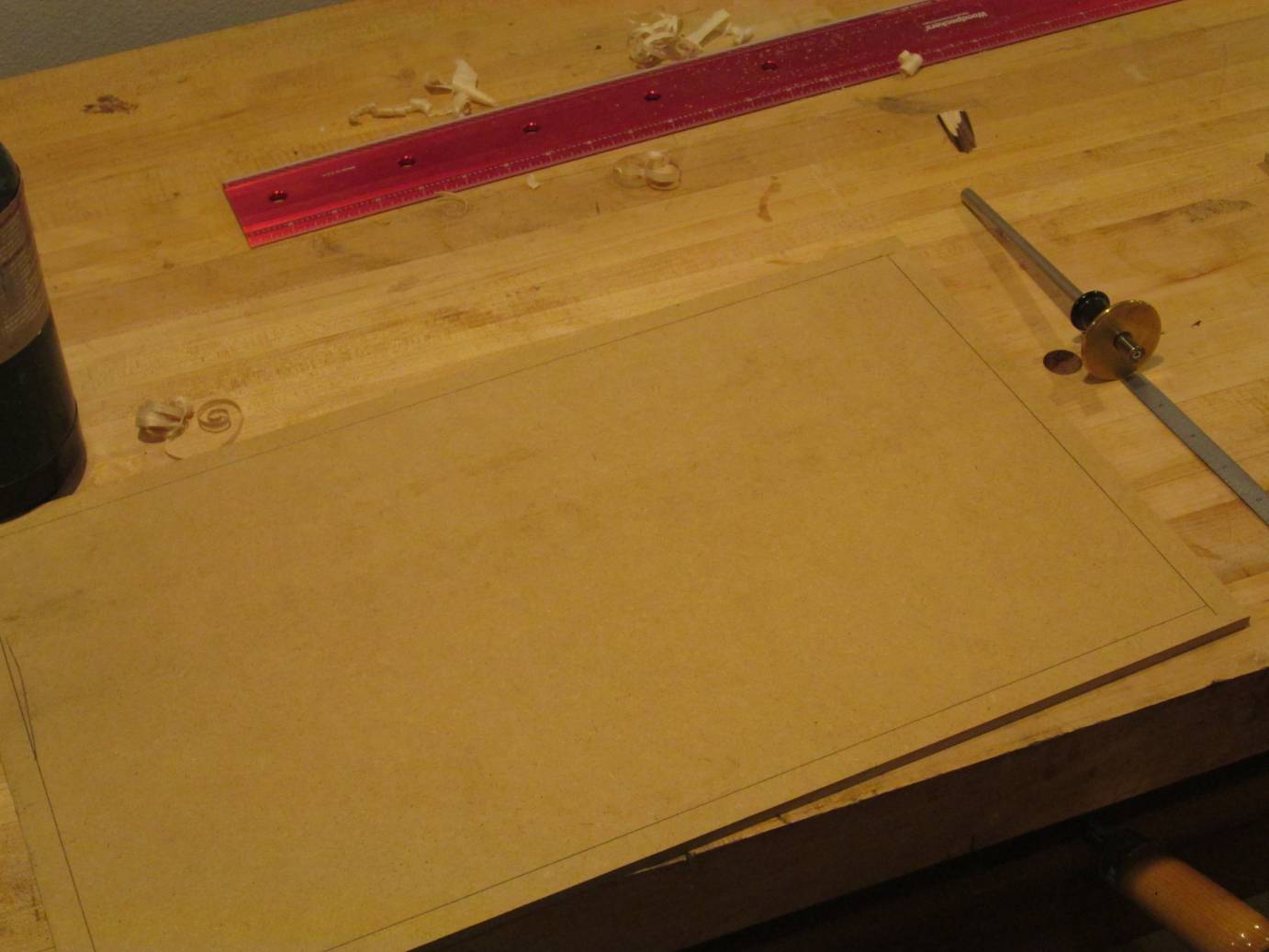

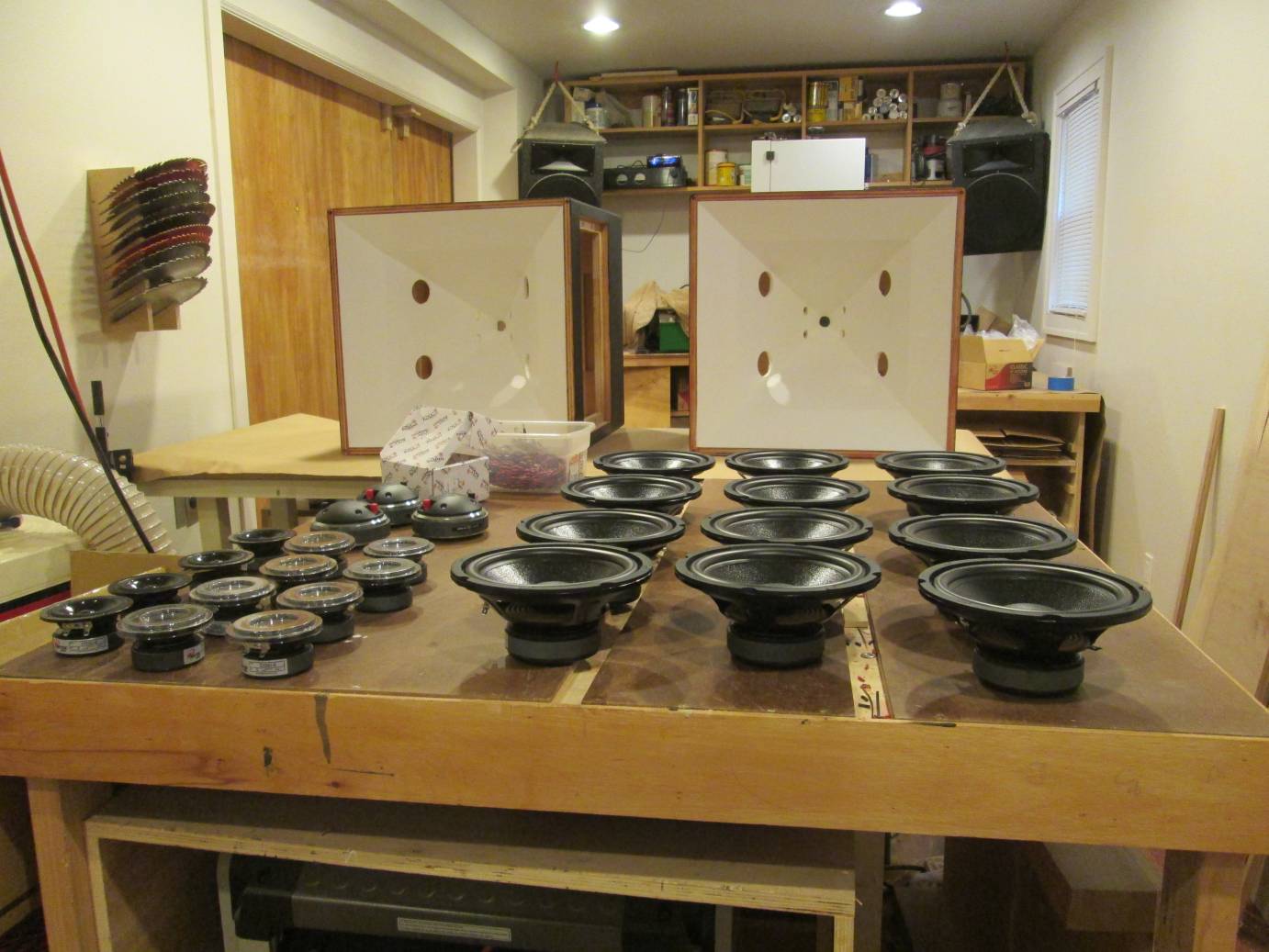

Looks great! That is an insane number of drivers there on the table! 😀
You have some painted white and some painted black, are there two sets?

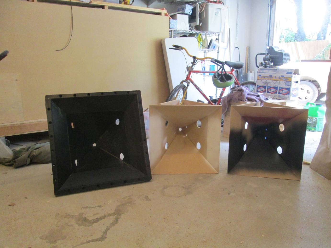

I included a picture of some of my prototype horn lenses. The big black one had no chance with my wife...the other two either had midrange port issues or spacing issues.

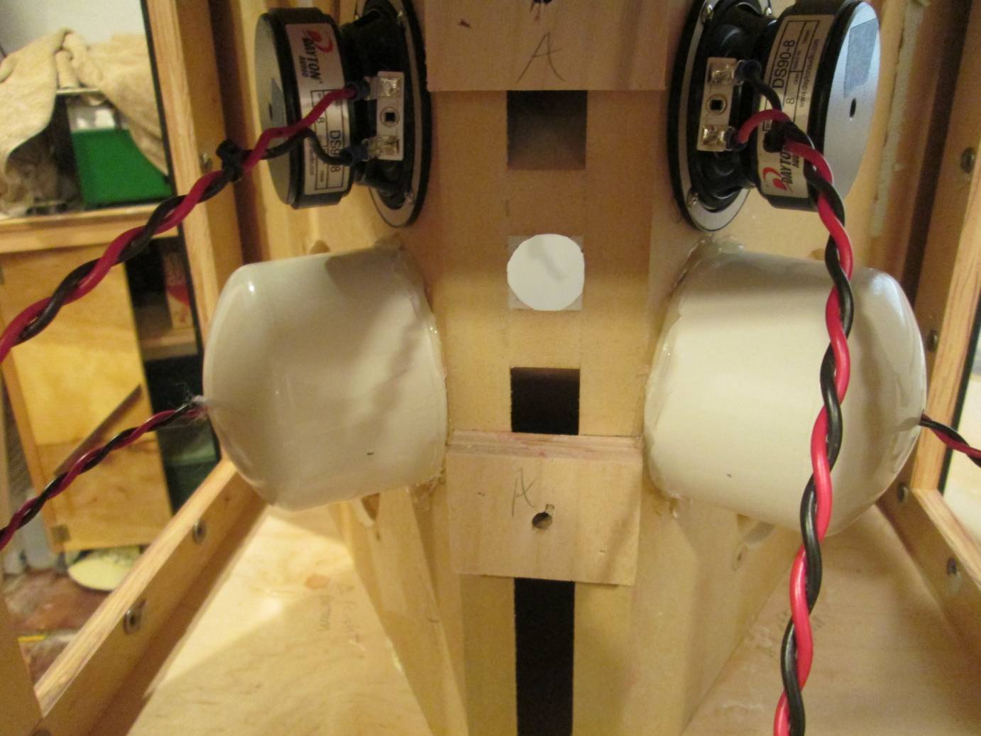

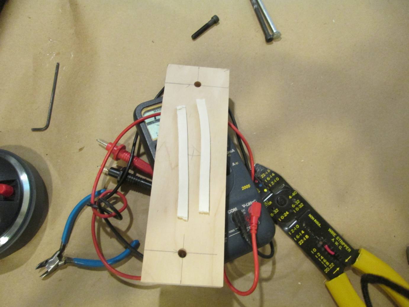

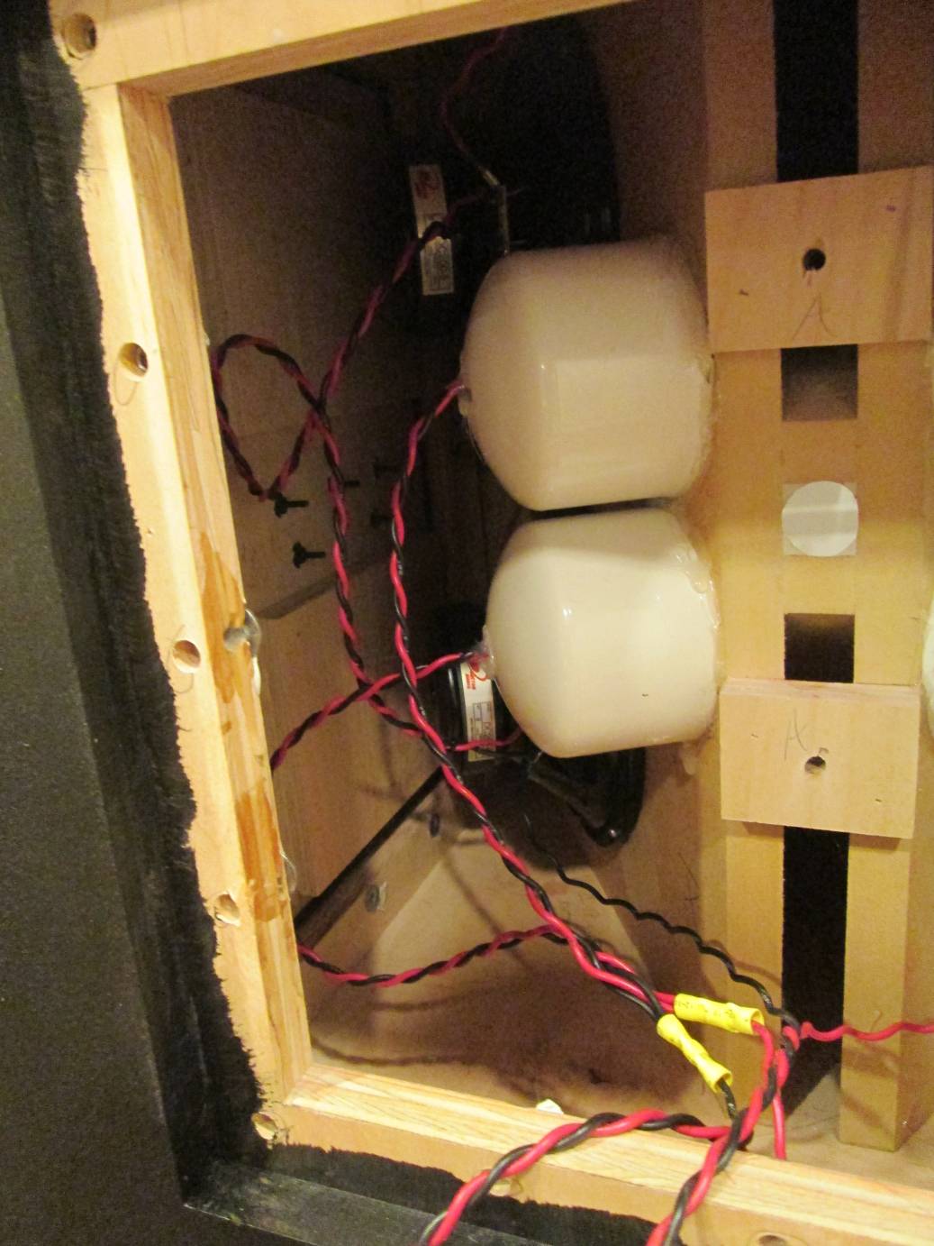

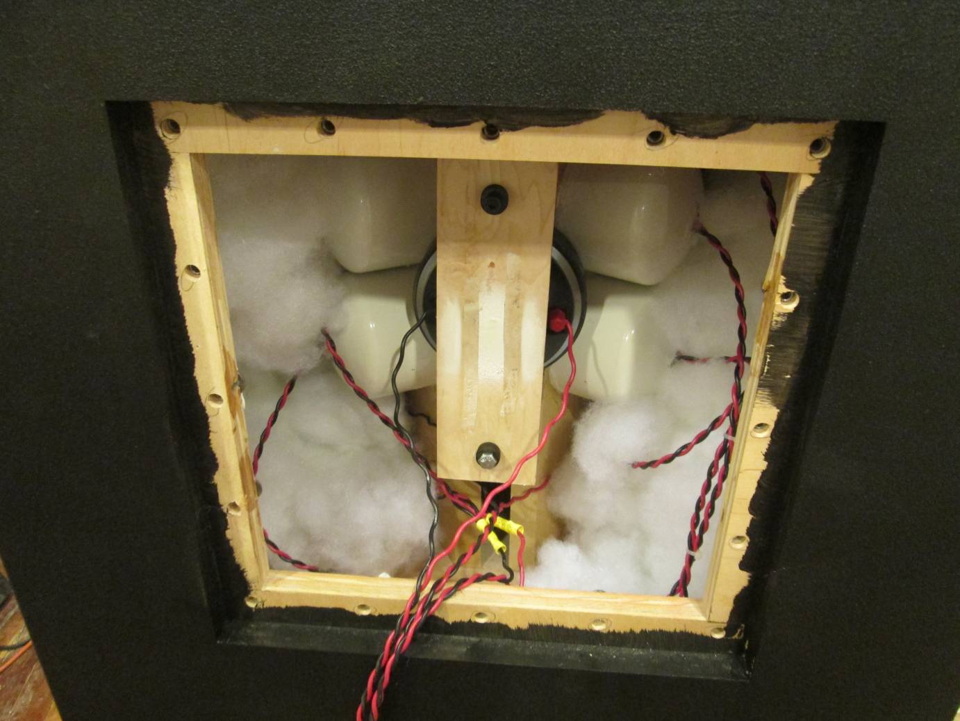

Next up is the midrange cup. I had to dremel out the inside lip of a 3" PVC endcap...but otherwise they work very well. They are hot glued to the horn. Be patient...it takes a while for the glue to cool enough to hold them on. Once completely cool...it's actually hard to get them off. They can be removed by slow careful cutting with a utility knife...for driver replacement.
Note that the wires come through the end of the end cap and all surfaces are sealed.

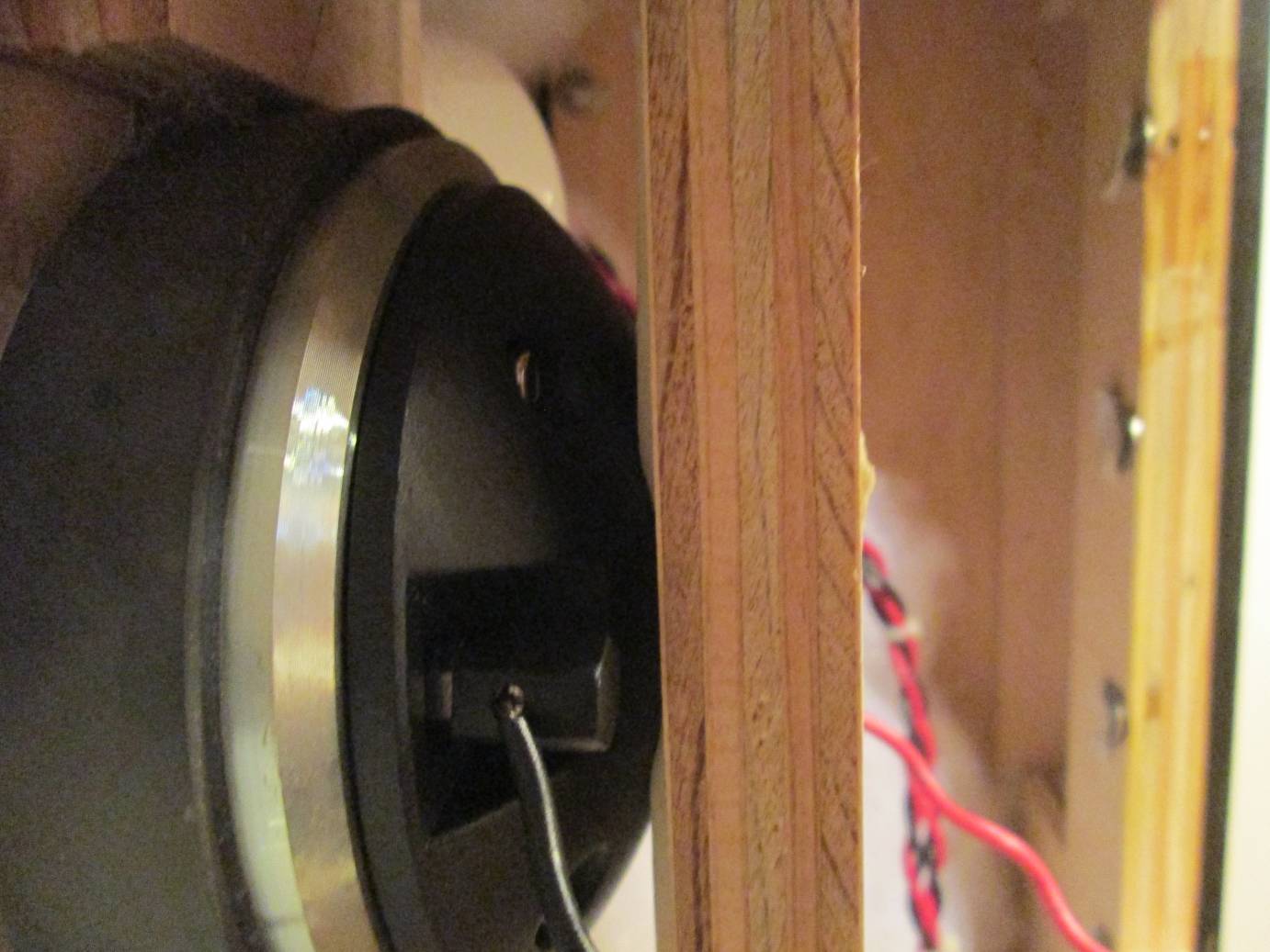

Also note that the compression driver is held in place by the compression action of a board with two strips of foam. Holds in in place easily...and well. Probably not suitable for something that's needed for touring...but for carrying up my stairs...just fine.
The outside finish is Duratex....love it.

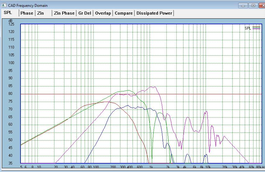

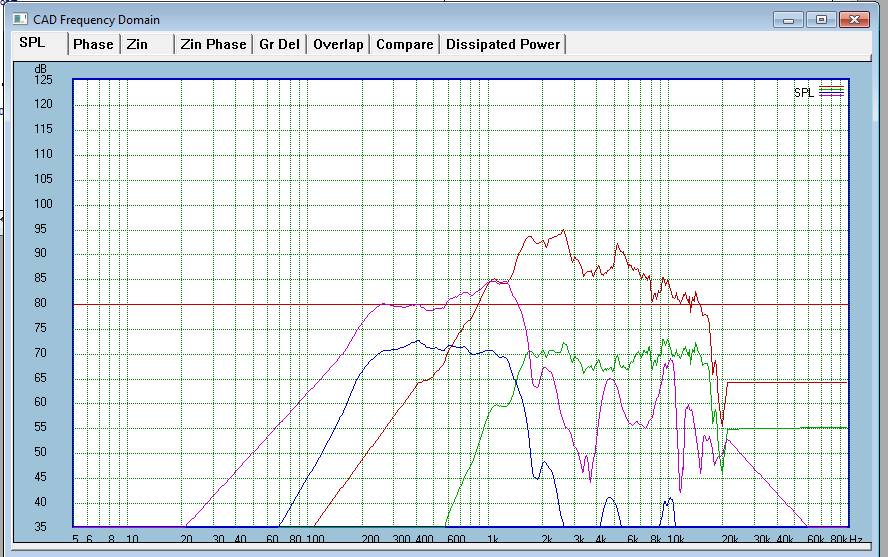

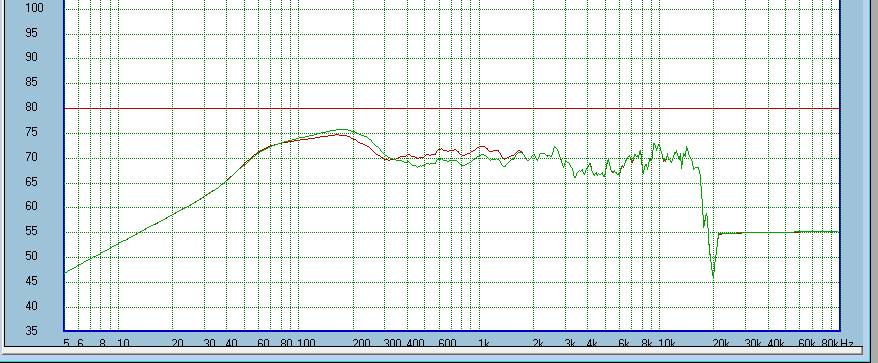

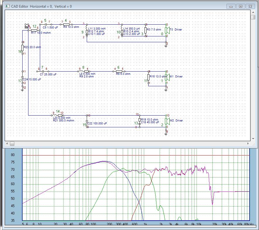

Last...for now is the crossover.
I have two version...A and B....A uses 9mH in series with the woofer and 40 Ohms in parallel with the mid. B uses 8 mH in series with the woofer and 13 Ohms in parallel with the mid. The difference is a bit more midbass and less midrange. I found the A version a bit too analytic ...but I left it as the center channel for the home theater. Made voices absolutely intelligible in HT usage...even if the rest of the track is busy and rubbish.
The comparison plot shows A vs. B....A has a bit more output in the midrange and less in the bass.
I think I've explained before that SoundEasy should be called Sound "Really kind of difficult, but with a enough work will get the job done, though you'll practice cursing a lot" I don't buy the measurements below about 200 Hz for the woofer...so I'm running a bit blind. I'll re-take and see what's actually happening and refine the crossovers as needed. These aren't the last crossovers....for sure. Plenty of optimization for measured time domain and frequency domain performance
Very nice work on the crossovers and measurements! The bass measurements look good, why do you say you don't trust them? Do they not match the predicted response? Are you using a sealed bass alignment or is it vented?

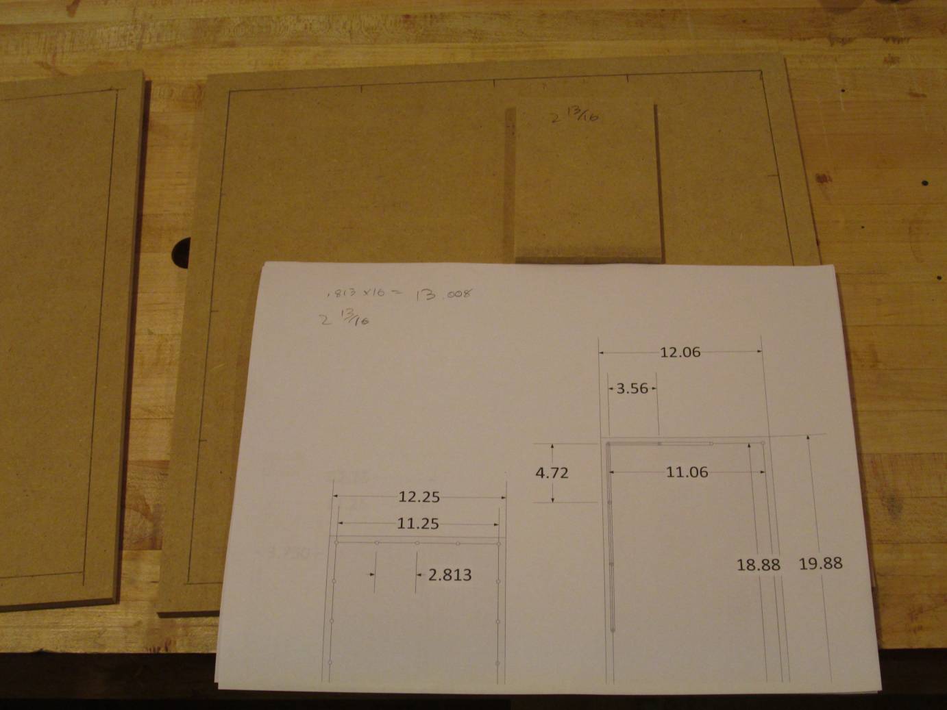

I see the dimensions for the holes for the ports going into the horn, but how much depth do you dremel away for each? Put another way, what is the depth of each hole fpr the ports at the specified diameter, and how much of the depth was dremeled to a wider diameter?

Every driver had some shaping. Including the woofer...as I've said before...the data from the band hall was much better. It clearly showed the rise for the horn loading and the natural rolloff...the data in the plots attached is probably only valid from ~250-300Hz up.

I don't have good dimensions...I dremeled them out as much as the dremel would allow without going to extreme lengths. I had about 1/8" material left in the port holes. The pictures are the best way.... I'll look through the pictures I have to see if there are any close ups.
