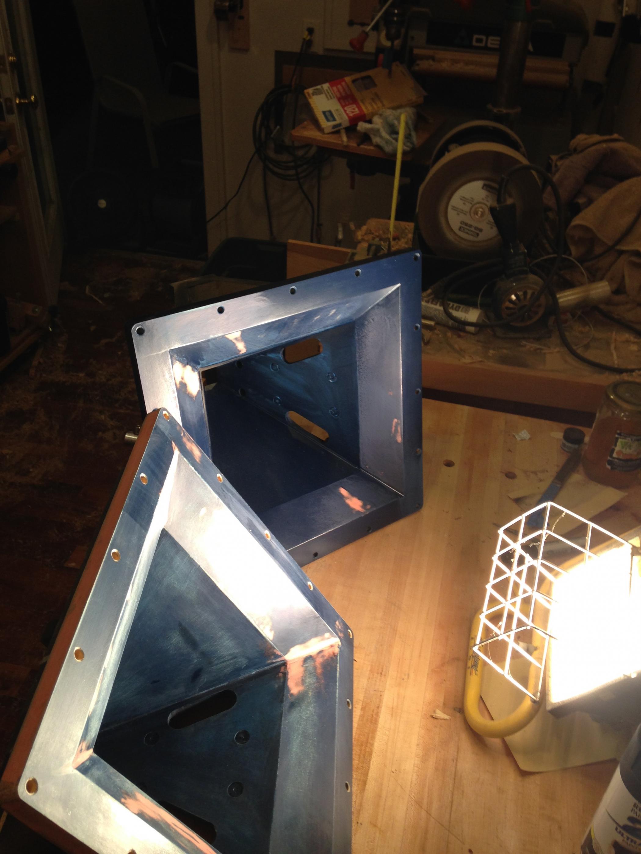

Can we see photos and data of your 16in Synergy? That's a nice size.
I found these two...I know I have a bunch more....
Scott

What drivers are in the complement? How low could you get with those woofers? Look like 5.25inchers?
Those are awesome! Like xrk asked: which drivers did you use? I did a small 2-way synergy with the B&C DE250 and Faital Pro 8FE200/8, but they're still bigger than 16". Neat design!
Woofer is the Vifa TC14SG49-08 (a 5.5") driver.
Midrange is the 2" Gento buyout using a PVC cap for a sub-enclosure.
Tweeter is the PRV D290...but that's because I had it. I could have used a much less beefy driver.
Scott

You can even make a synergy horn with one mid and two bass units, it's what's in my most recent build, and works great. It's a 4"D mid, so the same piston area as the 4x 2"D mids I used on my big synergys. I personally think that reducing the number of ports into the horn down to only what is needed for the SPLS is the best way to go anyway, I'm not playing these in a gymnasium and holes in horn walls may be tolerable for the tweeter, but they certainly aren't an advantage for it.
