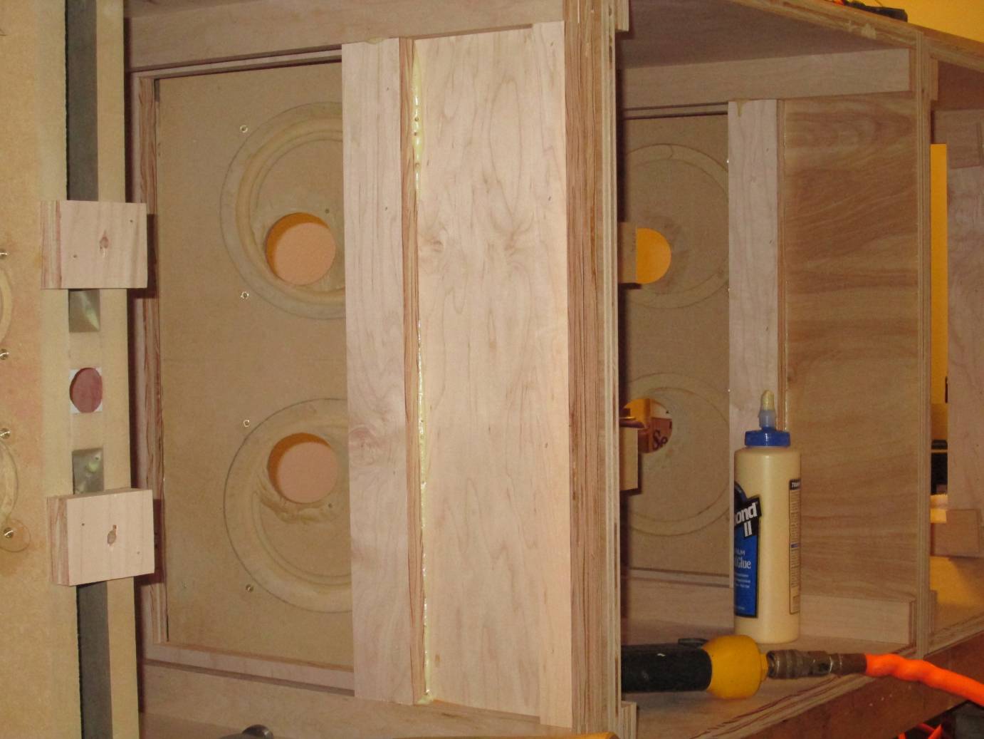

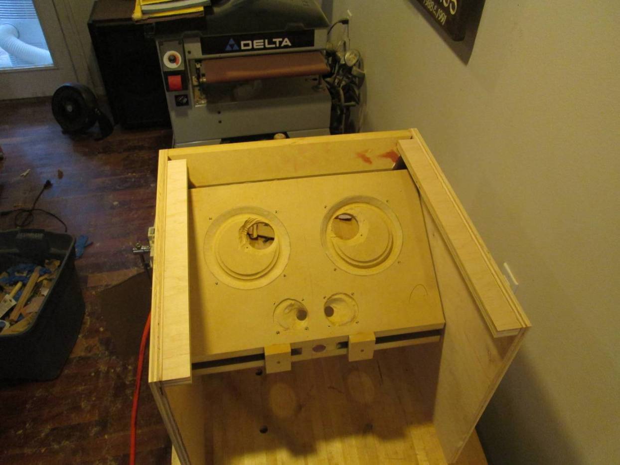

90 deg Synergy 2 way in foam core.
http://www.diyaudio.com/forums/full-range/223313-foam-core-board-speaker-enclosures-200.html#post3698230
Looks like uploads are working again...

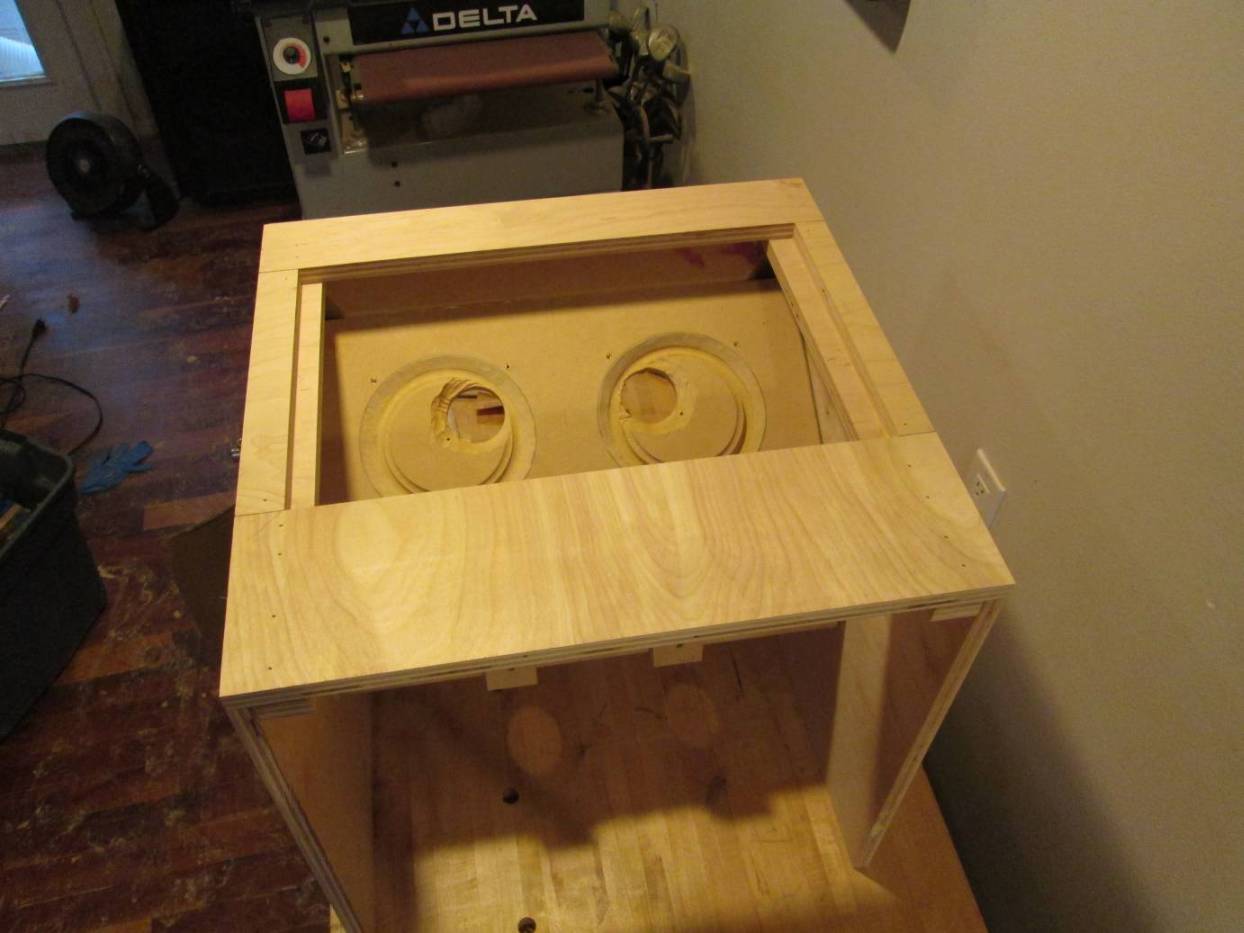

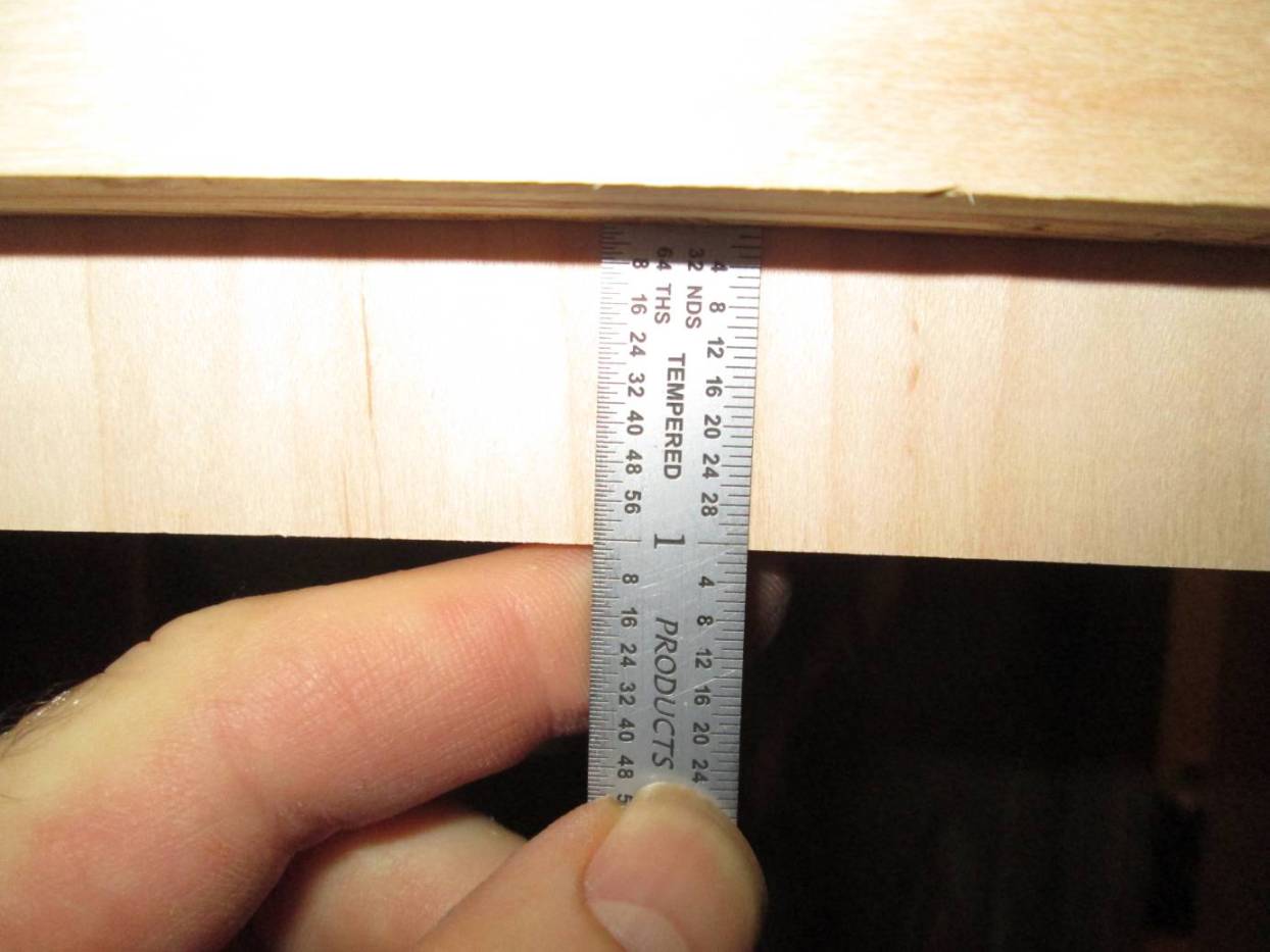

Note that I have a 1" overlap for my access panels. This gives me plenty of area for sealing and putting 1/4-20 bolts for attaching the access panel sot the openings.

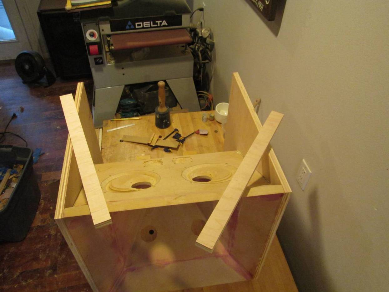

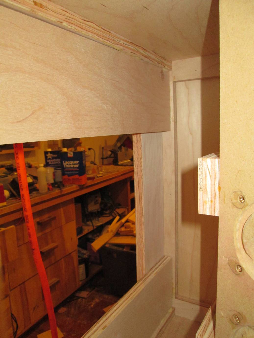

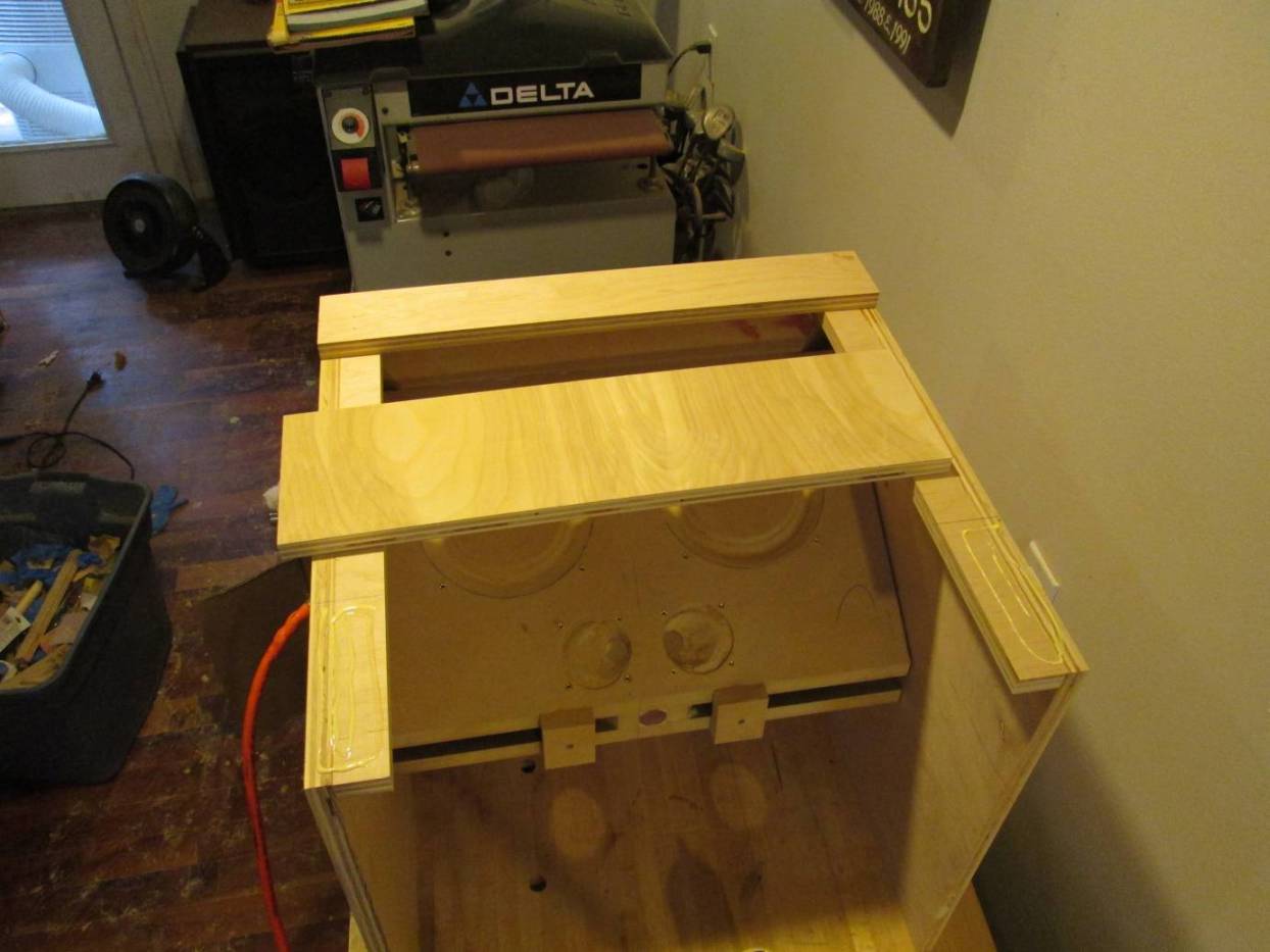

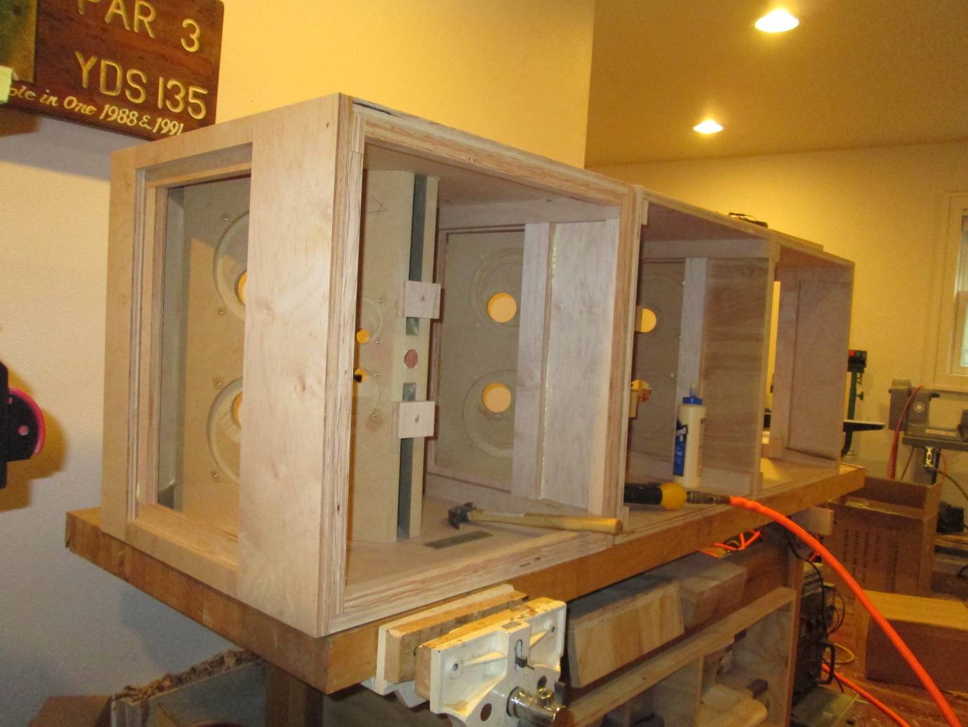

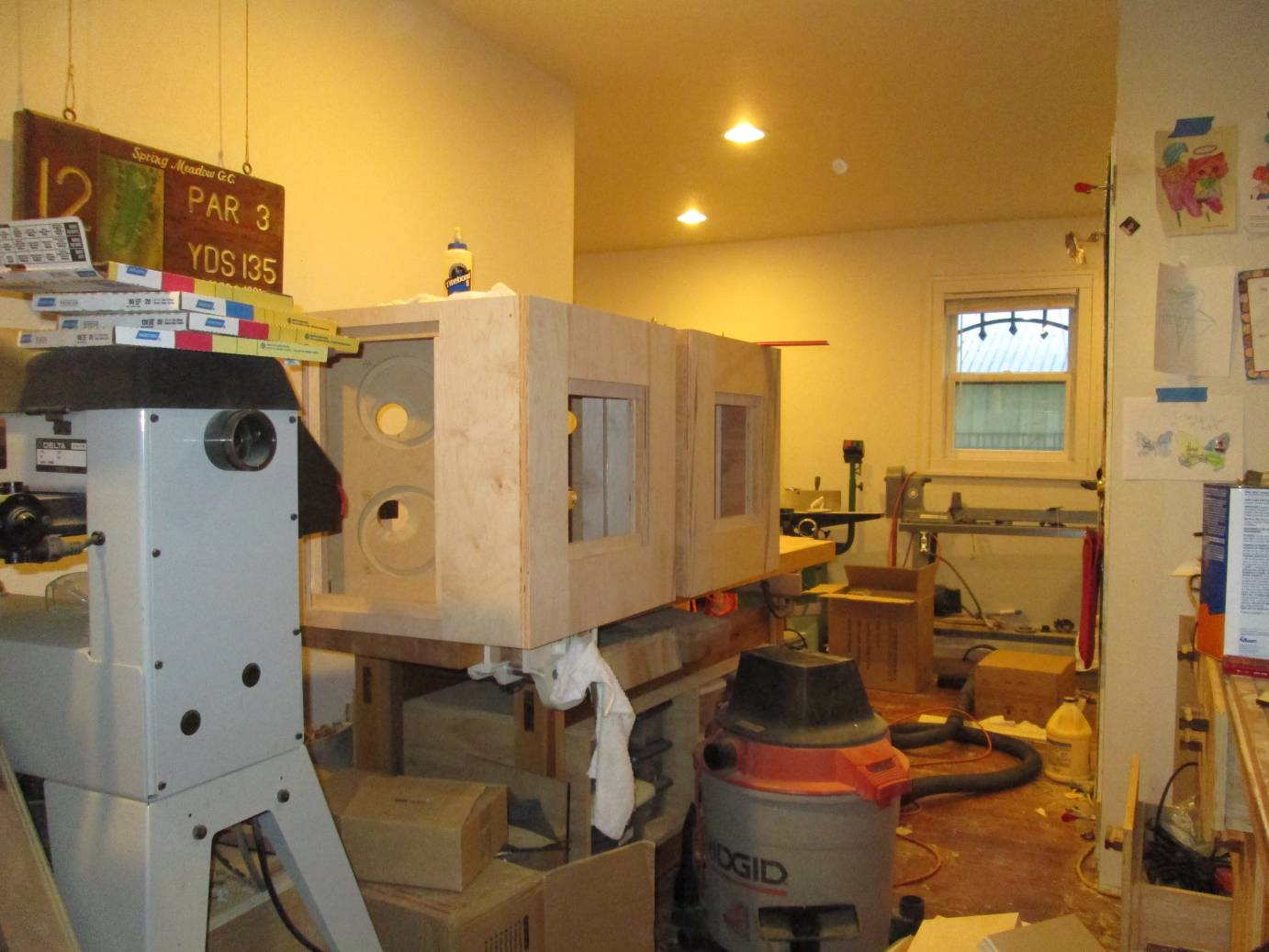

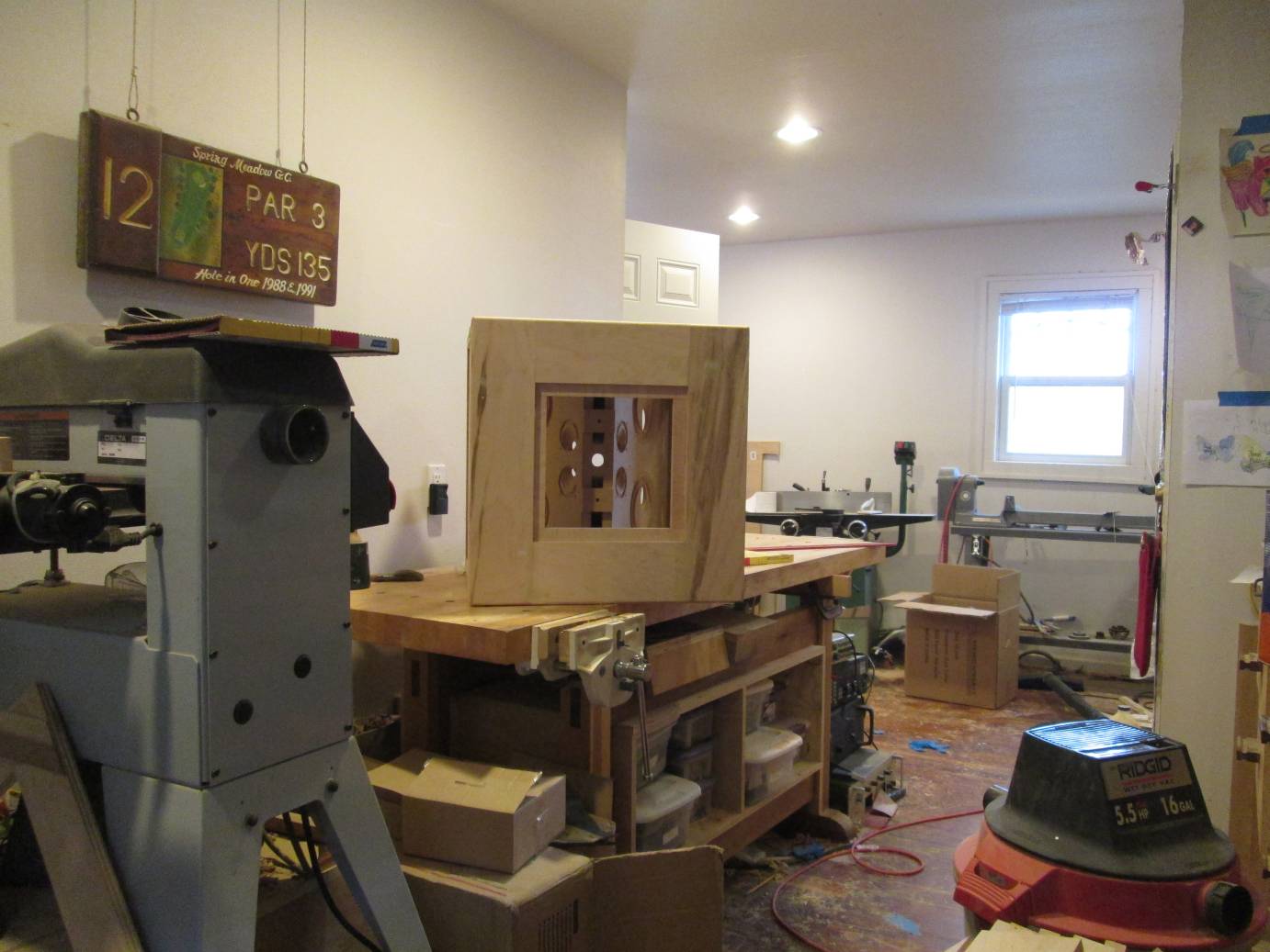

More pictures of wrapping an enclosure around the horn.
When doing this, the idea is to keep everything as square as possible. I put some serious time in here... The best part is, this way you can use a bunch of off-cuts and odd sizes...since very few pieces are very large it's efficient sheet good usage.
