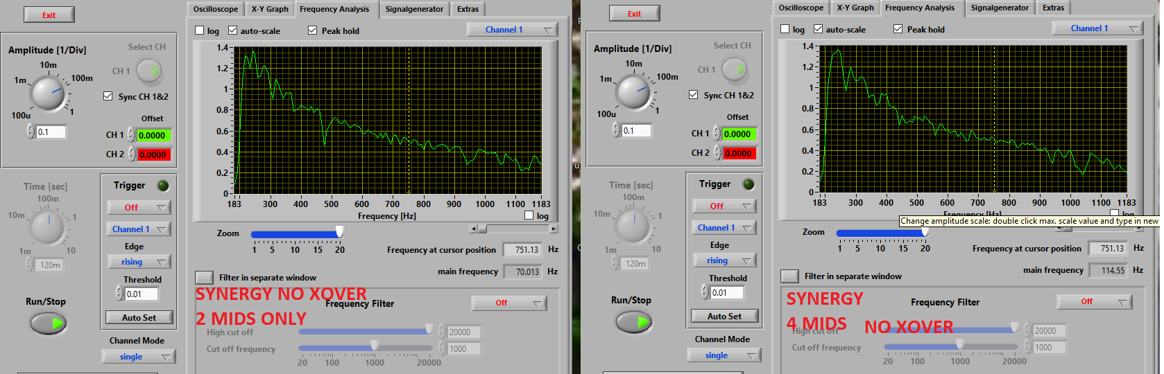

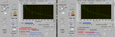

When I reduce my PSE144 to 2 mids (instead of 4) I got 470hz dive down.

I build Bills version and I compare it to Danley. The difference is obvious. Even Bill's version is more home friendly you cant beat the quality of transducers. The latest idea of Bill with one (or two mids) seems very interesting. it's not that hard to got mids to sound and measured right in Synergy.
Hi Sergey,
I think different port depth or compression vol might be needed when you change #ports at same location. At least they m9del a little different in Horn Response on some. Don't know about PSE144 though.
Also, did you cover the unused ports? If not they might act like resonant traps.

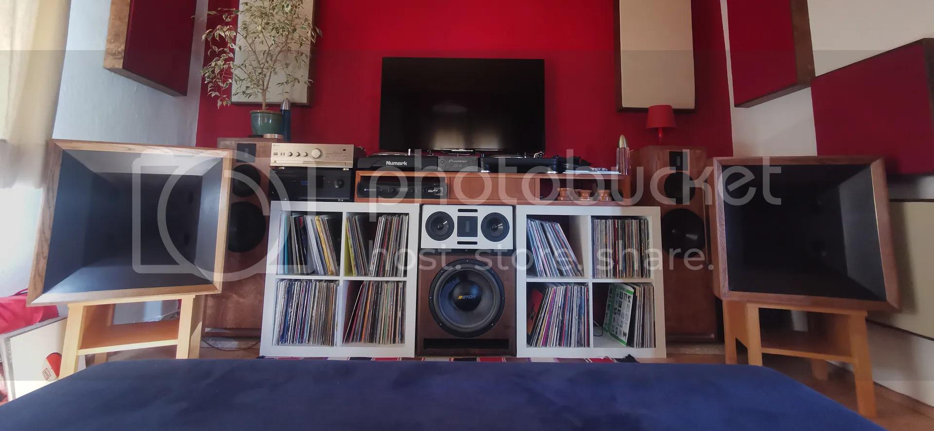

my synergy itteration
Sometime in april during lockdown here in Austria, I once again started to look for DIY Synergy Horns and stumbled over Scott´s build.
Regarding his backround and experience in audio, I was quite assured that the shiny description in the first post of this thread, wasn´t just a guy thrilled by his own work.
Although there were some doubts along the way, when looking at the price and the weight of the parts, i.-g the big caps for the XO are almost as much as the tweeter and how would it even compare to my "highend" ribbon twetter that cost as much as one complete synergy horn with wood and XO ?!
Would it be worth it, investing so much time and money in such a complicated enclosure?
The answer is YES!!!
My old system was very very good, but it lacked some punch and directness in the mids as a lot of this type of hifi tend to have.
The horns have the same amount of detail as my old system, but they do everything so effortless, at every level.
The 50$ tweeter is mindblowing, and the tiny midranges and cheap bass speakers, impress me every day. Price isnt everything, i know that NOW.
Had guys with 5-figure systems at home over, who couldn´t believe what they heard and left quite sad.
I don´t have the words and intention to wrtite a colourful sound description.
Trust Scott and my words: "They really are THAT good!"
The inner horn, top, side and bottom are black mdf boards. The rest is solid oak, with a little brass inlay at the horn mouth.

They are driven with DIRAC room correction, which imho does great things, especially in the sub region in my tiny room. They have surprising bass, but the last octave is taken care of by a big 15" BR Sub.
Planned to build proper stands for my horns, but decided to go for a second a sub underneath and finally get the rid of the sub in the center of the room.
My old system has found a new happy home and love my Synergies every day 🙂
Thanks Mr. Hinson for this amazing work :cheers:
-Sergej
