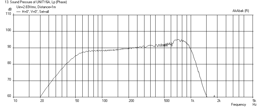

I see the point about huge holes in the sidewalls. Ok, if we back off on the desire to get 94 dB efficiency and drop to 4 drivers per horn and make the holes 2 in dia (or equivalent slot of 4.2 in x 0.75 in slot at the corners) the nominal efficiency drops to 88.5 dB which isn't bad for a 'home audio' speaker. Price gets cut in half to less than $20 for the 4 bass drivers. Not sure why you say the tweeter won't work as the main horn seems to be able to hit a 1 kHz XO point from bwaslo's measurements:
Here is the response with 4 drivers and a 1kHz LPF applied to suppress a peak that comes from making the hole smaller.

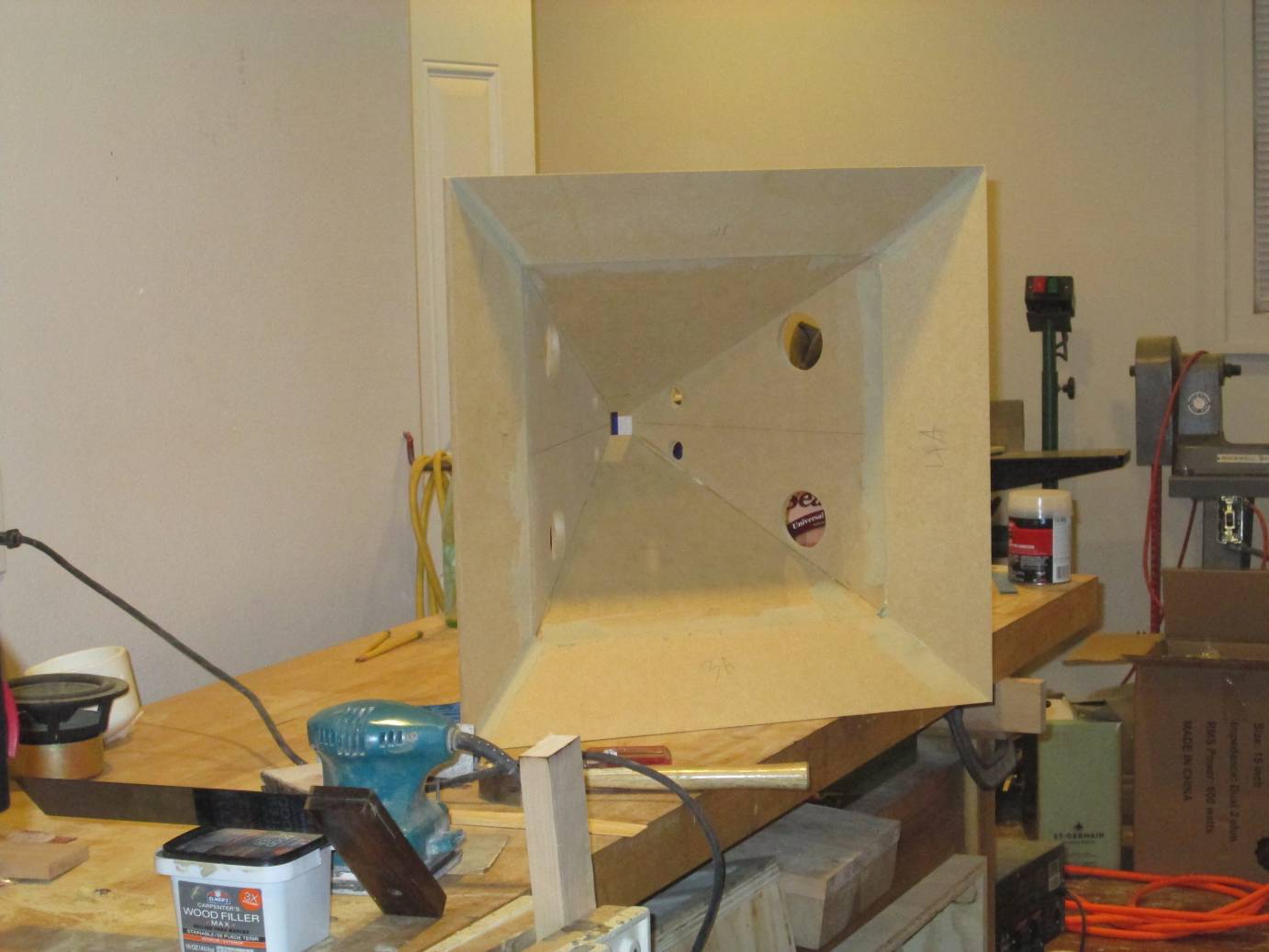

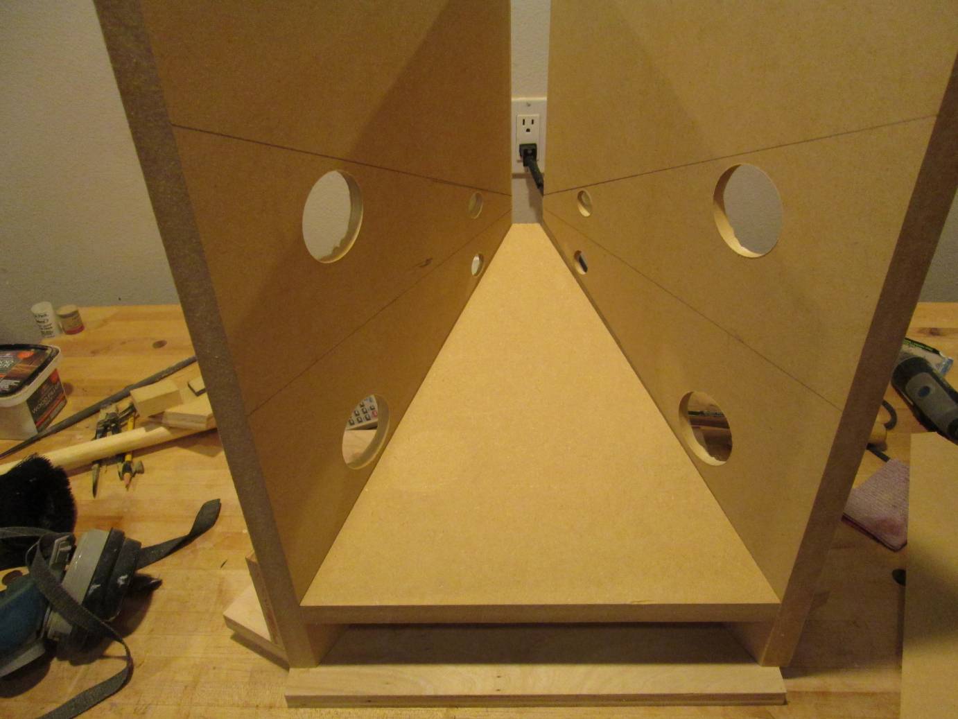

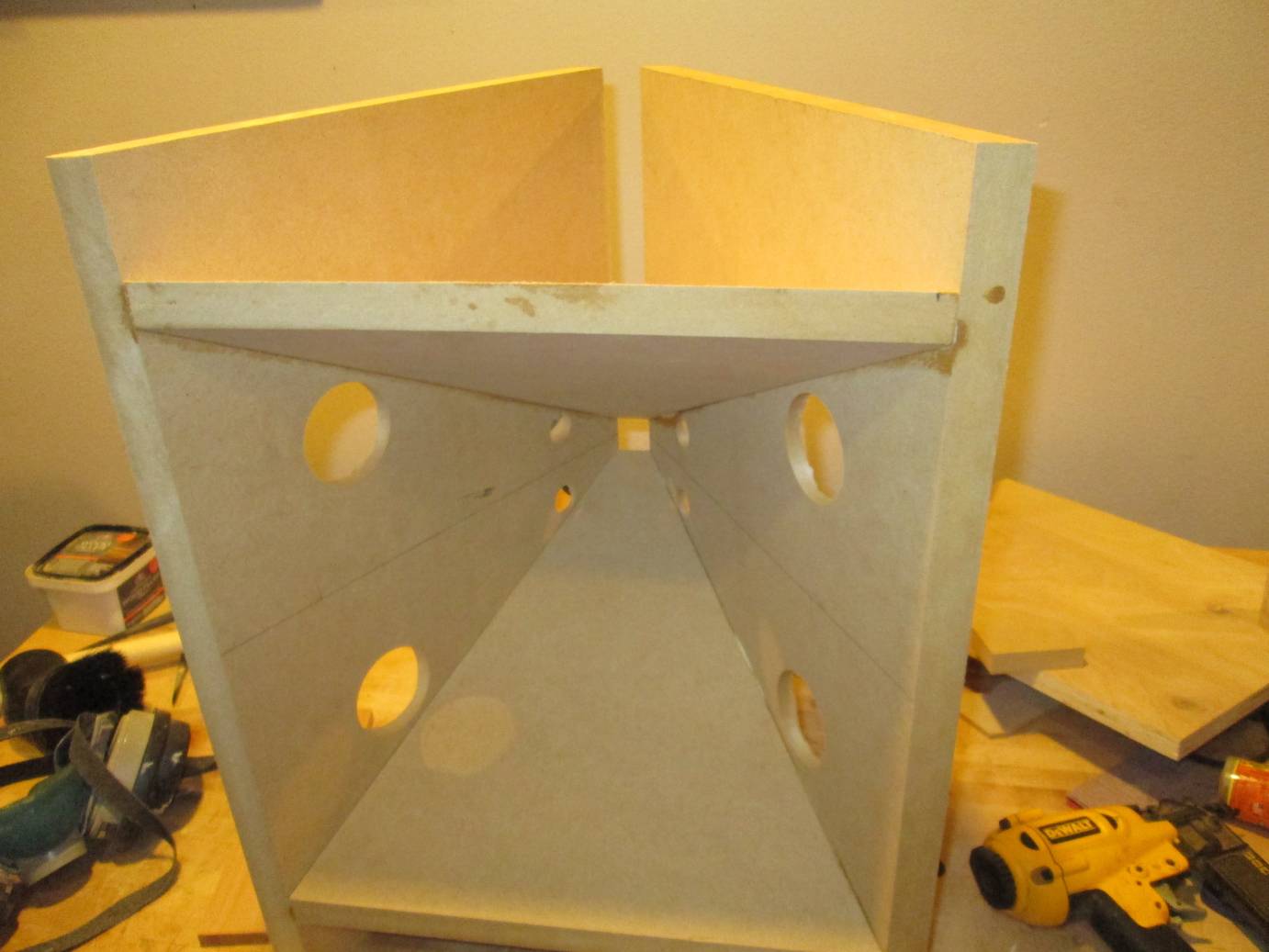

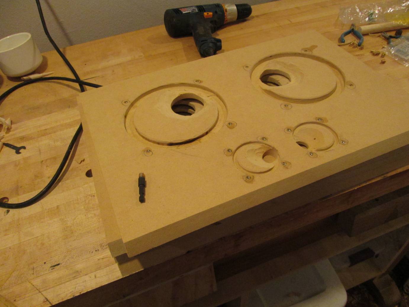

So next up is threaded insert installation. Buy. The. Tool.
Yes, there is a tool.
Buy it. It's very helpful. Also, install them on a very sturdy surface so you can press down hard as you are screwing them in. It helps prevent the MDF from pulling up...it still does, but not as bad. Then sand it flush. I put a dot of sanding sealer in the holes before screwing them in, in hopes that it would prevent the MDF from pulling up. I'm not sure it worked.

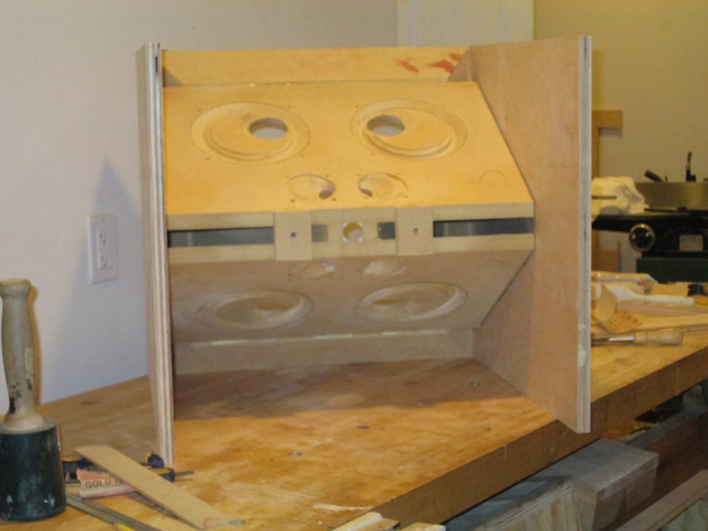

You can also see the jig I built to help hold the full height pieces.
The secondary flare and the primary flare were put together using gorilla glue which expands, aiding in assembly even if there is a small gap.
That said, work to minimize the gap. Gorilla glue isn't all that strong, so if you have large gaps you might consider secondary blocks, to increase glue surface area...I did on mine even though my gaps were pretty small.
I held the secondary flares in place using tape, and worked very slowly to ensure that each piece was glued on as square as possible. It was probably a week between start to finish since I was only gluing 1 secondary flare piece a day, one morning one at night. Patience is rewarded here....dry fit as much as possible.

Nice work there - looks great. Sometimes I use hot melt glue to tack and clamp while PVA glue sets. The hot melt can also be use to seal cracks like caulking.
I didn't think to use hot-melt as a temporary hold. I've used 60 second epoxy before...but that's for something that you know you can get into position in about 5 seconds flat. (They have a different version of 60 seconds than I do.)
I'll have to keep the hot melt trick up my sleeve for the next build where I could use about 8 other hands.

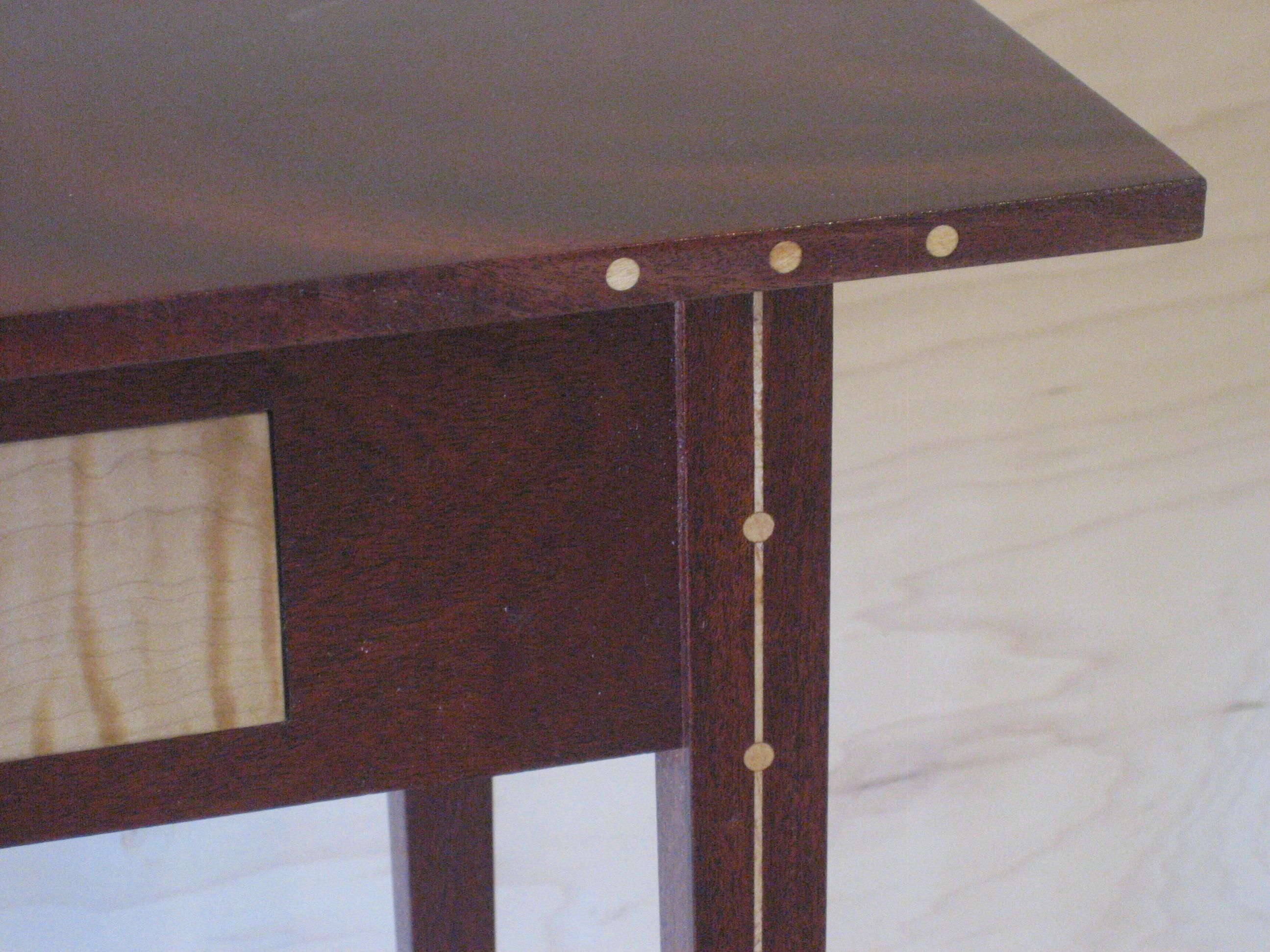

I just perused your thread....yeah...I had some prototypes that looked like that. Then my OCD kicked in and I started using some furniture making techniques to get the results I wanted. This was my last table, Mahogany, Maple, Zebrawood.
Great progress though! I wish I could have done the BMS...my wife barely put up with the speaker budget and size as it was....

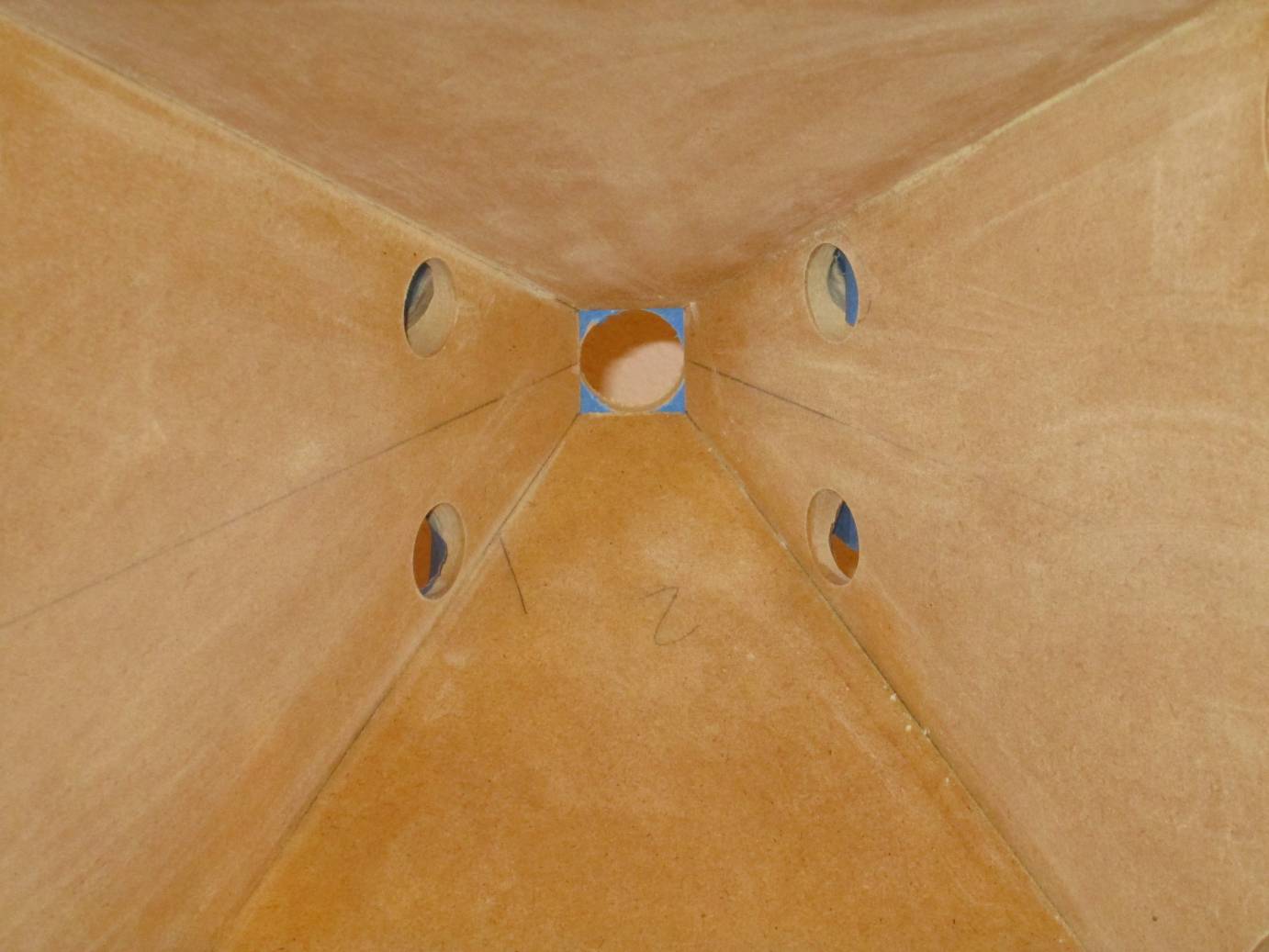

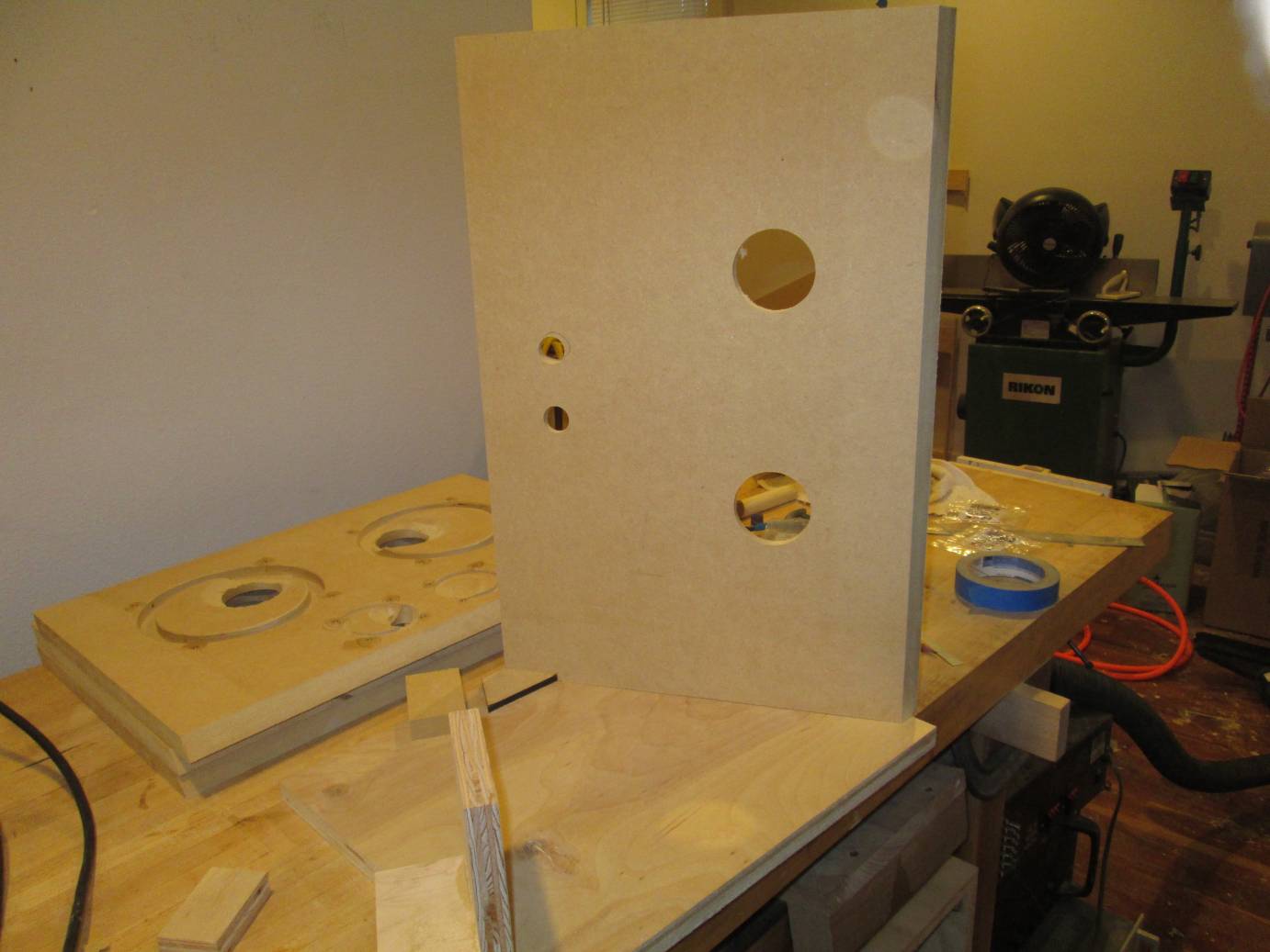

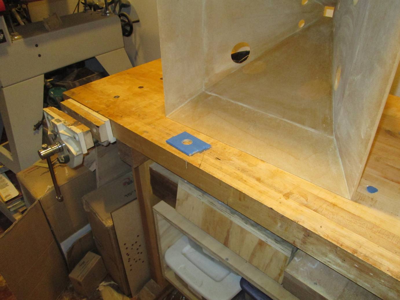

So next up is the process I used to smooth out the tweeter entry points. As far as I can see in the pictures on the Danley site...they don't do that. But I did...I kept reading about higher order modes...etc....so figured out a way to do it.
First I got two part epoxy putty to use as the filler. Next I drilled a piece of 1/8" MDF with a 1" hole. I covered it with masking tape, figuring that the epoxy would stick to the tape and the tape would come off the guide.
I then taped the guide to my entry throat and used it to build up and sand down the epoxy putty.
I thought I had gotten great photos of it.
I didn't, or if I did they are buried somewhere on my hard drive.
Scott

Very nice progress and great craftsmanship on this horn ( nice looking table too ). Let us know how the tweeter entry anything operation goes and if you can measure the difference. I can see why Bwaslo recommended making the throat entry only 0.71 in x 0.71 in - then when you use a 1 in drill it naturally makes a nice circle to square transition at the entry. I have a cheap CD that has a built in 4x4 in horn and I am thinking of making the begining of the wooden horn that size to match perfectly and this use the factory 90 deg horn as the throat. This may move the mid holes down further though.
