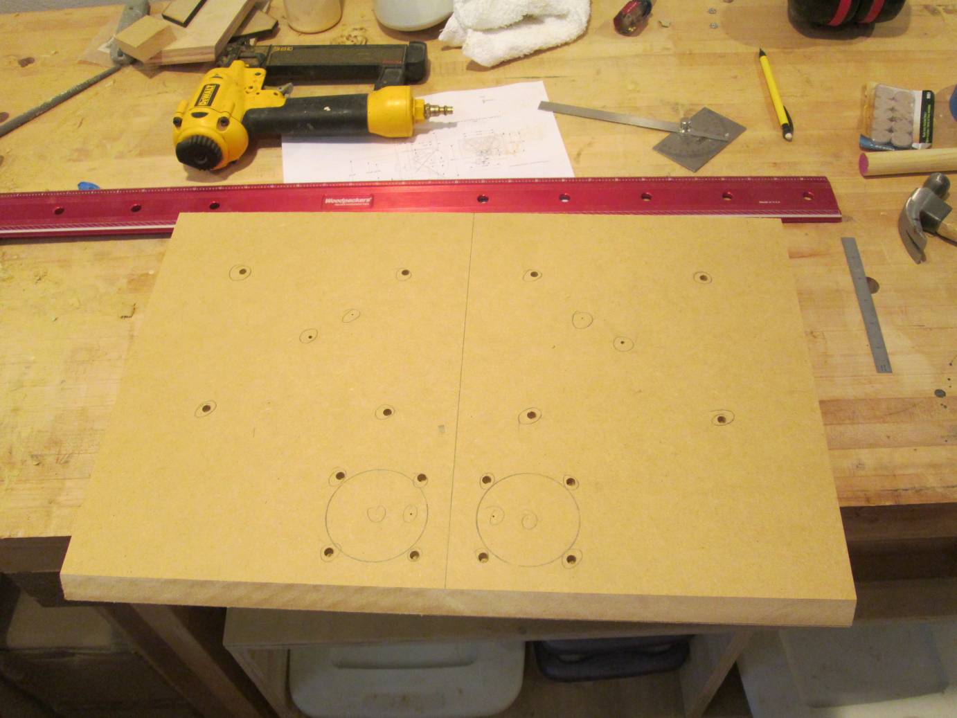

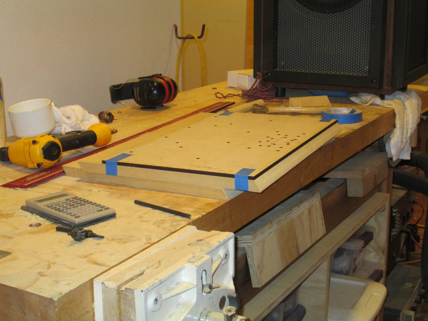

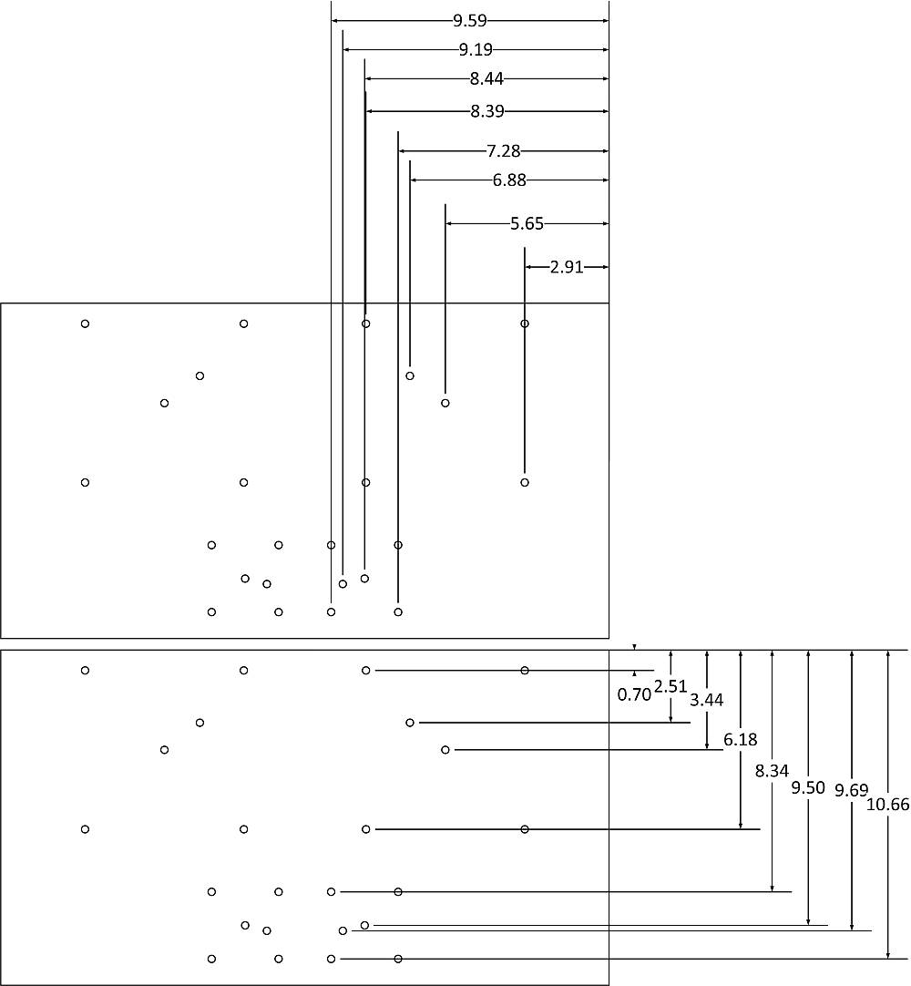

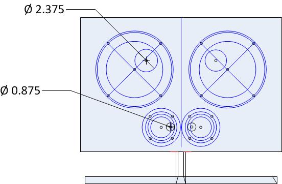

So next up in the build is how to repeatably drill all the stinking mounting holes. I wanted to use threaded inserts to ease driver replacement if ever necessary. I ordered a couple extra mids and woofers for myself in case one ever went bad. (One did...but in a crazy way, totally my fault...story to be told later.)
There will be hundreds of holes...between the access panels, driver mounting panels...etc. Have a drill press, it will speed things up greatly. It could be done by hand...very slowly and carefully...but it could be done. Also, please use a brad point bit or a forstner bit for drilling...preventing bits from wandering. Much more precise.

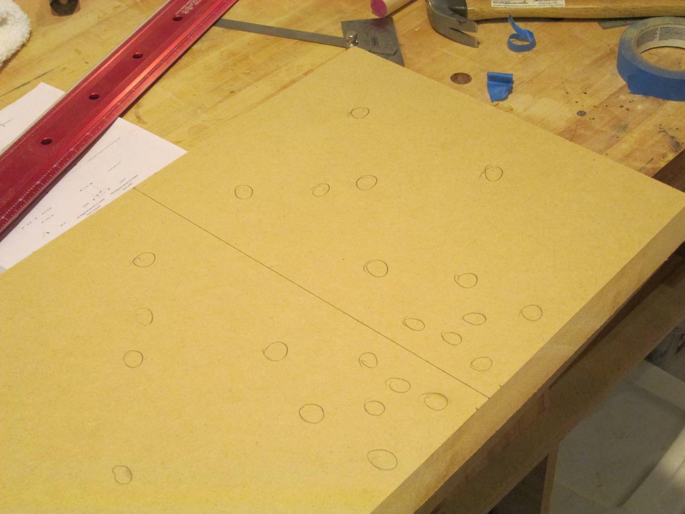

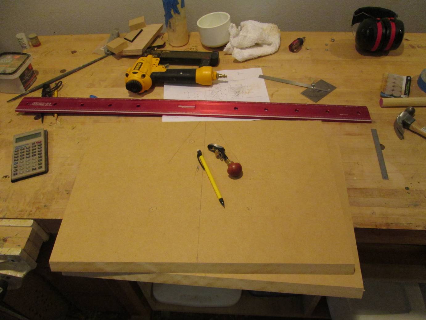

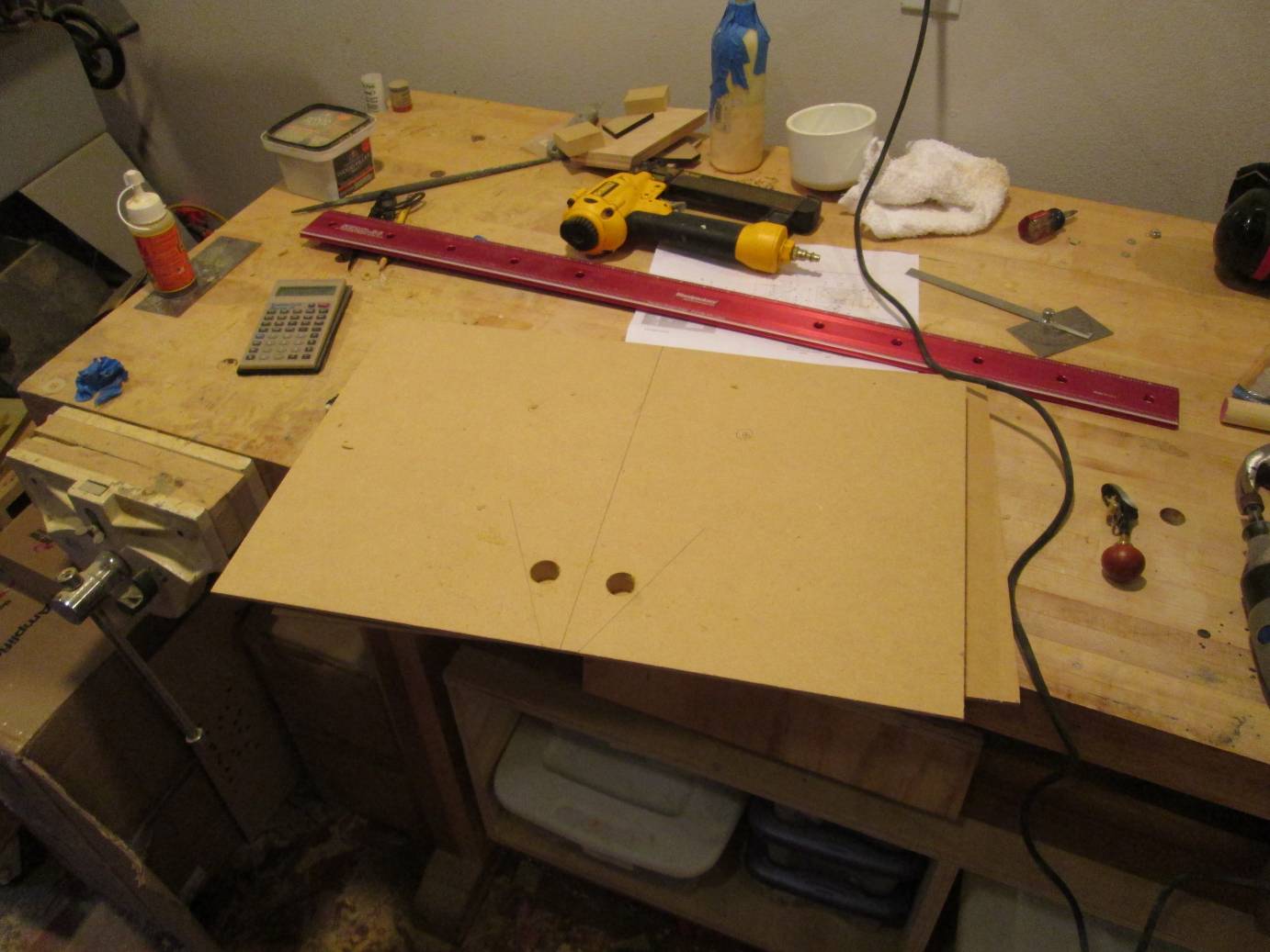

I made myself a marking template. I used 1/4" thick MDF that I laser cut using an exported DXF. (I have access to a laser cutter at work.) However, with a lot of careful measuring you could hand measure and mark it...and drill the guide.
I cut 1/4" holes and used something called a transfer punch to transfer them to the piece that would be used in the horn. It only took a couple of minutes to transfer all the drill locations to the work pieces where it would probably take you 20 or more each piece to measure every one. So totally worth the time.
You can also see I marked the location of the tweeter entry and the center line of the board.

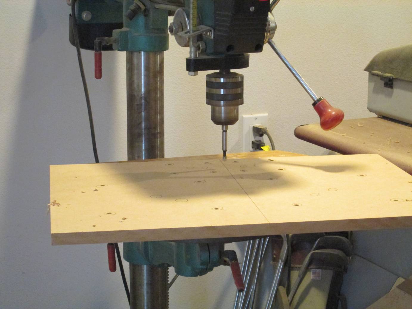

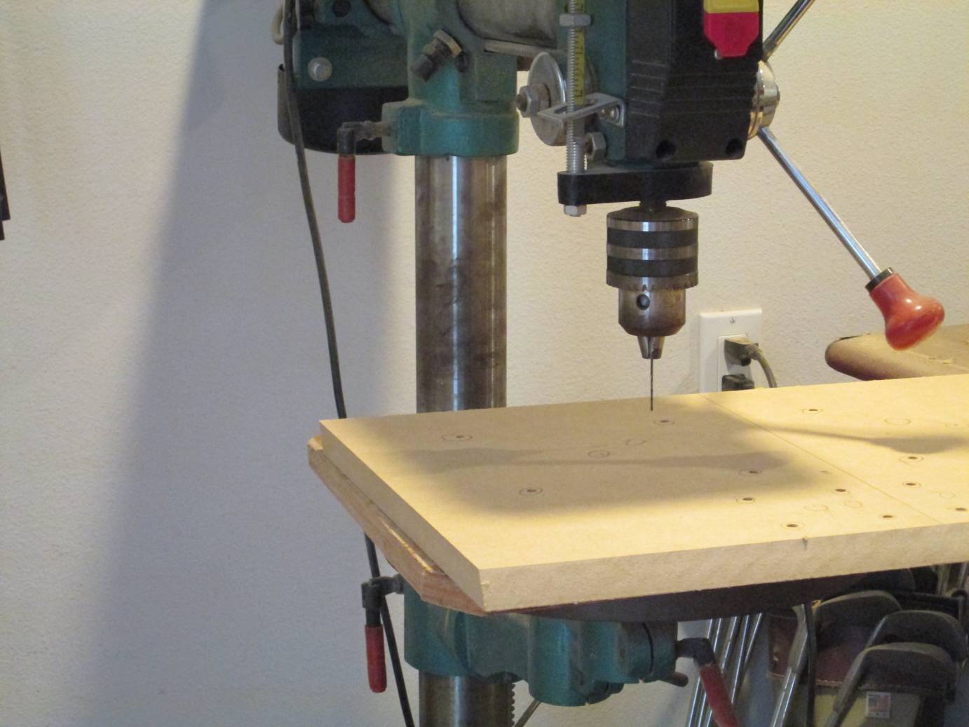

Next up is hole marking and drilling...for the driver mounting points I wanted to use threaded inserts. It happens the brass ones I used need a 1/4" hole. They are 6-32 which has plenty of holding power for an 8" woofer of the excursion of the Dayton.
I drilled each hole on my drill press.

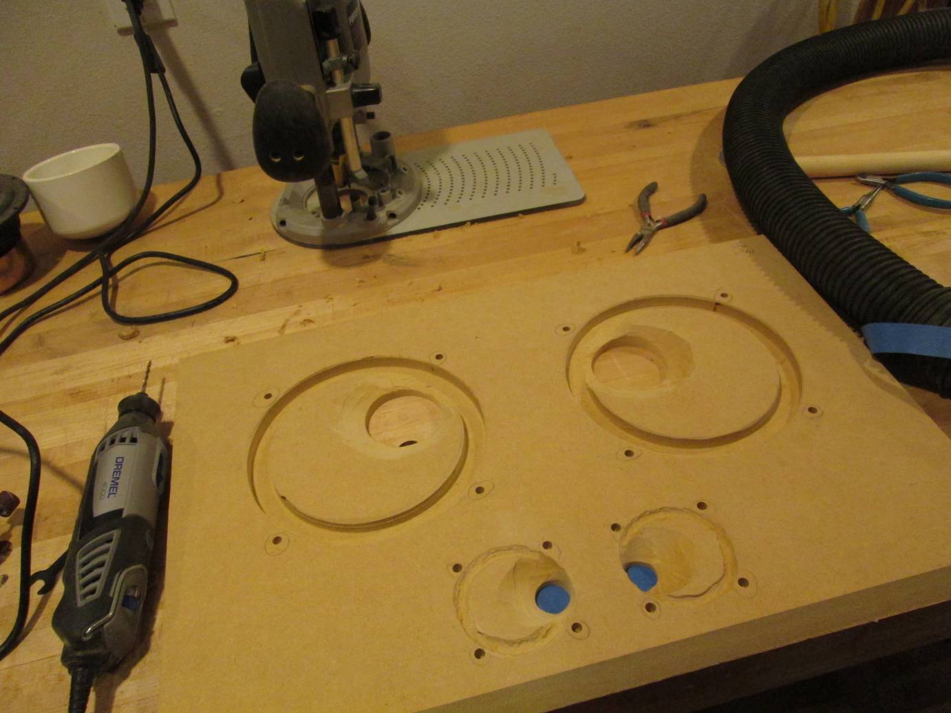

Next I made marking drills for the woofer and midrange taps. I picked the smallest drill I had (not sure what size) and drilled all the way through since the back is what got marked. This gave me a precise location to drill on the front.
When I flipped the piece over I discovered that the hole was somewhat difficult to find...the MDF had "self healed" so I used a tiny plane to shave off the material covering the hole.

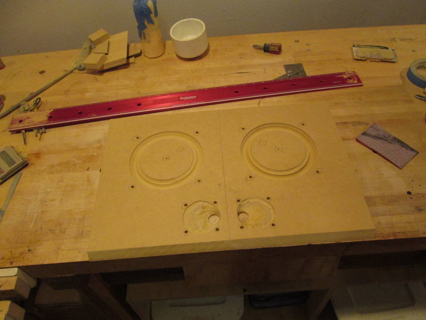

I drilled the tap ports for the woofers and mids from the front side of the horn using forstner bits. I didn't care too much about tearout on the back side since I knew I'd be grinding away at those areas anyway.
I then used a combination of dremel tools and routers to make clearence for the surrounds and cut aggressive frustums into both the mid and woofer holes.

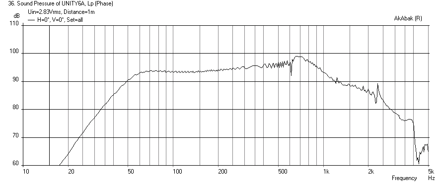

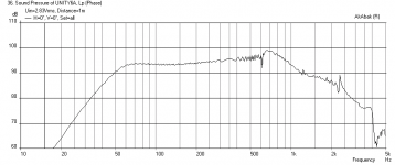

2-way 6.5 in bass driver option?
I am just getting into the Synergy horn design and think I may have found a suitable low budget option for a 2-way bass driver. I used the dimensions of bwaslo's 60x90 horn (coSyne) and stuck in the PE buyout 6.5in polycone woofer at the miidpoint of the main expansion with a 3.5in dia hole. If you get rid of the mid drivers, there will be just enough room to fit 3 drivers on top and bottom and 2 drivers on the sides for an 8 driver mid-bass that produces this response. The drivers are <$5 ea.
Here is bwaslo's design: DIY Synergy/Unity spreadsheet
Here is the calculated response for a sealed back box (no bass vents):
What do you guys think?
