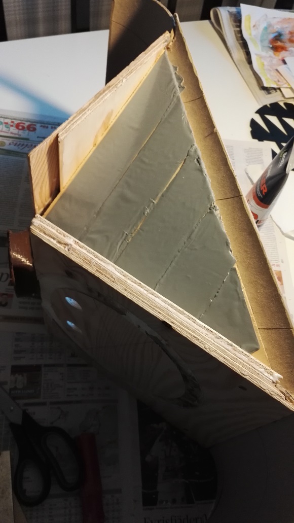

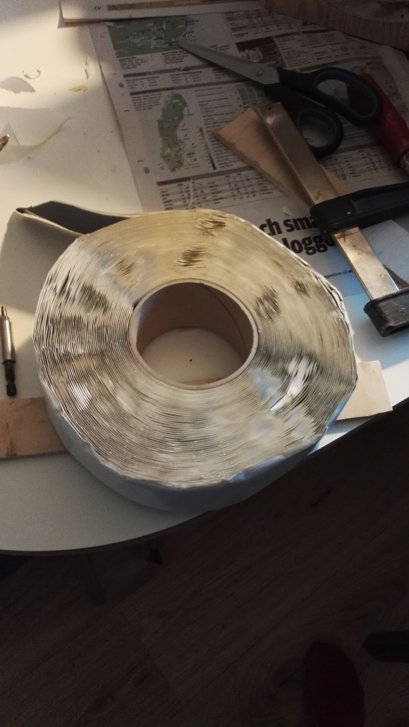

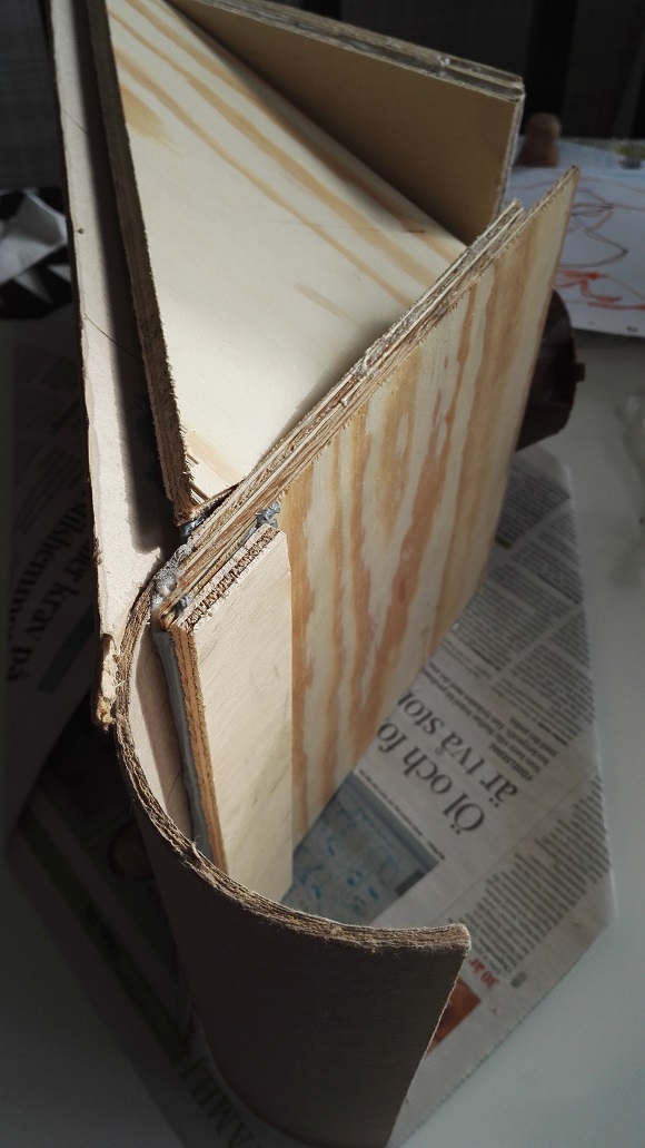

I bought some butyl band today, it's 50 mm wide (2") and 1 mm thick. It's a new product for me, feels like "häftmassa" (Blu-tack, Tack-it) but a little more sticky:
I added a layer on the top and bottom panel as they are largest:
On top of this I added another 11 mm plywood panel (scrap piece) and clamped it for 15 mins. I also added a small (40 mm wide) beam on the side panels beside the woofer with butyl band. As you can see on the picture above I've started with some routing and I have a simple volume filler made of MDF done. Hopefully I'll be able to do the last routing and mount tomorrow.
About the pre-ringing. It's at 25 kHz, my hearing does not come even close to that. So it's a cosmetic thing in the plots, but it would be nice to get rid of it. Someday I'll do a measurement with the nanoAVR to see if it shows the same phenomenon.

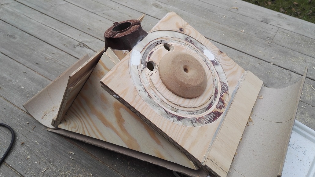

This is what the extra beam for the side panel looks like:
I tried the traditional "knocking test" and the sound is drastically different from before the treatment. I have however increased the amount of plywood by ~30 % so that is maybe not very unexpected. But there is almost no ringing, it doesn't really sound like I'm knocking on wood. 🙂

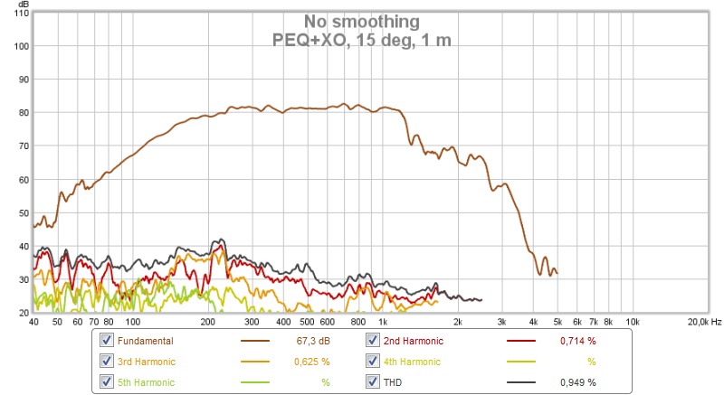

First a new measurement of the R2604 with only a 6 dB BW at 6 kHz (no cap), at 1 m, 15 deg:
It seems like the distortion around 500 Hz was due to panel vibrations!
Raw measurement of 8FE200 at same position:
and with PEQ and XO:
When I exceed 85 dB the distortion starts rising and at around 89 dB there is some obvious scraping (cone against volume filler I think).

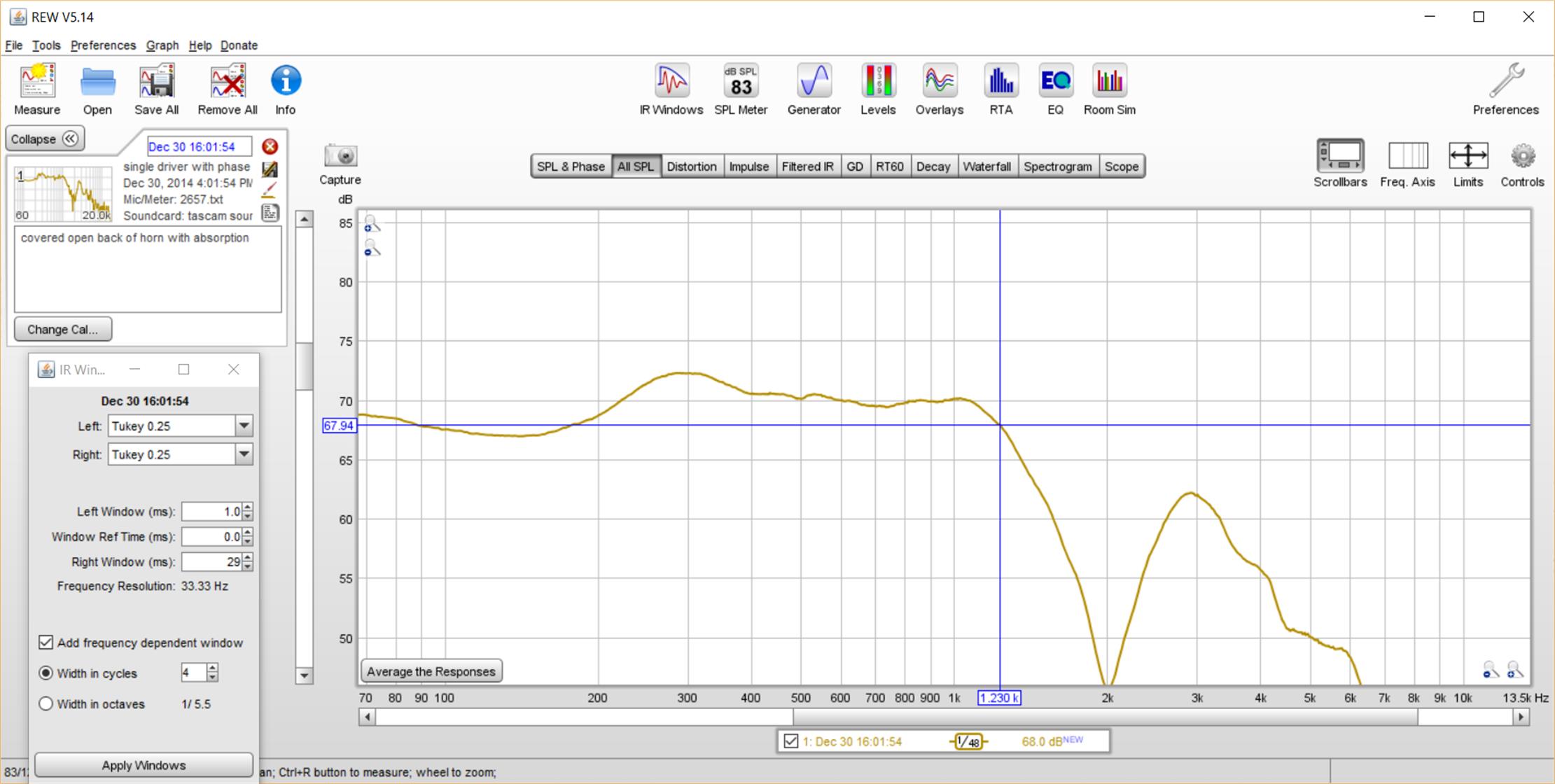

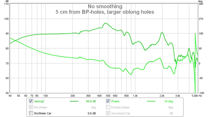

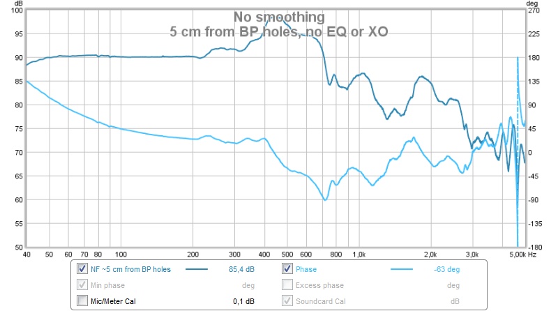

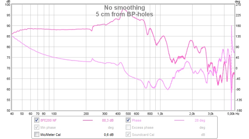

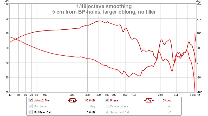

Here is the woofer response 5 cm from the BP-holes:
I'm really hoping that making a box to increase the distance between the front and back wave will have some effect on the response. It falls of with a textbook 6 db/octave from 350 Hz at 1 m now which requires a lot of EQ.

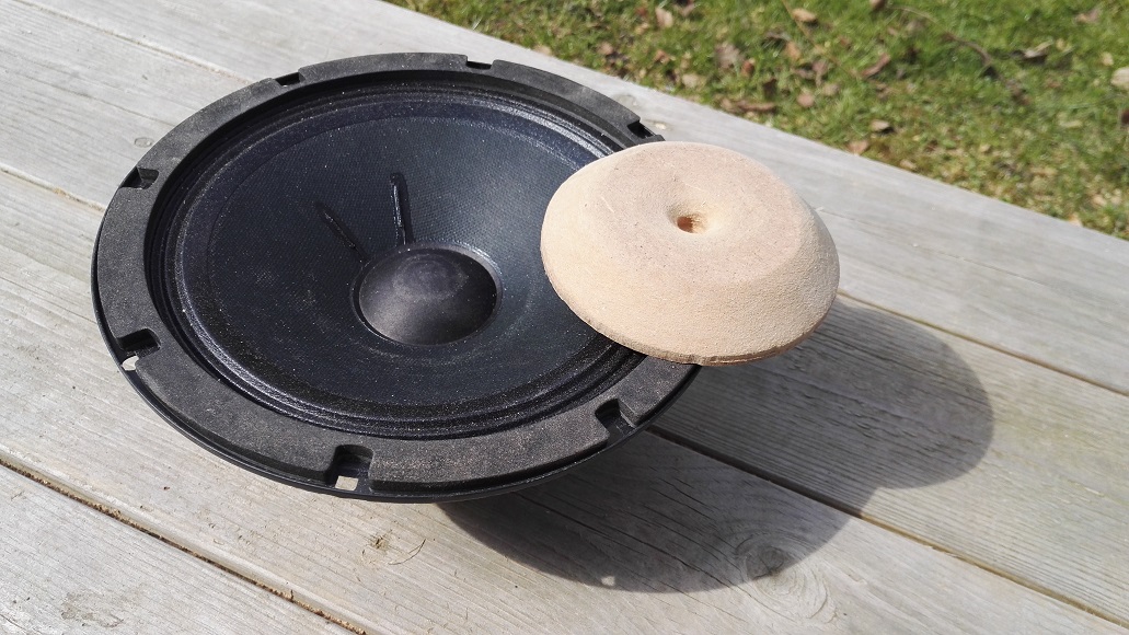

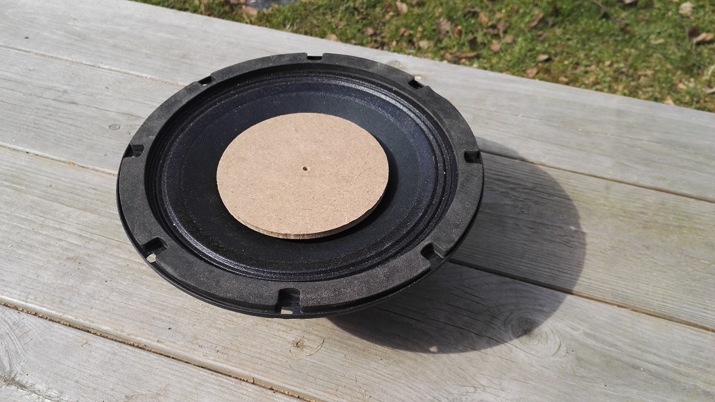

Well, the phase plug only works properly if it's loading into a symmetrical-to-the-driver horn. Otherwise you'll alway have again the same problems with the phase (or, if you want, run-time) differences. So no, to increase the distance between the front and back wave will not have the desired effect. At least not in the problematic frequency range. I have more the impression, your small holes work probably more as a helmholtz resonator. To verify you could also look at the waterfall or impedance diagram.
Here in the states, I use roofing membrane and fibrous roofing cement for CLD as both products are relatively easy to find and cost effective. Only drawback is the cement gasses off for a few days so build time is extended.
When you say phase plug I assume you refer to the volume filler? The reason I added it is to move the LP point of the chamber between the cone and horn wall up. But sure, it acts like a phase plug, and the size of the driver may be what causes the irregularities around 400-700 Hz. The sharp dip around 900 Hz was at least removed by the volume filler.Well, the phase plug only works properly if it's loading into a symmetrical-to-the-driver horn. Otherwise you'll alway have again the same problems with the phase (or, if you want, run-time) differences. So no, to increase the distance between the front and back wave will not have the desired effect. At least not in the problematic frequency range. I have more the impression, your small holes work probably more as a helmholtz resonator. To verify you could also look at the waterfall or impedance diagram.

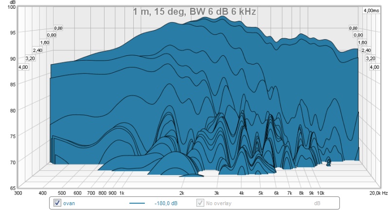

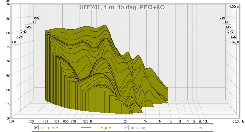

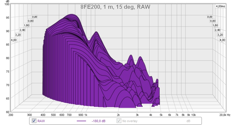

Here are the CSD-measurements:
From raw 8FE200 measurement.
With PEQ and XO.
For the R2604 with BW 6 dB at 6 kHz.
I'm thinking there is a problem right now that the back wave arrive before the front wave as parts of the cone backside is closer to the mic than the BP-holes, at least when off-axis.

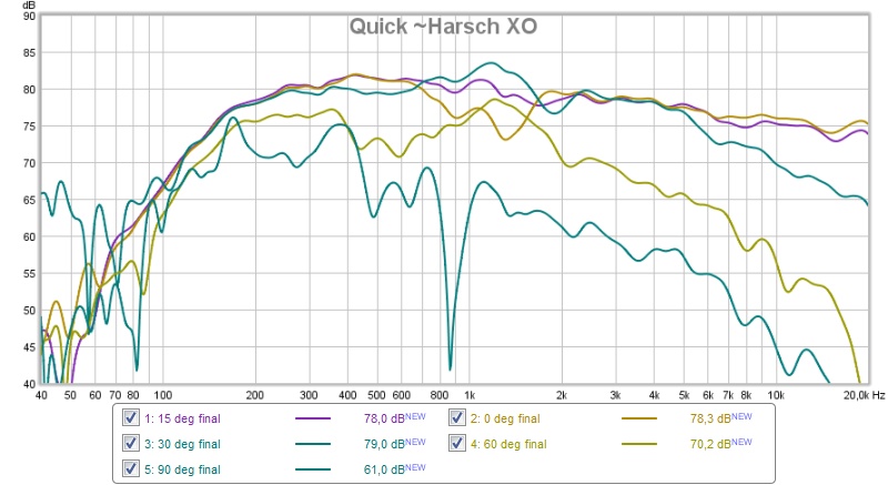

Here is a polar measurement I did after making a quick XO that looked decent at 15 deg:
Quite heavy irregularities around the XO (1.2 kHz).

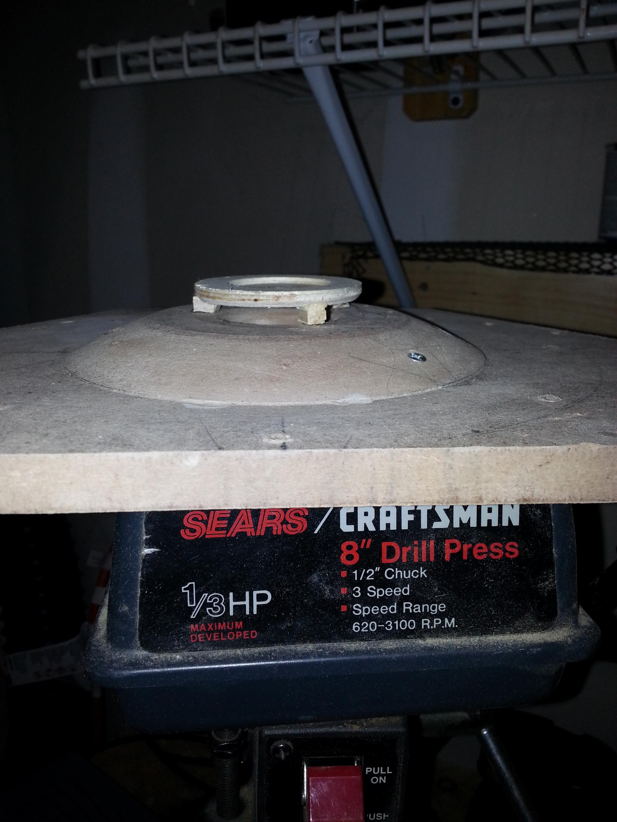

my results with a top hat phase plug

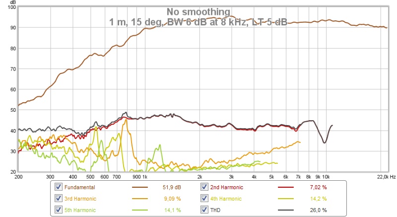

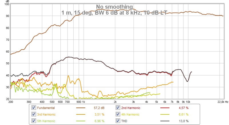

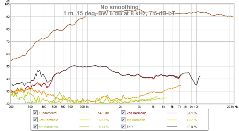

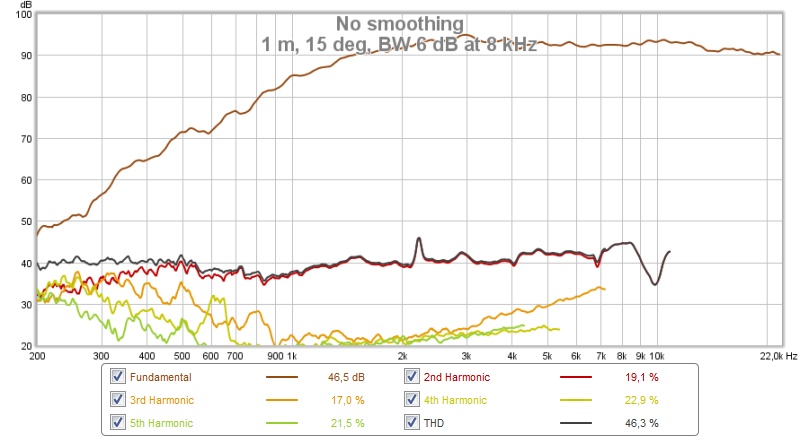

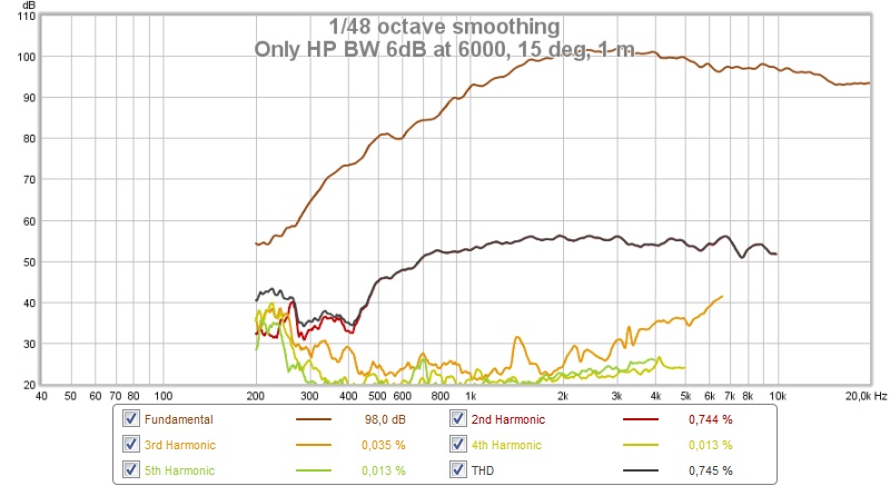

More R2604 experiments
The distortion when only applying a HP filter (at 6 kHz) hinted that a lower XO was possible:
There is definitely a downward slope from ~2 kHz which got me thinking that a LT could make my life easier by moving the XO to below 1200 Hz.
First a baseline, 1 m, 15 deg, BW 6dB at 8 kHz, about 94 dB:
-5 dB point is at 1.3 kHz. (Distortion below ~800 Hz is noise from airplanes, weird peaks between 500 and 2000 Hz are birds.)
With a mild LT (5 dB):
-5 dB point is at 1.0 kHz. Distortion only very slightly raised around 1 kHz.
A little more (7.5 dB):
-5 dB point is at 0.9 kHz. Still acceptable as it's 40 dB below for the pass-band.
More (10 dB):
-5 dB point is at 0.83 kHz. The distortion feels a little high.
So XO at 900-1000 Hz is indeed a good option for this tweeter in this horn!
/Anton

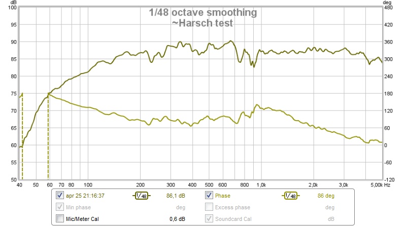

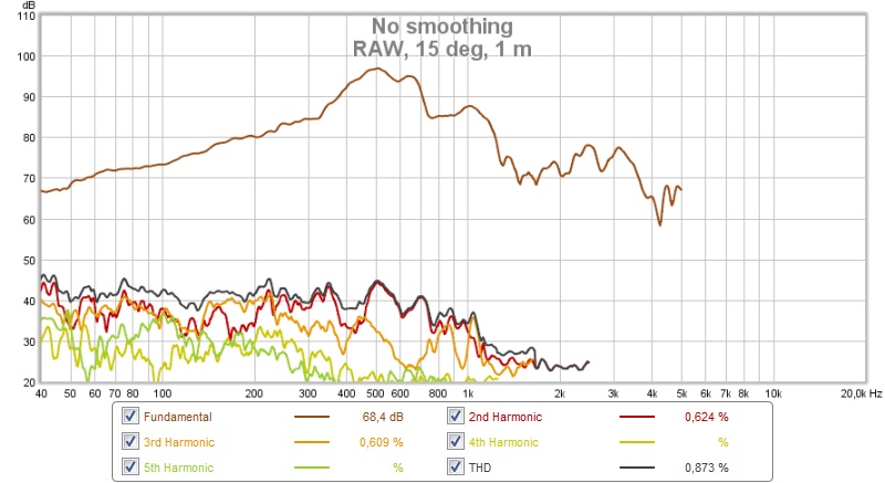

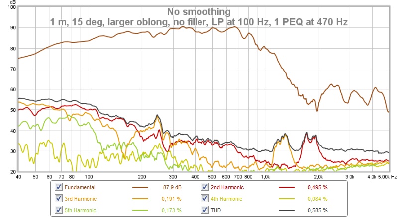

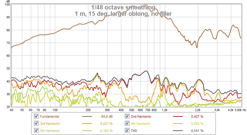

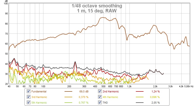

Mid measurements

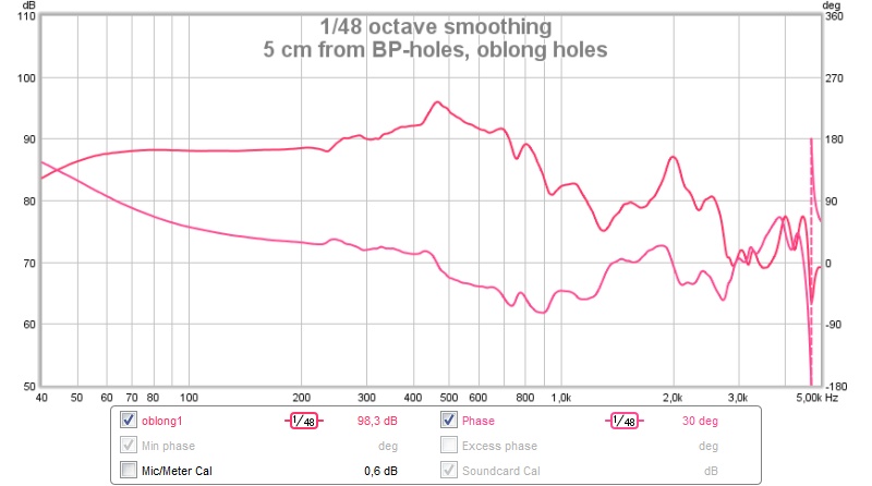

I did also experiment with the BP-holes. First I tried removing some material from the volume filler to straighten out the response and remove the odd peaks in the distortion. It had little effect:
The peaks around 500 Hz are a little lower and only 1.
Then I drilled a 14 mm hole closer to the mouth of the horn to make the hole oblong and reduce distance differences for the 8FE200 (which I think is causing the 500 Hz peak):
That's a surprisingly small difference, lower peak but same shape. Let's add another hole:
No difference again... Alright let's remove the volume filler, that should make things a lot worse:
Oh, it didn't. Actually a little better. How about at 1 m:
Interesting, let's add a first order LP at 100 Hz to counteract the open baffle slope (and 1 PEQ at 500 Hz to smoothen response):
Not bad for ~900 Hz XO. A little high distortion below 200 Hz, but there is no HP filter added. 89 dB for one should be 95 dB if both woofers were installed. Time to make a box and install the other woofer I suppose.
I got a little excited and tried combining the responses (R2604 with 7.5 dB LT and 8 kHz HP, 8FE200 with the above settings) and only trim delay on tweeter:
Not perfect, but It's only at one point and with one woofer.
/Anton
