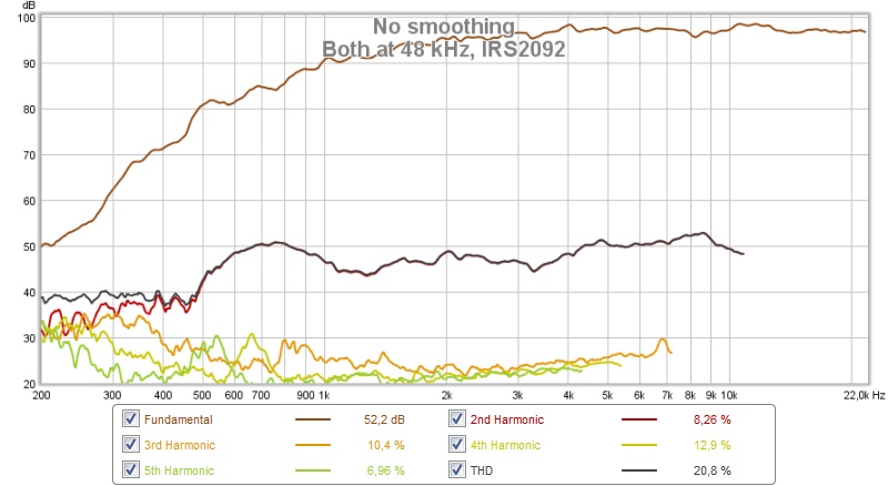

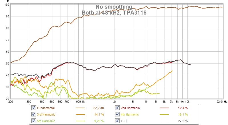

Sample rate corrected!
The sample rate in REW was 48 kHz and 44.1 for the soundcard. Now with both at 48 kHz, 97 dB (with the TPA3116):
And here with a 300 wpc amp based on the IRS2092:
and at 89 dB:

Nice to see the cleaner distortion plots, you'll have to thank ICG for that 😉.
Did it clean up the bottom end of an early waterfall plot as well? I did see some sample rate mismatch "like" disturbance there. But that could also be driver related.
The remaining pré-ringing could come from the D/A stage but this exercise did show the degradation of the signal with a mismatch in sample rate. I'd recommend running a loop back of the signal chain without the speaker and mic to see how far you can clean it up.
As you have plans to use different equipment it's probably OK to let this be as is.
The IR represents mostly high frequency. This ringing can be above 20 KHz. A loop back shows you where it is. I could hear a difference between Asio and Wasapi on my speakers. After adjusting my Asio buffer settings with loop back confirmation that difference went away. Signal chain does matter to a degree. Wasapi still gives a little advantage (in plots) but I need the Asio chain for running more than 2 channels.

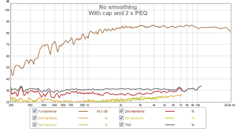

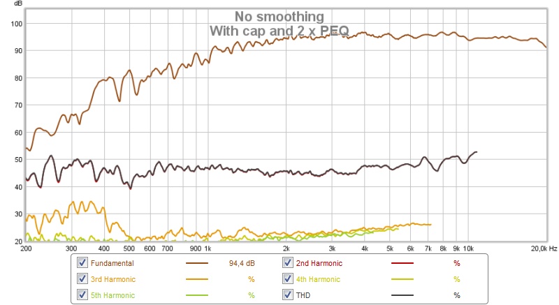

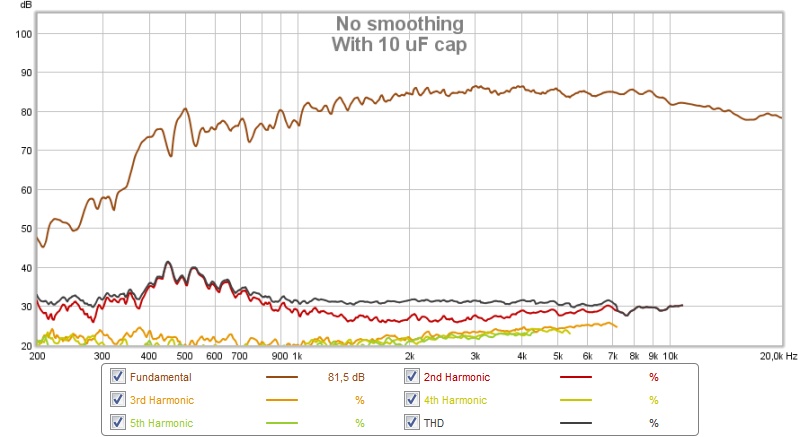

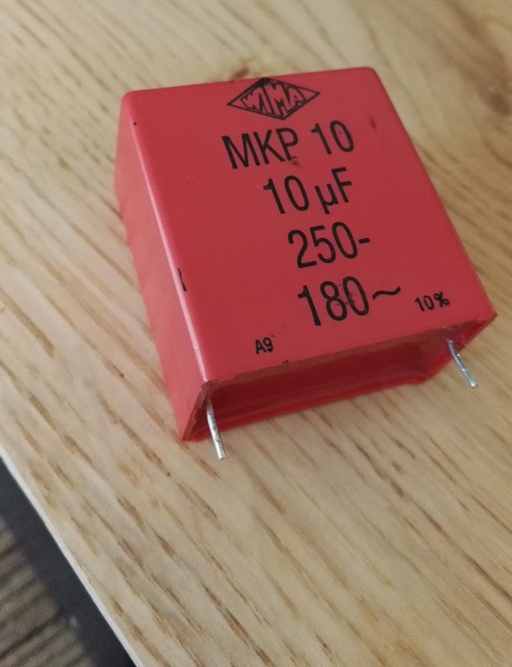

Experiment with capacitor

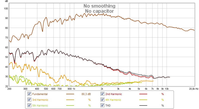

I did a little experiment inspired by kees52 in the Trynergy thread where I added a 10 uF WIMA MKP capacitor:
in series with the R2604.
All measurements at 1 m, 15 deg off axis using my IRS2092 amp. First without cap:
With 10 uF cap:

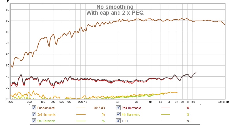

Quite good, let's try adding a little PEQ to remove hump at 500 Hz and lift slightly at 16 kHz:
Excellent, close to a 1200 Hz Bessel actually.
Let's turn up the volume:
more:
more:
Interesting result with only 1 cap and practically only PEQ outside the passband (16 kHz PEQ could easily be skipped and 500 Hz PEQ was only to control excursion/distortion).

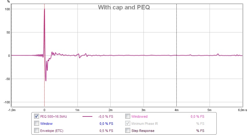

Impulse response with cap and PEQ:
/Anton

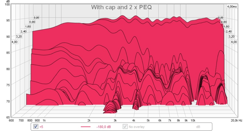

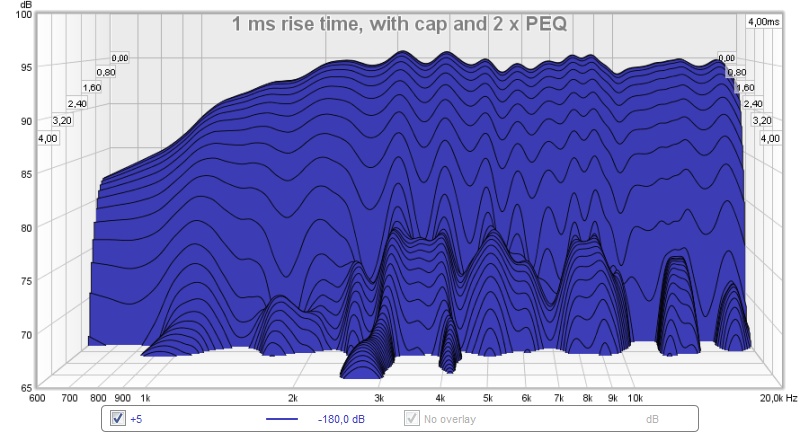

Oh, and here is the CSD for the 95 dB measurement:
Compared to an earlier CSD:
541195d1459536988-synergy-attempt-without-compression-driver-1m-axis-eq-bs1200-csd.jpg
Slightly better behavior below 2 kHz.
Oh, and these measurements are done indoors, shouldn't affect anything as I've gated the measurement before first reflection.
/Anton

Not bad at all! The distortion plots look very good. Any change in phase with the introduction of the cap? Will be interesting to see how adding mids will handle the hand off to the tweeter.

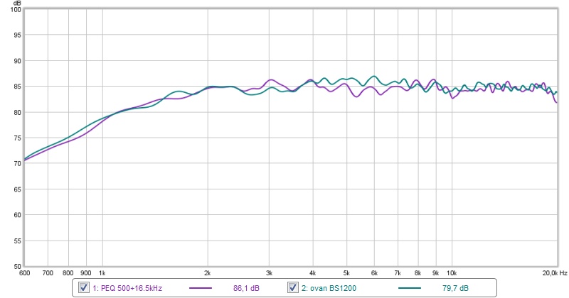

Here's a comparison of cap+2 x PEQ (purple) and EQd flat+LP Bessel 1200 Hz (green):
And phase:
Quite similar, slightly less phase change with the cap.
/Anton

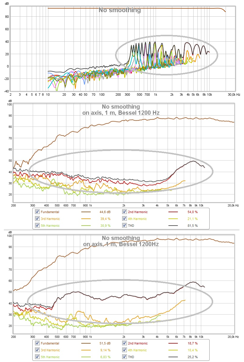

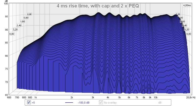

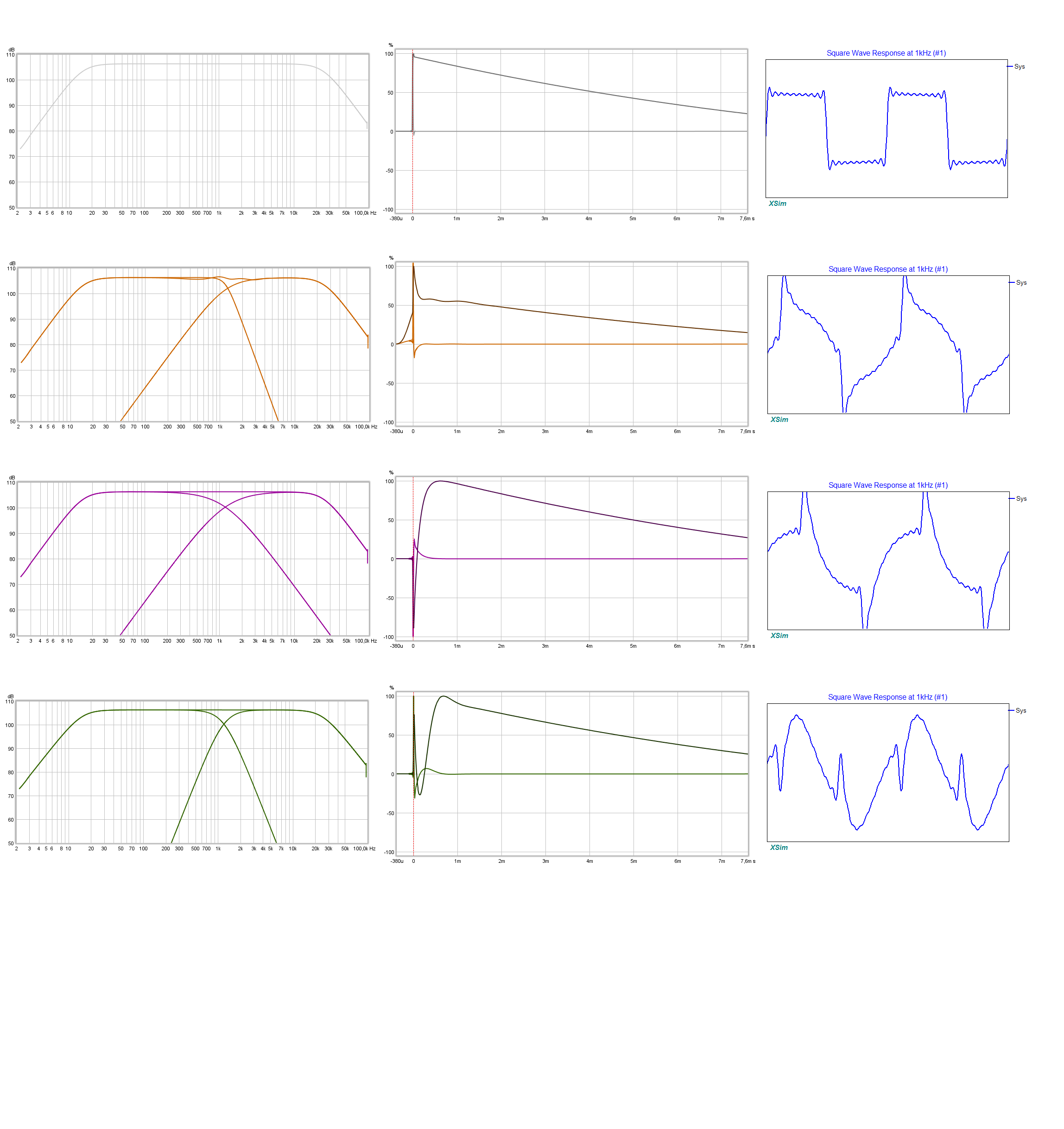

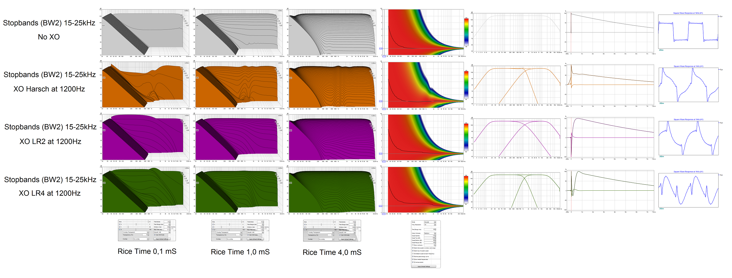

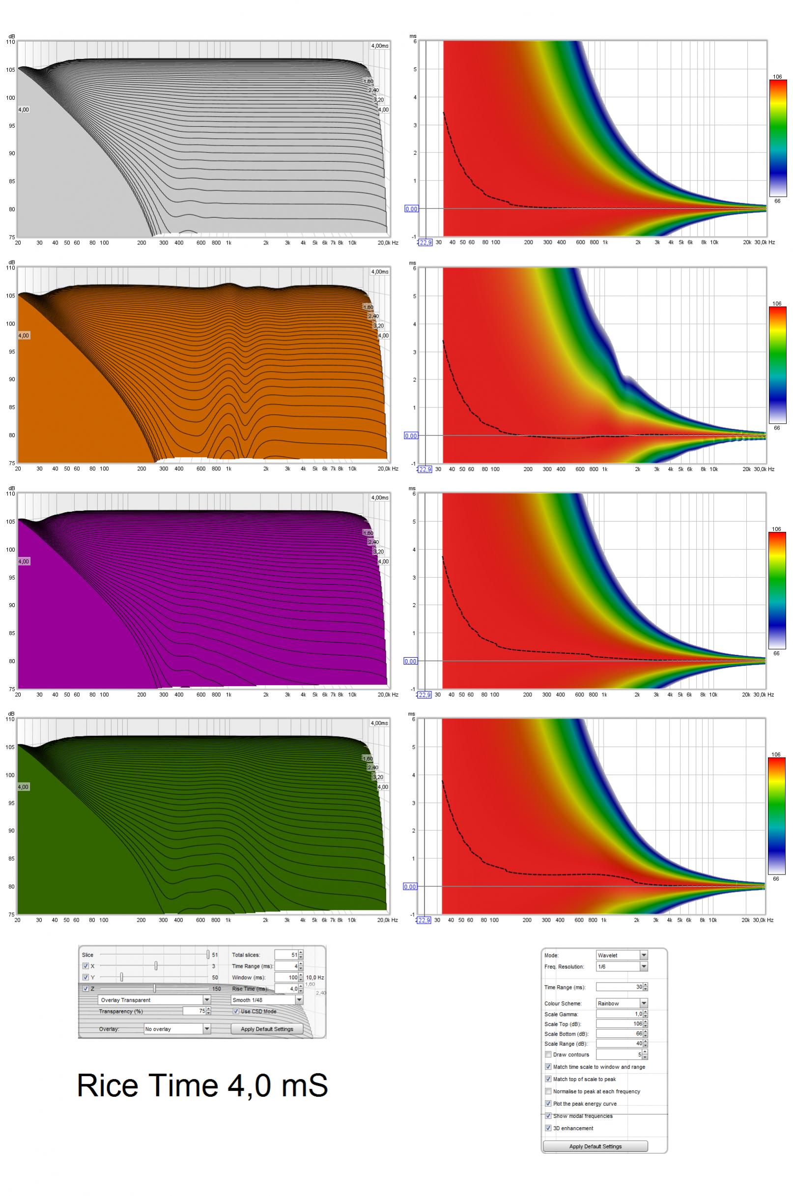

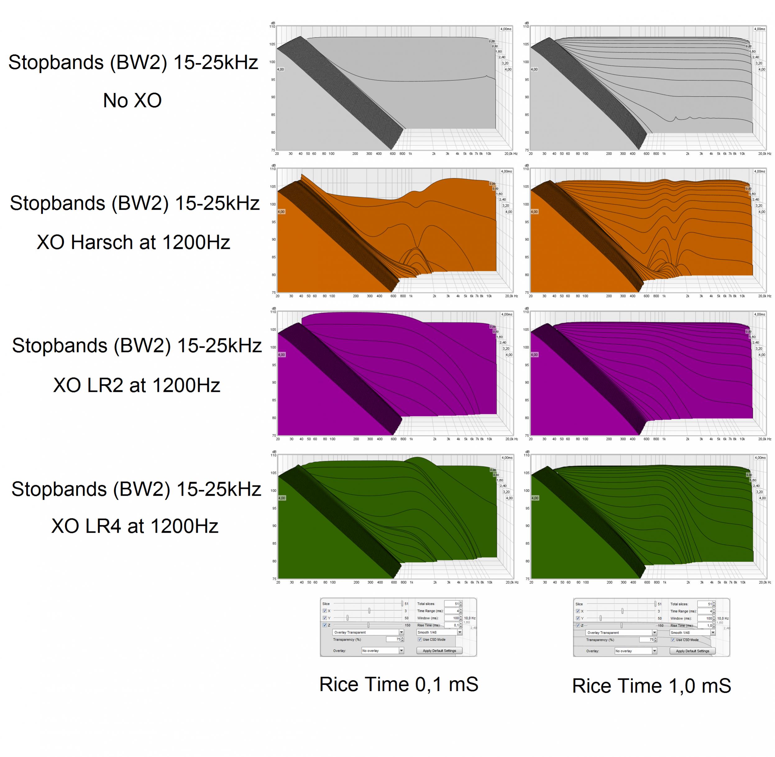

Great results with capacitor, that waterfall is a bit clearer below 2kHz is probably because at very low frq not seen in frq plots capacitor setup has a little bit more extension also indicated by phase trace direction in post 112 phase plot, ringing tail in that frq area coursed by slope cut off will go away later when midwoofers extend bandwidth even lower.
Mayby below minimum phase system examples is interesting data related this thread, files size did grow so to see full resolution had to split up therefor picture 1 is same as 2/3/4.
Indeed interesting, always nice to have you on board for these kinds of data.
