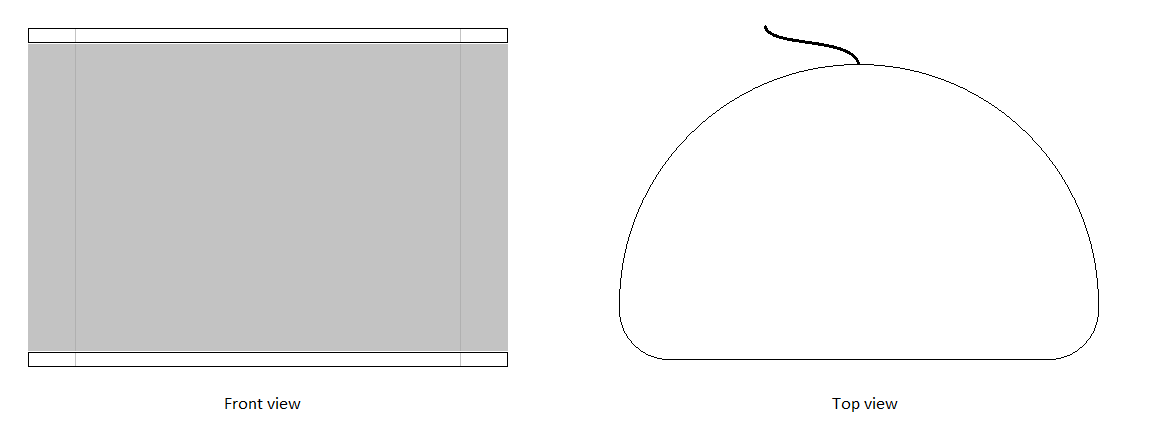

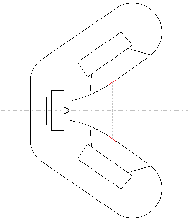

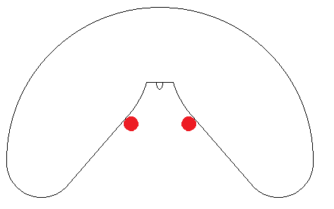

A first sketch:
Inside. The woofers are Faital Pro 8FE200.
Outside view.
The size is about 50 x 35 x 30 cm (W x H x D, 20" x 13" x 12"), i.e. a quite compact synergy.

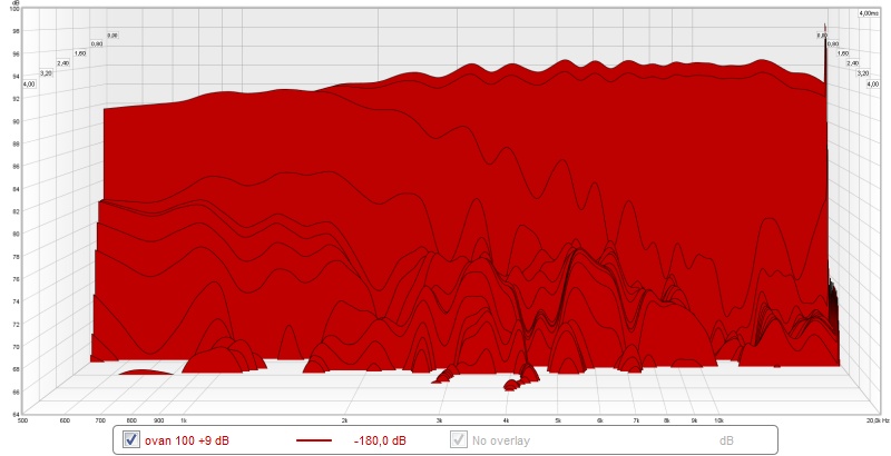

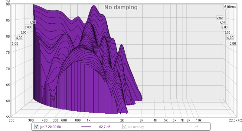

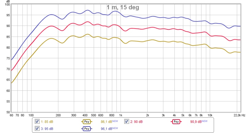

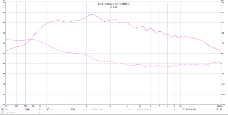

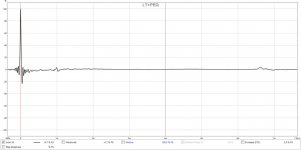

These are the horisontal polars of the R2604 in an early waveguide (210x130x85 mm):

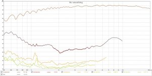

Measured waveguide (the brown one).
On axis, with phase.

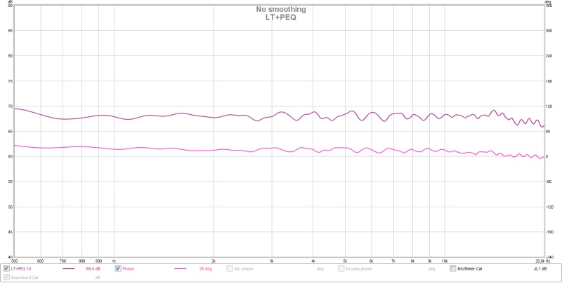

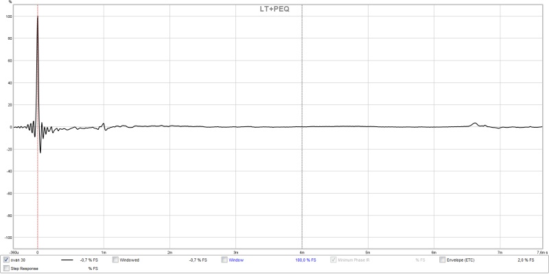

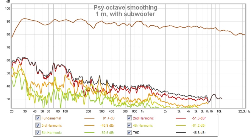

On axis with PEQ and LT.

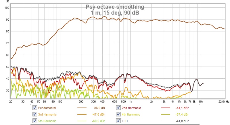

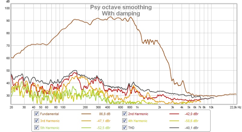

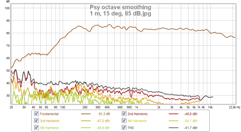

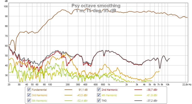

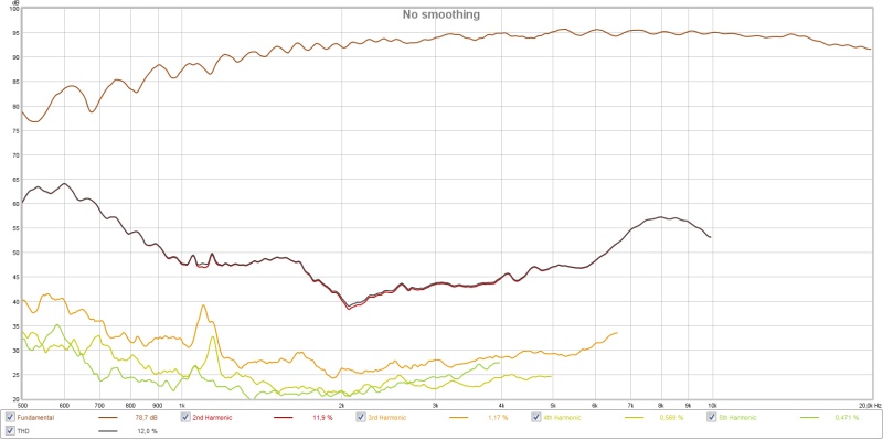

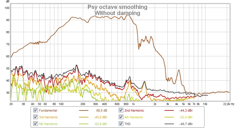

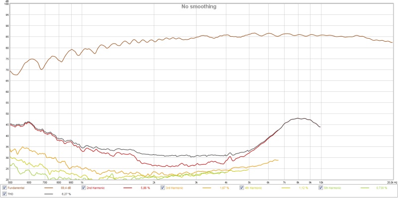

Distortion at 85 dB with 1.2 kHz bessel (for Harsch XO).
Distortion at 94 dB with 1.2 kHz bessel (for Harsch XO).The R2604 should be better loaded in the bottom end with a 50 cm wide waveguide (synergy horn) and that should reduce the distortion to enable a 1.2 kHz crossover and 95 dB maximum level.

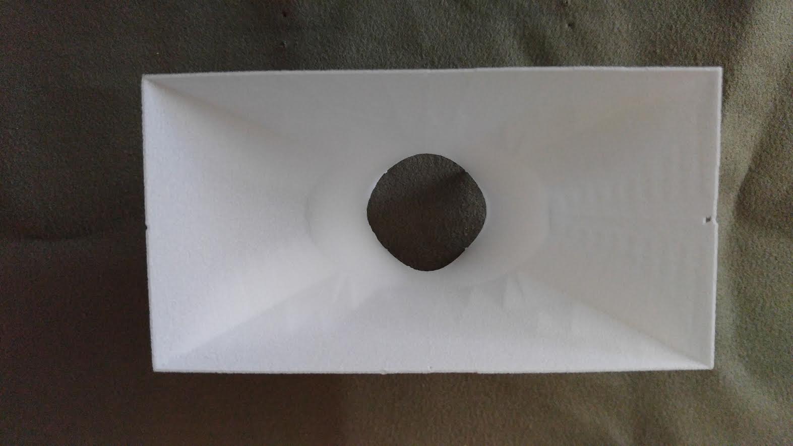

The plan is to 3D-print the first part of the horn (throat) and then use wood for the last part.

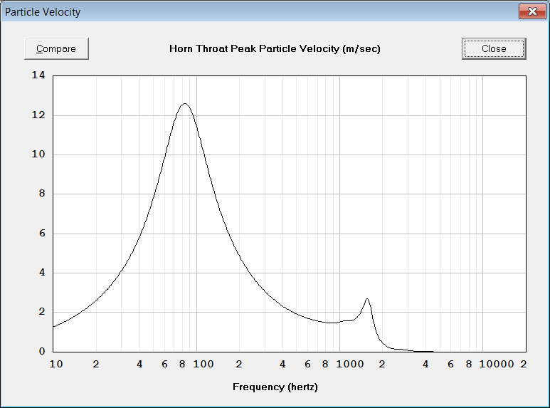

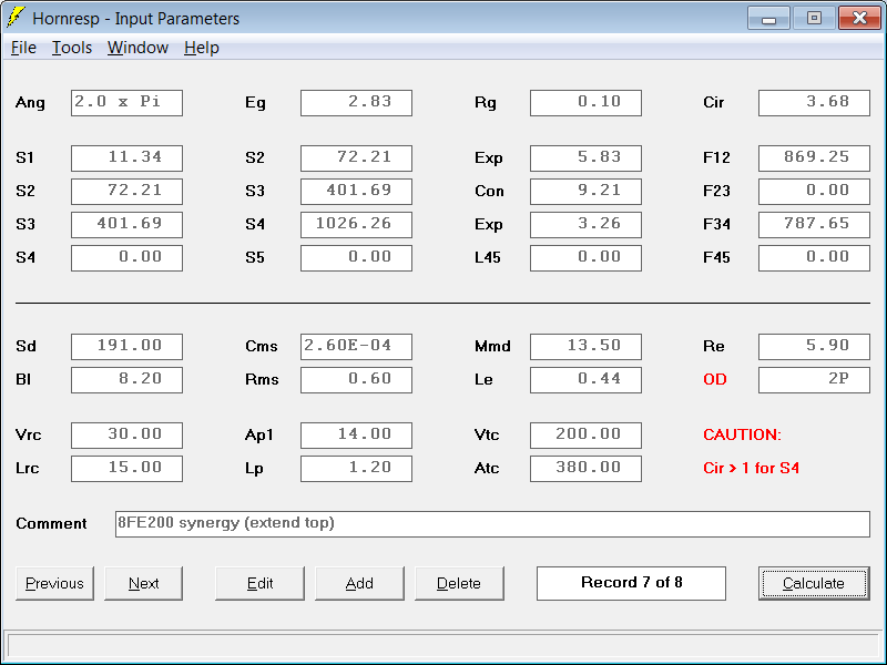

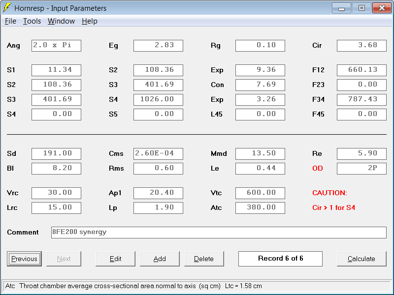

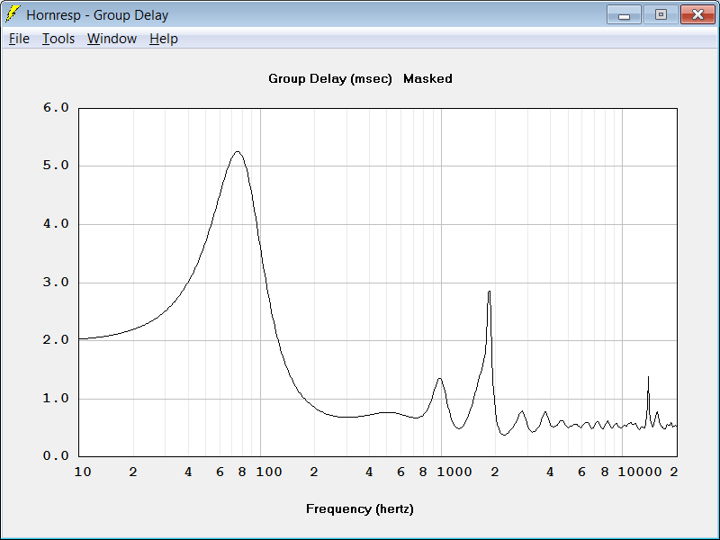

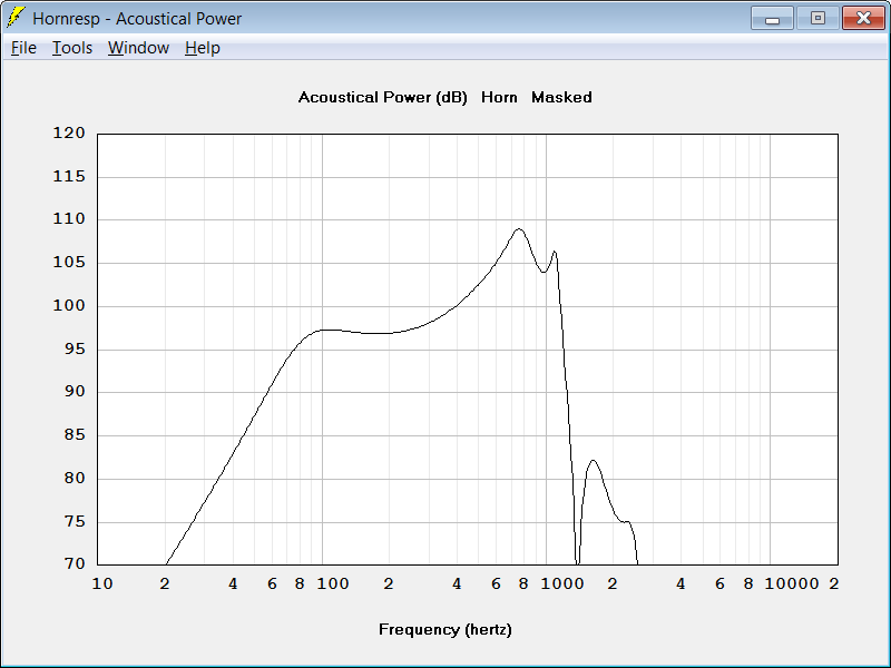

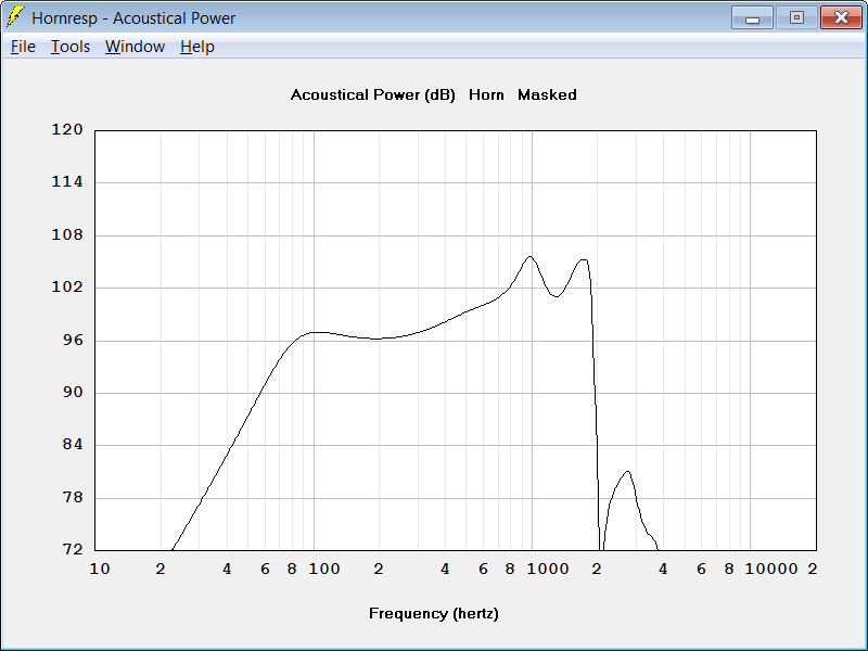

I'm quite new to Hornresp, but have tried a little:
Throat velocity (separate model) is 9 m/s at 2.83 V and diaphragm displacement is 1 mm. I've used 2 x 1" holes for each woofer in 19 mm MDF using minimal volume filler (measured the Vtc for the woofers at 350 ml).
The plan is also to have a leaky supercardioid setup for the woofers to stretch the directivity of the speaker down to below 200 Hz.
I'll post 3D-models later to show what I plan to print 🙂

A first sketch:
Outside view.

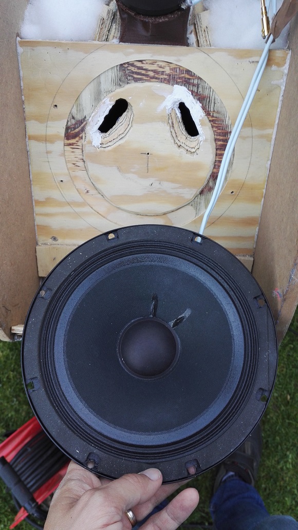

I struggled mightily to make 8FE200s work in a 2-way synergy. I could get response out to 1.3 Khz (using a volume plug) but no matter what I did, I had a null around 900 hz. The configuration that minimized this null was with no enclosure around the back of the 8Fe200s and with those drivers draped with absorption. That was how I prototyped it but my celebration was premature.
Like you, I was trying for a small, tight box for each 8FE200, just big enough to fit the magnet and with the back wall of the box parallel to the horn wall. My conclusion was that reflections from the back wall were arriving 180 degrees out of phase at the port through the horn wall and cancelling. Others have shown successful use of the 8FE200 in larger enclosures. My advice is make sure you have enough space behind the drivers for enough absorption to absorb the back wave at the resonant distance.
Good point! I'll probably need to print volume fillers as well. One upside of using the R2604 is that the membrane is in the horn throat and not deep inside a driver, so the notch from the reflection should be high in frequency.Nice. 🙂

I'll print the throat, maybe first 7-8 cm.

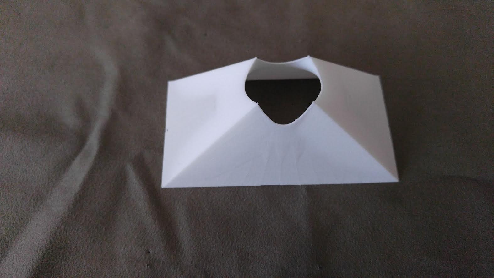

re' just printing the throat

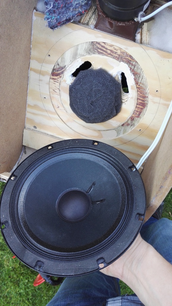

I've done a rectangular wooden conical horn synergy with a square throat from BWaslo's spreadsheet. I did the round to rectangular conversion with modelling clay like most others. Unsatisfied with this and inspired by XRK's thread I just 3D printed an insert for the horn that does that conversion much more smoothly than I did with clay. Now I've got to scrape off the clay and slide the adapter back into the throat in its place and measure to see what improvement I got.
I think this insert approach is easier to execute than joining a wood section to a plastic printed section, provided one is comfortable working with wood in the first place. The hard part, for me at least, was doing the CAD for the adapter and prior to that, choosing an appropriate profile. I did this in Sketchup and generated the shape heuristically rather than mathematically. It looks a little rougher than it actually is or I would like but is at least a proof of concept. I just exported STL from the Sketchup drawing and sent it and $30. off to "Sculpteo". I felt very lucky when I got the piece back a few days later.
Some pictures below. The adapter is roughly 2" by 3.7" by 1.5" for a 90x45 horn. The third image is the google file itself showing the adapter in the horn. It ends about .5" short of the mid ports with final thickness of perhaps 1/32".
Alright, I'm going for a leaky cabinet and maybe there is a point in putting the vents directly behind the drivers.I struggled mightily to make 8FE200s work in a 2-way synergy. I could get response out to 1.3 Khz (using a volume plug) but no matter what I did, I had a null around 900 hz. The configuration that minimized this null was with no enclosure around the back of the 8Fe200s and with those drivers draped with absorption. That was how I prototyped it but my celebration was premature.
Sure looks easier! My approach will however be very sensitive towards shape of the throat as the wave is in no way flat when entering the horn compared to a (good) compression driver. The R2604 is however quite light, which should make the connecting easier.re' just printing the throat

This is from a simulation I've done of a WG that should perform better than the one I've measured:
Simulated result:
Constant directivity from 2 kHz to 10 kHz. The low end should improve with a larger WG.
/Anton

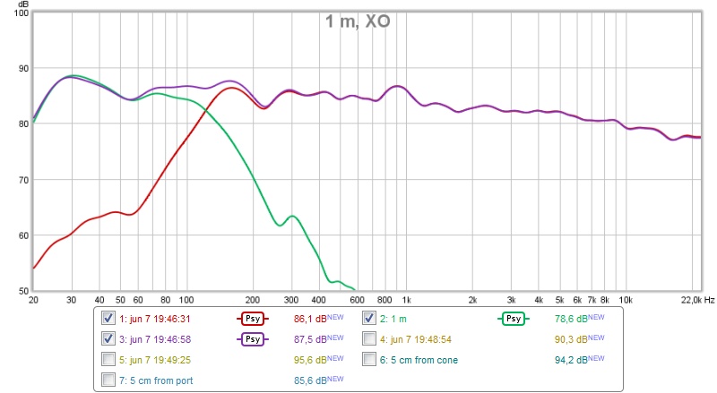

New hornresp attempt

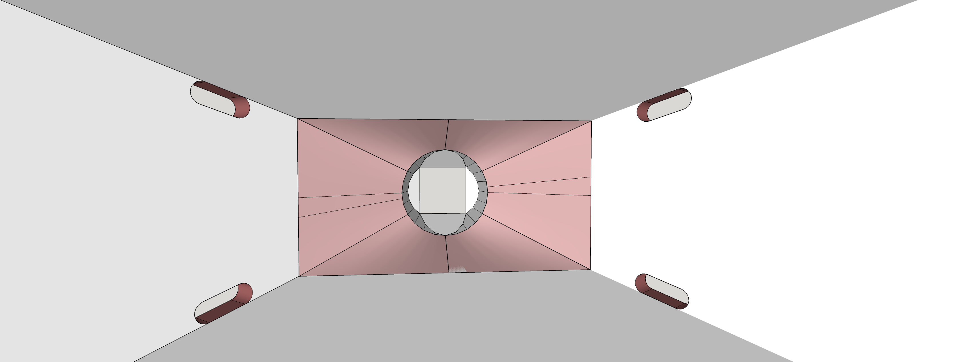

I tried to get the response for the 8FE200 up to 2 kHz and arrived here:
I've assumed that the throat adapter only needs to be 5 cm long. I also reduced the holes to 21 mm diameter (from 25.4 mm). Looks like this:
Probably even better to make them oblong from diffraction point of view, but that reduces the possible length of the throat adaptor.
Another possible look:
/Anton
/Anton
that looks very doable. You wouldn't get the same results using a compression driver, because, as you said, you'd have to add perhaps another 3 cm to the reflection distance. The L12 on my 8FE200 proto was 2.25" which suggest that your 5.8 cm is practical.
I noticed in doing these horn response sims that if, for example, you changed both your "Ap1" and "Lp" parameters to half the values in your posted model, you would get the same results - both for the frequency response curve and the offset throat particle velocity. If you can thin out the horn wall at the port location (e.g. frustrumize), then you can use a smaller hole and thus better polars If one takes this to the extreme, you end up with an extremely thin horn wall and an extremely small hole. What is the catch?
One thing I wanted to ask given your comment about the shape of the wave entering the horn from the ring radiator tweeter - are you able to model that so as to accurately predict the polar response of the horn driven by that tweeter?
An extremely thin horn wall would imply a larger VTC (volume of throat chamber). The VTC needs to be filled to reduce it's volume to raise the mid driver's upper cut off frequency high enough for the tweeter to not run out of excursion in it's lower range.If you can thin out the horn wall at the port location (e.g. frustrumize), then you can use a smaller hole and thus better polars If one takes this to the extreme, you end up with an extremely thin horn wall and an extremely small hole. What is the catch?
Interesting find indeed! I had to do a control myself cause it seems weird, a smaller hole should result in higher particle velocity.that looks very doable. You wouldn't get the same results using a compression driver, because, as you said, you'd have to add perhaps another 3 cm to the reflection distance. The L12 on my 8FE200 proto was 2.25" which suggest that your 5.8 cm is practical.

Well, I'm trying as apparent in the 3D-printing thread (starting at post 174 here).One thing I wanted to ask given your comment about the shape of the wave entering the horn from the ring radiator tweeter - are you able to model that so as to accurately predict the polar response of the horn driven by that tweeter?
Here is comparison of measured and simulated horisontal polar response for the brown WG:
I discuss sources for discrepancies in the thread.
Hopefully I can make a model of the synergy later.
/Anton

. if using a volume plug you may end up with a longer port length and need a larger hole.
Have you tried using the Multiple Entry Horn Loudspeaker Wizard to simulate the complete system rather than just the offset drivers? See the Hornresp Help file for details.

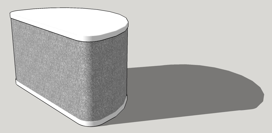

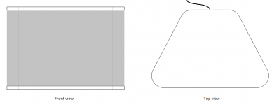

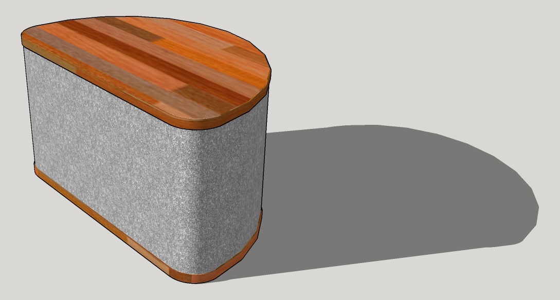

Sketchup model
Played around a little in Sketchup. Outer dimensions are 50 x 28.2 x 30 cm and the waveguide mouth is thereby 40 x 25 cm.
I'll make a model of my media console to see how it looks later.
/Anton
/Anton

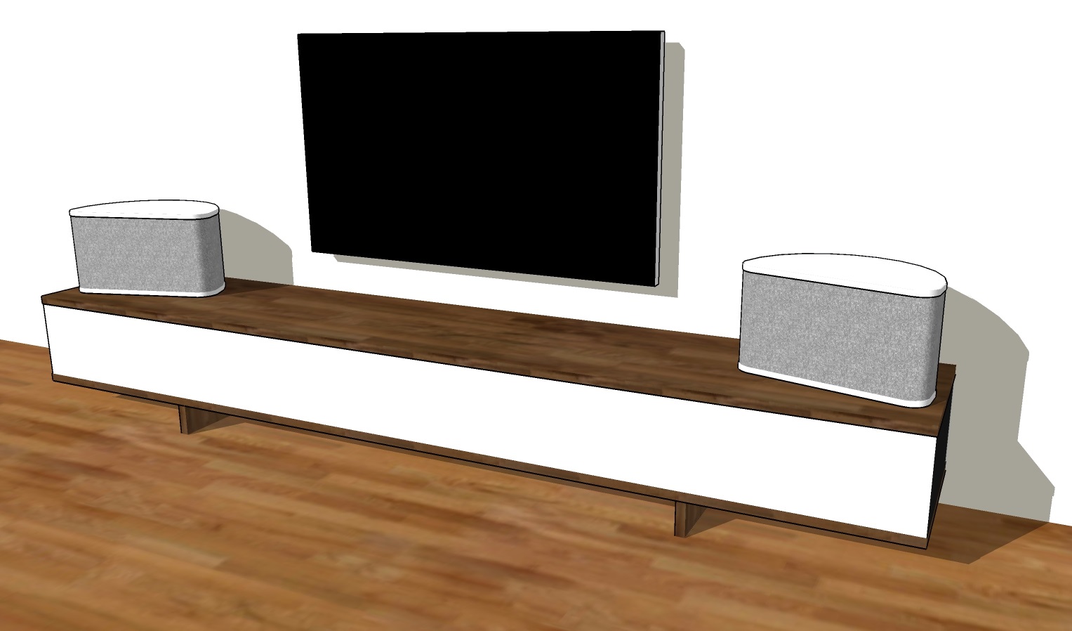

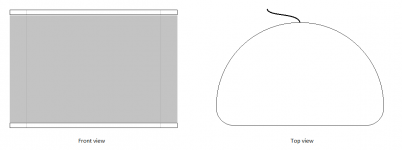

More sketchup
Here's how it would look on my media console (290 x 40 x 50 cm, W x H x D):
Showed this to my SO and she was surprisingly positive! I think I could make these in a way that she would let them in to our living room 🙂
I probably need to come up with some kind of feet to angle the mouth upward (towards ear-height while seated).
/Anton
/Anton
