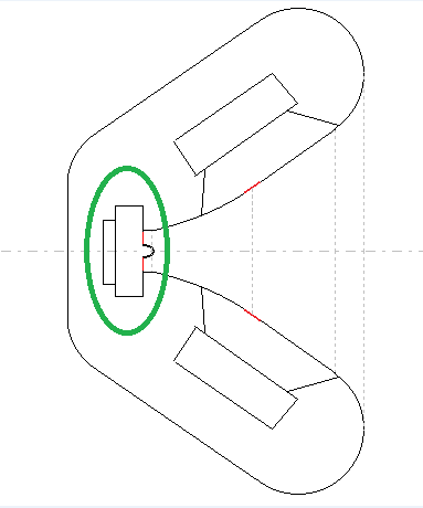

I think it looks doable, the design is probably slightly stretchable without affecting looks.Nice looking design Onni. It's got a certain 1970's aesthetic and I mean that in a good sense. Very clean lines. A lot more WAF friendly than my rectangular box with a black baffle. I hope you can stuff all that into that little box. Those 8FE200's have a much larger bezel diameter than the smaller DC200's I used. I know I sure had a tough time fitting mine into a 46cm tall x 28cm wide x 33cm deep. This was using the Faital Pro LTH142 waveguide.
http://www.diyaudio.com/forums/multi-way/285030-bookshelf-multi-way-point-source-horn.html
The 8FE200 is only 4 mm larger outer diameter than the DC200 (209 vs 204 mm). The bezel looks large, but that's mainly due to the cone being unusually small for an 8" woofer. It's also 5 mm lower (total height) than the DC200 which should be positive
/Anton

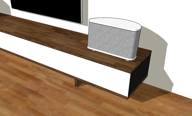

Played around a little in Sketchup. Outer dimensions are 50 x 28.2 x 30 cm and the waveguide mouth is thereby 40 x 25 cm.
/Anton

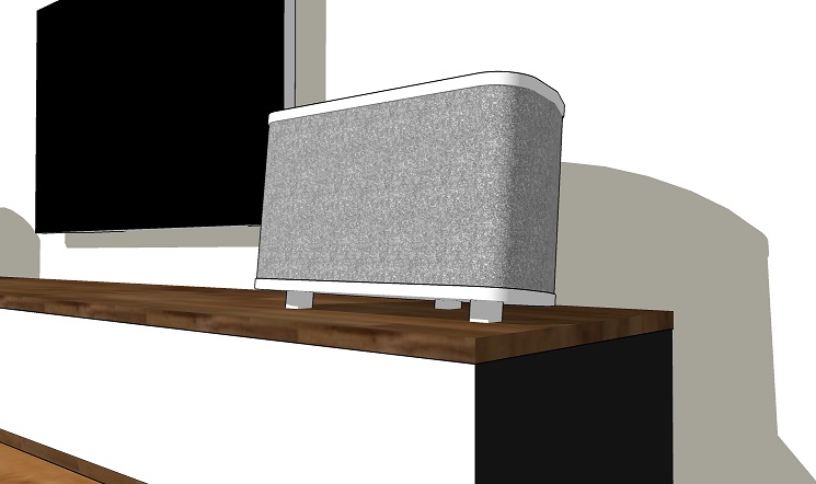

30 mm square legs
Tried adding the simplest possible legs, 30 mm squares. 45 mm long in front, 20 in back:
Looks decent for something so simple.

So aside from or including the layer of fabric, your wrap around is going to be flush with the top and bottom panels? So as to avoid diffraction? I'll be curious to see how you do this as I want to do this cabinet style quite badly.

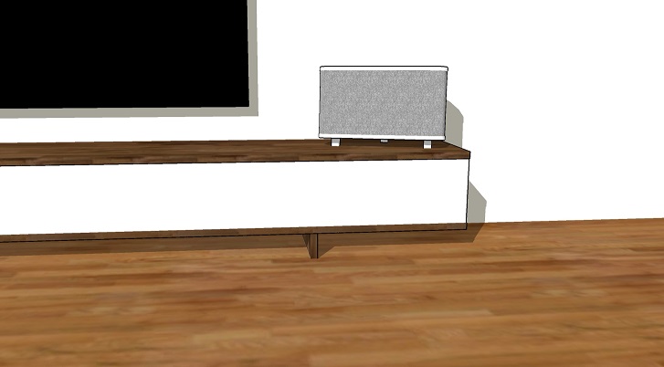

Here's how it would look on my media console (290 x 40 x 50 cm, W x H x D):
Showed this to my SO and she was surprisingly positive! I think I could make these in a way that she would let them in to our living room
Raise the TV just a little and make three!

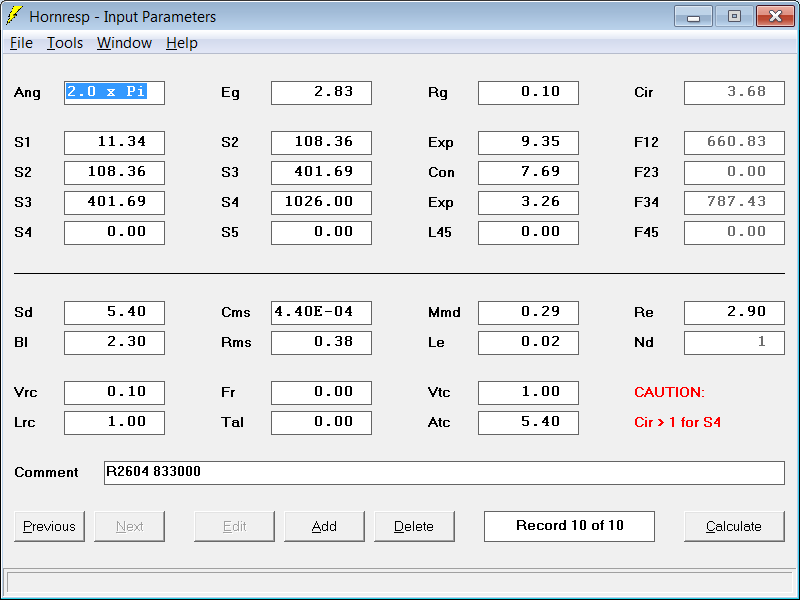

Alright, but how do I model this: R2604 833000?The OD option only simulates the two low-frequency offset drivers. The Multiple Entry Horn Wizard also takes the driver at the horn throat into account.
/Anton
Thanks!Great looking design Onni!

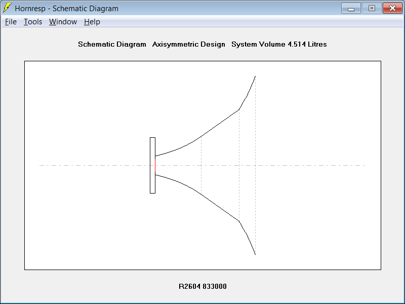

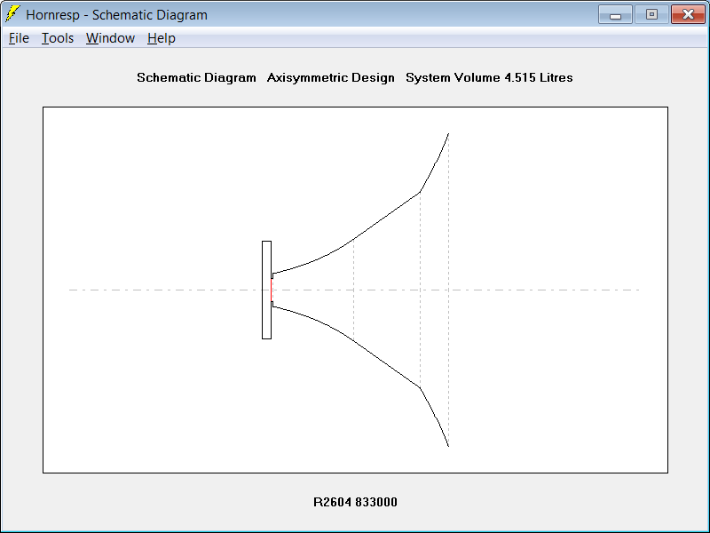

I tried modelling the R2604 in hornresp using the parameters from the data sheet. Please comment on how I've done!
The phase plug makes the schematic look a little weird as the Sd is smaller than the throat.

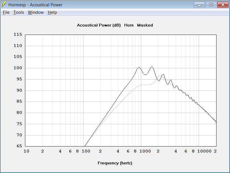

Displacement at 100 dB, 1 kHz is 0.19 mm which incidentally is just below Xmax (0.2 mm).
/Anton
From sweetspot:

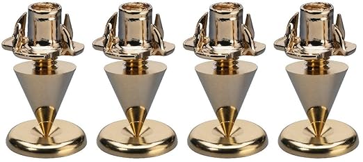

I'd use spikes, not because of the audiophile attraction but because of the looks! Very 70's in a good way.
I'd use stacked construction on the outer shape though. With a Router and template it's easy. It's not like you're building arrays .
By the way, love what I see in the CSD, very promising.. got to love those ring radiators...
Spikes is a nice idea, brass should work. Maybe something like this:I'd use spikes, not because of the audiophile attraction but because of the looks! Very 70's in a good way.

Maybe only in the front and a soft one (or two) like this in the back:

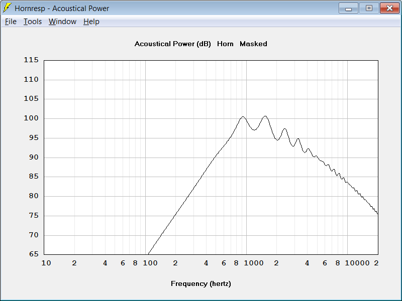

Comparison of 2.83 V into the proposed synergy and a model of the printed waveguide I've measured:
/Anton
It has full TS parameters - you could model it assuming a pistonic diaphragm rather than as a ring radiator as an approximation. This horn would be easy to model in Akabak (and probably HR now that it has a synergy like multi-tap injection feature) - and certainly Comsol should be able to do it - does Comsol take driver TS parameters?
- Synergy attempt without compression driver
