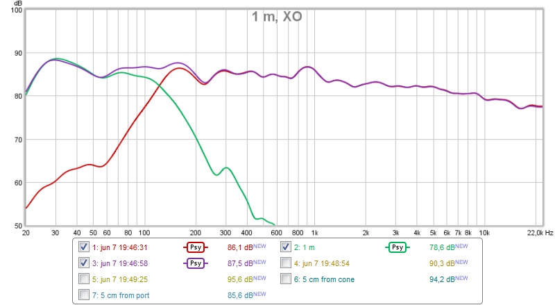

I've been listening outdoors with a subwoofer (8" Tangband W8-740P tuned to 27 Hz) and I'm blown away! Both by the sound and how obvious the high directivity is, even my SO was impressed 😀
Here's the XO between subwoofer and speaker:

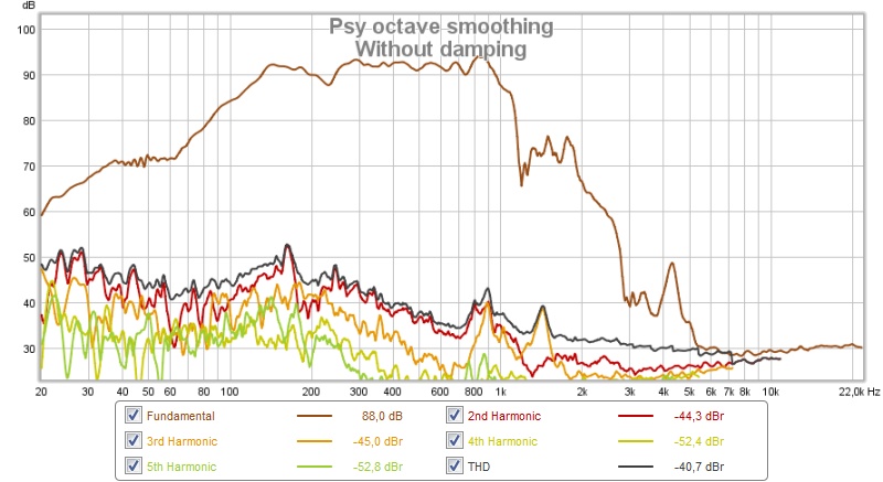

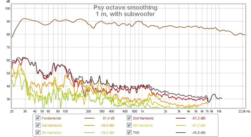

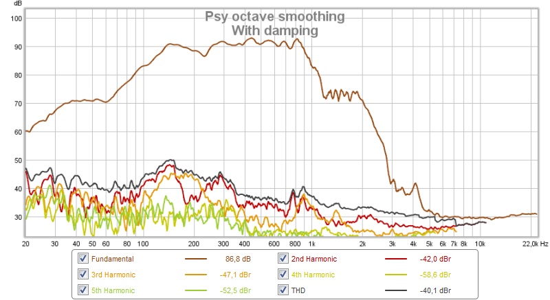

Distortion at ~90 dB which was the high level I listened at (otherwise at ~80 dB):

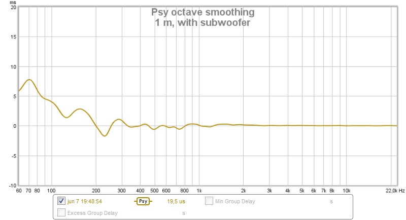

Here's a plot I haven't showed earlier, Group delay:

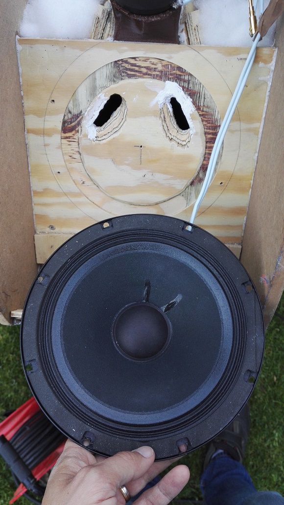

And I promised to show how the frustumized holes look like, so here's a pic:

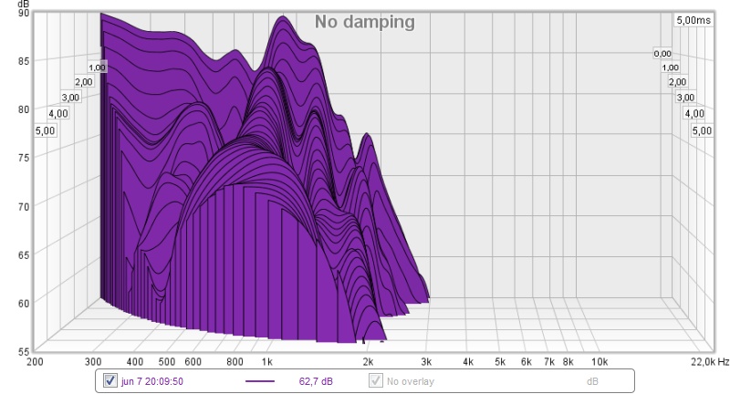

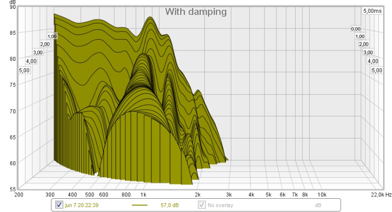

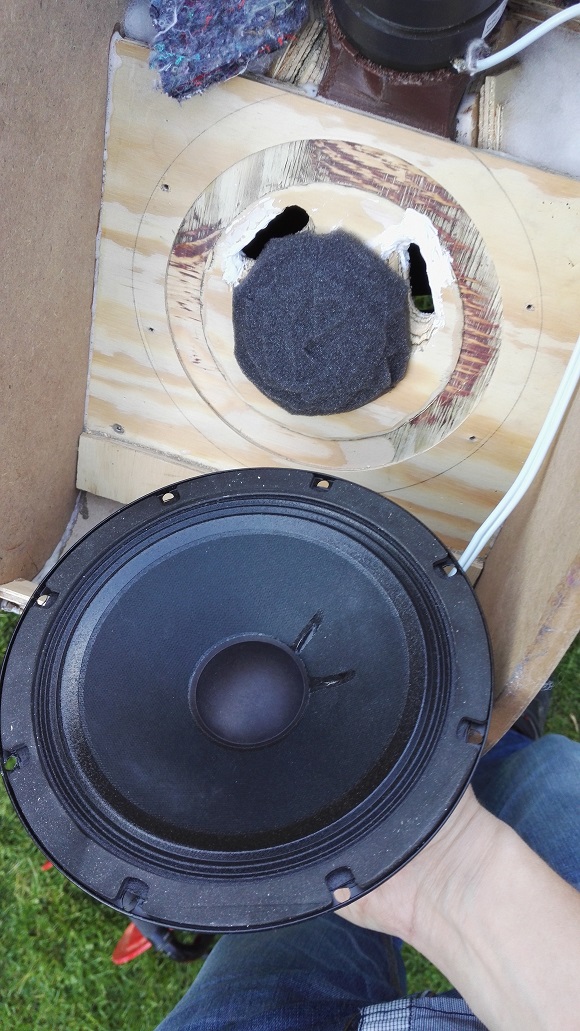

I read in Legis thread (here) that it could be a good idea to add damping in the front chamber (between cone and horn wall). So I tried that:
Here's woofer response without damping:
And here with the added damping:
No huge difference, the resonances outside the passband are slightly more attenuated and output around 1 kHz is also down a few dB. Maybe the volume that I can fill is too small to have any significant impact.

The damping does however seem to affect the CSD in a positive way:
No damping (0.5 ms rise time):
With damping:

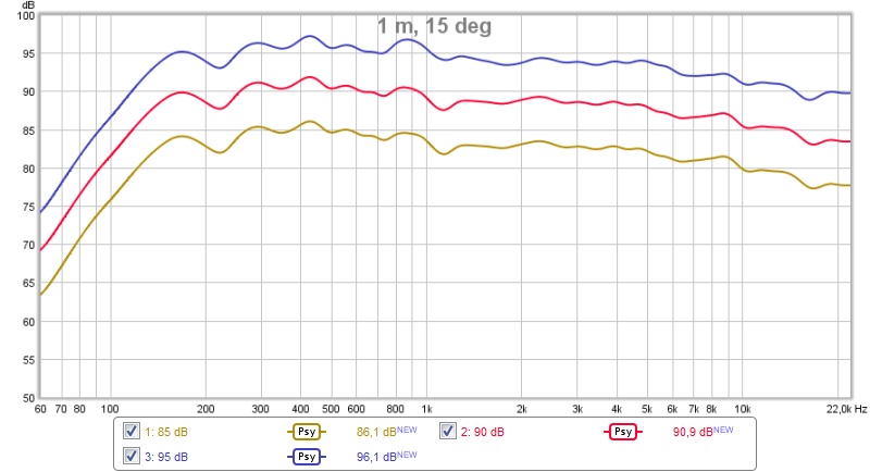

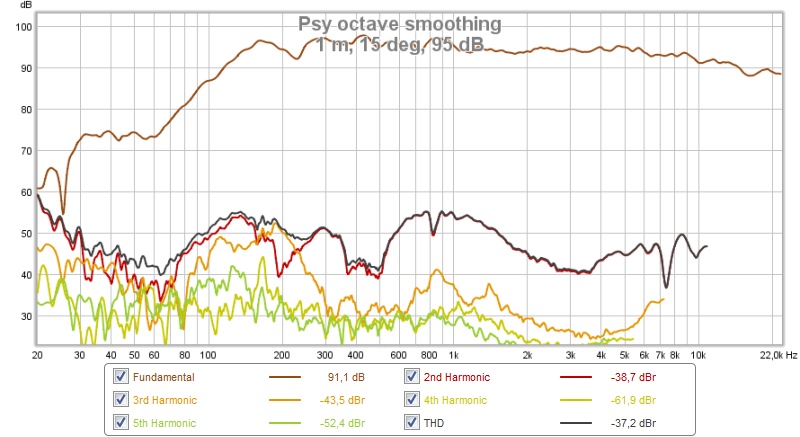

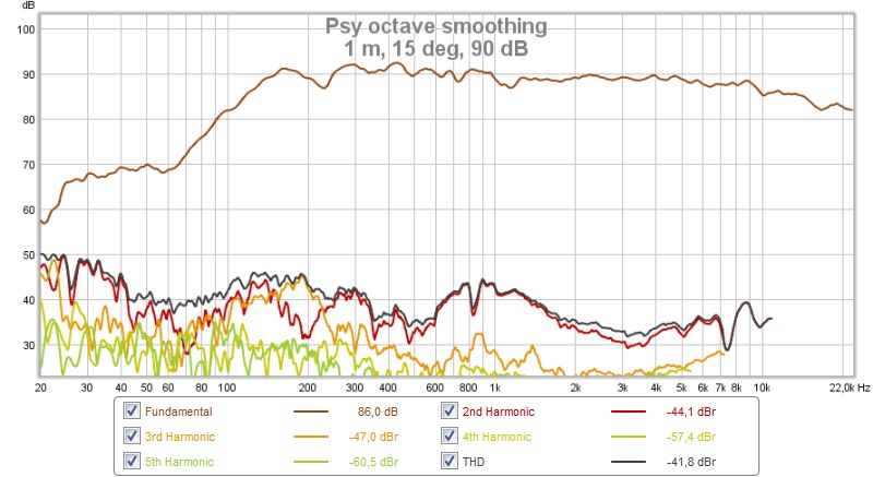

I felt like testing the linearity of the speaker so I measured at 85, 90 and 95 dB (1 m, 15 deg):
Looks good around these levels. Here's distortion for the three measurements:
/Anton
