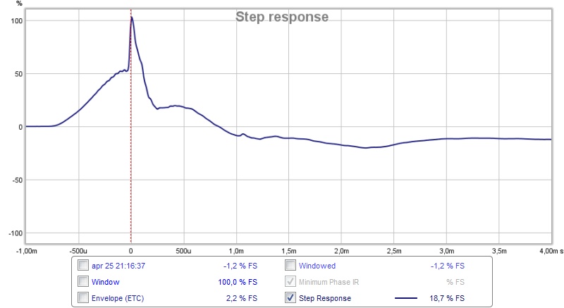

Can you show Step Response? That's the true test of a good Harsch XO.

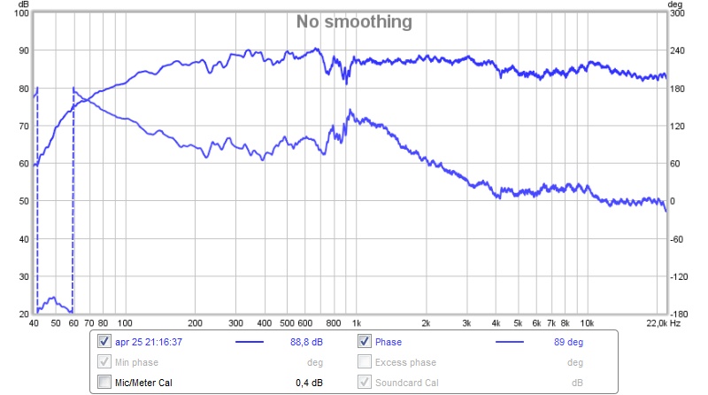

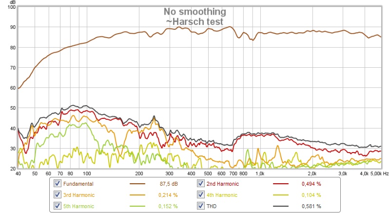

Thanks! I thought I was clever when I came up with the idea, but it was of course thought out by Linkwitz himself before me 🙂

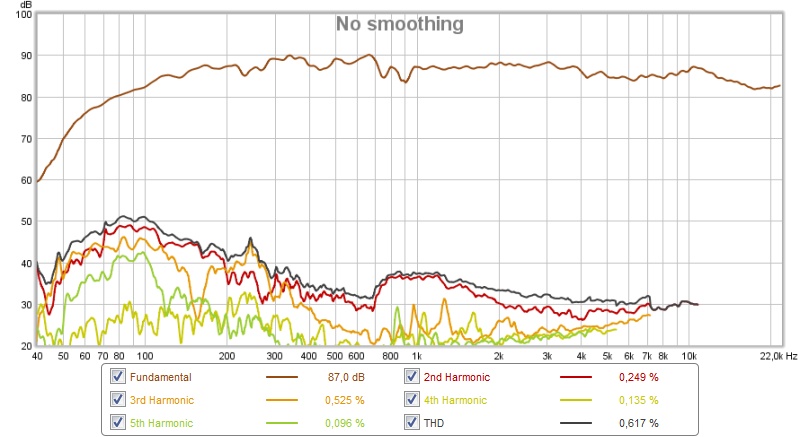

There is still some problems with the phase, the woofer seems to be lagging about 75 deg. It was a very quick and dirty XO. Here are the figures from 40 to 22 000 Hz:
Maybe I shouldn't be calling it Harsch as it's just setting the same level and adjusting delay until dip at XO disappears. The slopes are not at LR24 and Bessel.
/Anton

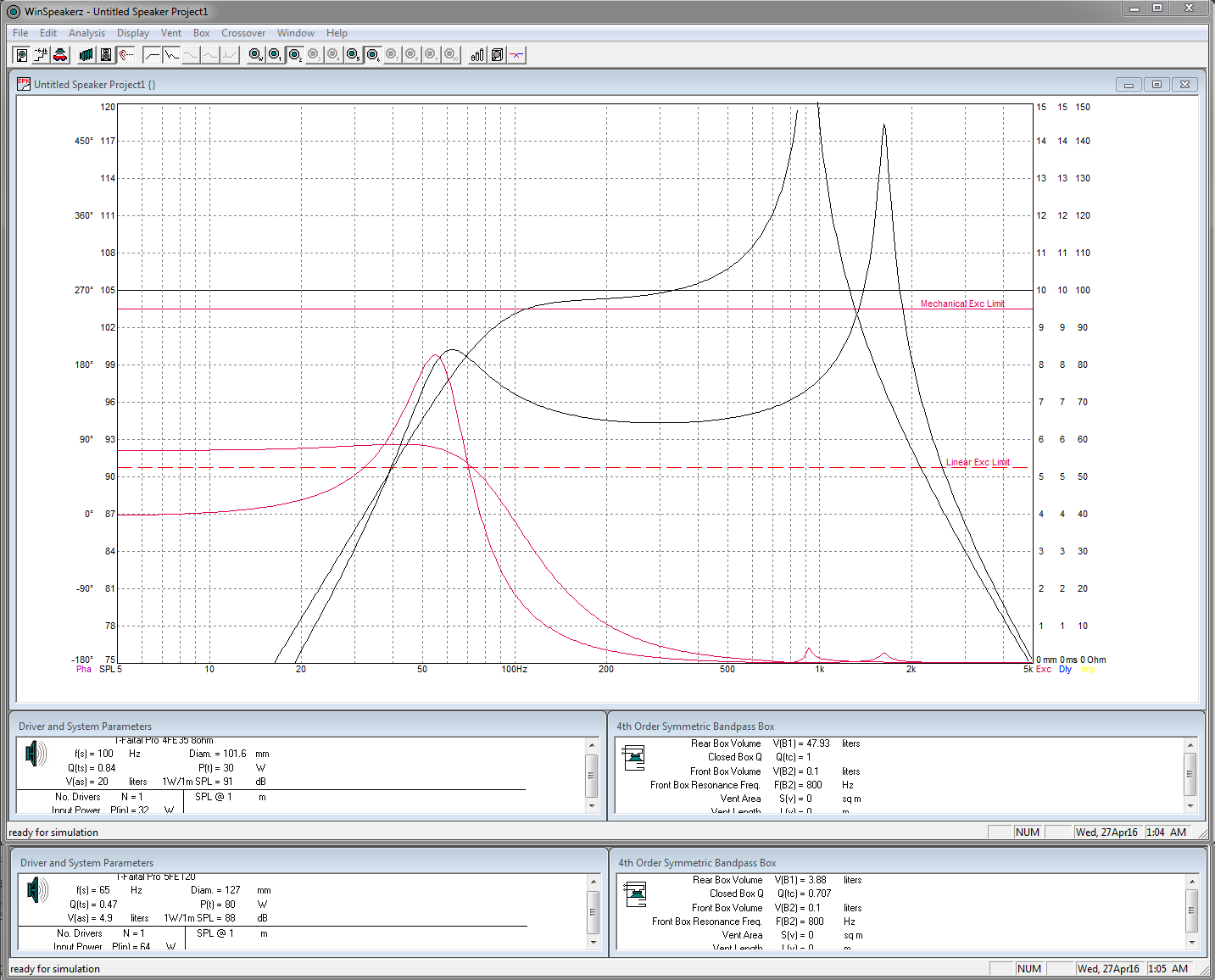

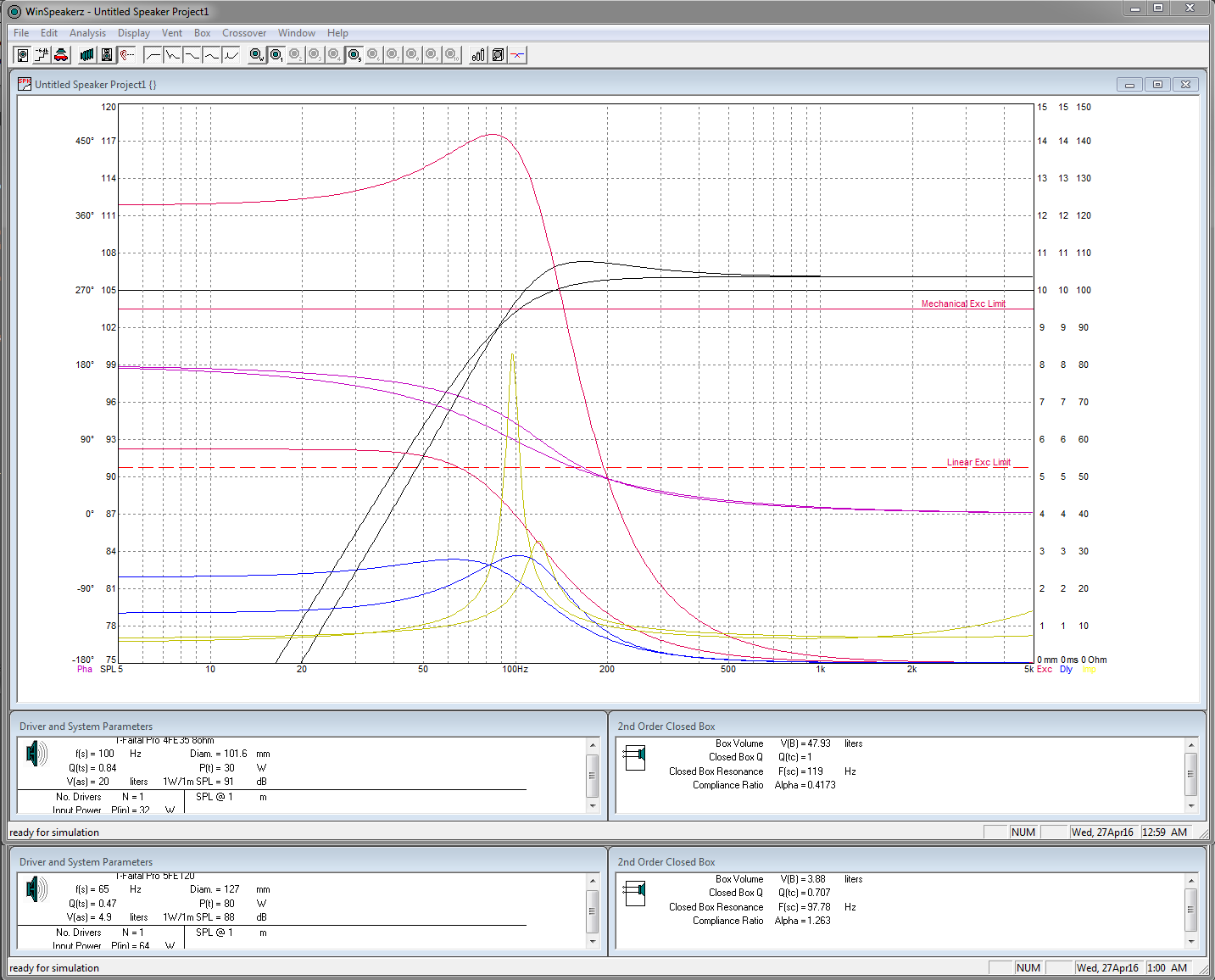

Nice sounds like you got them right trimmed to application and a good performer, Faital Pro looks like good stuff and look forward myself try Faital for first time. Think onni announced he go for 150Hz extension and seems 5FE120 can do it, has thermal power of 80watt Xmax of 5,25mm and Sd area of 79,8 sq cm, also some say for mid high Qms is superior and these have Qms of 7,4.
Below in a dirty quick sim setup is 8 ohm versions of 4FE35 verse 5FE120 sealed and also 4th order symmetric bandpass box, 4FE35 is feeded 32 watts and 5FE120 have 64 watt.

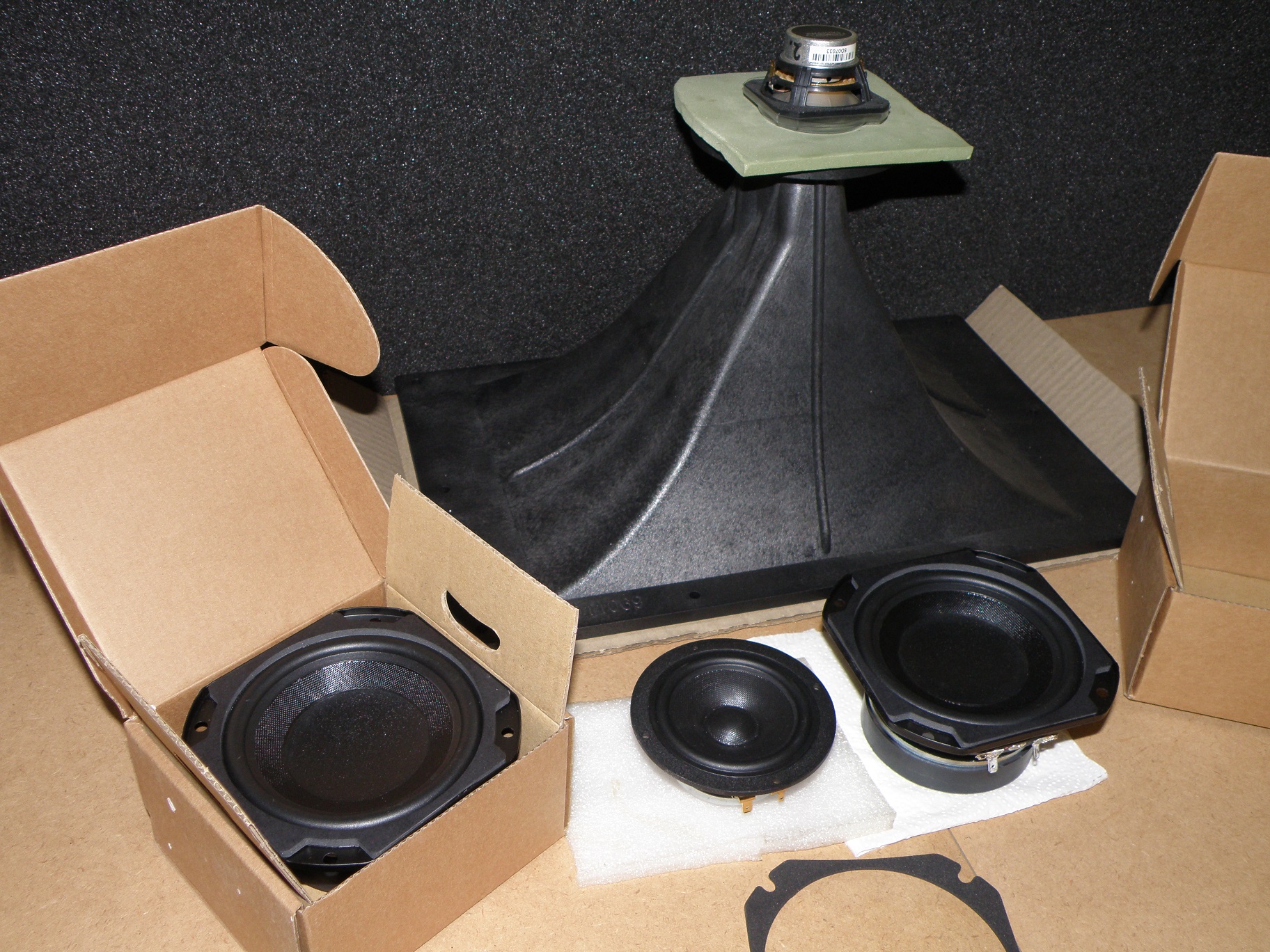

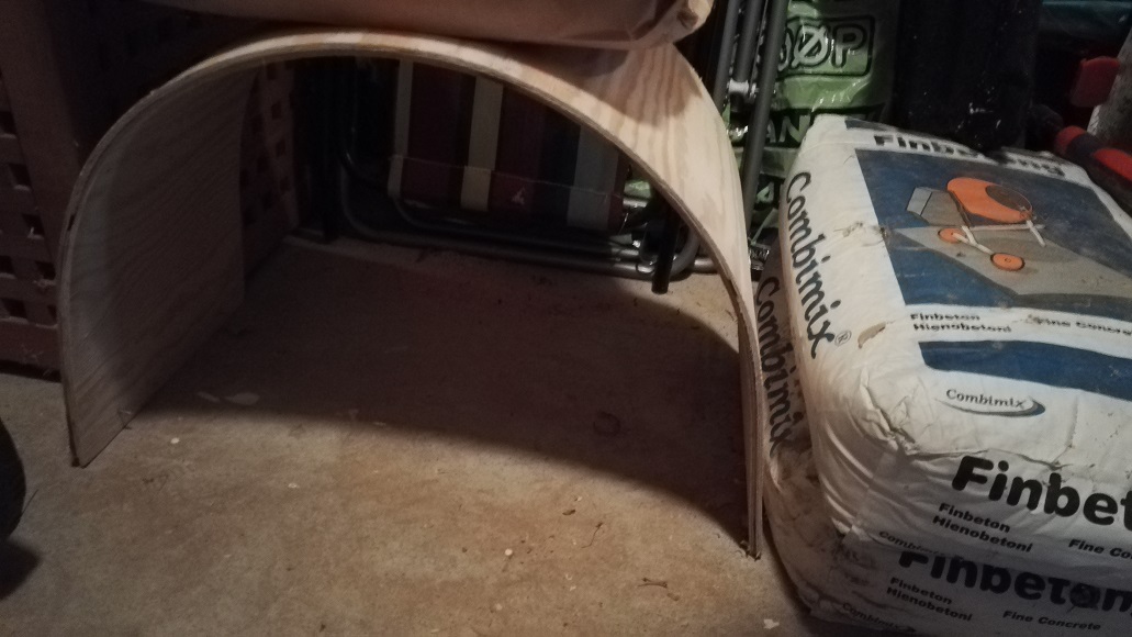

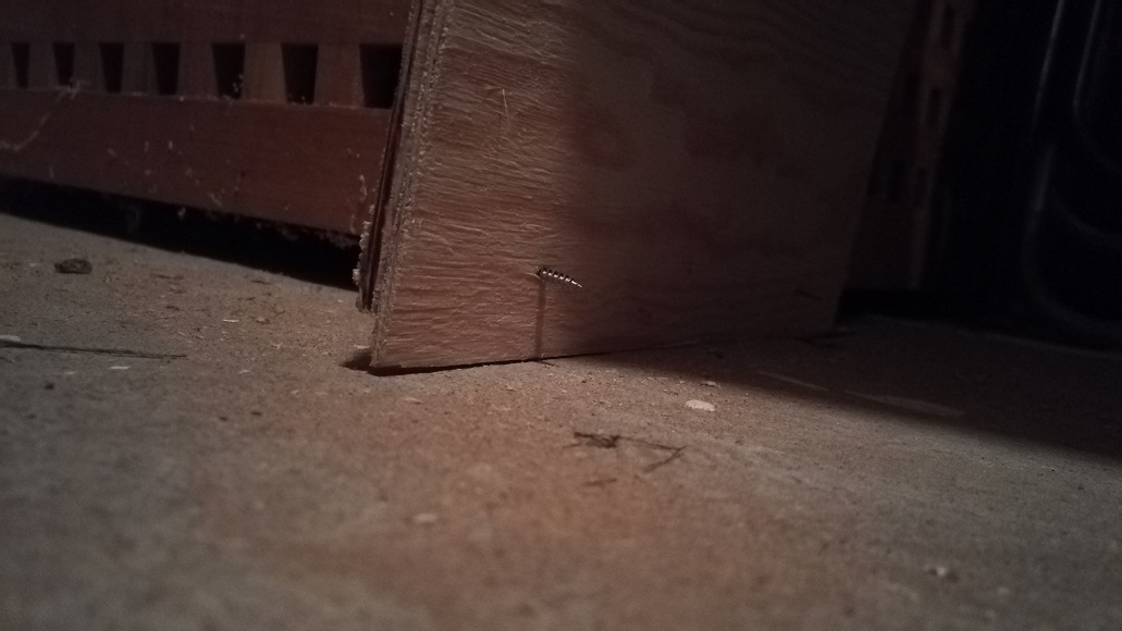

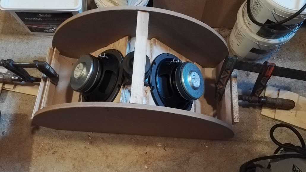

Here are a few pics from today's progress:
I'm gluing stiffeners for the edge of the cardboard. Will also be used to fasten the back panel.
Here I'm testing an idea I had about how to easily glue two (pre-bent) panels together. First I cover one of the panels with glue, then i screw them together at one end. Then I bend them slightly less (about 90° total angle) than final (about 180°) and screw the other end together. After this I bend to the desired shape which forces the surfaces together with some force. This should keep the surfaces in contact while the glue sets. I'm not sure the pressure will be enough though.
Close up of the screw holding the panels together:
/Anton

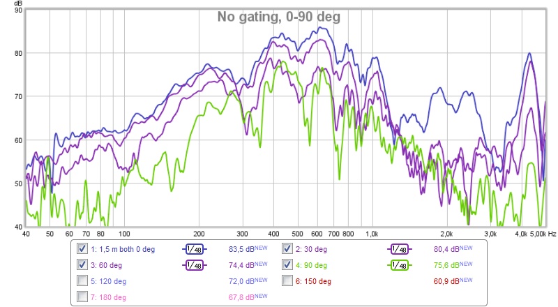

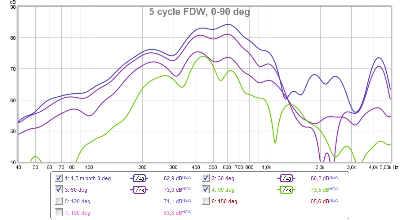

Polars for woofers
I measured some polars with both woofers attached and with a lot of damping behind them. 1.5 m distance (from top of phase-plug on R2604), 1.3 m from ground. Completely raw (0, 30, 60, 90 deg):

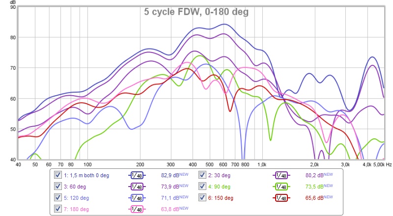

With a 5 cycle FDW (0, 30, 60, 90 deg):
547778d1462656193-synergy-attempt-without-compression-driver-5-cycle-fdw-0-90-deg.jpg
And all the way to 180 deg:
547779d1462656193-synergy-attempt-without-compression-driver-5-cycle-fdw-0-180-deg.jpg
0-90 is not bad at all, albeit a little uneven. I'll experiment with some PEQ and XO later.
/Anton

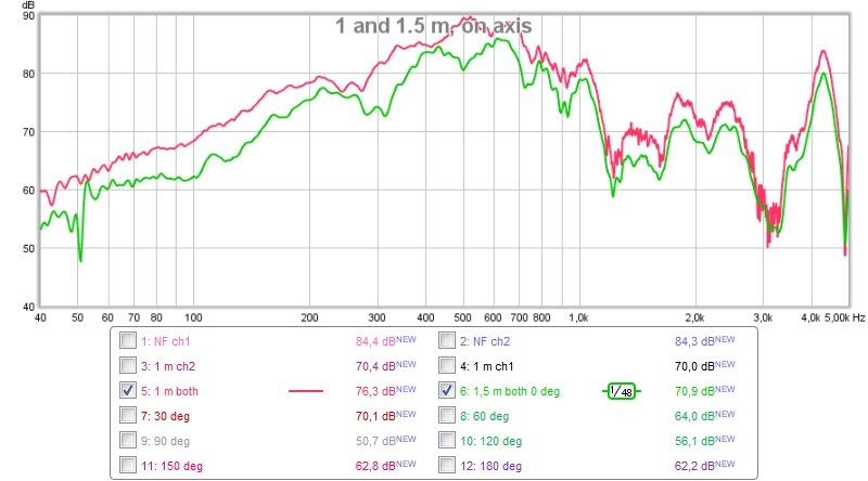

Is the distance from the bass injection port to the mouth 11 inches long? And is that the source of the 300hz dip? It's unusual because below 500Hz, woofer response from port injections usually pretty uniform for speaker like this. For example look at my bookshelf horn - the polars are uniform below 600Hz - omnidirectional basically.
528426d1454257077-bookshelf-multi-way-point-source-horn-sb65-lth142-eq-6thfdw-polar-vertical-big-holes-repaired-10db-scale.png
Anyhow, good progress but now comes the debugging phase.

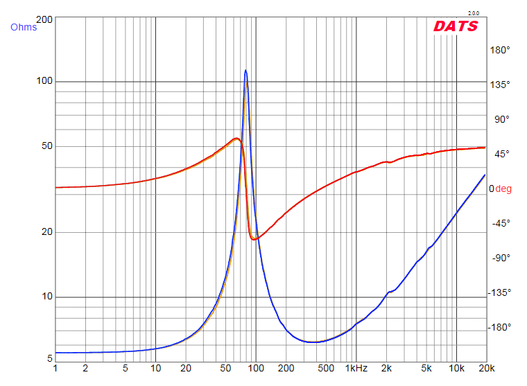

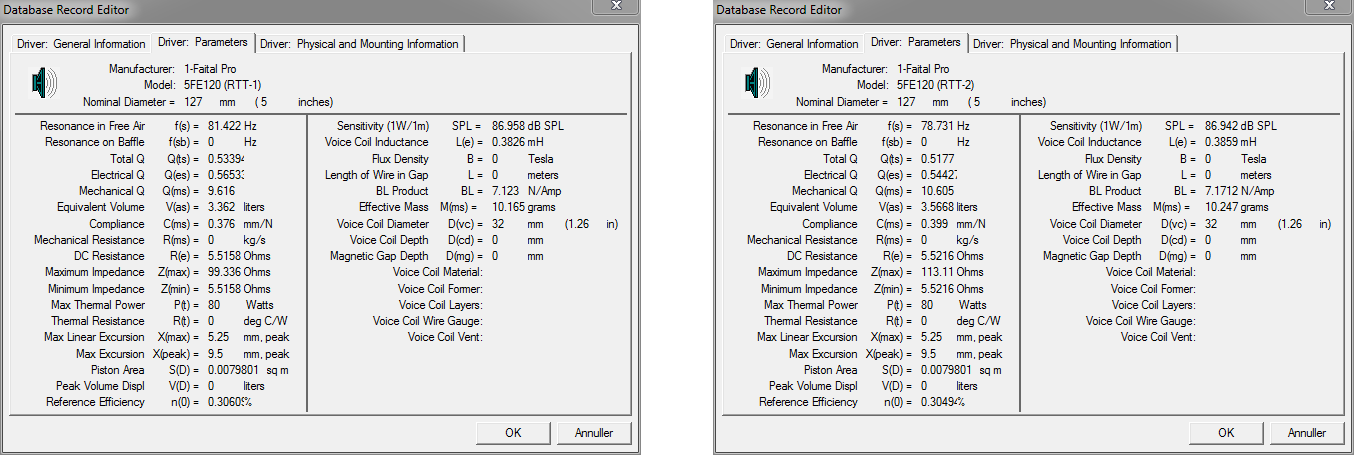

Thanks sharing build progress it looks good, your 8 inchers looks better now but should need any data down the road i just got 2x 5FE120 for trials, so far brand new without break in (relative high fs) had a run with DATS but you welcome request data how they perform behind a bandpass port.

The 300 Hz dip seems to be ground reflection. Here is measurement at 1 and 1.5 m:
Closer=larger difference between direct and reflected sound=first dip at lower freq.

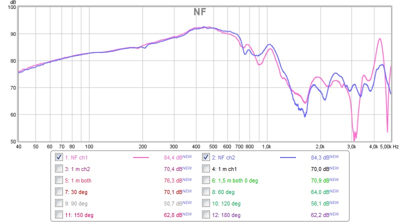

Maybe I should try to raise the speaker even higher for the polar measurements to reduce influence of ground reflection. How did you do it? The woofer setups are slightly different (more routing done on one and slightly larger BP-holes). This is the difference between NF-measurements:
