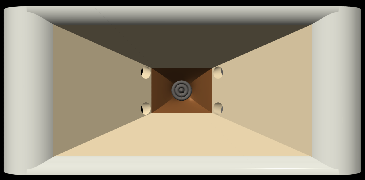

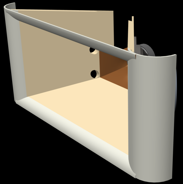

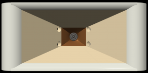

CAD

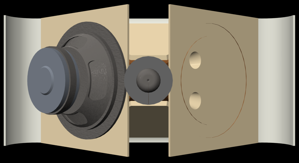

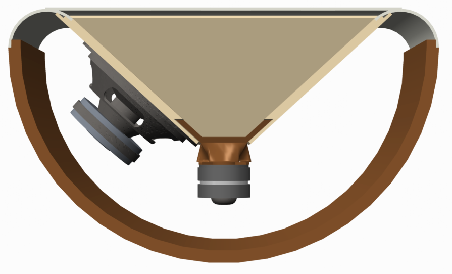

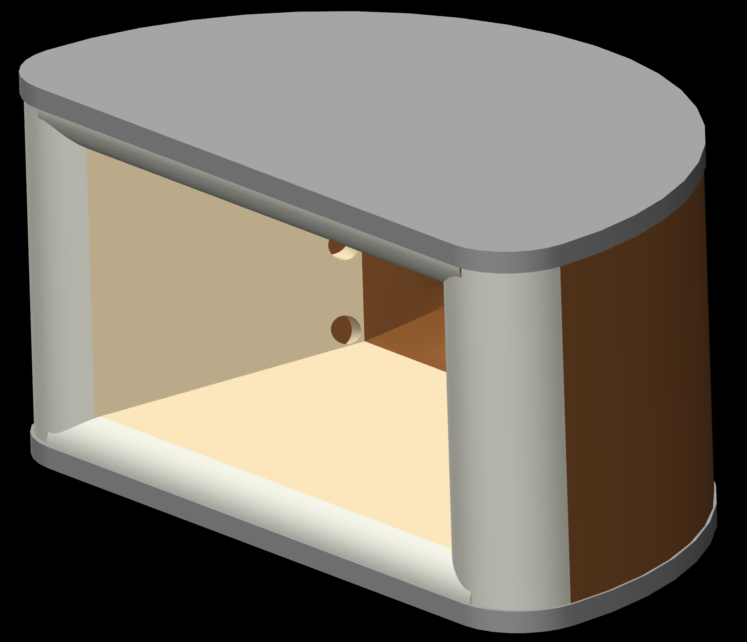

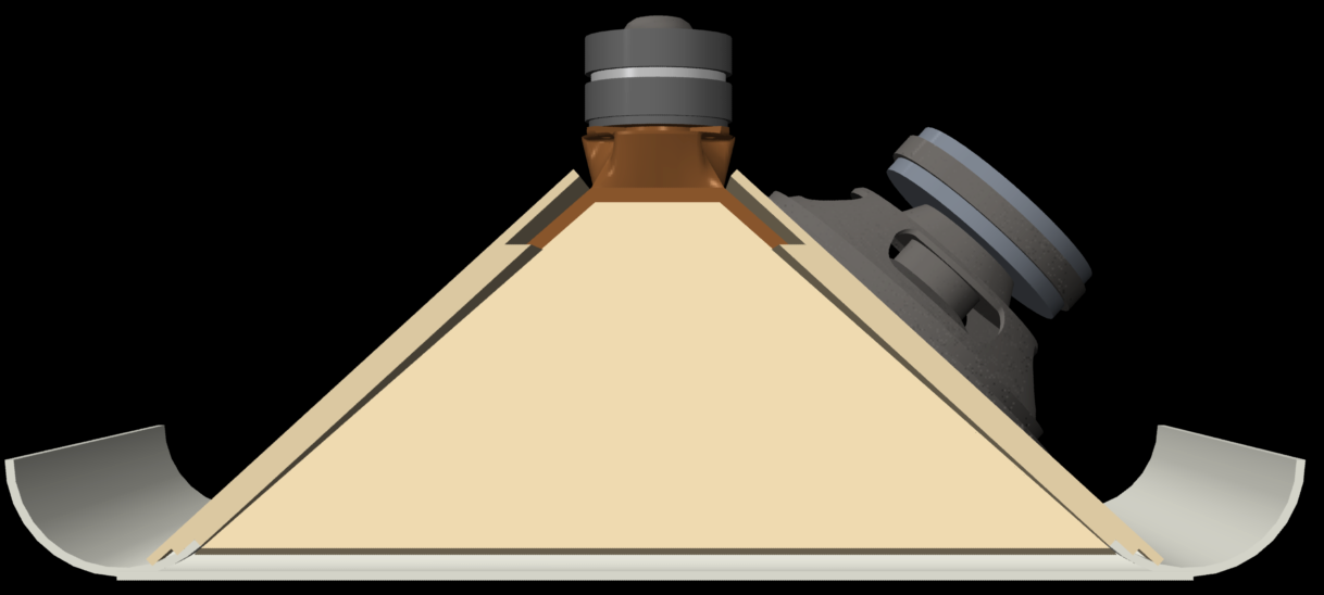

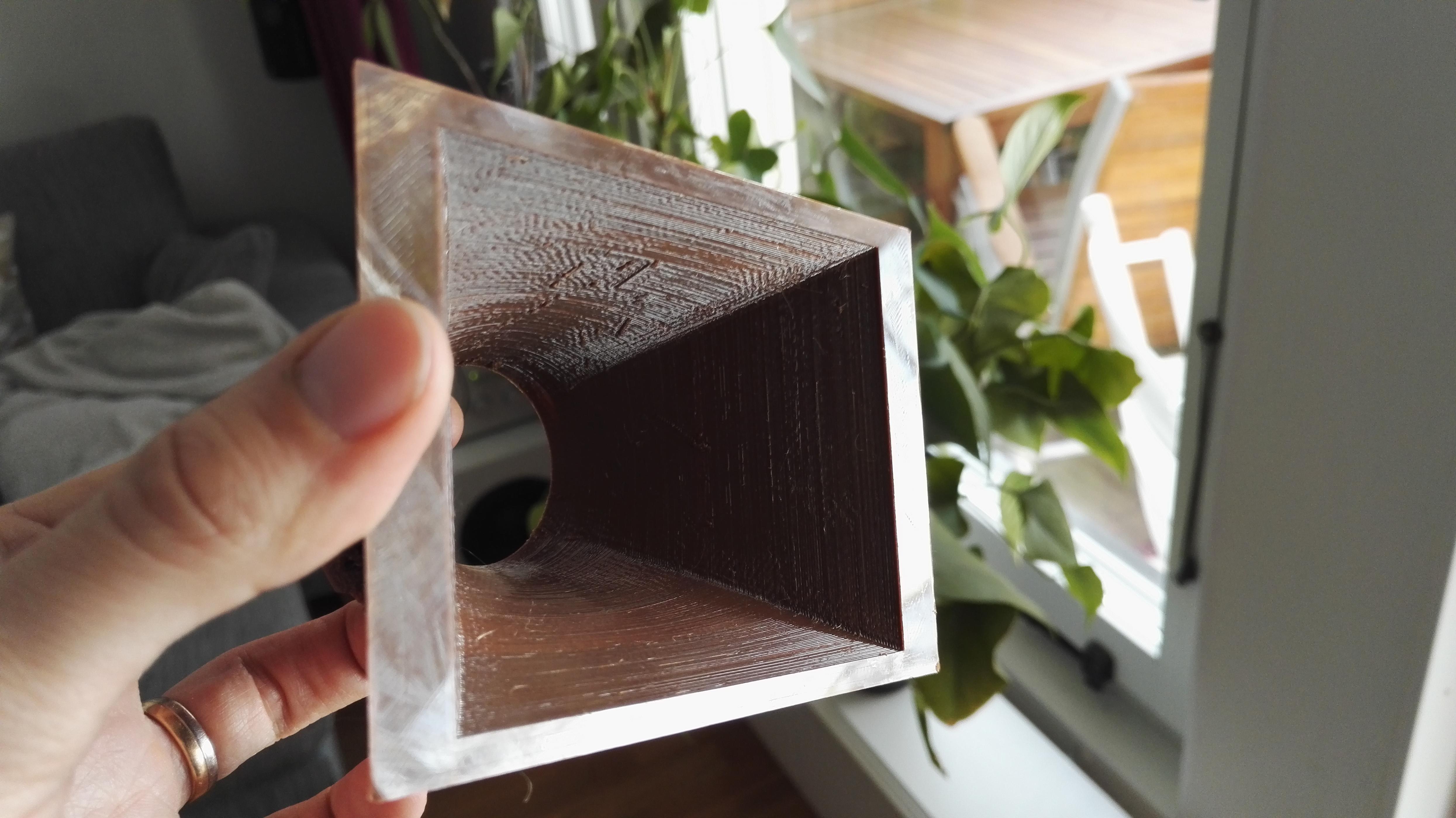

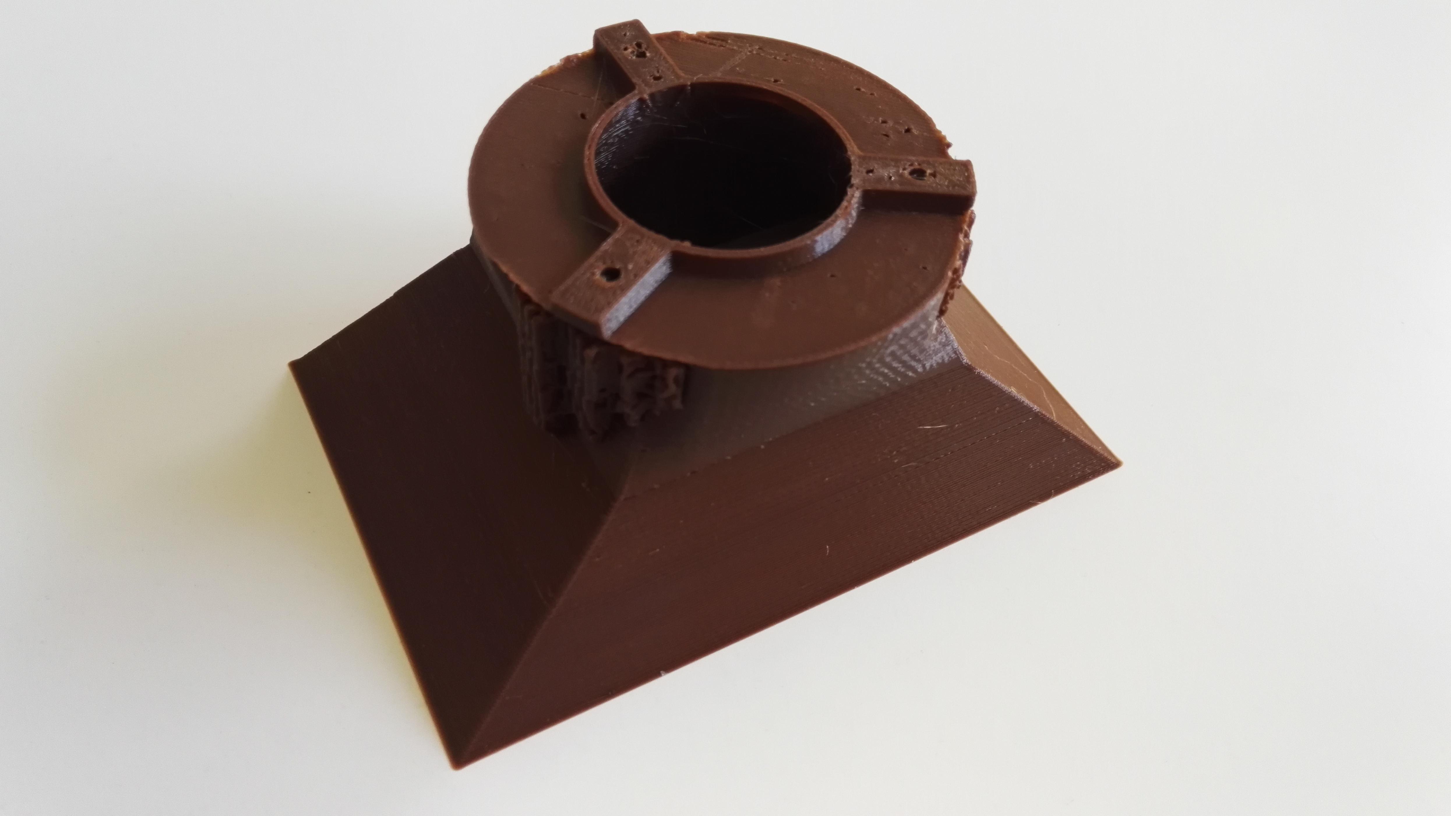

Here are some renderings of a 3D-model that should be correct and includes the 3D-printed throat adapter and to scale models of the tweeter and woofers.
Everything seems to fit. Next step is to make some saw dust I suppose!
Oh, and it's a 90x50 horn, total size of box is 55 x 28 x 33 cm (W x H x D).
/Anton

ThanksThose are some pretty models. Super elliptical oblate spheroid would seemingly be the natural evolution of this.
Well, I'm not so sure. The point of the oblate spheroid is to take a flat wavefront (typically from a compression driver) and convert it to a spherical wavefront that can travel down a conical horn. The ringradiator does not emit a flat wavefront as evident from sims:
So the goal must be to make a profile that as fast as quickly turns the wavefront from the ringradiator to a spherical one and then use a conical horn (if constant directivity is the goal).
A super elliptical horn would possibly be better than a rectangular, but much harder to build, especially when it comes to getting the woofers close to the bandpass holes (for short hole length).

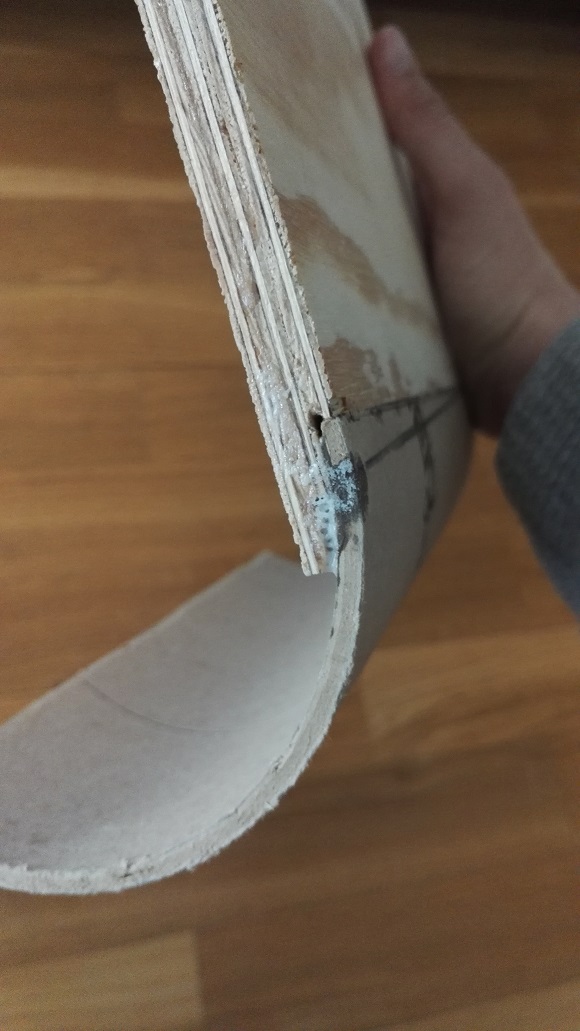

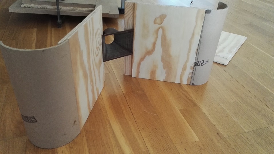

Some progress
I'm glueing some of the horn sides atm:
The sonotubes are adhered using polyurethane glue, as are the plywood sheets (to each other).

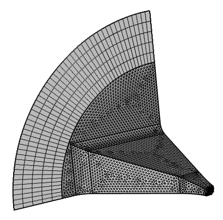

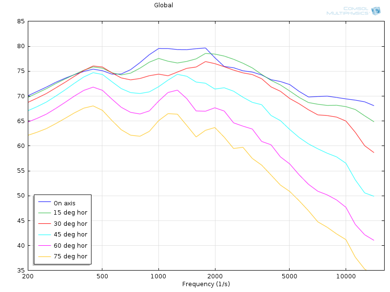

I've done some sims of the horn with two large simplifications:
1. Only tweeter (no mid BP holes).
2. Infinite baffle.
Other than that I'm assuming that the membrane has a constant acceleration (varying linearly from voice coil to edge).
This is what the geometry (1/4) looks like with mesh for 10 kHz:

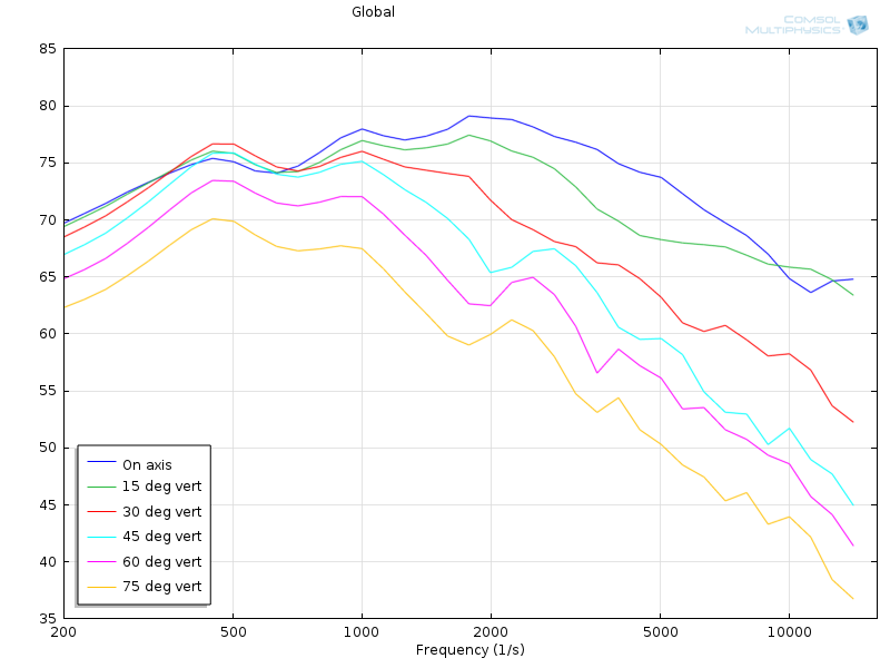

It ran out of memory after 14 kHz, so here's horisontals 200 Hz to 14 kHz:
And verticals:
Both results are taken at 2 m and slightly off axis (to remove numerical problems with perfect symmetry). On axis looks a little wonky, but other than that I'm quite satisfied. Let's see how well the sims correlate with measurements.
