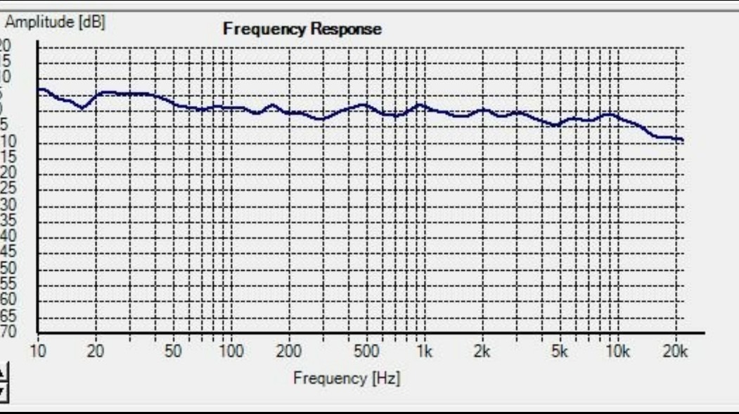

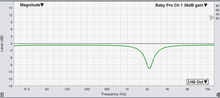

I'm not sure I read your plots well - due to my failings🙂 not the plots.
They seem very flat and true.
I've found with my Holmimpulse amplitude vs Freq measurements that I tend to like the sound of a good boost of deep bass, slightly less mid bass, slightly less mid, slightly less upper mid, same level tweeter..
The whole plot slopes left (high) to right (a bit lower).
Truly flat is too bright for me.

I share your tonality preferences. I like a bit of bass bump, and truly flat is almost always too bright. So I use a downward sloping house curve like so many folks do.
That said, I typically tune to get flat magnitude and phase.
Because I manually adjust bass, and overall downward slope in real time, on a track by track basis.
It's very easy for me because I've done so much of it, and usually needs no further adjustments for an entire album, or often even a Youtube playlist that stays in genre.
And, inside vs outdoors always needs considerable adjustment.
And, And.........most importantly...individual track adjustments add greatly to my enjoyment of them .🙂

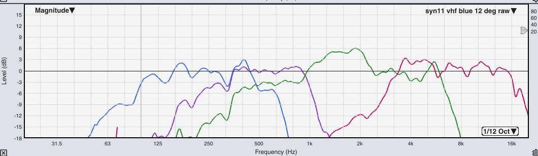

Here's an example of typical flat tuning, (also shown in post#2.
In the frequency magnitude response pane, Green is the entire Syn11.
Blue, Brown, Purple, Pink, and Dark Red are individually the 18"s, 12"s, 4"s, coax CD's HF, and VHF.
(The red trace above them is Coherence, which is a statistical measure of correlation, stimulus signal to measurement.
It is displaying the CD's HF section in this plot, so coherence is high across it's bandwidth, but zilch elsewhere.
It's a very useful stat for knowing how much multiple arrivals are contaminating the measurement.)
This plot in contrast to flat above, is one where there is an embedded downward sloping house curve into each of the driver sections' FIR files.
Dark Purple is the Syn11 without subcart. The 18"s in the syn horn are high passed at 50Hz on this one. Coherence is for full speaker.
My idea behind embedding the house curve was to get a head start on manual adjustments, with the house curve being the center of gravity so to speak, where manual often ends up going.
But I'm so used to manually adjusting vs overall flat, and tuning/verifying individual drivers sections as flat, ......i found the embedded house curve is more of a pain than a help.
Prosound Meyersound's philosophy got me started with 'just make dang speaker flat'....then do what you want with it situation depending.....and know you are always starting from a well known flat cornerstone.
Anyway, hope all that was clearer, and helped explain.

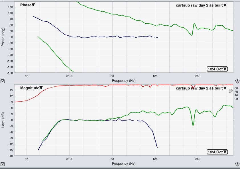

Hi mark100,
I apologize if this is off-topic, but I was wondering what technique are you using so that your low-frequency measurements, e.g., 32 - 300 Hz, show such a small variation?
I am curious because I recently finished and measured a low-frequency enclosure, and the near-field measurement was shockingly similar (withing few Hz, e.g., f_3, f_10) to the simulation. Once I move the microphone to the listening position, the measured signal reminds me of Alps.
I understand that I can correct the peaks, but even with the 1/12 smoothing that you use, the signals has the deep nulls.
Kindest regards,
M
Kindest regards,
M
Hi M,
In both of the plots in #145, the lowest section is just the 18" drivers in the syn horn.
The response doesn't include the "subcart" (the name i've given the lower sub to help differentiate it from the 18" sub drivers in the syn horn)
Both plots were at about 1m, so pretty close to the syn's 18"s.
And yeah, out in the room it will all go to hell.
Which is why i don't make or value sub measurements out in a room....I use my ears for that.
All my subs, like the subcart, PPSL, sealed and vented regular boxes, etc........get measured and tuned out on the driveway.
Since I use linear-phase xovers, I know they will mate up and be in phase with main speakers indoors, with nothing more than correct time delays.
Out on the driveway, I make a physical distance measurement with a tape to ascertain where the sub's measured acoustic center is vs a ToF measurement.
That gives me the info needed to get delays right indoors.
Syn11 is unique for me, as I have to measure subwoofer's low freq along with main speaker, cause a sub section is part of the speaker !!
Heck, the outer extremities of syn11's ports, including its 18" ports, all fit in a 24"x16" rectangle. Hard to separate that Lol
Which is why the response is included in indoor traces.
Normally, i say to heck with indoor measurements below 100Hz.
I know folks will tell me about multiple subs, sub optimizations, Dirac, etc.
I also can't see how any of that will ever get as good as outdoors. Even outdoors, two subs muddies up, other than when sub content is part of the stereo mix.
Every time I've tried to do anything with subs indoors, single or mutiple, doing any thing other than placement and EQ'ing down room modes....
....well, bass & especially bass transients.... get fatter ,blurred, muddy. Me No likey 😛
So i just use my ears to try to get what I hear outdoors to sound as clean and dynamic indoors. My turn to veer OT haha

Hi M, That's not correct. Both plots under discussion in #145 were indoor plots at about 1m, and were of the Syn11 horn section only.
The only reason the lowest 18" section looks good is due to closeness of the measurement.
What I was trying to convey, and was probably too wordy about...is that I personally don't put value in indoor sub measurements .
This is the subcart raw measurement and processed reponse, taken outdoors ground plane at 4m.
It's what I run indoors without further EQ etc, other than playing with various low-pass frequencies.
It looks good cause it basically is good....and outdoors 😀

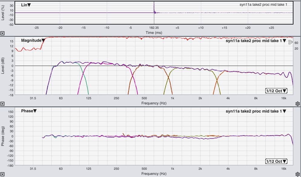

Hi mark100,
I was wondering, if you could post the measured, i.e., unfiltered Syn 11 in the 500 - 20,000 Hz.
Kindest regards,
M
Thank you for the explanation. I am still surprised how look the Syn 11 looks in the about 125 - 500 Hz bandwidth.It looks good cause it basically is good....and outdoors 😀
Kindest regards,
M
Here's the 4 sections' individual raw responses used from 100Hz up.
Blue = 12"s
Purple = 4"s
Green = coax CD HF
Red = coax CD VHF
Blue = 12"s
Purple = 4"s
Green = coax CD HF
Red = coax CD VHF

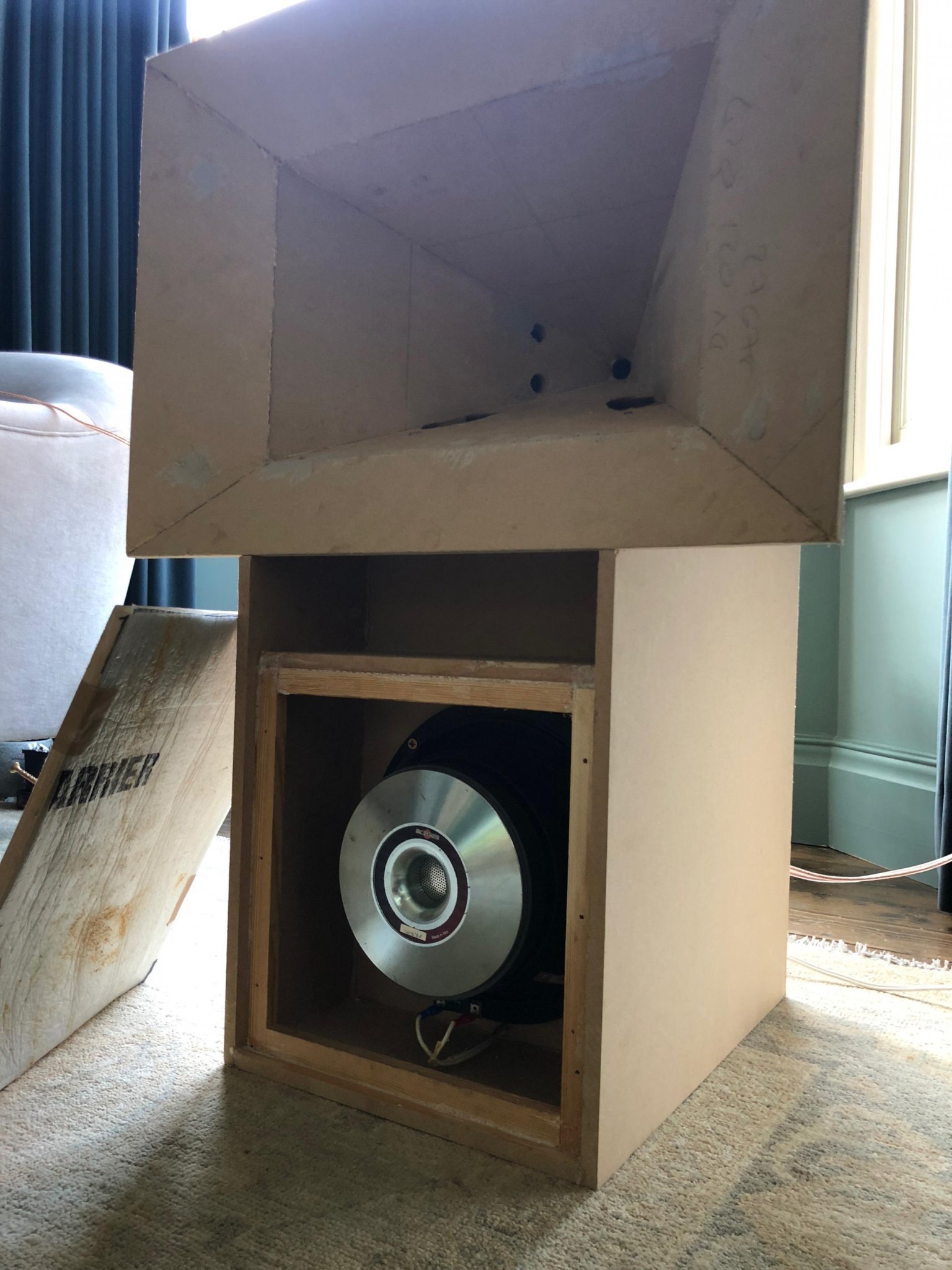

hornsteff here is one alternative way to mount a driver to a MEH/synergy
more info from this post (and thread):
https://www.diyaudio.com/community/threads/synergy-build-with-tf0410mr-mids.324097/post-5501378
I asked David McBean how to go about simulating this in this post and his answer is in the next post:
https://www.diyaudio.com/community/threads/hornresp.119854/post-7367527

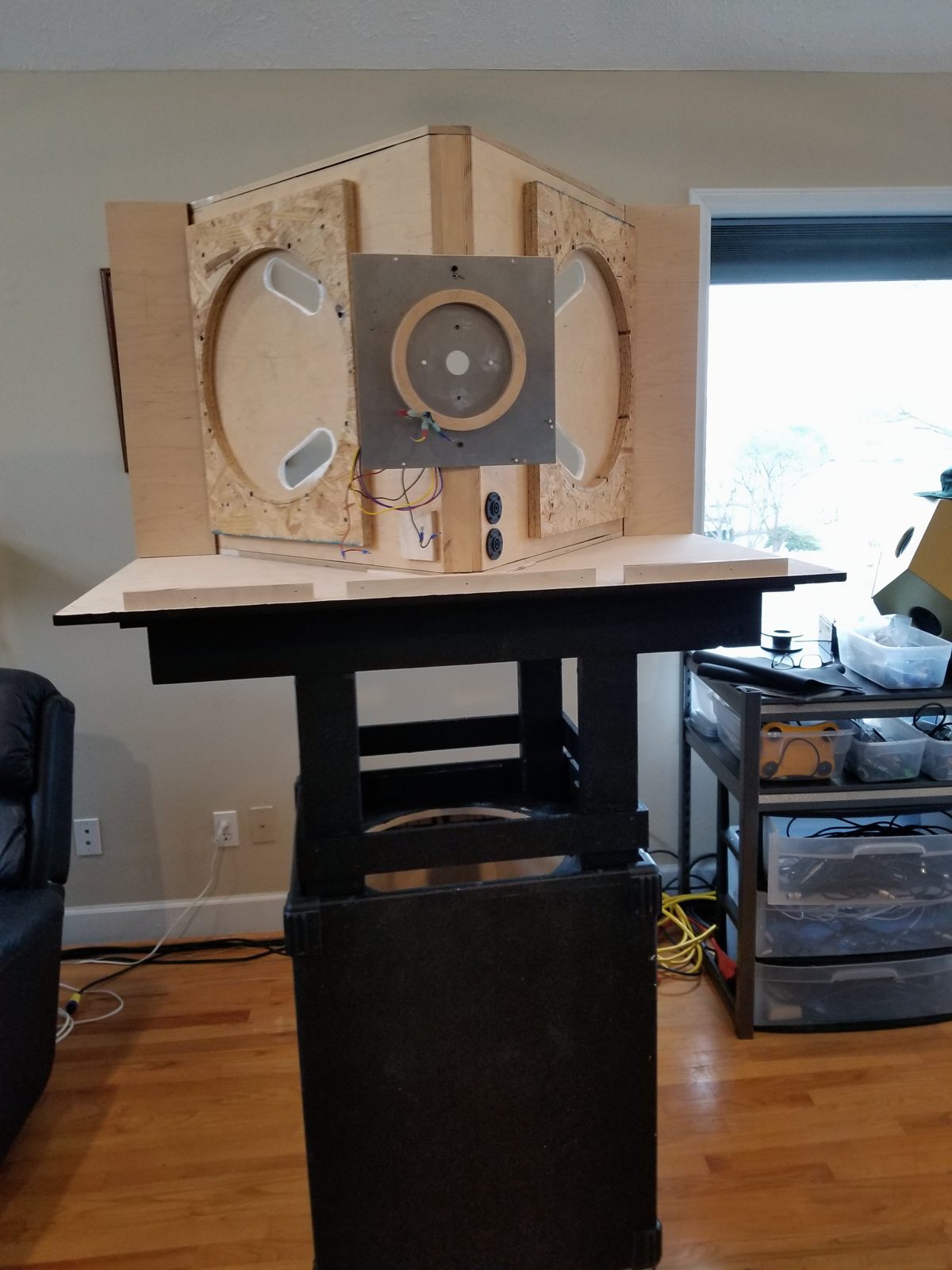

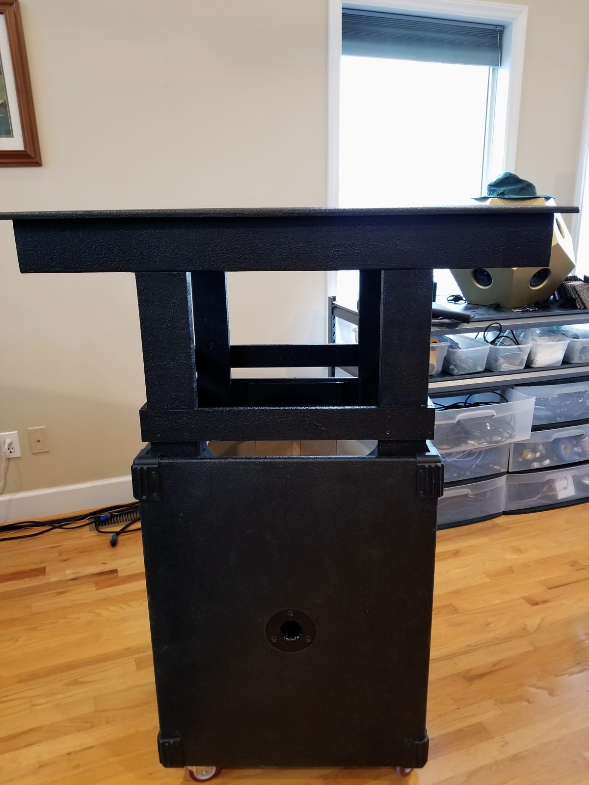

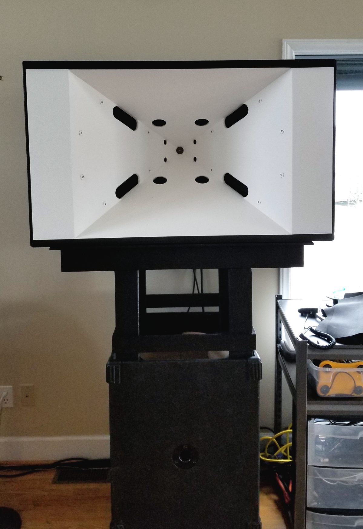

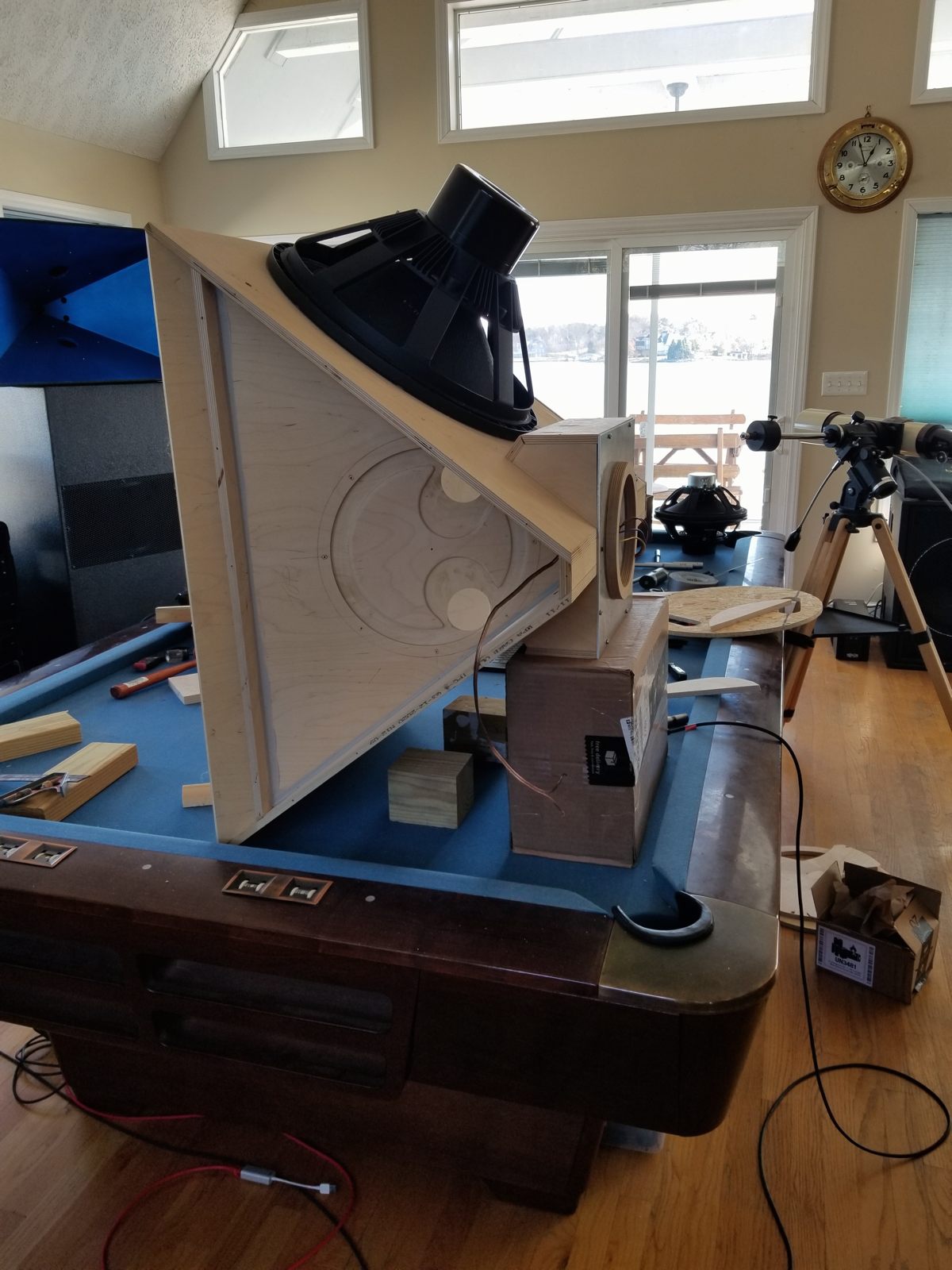

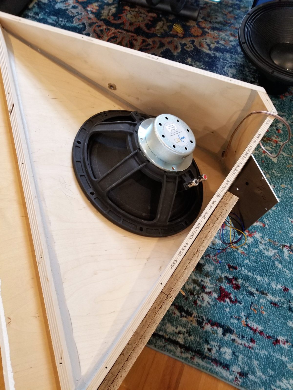

About 2-3 weeks ago I got inspired by ncbluetj's BASH build which uses 4-15" !! https://www.diyaudio.com/community/threads/the-b-a-s-h.391536/page-6#post-7190481
Decided to see if I could retrofit a pair of 18" to an old synergy prototype....looked like it could work, providing a box could be built to wrap it.
The old proto is a 75x60 build that uses two 12"s, four 4"s, and a coax CD.
I'm like yeah, I can build a box around it, but it's going to be one heavy sucker. I'll need to build it on site, in its final resting place.
Decided I wanted to build it on a stand to match the height of other synergies sitting on tall subs. Used a vented sub box emptied and turned point up for the base.....(which already had coaster wheels, yay)
Built the box pieces and painted them. Time to assemble.
First thing was to mount the 12"s and seal them up the way the proto was designed.
So I can start putting it together on the stand.

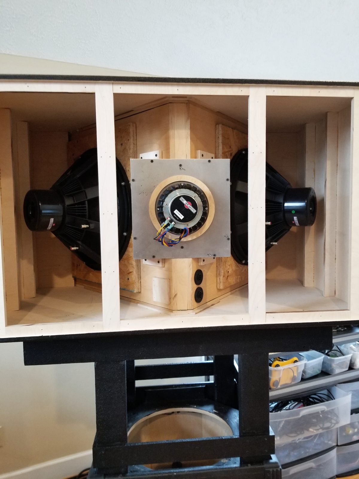

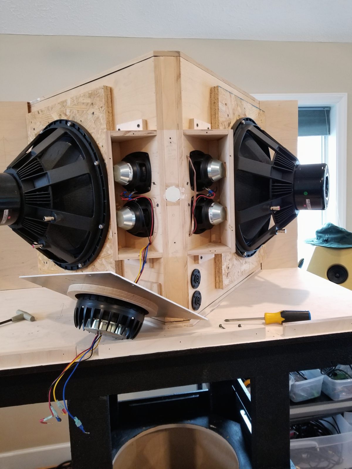

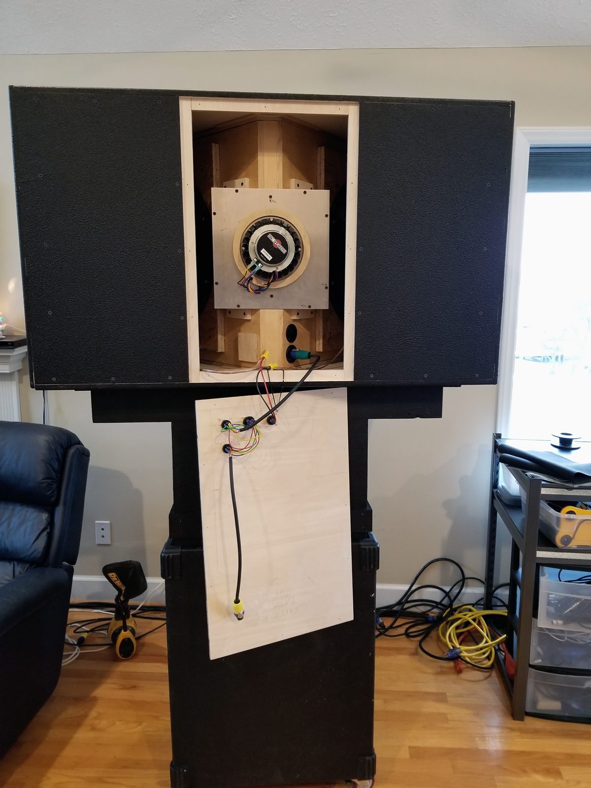

Ann then add the rest of the drivers.
And then add the box.
Finish the wiring and seal her up...
Done. Assembly went nicely....took about 4 hours yesterday......happy camper 🙂
