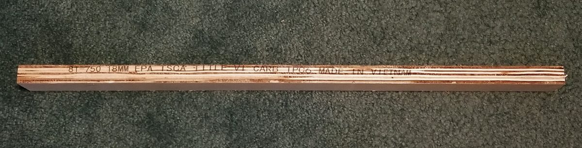

Oh it's not baltic-birch by any means. That stuff is nearly unattainable due to the war.that's an awesome price for 3/4" BB ply
I had one last sheet of 5'x'5 3/4" BB, that i used to make six baffle boards for the new subs. My cabinet shop said they had seen a single sheet of it go for over $300 lately. I came close to listing it for sale, but know I need all the strength I could get for the baffles.
The 3/4" birch i use for the boxes (and for the big sub-carts I just trashed is simply inferior to BB.
It works, but a whole lot more bracing is needed.
That said, a 4'x 8' sheet for $35 is something I'm grateful to be able to source. And sheets are actually 1/2 oversize each direction (for cabinet trade work).
Stuff comes from Vietnam. 10 ply...11 if you count a paper thin veneer.
