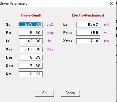

The 2 low drivers are Faital 12pr320's. They each have two 2.44" round ports centered 7.5" axially from CD, for a total area of 9.4 in2.
Here's TS and a little chart putting the above into metric. ( inkow HR let's direct english entry, like said...just trying to help others follow.)
The port area is total area for one driver.
Hope this helps make it a little quicker....lemme know what's missing if be the case...

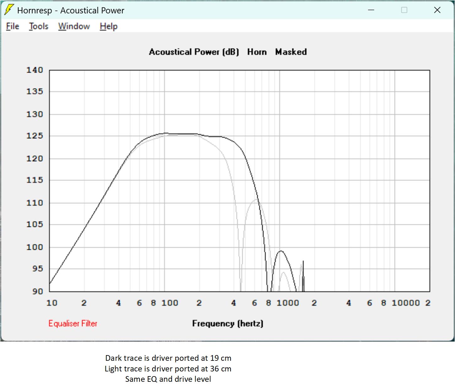

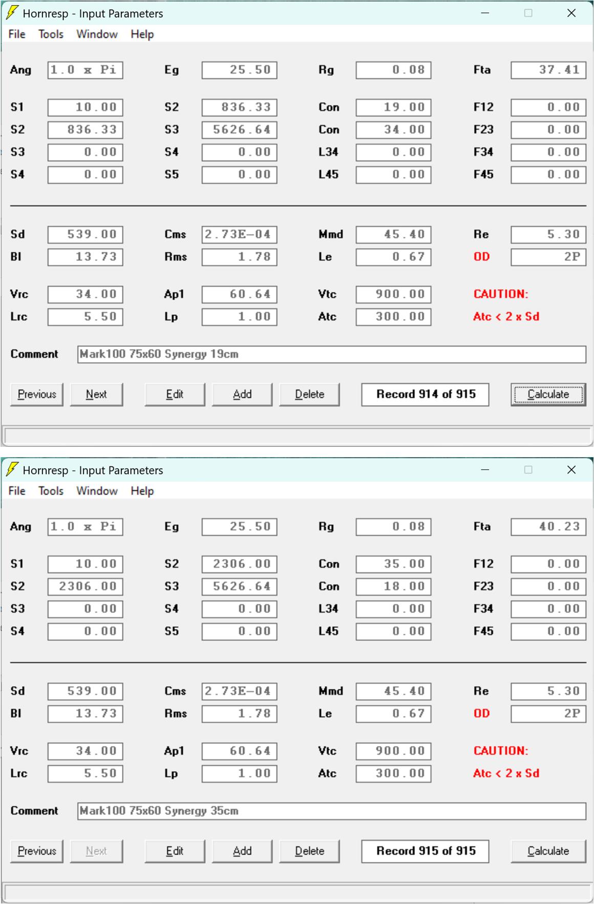

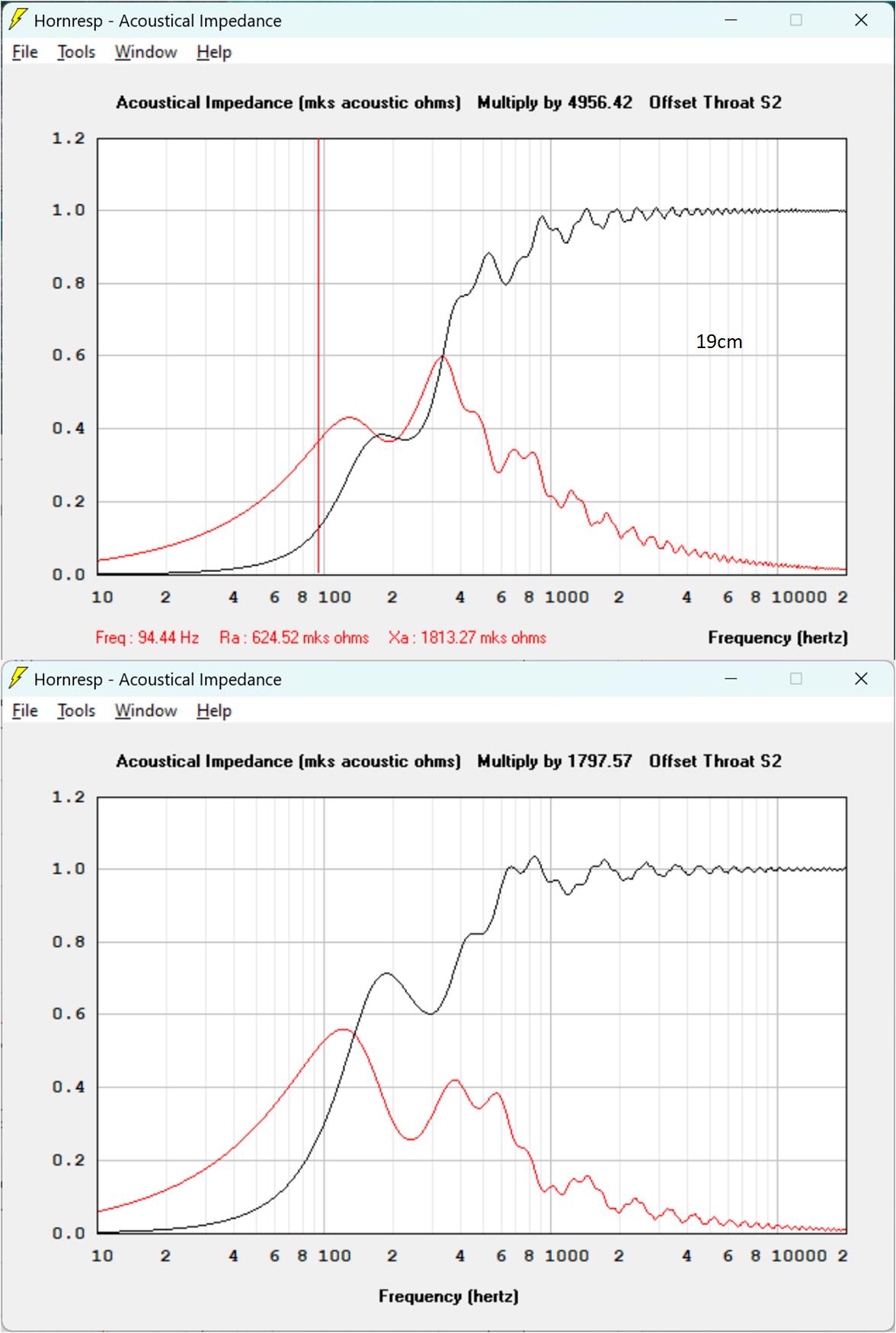

I have an answer already. I created the models, equalized the 19 cm model a little and adjusted drive for near Xmax at the low end. I then used the same EQ settings and drive level on the 35 cm model; 36 cm because the schematic view suggested I couldn't go any further, likely wrong about that. In HR, you can run a model, right click in the graph window and capture current results, then run a 2nd model and compare (tools menu).
I did that and saw that the only change in output was that the reflection null moved to a lower frequency; no changing loading or extension at the low end.
The acoustic impedances are different but that doesn't seem to matter.
If we wanted more low end, we would be looking for the acoustic Z to rise above zero sooner.
Moving down the horn hurts the high end and doesn't help the low end in this case.

I tried increasing Vtc from 900 to 1800 but, if anything, that increased the response level beyond the notch.
What seems to have the most and beneficial effect is reducing the effective port length well below 1 cm but that might not be practical, given the large hole area. You could try "frustrum"ing the port holes
And one more caveat: the port area isn't sufficient for 130 db output level. Seems to be good for about 118 db or so. At that level, you have a lot of excursion remaining to extend the low end.

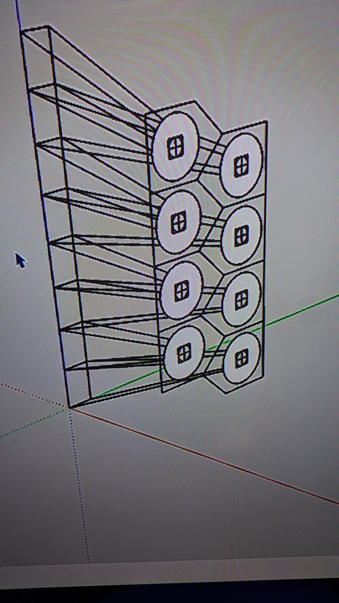

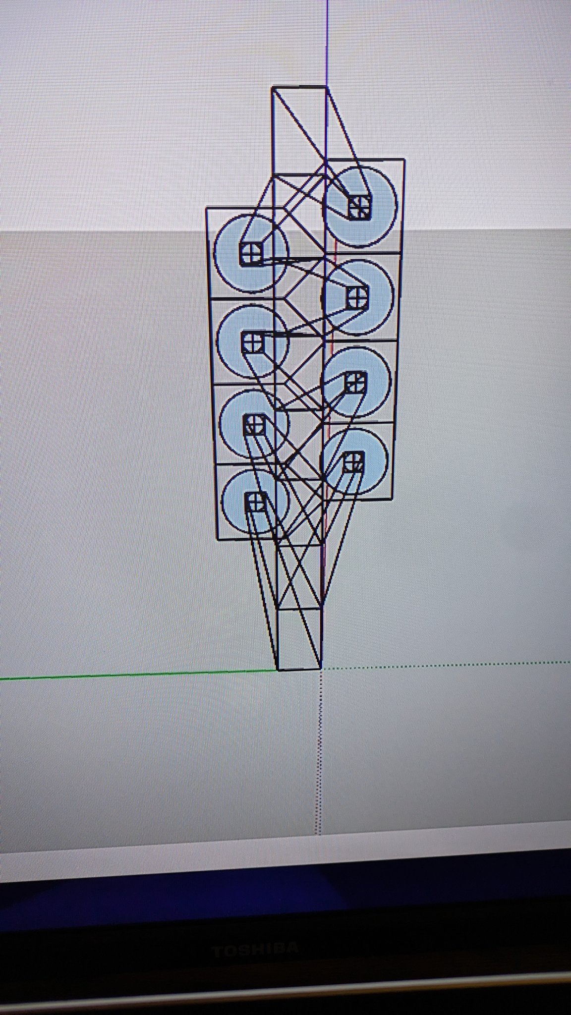

I'm working on something similar to a DSL J7/8. Multiple stacked short horns feeding into a large horn. Mids and highs are both in the short horn. Faital Pro HF108R for the highs (1") and Beyma 6MCF200Nd on mids (6.5") with Beyma 10MC700Nd for lows (10") on the large horn. Each mid taps into two short horns basically so the mouth so it's close enough for 1/4 wavelength of 4000Hz.Hi, Everything I've built has used a CD to reach down to small mids between 700-1000Hz, ...or using the CD to reach all the way to large mid-lows between 500-700Hz.

Very interesting! Beyond anything I've tried. Good luck !I'm working on something similar to a DSL J7/8. Multiple stacked short horns feeding into a large horn. Mids and highs are both in the short horn. Faital Pro HF108R for the highs (1") and Beyma 6MCF200Nd on mids (6.5") with Beyma 10MC700Nd for lows (10") on the large horn. Each mid taps into two short horns basically so the mouth so it's close enough for 1/4 wavelength of 4000Hz.

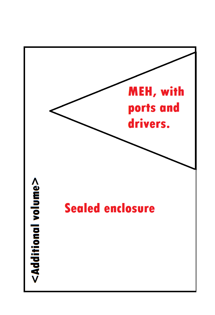

Hi RobertC, I'm not picturing exactly what you mean.I have been reading through many MEH threads over the years and was wondering as it doesn't seem to be touched on too much when making MEH speakers, why isn't there a large and low tuned (LLT) cabinet below the already large horn to extend frequency response to make it full range? As I understand it the MEH is front loading the drivers to some frequency, which is determined by the horn mouth size which can be impractical to do the full frequency range by just front loading them so why not rear load them with a LLT to make up for the shortfall?
Do you mean a second large horn box below the MEH? Or incorporating large low tuned drivers into the MEH?
And not sure what you mean by the MEH is front loading the drivers...?
My take on a MEH is that the horn loading gains of drivers placed in/on the horn, are more of a secondary advantage, than the primary advantage of closing down inter driver spacings. And I think the horn is about a constant directivity design.
Most MEH's for home audio hope to be smallish in size and weight....which necessarily precludes large heavy boxes.
I think designing them, knowing a sub is mandatory makes practical sense.
With syn11, where I've tried to put a sub into the MEH by adding a pair of 18"s onto the horn, it's become pretty clear to me subs are subs...no beating Hoffman's iron law. The 18"s need box volume and ports just like any other reflex sub....which makes the dang entire MEH crazy big to do right.
So if you meant a second large horn box below the MEH, I say go for it!
If you meant incorporating large low tuned drivers into the MEH, I'd say study the Danley boxes, their drivers and ports .....but know you will still need a sub.
Hope that was understandable...

So as I see it there is the MEH itself, and an enclosure around it but typically these don't extend below the MEH, so my thinking as to provide volume for the subs in your Syn11 would be to make the enclosure for the horn bigger like my attached pic (it's a side view). And as I understand it from what others have explained above if that does work, the enclosure would only be ported through the MEH to prevent phase issues. Wouldn't this provide the enclosure volume you need?
Yes, that is both a practical and cost consideration, but given the already large footprint of your Syn11 and something like @ncbluetj B.A.S.H, why not extend the cabinet below the MEH and pop some castor wheels on it?
