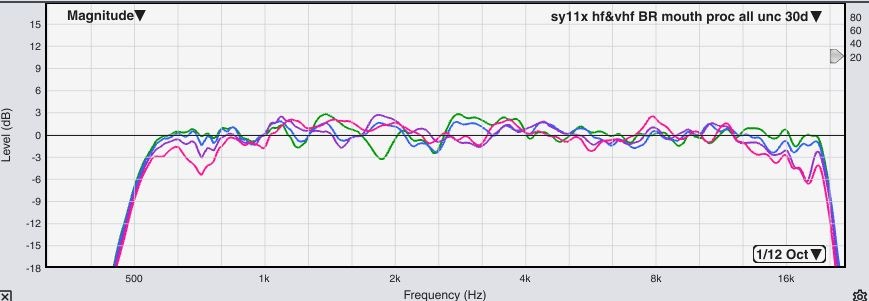

Looking at the last set of polar work I did on syn11, I see it was all about working on individual sections, and the effects ports were having on each section.
Didn't bother with entire speaker polars ...don't remember why not.
Here's the dcx464 CD...0 to 30 degrees, steps of 10. It's pretty typical of where i stop fussing with polars further.
I'm currently using the CD from 900Hz up.

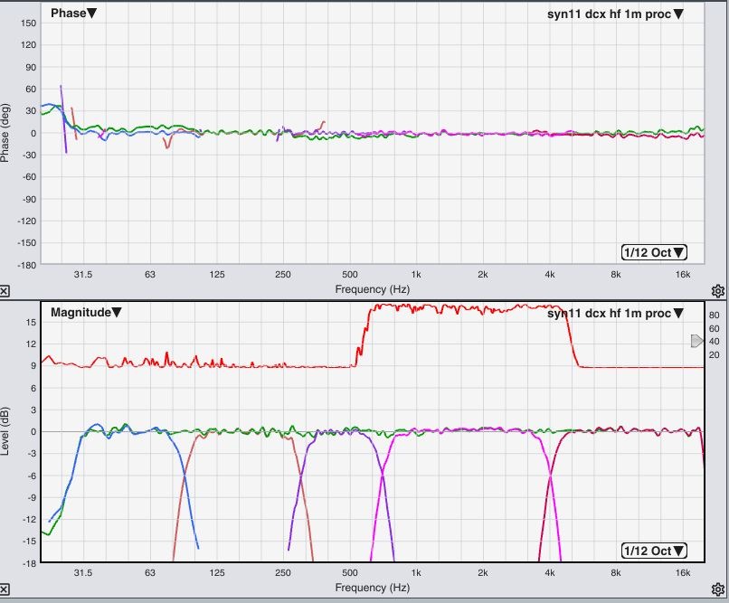

Hi, it's a bit tough to know exactly how to measure. For me, I rely on two approaches and compare them.
First is outdoors pointing off a deck to mic(s) about 3m away.
Second is indoors about a meter from the mouth.
I've never gotten data right at the ports that i thought was any good, maybe because there are always more than one port in play for mids and lows.
Outdoors is pretty reliable.
The close up indoors suffers from two things beyond normal room reflection issues.
When the mic is close, the relative distances between acoustic centers is greater than mic further away. Tis true for all speakers I guess, but give a unity/syn typically has more z-plane offsets, so it makes it a bigger issue up close.
The same z-plane differences makes relative SPL levels tougher too. For a simple example, on a big syn, a mic at horn mouth maybe be only 1ft to the low ports, but maybe 2 -2.5ft to CD
Doubling the mic distance to 2 ft from low ports loses -6dB, but only attenuates the CD -3 to -3.5dB.
Stuff like this is why i stick to outdoors without any stitching as much as possible.

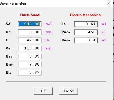

@mark100 when making tap holes, you're usually at 1/8 of driver Sd right? Is there a resource out there to determine when a smaller tap hole turns into an acoustic low pass? I'm working on a project with some 6.5" mids that I want to cross over to 10" lows. The 1/8 Sd for the driver is 1 & 3/8". But I'm worried that that small of a hole won't let enough 400Hz through as that's my targeted crossover to the 10's. What resource would one use to know what wavelengths are truly making it through?
I also saw your comment about bumping up to 1/5 driver Sd, but I wasn't sure if you meant porting the lows or widening a tap. Thanks.
Hi swiegert2011,
I do not know of any resource like that...if you find one, please pass it on.
I've used 1/8th of Sd for low-mids, 12" through 8" drivers designed to get down to 100Hz.
With 4" mids, I'm using about 1/12th Sd, and they reach down to 200Hz fine....some folks might use them even lower, if building a low SPL design.
The 1/5th Sd i mentioned somewhere, had to be for the 18"s I've put into syn-11. Not sure that works any better than 1/8th.
But the 18" sensitivity is lower than I hoped, so i tried larger ports (by just making their fat cigar shape bigger).
(I guess in retrospect, I'm just not used to how relatively inefficient sealed 18"s are to vented.)

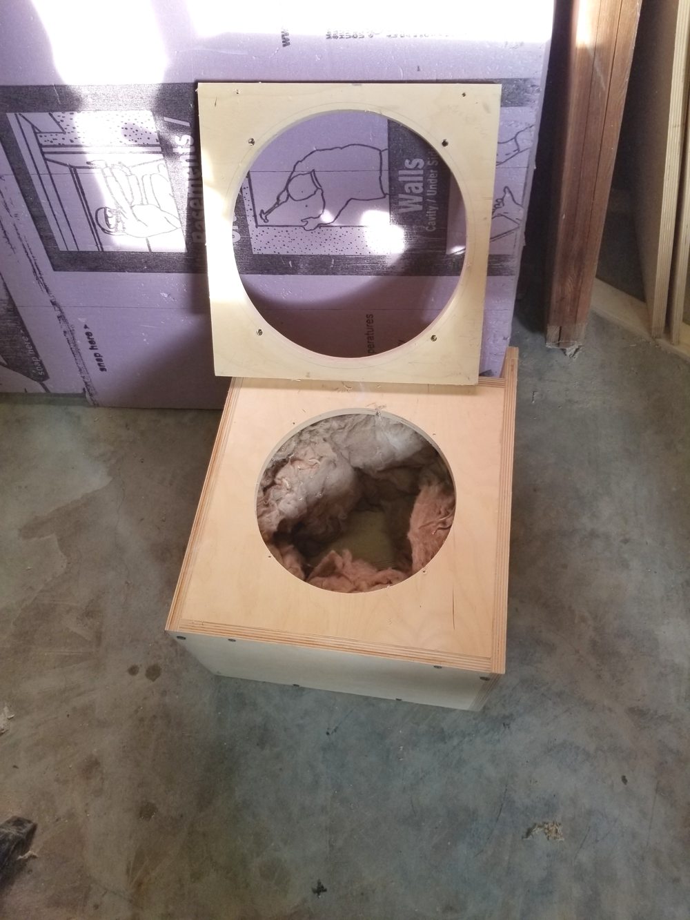

Given the time, effort, and expense of trial by error with port sizes in actual horns, I built a small surrogate test box.
I drop a driver in, then put a plate on top the driver with whatever size port, and measure. And move the port hole over various locations on the driver, like center vs edge, etc. Nothing even needs to be fastened down really. And different baffles for drivers' sizes can be used in the test box.
Here's pict of the test box, and then like said, just make a plate with port size hole in it to set on the driver....oh, and make the plate big enough to cover the whole driver with the port out near the surround...like my stupid butt forgets to do lol...
Hope this helps..

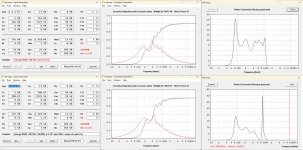

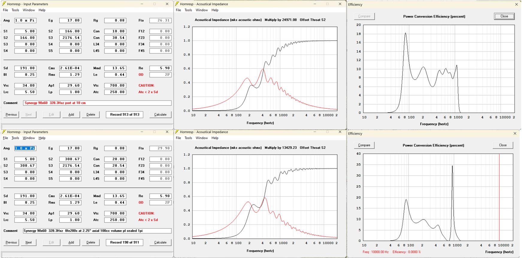

The resource you are looking for is HornResp. In HR, you can model a full MEH and tune the size and localation of the ports, or at least the axisymmetric equivalents of them. Its the combination of the amount of air trapped between the driver cone working against the area and length of the port through the wall into the horn that creates the acoustic LPF
Thanks Jack,
does Hornresp model the location of the port relative to the driver, like centered under the cone vs the periphery?
And can it model one port vs two, per driver?
Oh, and can it model port in horn center vs port in corner?
Thx!
Thx!
nope. its blind to those kinds of things. for that you would need ABEC, which I have spent the last month beating my head against for an open baffle/Uframe design.
HR will help in shaping, characterizing low pass filter effect and making total port area sufficient to avoid turbulence/port noise and seeing the reflection null
Some more thoughts....and where HR would be particularly useful.Its the combination of the amount of air trapped between the driver cone working against the area and length of the port through the wall into the horn that creates the acoustic LPF
I get the sense most unity/synergy builders are aware of how the acoustic LPF works..it's been discussed fairly often.
What isn't discussed much is what determines the acoustic hpf filter....port sizes and locations in horn....

The point can be demonstrated relatively easily in simulation.
I had a model for a small horn (by your standards) on the computer. I modded the port location. Then prepared the attached diagram
comparing acoustic impedance (the load Z seen by the driver) and power conversion efficiency for a port 10 cm from the throat vs 20 cm. Doubling the port distance resulted in a marginal increase in efficiency below 200 Hz. Likely would be a larger effect on a larger horn...
It would be fairly easy to throw together a simple model of your horn if you wanted to look deeper. Just post or send me the dimensions and driver T/S params
(The big peak circa 90 Hz is the driver resonance.)

Nice, and thx!The point can be demonstrated relatively easily in simulation.
I figure others would like to see what you're doing too, so I'll post my data here...
syn-11 is a 75x60 horn, 33"x 25"; with an axial length of 21" from CD mount to mouth exit
The 2 low drivers are Faital 12pr320's. They each have two 2.44" round ports centered 7.5" axially from CD, for a total area of 9.4 in2.
Here's TS and a little chart putting the above into metric. ( inkow HR let's direct english entry, like said...just trying to help others follow.)
The port area is total area for one driver.
Hope this helps make it a little quicker....lemme know what's missing if be the case...
