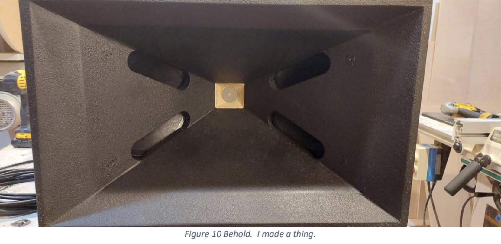

That’s the funny thing. He built several with small mids, including the one documented in this thread:I'd love if Scott Hinson, whom I too respect, has the opportunity to try adding small mids...be great to get his take.
https://www.diyaudio.com/community/threads/synergy-horns-dayton-and-prv.244890/
But he has found nirvana with his latest build, featuring the dcx464 here.
You found nirvana by adding mids after building several with coaxial compression drivers. 😆

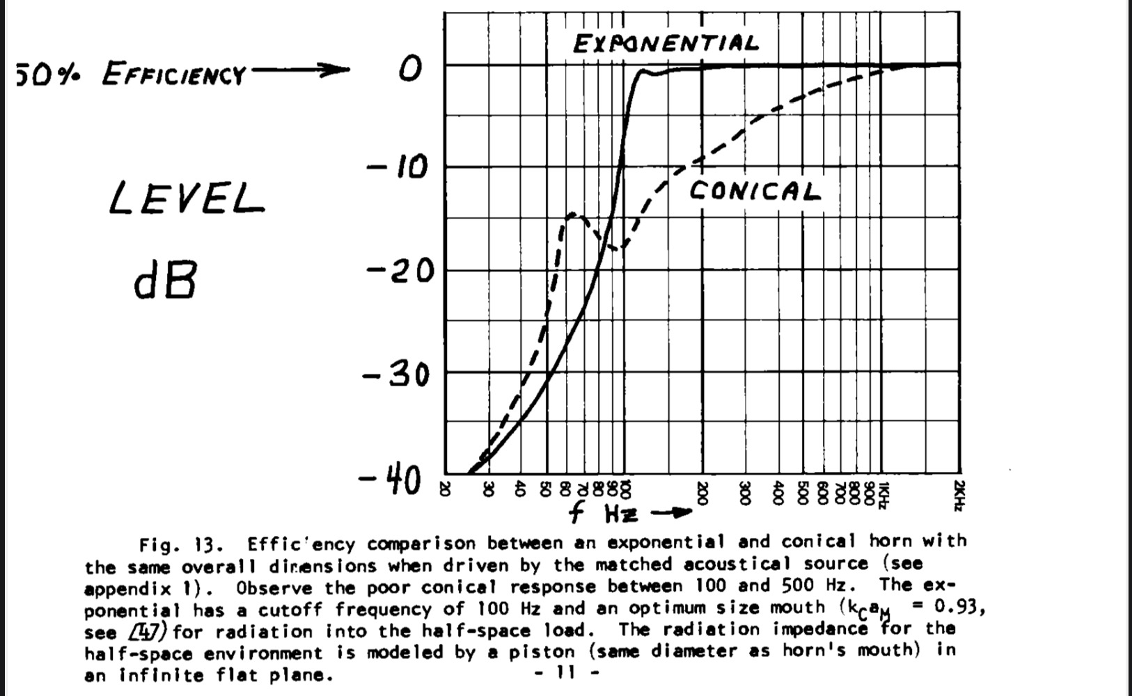

This got me thinking that it might be the horn. From theory, we see that conical horns load bass poorly. So perhaps your high crossover corresponds to where the coax is starting to struggle at below 1kHz, as Keele’s chart shows.
So the perhaps the coaxial mid is struggling too much in a conical horn, leading to more audible distortion even in a home environment.

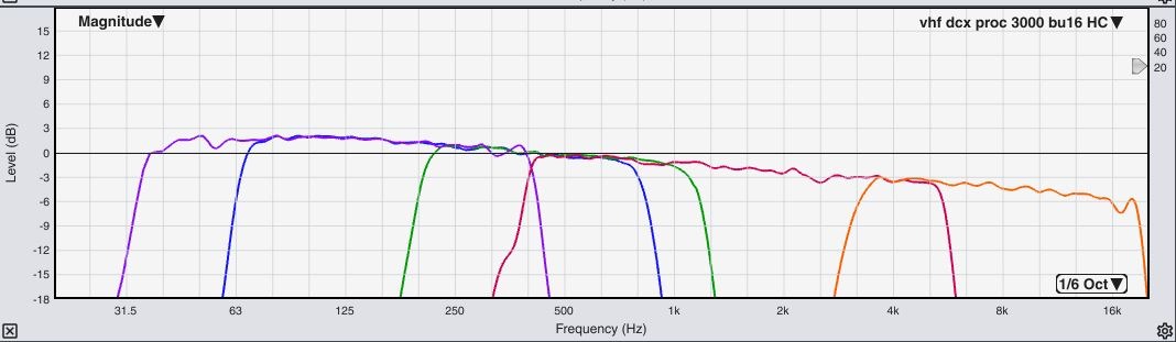

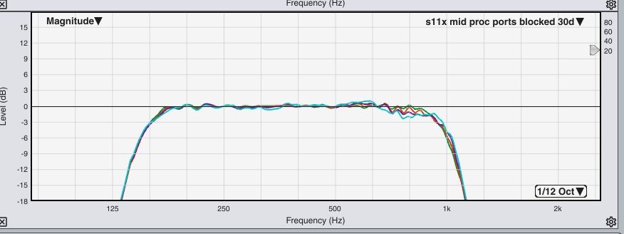

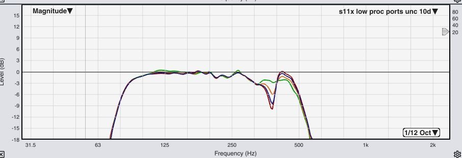

The other day when quickly making a new house curve tuning, I took the time to define what i think is the maximum usable bandwidth of each driver section.
By that, I mean bandwidths that took only moderate EQs, and the end points needing little to no boost, to maintain rolloff targets.
Below are the traces and what I think are the usable f-6 ranges.
18" subs purple. 35-425Hz
12" lows blue. 65-850Hz
4" mids green. 200-1150Hz
dcx464 lower section red 390-5400Hz
dcx464 higher section orange > 3200Hz
Lots of room to try things...lots of room to get good and confused Lol

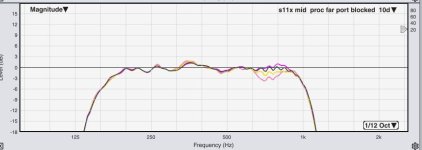

Yes, the 2 CD diaphragms are definitely aware of each other. Just as the 4" mids are very aware of the CD's lower diaphragm.
I think anytime two driver sections have raw overlapping band widths, they can't help but interact..especially when coupled on a horn.
It always amazes me how much an unshorted CD can effect raw mid measurements.
Which i think is why I think anyone using a passive xover has got to have some circuitry in place before even semi valid raw measurements can be made.
I mean, the unmeasured section has to either be shorted (directly or by amp) or have some kind of shunt across it for dampening.
That said, I'm a fish out of water when it comes to passives.... I just know you damn well have to short driver sections that arement being measured.

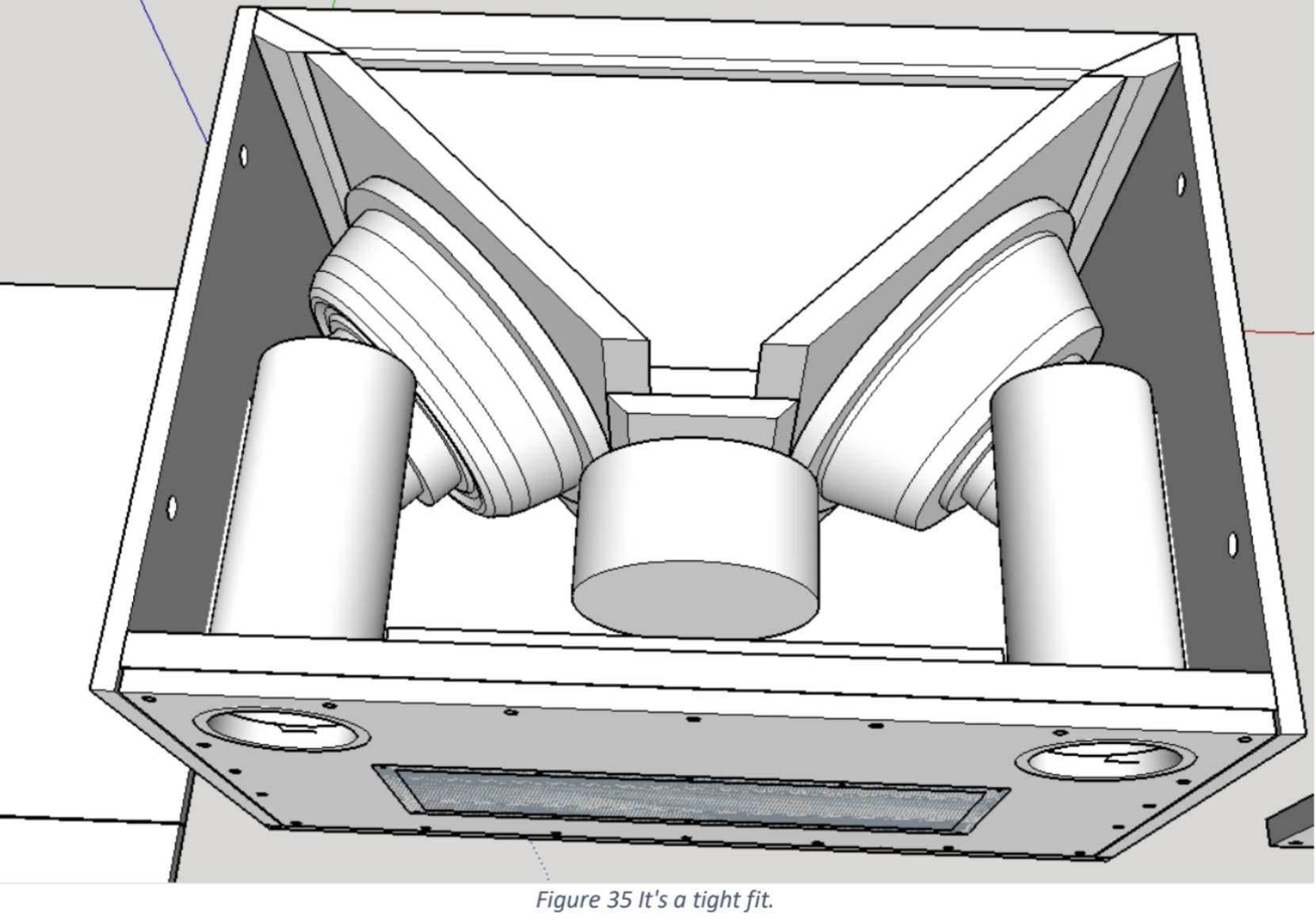

It is kinda amazing how sensitive/efficient the four 4" mids of my syn10s and 11 are.The midwoofer version does have some good benefits. The woofer mids are more efficient than the mids from a coaxial compression driver through the magic the port being further toward the mouth. Also, I might make a corner horn pair, and using midwoofers allows for getting closer to a corner with a physically smaller tweeter & shallow mids.
And yep, using the small mids does make it easier to locate separate low ports more optimally (that using one large low-mid)

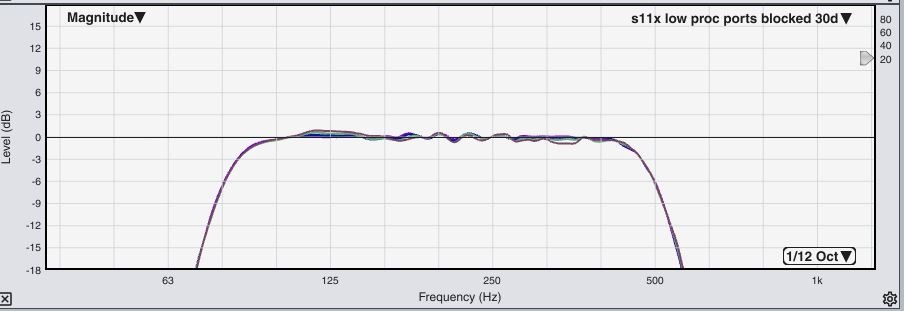

I'm working on showing some measurements I made, trying to get a handle port interferences for each section...
I've owed Steffen too, some of this info for a while....it gets into the whole on-axis vs 10 deg off stuff. etc...

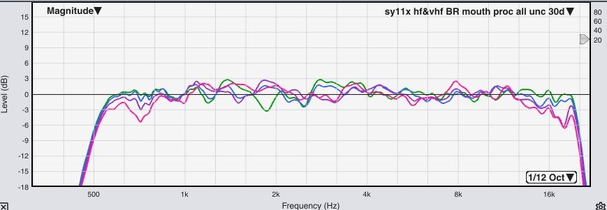

While doing gating measurement on the HF part I found a high Q dip around 16kHz. In your experience, is it better to EQ it back in the frequency response?

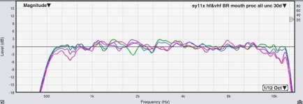

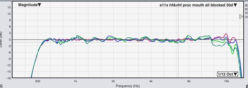

Hi folks, I've been trying to put together a series of measurements to show some of the explorations I've been attempting, but somehow i keep getting a mental block....feels like I'm trying to write a full novel uhg.

First, I've wanted to get a handle on how much do ports in the horn effect response vs how much does mouth termination effect response.
By 'effect response', I mean still produce anomalies across polars, after having applied DSP correction.
And I've wanted to separate port interference from mouth termination issues, section by section.
So first set of measurements was to block all ports with thin sheet metal and duct tape.
And then relatively close, within 1-2ft of the mouth, measure and correct each section's response.
The idea behind measuring close, is to try to be too close for mouth termination issues to get into the meas.
After making corrections, polars were gathered to see what I think the best hoped for response from each section could be (iow pure horn.)
The CD of course, was the only section that could get a pure horn (with all ports blocked.)
Then open and measure the mids, keeping low and sub ports blocked.
Then open and measure low, and last the sub section.
Here's 0-30 degrees for the CD, mids, and lows in order.
Again with all ports that are for lower frequency sections, blocked.
I think, and pls feel free to critique the idea, that this shows the best that can be hoped for for each section ignoring mouth termination.
As I unblocked port sections for the tests above, I also measure the effect of each unblock stange on the higher drivers sections.
For instance, after unblocking the mids, I tested the CD again with just the mids open. And then did the same after opening lows, then subs.
The CD's response did deteriorate as ports were opened, but really not as bad as I expected given there are 12 ports in the horn and the sub ports are big!
Here's the CD with all ports open.
Here's mid uncovered. followed by low uncovered
I use these as the start for determining how to use section spans / determine xover points.
For instance the above says to me the lows shouldn't be taken any higher than about 325Hz.
