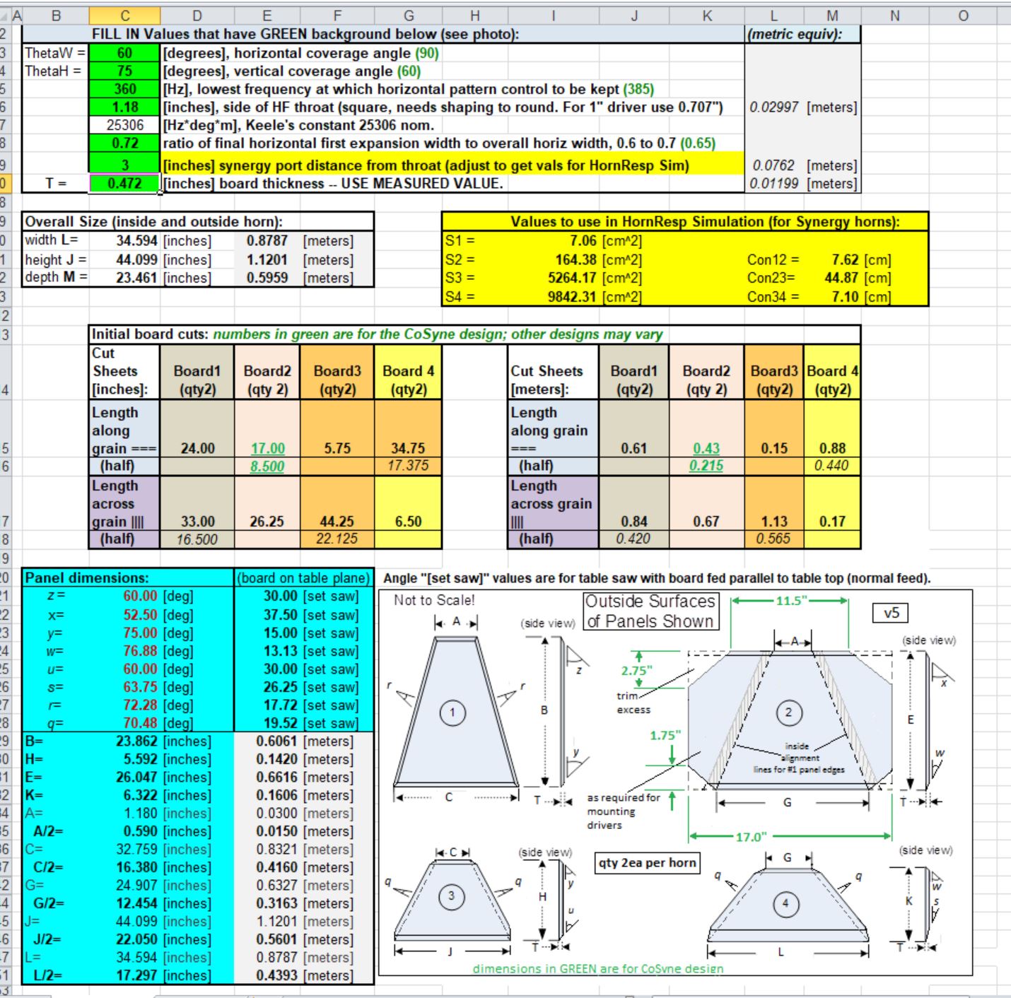

Hi guys, thanks for the kind words and interest,
Ok, drawing and port details...
here's the SynCalc sheet for the starting 75x60 horn shown in the thread opening post.
I only built the primary part of the horn, no secondary flares.
So in the blue Panel dimensions box, ignore the 2 secondary flare pieces.
Also note dimension C= 32.76" = the horn's mouth width, and G = 24.91" = mouth height.
It's backwards from the pieces picts because I input the horn as a 60x75.
I have to input H&V backwards because of the way I use the sides to form the horn without needing a box. And to allow sealing low drivers into the top and bottom.
The 4 small mid ports have centers 3.5" from CD flange, and are 7/8" diameter.
The 4 larger round low ports have centers 9.5" from CD, and are 2.5" diameter.
The long sub ports have centers 15" from CD, and are 10" long by 2.25" high.
All port distances are along the horn wall.
Hopefully, the picts at the beginning of the thread show that after the horn was built, the rest of the speaker is just a box built around the horn.
Box is 46"W x 27"H x 26" deep.
Only two things keep it from being nothing but a box with an open front.
First are the 6" wide flanges on the front, needed to fill in between the horn mouth and the box sides.
The 6" flanges have 4" bass reflex holes in them that I no longer use. 18"s are sealed now. I'll probably fill the 4" holes and repaint whenever i take the box apart again.
Second is I found it was essential to seal off the 18" cavities from each other. I used 2" thick rigid foam board because i could wedge it in tightly, and keep from having to make some kind of wood dividers. There were really nasty internal waves without sealing the two sides off from each other.
All the drivers are the same as previously posted other than the 18"s, which are now Dayton Apollo 18N. That let me put my bms 18"s back into their sub box.
The Daytons seem like a good sub drivers. I think it might like them a little better than the Faital 18FH500's i have.
The issue I mentioned about powering the 18"s, and finally realizing i was hearing a difference between low signal and cranking signal, came from trying to use a relatively lower powered amp in bridge mode inside the q-sys network.
The amp, a CX254, supposedly makes 900W @ 4ohms in bridge mode, which i would think would be fine for indoor use. (18's are 8 ohm in parallel)
However, luckily a few weeks ago, one of my sons was visiting and i was showing him there is slider for each driver section. I boosted the 18"s about 6dB when already playing pretty loudly. No change in sound.... HUH? I opened up the amp's monitor panel in q-sys and saw any transients were taking available headroom to zero.
I don't know yet if the amp is truly running out of headroom, or if q-sys is setup wrong for the amp. The amp is an older design that's called a data-port amp, and there are conflicting QSC instructions on how to set its DIP switches (which control bridging etc) vs its q-sys settings. Gotta get in touch with tech support.
Anyway, when I swapped to a regular amp with a couple of thousand watts into 4 ohms...wow, what a change.
Embarrassing really....I knew something didn't make sense, needing the auxiliary sub as much as i did to support syn11's 18"s....but lazily just thought i was trying to use 18"s where they didn't have enough box volume.
(That nagging sense that something wasn't right despite the great sound, has had a lot to do with why I haven't posted more about syn11.)
I currently have the Daytons high-passed at 40Hz, and often don't need the extra sub.
But when there's 30Hz music, or outdoors, I still need one of my bms subs.
Heck, outdoors the dang speaker is so powerful it can keep up with a couple of extra double 18"s .

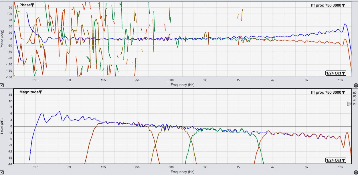

here' the 10 deg tuning in place right now. Ungated indoors, 2-3ft from mouth.
The 75 deg H pattern is too bright on about every song, so I embedded some house curve tilt into each of the drivers sections.
Forgot to save the 18"s section, but it's easy to see it in the entire speakers blue trace,(other than missing its low-pass at 100Hz.)
Xovers btw, are all lin phase 96dB/oct, at 100, 375, 750, and 3000Hz.
So now you are back at 10 deg tuning. Is it just plain easier/faster? Or are you still using the sheet metal method and two step tuning?

I know this is gonna sound like heresy...but the more measurements and processing files I try....well, I think the whole on and off axis current CEA2034 type perfectionist trend...is just that......and is not as important as I've been thinking.
I think 10-15 degrees just splits the differences between on-ax and off-ax variations, on horns like these.
Anyway, the best way I've found to keep a syn horn an active prototype is to assemble it using nothing but drywall screws.
With a decent tracksaw, and close attention to angles and dimensions, I've found after a bit of practice, they can go together tightly with just the screws.
And then be undone to lay flat to change port sizes/locations. Putting round port plugs back in is pretty easy, even when needing to re-route thru the plugs for different ports, etc.
