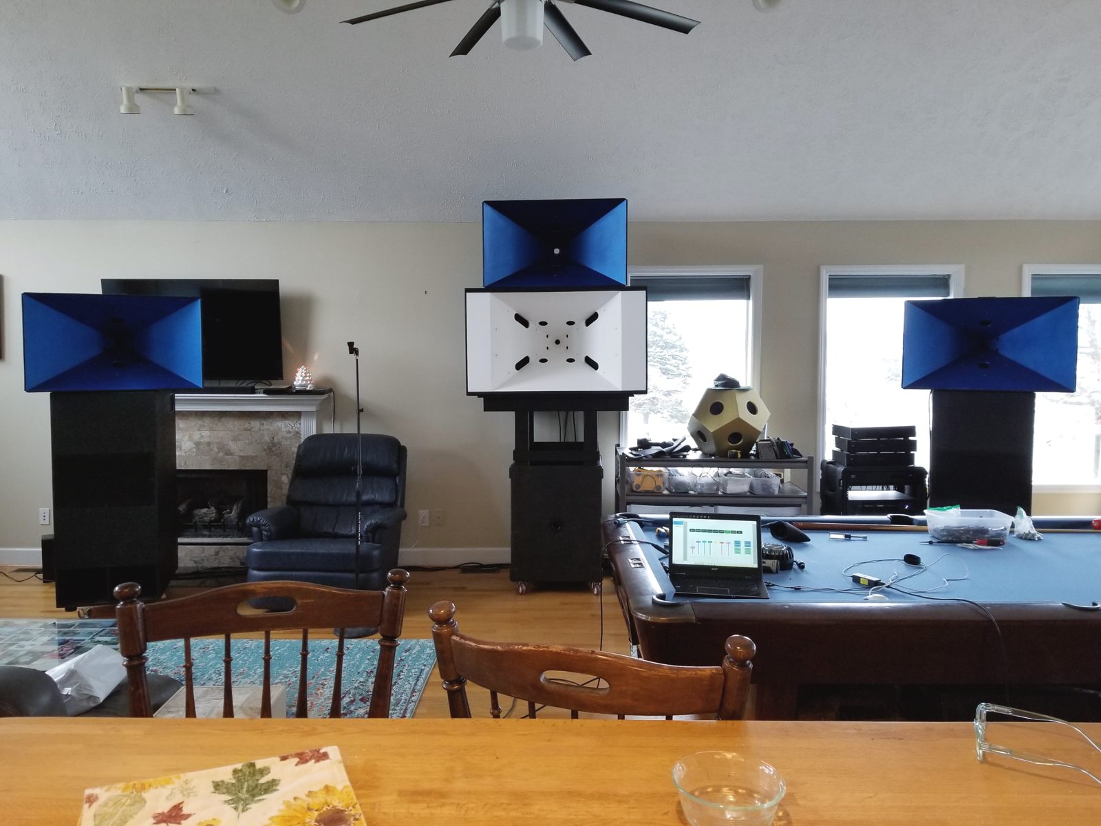

Did you notice the stand? The syn11 is at standing ear height, just like the L & R syn10's sitting on PPSL subs.
This syn11 is my center speaker in a LCR setup, simply replacing the syn10 that was in the center sitting on two 18" reflex.
here's a pict of the setup...please don't mind the mess...my GF doesn't 🙂
I've listen to syn11 alone, compared to L & R each alone, and the bass is definitely cleaner to either the L or R stack. It takes more boost to compensate for the lack of floor gain, but once than is leveled out, it's cleaner. Problem is, modes, nulls, and floor bounce of course make it song specific on how it fills in or cancels notes.
I've also listened to this syn11 by itself, and with the L & R PPSL subs blended in. Definitely makes more songs sound filled in.

Hi Steffen, my bad....I said a one-axis tuning in the opening posts. It was at about 10 deg off. ONE is too easily mistaken for ON, huh?Hi Mark 😀
That is really a massive build. Looks kind of fascinating.
How comes that you did the tuning directly on axis. I think that you normally tune to some 10 degrees off-axis. I guess it is because of initial MONO-listening?

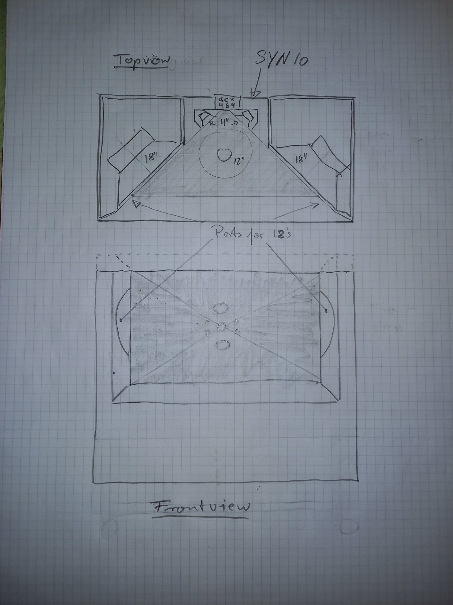

Is it really necessary that the ports for the 18´s are inside the horn? 1/4 wavelength summation could still work?
What if you build an 18´s sektion to mount your existing SYN10´s in, so that the 18´s fire from the sides, just outside the vertical horn-walls!?
I try to attach a s quick sketch. View attachment 1117826

I have how much it would change things to let the woofer cone hang out of the horn. But i do know that acoustic low-pass feature of it playing through a port is real indeed.
Yea, I have studied the BASH-thread. I need triangular boxes to fit in a corner, but 4 woofers in one SYN/MEH I like.
Are you saying there is a difference in sound whether the port is a round hole or a segment of a circle (provided equal port-area)? 🤔
My idea in the drawing i attached was actually inspired by the woofer-ports seen in the BASH. So I think it still would have that acoustic low-pass feature. But you will maybe have to cross a bit lower with respect to the 1/4wl-rule?
The idea being a subwoofer-design that wraps around your existing SYN10´s, without changing the SYN10´s in any way. The SYN10´s mounted/fitted in the "Synergy-sub". Removable, like two in one that can easily be separated. The "wrap-around-synergy-sub" would replace the PPSL´s

Hi Steffen, sorry i couldn't give more time yesterday to the drawing you posted. I've thought about a triangular box a lot, one that would use room walls as the horn. Short of putting the dang speaker guts outside the room, or making a room within a room, I haven't gotten anywhere.Yea, I have studied the BASH-thread. I need triangular boxes to fit in a corner, but 4 woofers in one SYN/MEH I like.

I don't know here. I try for port area to be about 1/8th Sd. I prefer to keep the ports length and width dimensions to a minimum, which of course leads to circles or ovals. And I kinda think potential chuffing needs to be considered .Are you saying there is a difference in sound whether the port is a round hole or a segment of a circle (provided equal port-area)? 🤔
The 1/4 WL rule gets real easy, when just using it from one section to another with all these sections.My idea in the drawing i attached was actually inspired by the woofer-ports seen in the BASH. So I think it still would have that acoustic low-pass feature. But you will maybe have to cross a bit lower with respect to the 1/4wl-rule?
For instance CD to 4" ports is about 3.5" for 970Hz ,,, (if I rebuilt I'd go to 2.5 -3" for use with any CD, and a further reason described below)
4" to 12" ports is 6" for 565hz.
12" to 18" is 7" for 485Hz.
Now those were all just closest distances going down horn wall(s).
What i'm intrigued with is the idea of keeping all contributing posts with 1/4 of each other.
For instance, the diagonal distance of the 18" ports from each other is a great big 22", for 155 Hz.
12"s are 12 inches diagonal, for 280 Hz.
And 4"s are 6 inches diagonal, for 565 Hz.
I'm thinking that set, 155Hz, 280Hz, and 565hz, maybe represents the maximum ideal xover frequencies.
Staying under 155Hz 18" to 12" is easy, so is 12" to 4" @ 280Hz, and CD to 4"s can be done too at 565Hz because of the coaxial CDs.
But at 5-600Hz xover has not sounded quite as good as a little higher (700Hz and up) on syn10's which have the same geometry there. (this is why I'd tighten the 4"s to 2.5-3" from CD on a rebuild.
The only modification to syn10 itself was adding the 18" ports. I guess you're wanting to avoid that. Seems to me, syn10 would have to start with a smaller horn, that gets extended by a syn11 enclosure. Maybe I'm not seeing the secondary flare design you haver in mind. But like i said earlier, i hope to be done with secondary's 😆The idea being a subwoofer-design that wraps around your existing SYN10´s, without changing the SYN10´s in any way. The SYN10´s mounted/fitted in the "Synergy-sub". Removable, like two in one that can easily be separated. The "wrap-around-synergy-sub" would replace the PPSL´s
