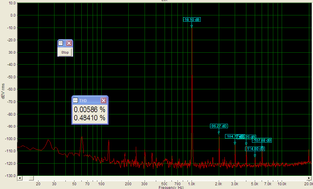

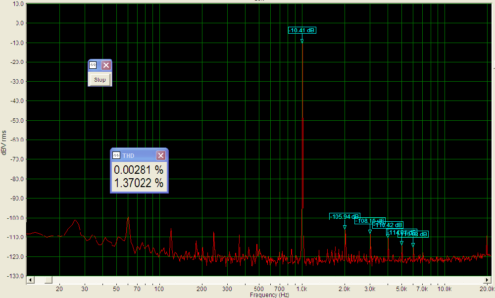

Thanks, Mike. That did the trick. Here's the THD image of the signal source input that I'll be using to drive the amps. I think it's good enough, definite improvement over what I was using before. What do you think?

Here symasym with 13.2 Vrms across an 8 ohm load. That's about 22 watts. Some of the fine noise you see between each harmonic is caused by the PC causing the plot to jump around from time to time.

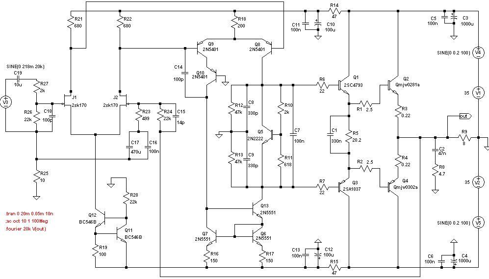

This is my modified symasym, with:
- 2sk170 (BL version) in LTP, matched at 6mA Ids
- wilson current mirror in VAS
- much linear drivers, 2sc4793/2sa1837
- good factory matched finals (mjw0302/0281)
Other modification consist in bigger tail current in LTP (Ids=3.3mA), little more VAS current than original (3.1mA), double class A drivers current (70mA) and bigger suck out capacitor (330nF)

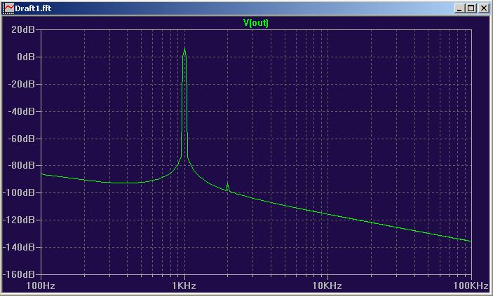

The results are:
1kHz, 1W, 8ohm, THD 0.0009%
1kHz, 10W, 8ohm, THD 0.0031%
1kHz, 50w, 8ohm, THD 0.0074%
20kHz,1W, 8ohm, THD 0.0022%
20kHz, 10W, 8ohm, THD 0.0078%
20kHz, 50w, 8ohm, THD 0.0189%
AC phaseshift at 20Khz < 1grd
All this results are simulated with LTSpice. I want to build it but first I need your expert opinion.
Thank you,
Mihai
1kHz, 1W, 8ohm

MikeB said:
Another suggestion: As you doubled the LTP-current, you might half R21/22 and reduce R18. (for symetrical clipping)
I guess, you should build it.
Mike [/B]
Thank you Mike
I already done that.
r21/22 = 340ohm, r18 = 72ohm and guess what 😀:
1kHz, 1W, 8ohm, THD 0.00088%
20Khz, 50W, 8 ohm, THD 0.01821%
