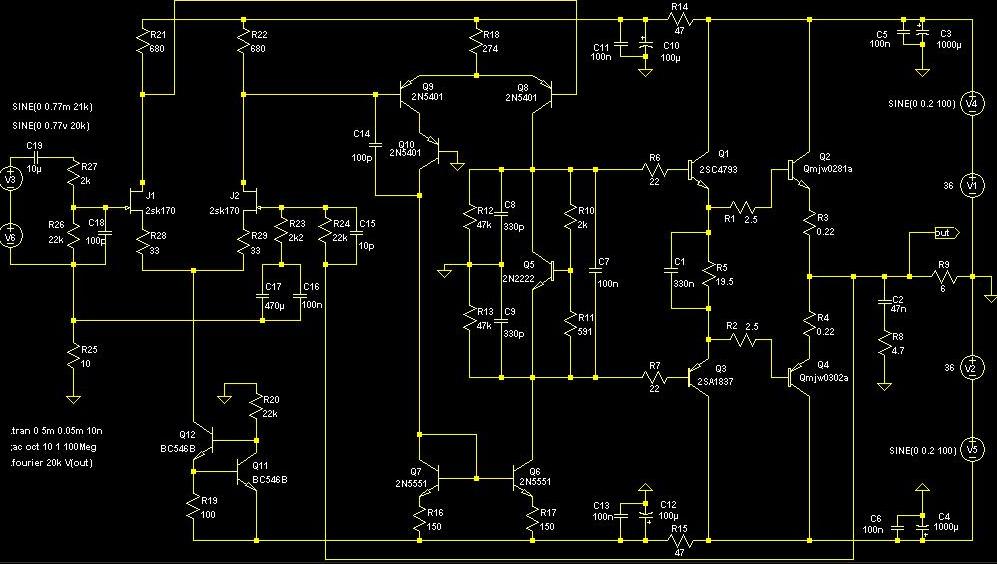

I want to decrease the gain of my symasym at 10. (my DAC have 6Vp-p output). The problem is that I'm not sure if it is wise to make source degeneration for 2sk170bl input pair.
In sym, if i use 33ohm source resistors and 2k2 instead of 499 feedback resistor the gain will be 10. The THD will decrease a little bit but I'm not shure if the amp will be sonicaly the same ...
What do you think about that?
Roender, symasym might degrade sonically if you have that large input signal. The problem is the large swing of the inputdiffamp. You also have to lower supplyvoltage to ~32v, otherwise you exceed max Vds of 40v for the sk170. Also, you will need even more than 33ohm degeneration to keep feedback levels at the old value.
In theory you should have a floating cascode to compensate for this inputsignal. Why is your DAC delivering that large signal ?
Mike
MikeB said:
Where has the wilson current mirror gone ?
You should take the Vds-threat to the sk170 serious, with a 6v input signal, vds to the jfets will increase to ~42v, killing them. With a 10% margin, you end up at supply voltage of max 31v.
Mike
This schematic is only for symulating. In sym, there is no difference with wilson CM, only in practice will improve thermal balance.
