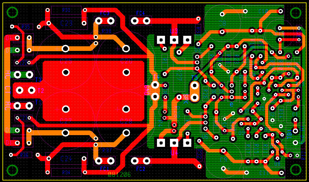

Here's the BOM for my PCB. I hope that I got all the parts, let me know if I goofed up anywhere. All the parts on the amplifier section are labled according to Mike's schematic. The PS is labled according to the schematic found in post #114. Also, label R23 near the bottom right mounting hole should be R12.
Al

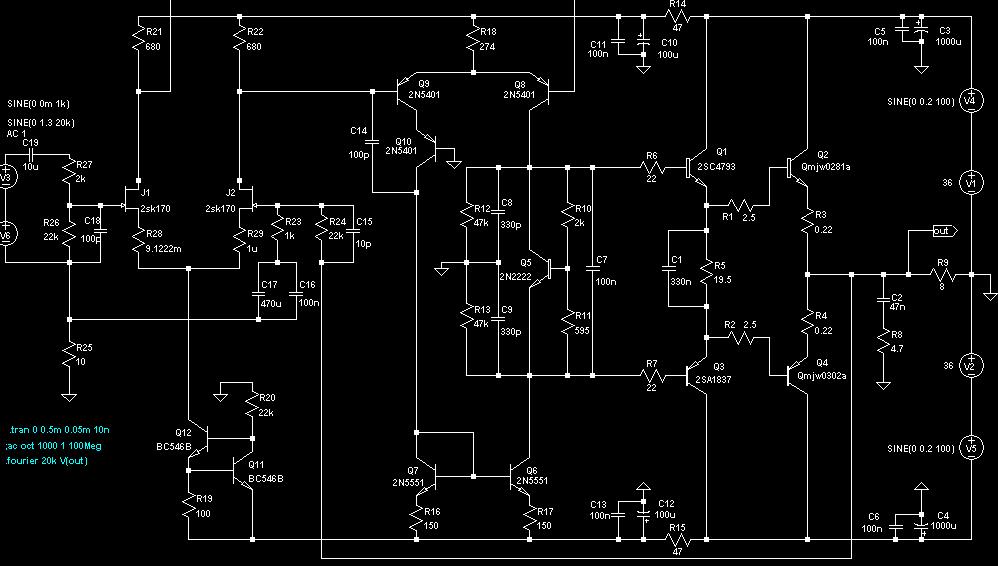

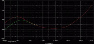

I make some measurements between original symasym and my amplifier, modified version with k170 and more tail current.
Open loop gain:
1kHz -> original 27400, mod 13800
10kHz -> original 22900, mod 11100
20kHz -> original 16100, mod 7700
100Khz -> original 3600, mod 1700
Slewrate:
original 23V/us, mod 18V/us
PhaseShift at 1Wrms/8ohm 20KHz:
original -3.8grd, mod -3.1grd
I want to reduce close loop gain by 2 but I don't know if the amplifier will be stable.
I can't do that in spice, I don't know how. Can you help me Mike?
I would like to use current mirror and jfef cascode ion the input stage and also a cascoded JFet current source. To my expirence that improves clarity and texture.
I also think tha the secondary filter would be better if devided into two sections r-c wit 22 ohm and 2000 microfrarads.
It could also be a good idea to insert diodes in front of R14-15
best MiB

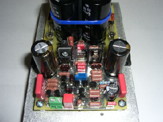

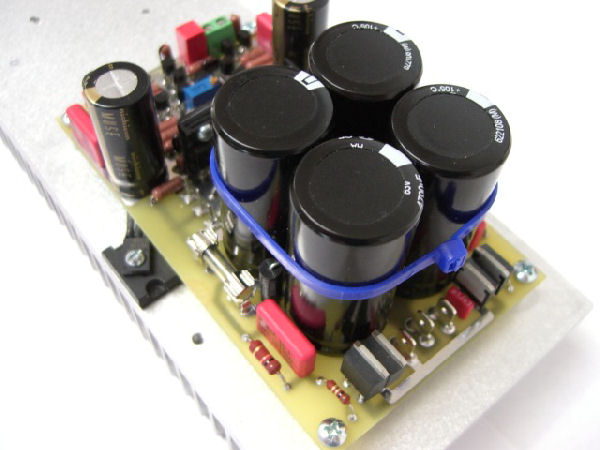

Hi all,
Well, good news. Everything works great with the new revised PCB. As you can see from the pic the output transistors no longer mount underneath the board. You'll need 4" of heatsink instead of three, but it's now DIY friendly. I'll post gerbers, and a revised BOM later today.
Al
