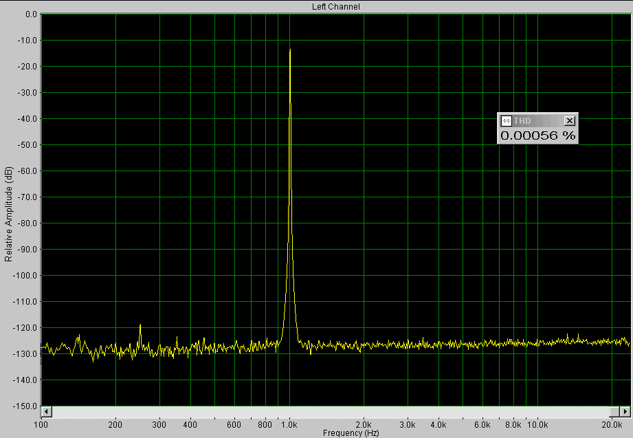

I finally got around to measuring THD this morning. I gotta say Symasym is an incredible design, I've built many kits, and never seen any measure this well. Of course how it sounds is what really matters. I'll get back to you soon on that. I measured THD at 50,200,1Khz, and 5khz into 8 and 4 ohm loads at 25watt/50 watts with the fundamental at -10db. The voltage output across each load measured 14.5Vrms. My source input is a little noisey so I included it as reference. Here's the numbers.
@50Hz 8ohms/25watts, 4/50watts
Input 2HD=-100db,3HD=96,4HD=114,5HD=101,6HD=111
Ouput/8 2HD=-109db,3HD=96,4HD=112,5HD=101,6HD=110
Ouput/4 2HD=-107db,3HD=96,4HD=114,5HD=103,6HD=109

Hmm, interesting and impressive measurings, funny that the 2nd harmonics gets lower through symasym... (Cancelling ?)
3rd harmonic seems unmeasurable, and all values dominated by signal source / measuring device ?
Good work !
How did you measure ? Soundcard ?

I found the cancelling to be interesting too. It made me check my setup a couple times to make sure everything was Ok. The cancelling on the 2nd harmonic happens only at 50Hz, and 200Hz. The odd harmonics appear to be flat throughout. I'll try increasing power to 50watts into 8ohms, and 100 watts into 4 to see what happens. It might be that running Symasym with 50v rails improves THD.
I measured the souncard, a USB Audigy 24-bit Live External, by connecting the line in and signal out together and setting my TrueAudio signal generator to 0.315Vrms/-10dB and measuring THD. I then connected the signal generator to the amp input, and using a voltage divider to drop the amp output from 14.5Vrms to 0.315Vrms I measured the amps output THD. I used SpectaPlus Real-Time Spectrum Analyzer version 5.0 to measure THD.

As Pavel might confirm, measuring is an "art". I spend some time configuring and testing, and finally got my soundcard distortionfree.
The signal generator included in spectralab is ... (bad c-word) ... useless.

I cranked up the power, still looks impressive. Just measured at 1Khz this time. Here's the measurements.
At 8ohms / 50watts, and 4ohms / 100 watts, 20Vrms
Input: 2HD=102, 3HD=107,4HD=107,5HD=96,6HD=112
8/out: 2HD= 95, 3HD=107,4HD=106,5HD=96,6HD=107
4/out: 2HD= 90, 3HD=100,4HD=100,5HD=95,6HD=102

I also noticed Symasym is dead quiet. With the inputs grounded the noise level is flat at -120dB. Not even 60Hz or harmonics of it anywhere. I hooked it to my speakers and with my ears touching the dust caps, I couldn't hear a hum or a hiss, amazing!!

AAK, nice measurings ! Were these tests already done with 50v supply ? (obviously with the 40v peak for 100wrms into 8ohm)
Its good visible that at 132w into 4ohms symasym runs out of power, giving a rise in 3rd harmonic. The 50w into 8 ohms seem to be done effortless, showing no 3rd harmonic yet.

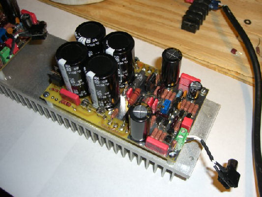

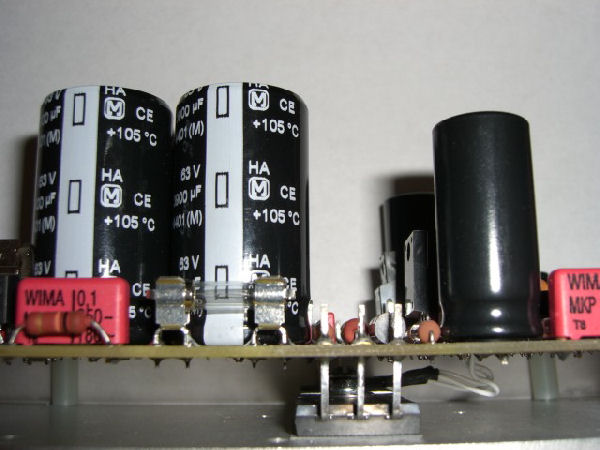

Hi Chris,
I'm working on it. I'll provide a schematic with the actual part numbers, and BOM. Also gerbers for top, bottom, and silk for those interested in building there own. The PCB program that I used is called Ivex, they went out business about three years ago. The program is very easy use, much easier than eagle, but not as powerful. I'd be glad to email the .exe plus provide any help necessary for those who would like to modify the board.
But, before I provide all this info on this forum I'd feel better emailing it to Mike so he can go over it to make sure everything is Ok for others to build.
As you can see from the pic, the board is very compact (5"x3") requiring the output and vas transistor to be mounted to the heat sink under the board. It can be a little tricky. I'll also provide some simple assembly instructions.
Best regards,
Al
