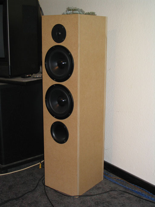

Chris, my speakers are DIY (of course...) Not very high end. (Visatons, 2xW170S8 + G20SC, 17cm woofers, 2cm textile dome tweeter, 2 way, 40Liters, tuned at 36hz, and a real mans port 50cm^2x25cm, diy crossover,90db eff)
But, i am quite happy with them, uncolorized, brute deep bass, detailed.
20hz is too low for them... Max excursion 20mm.
Ooops, a bit dusty, time for some cleaning... :ashamed:
Fernando, i see max voltage at 40v. Get a good powerful toroid. maybe 250watts (at least), 2x25v.
Hi Mike,
They look good. 20 Hz is definitely too low. Box tuning B4 or other? You may consider making the port more resistive.
I still have my prototypes of a double box construction with 8" Marsland image 8's and a Philips AD0163T8. They sounded good, but much better with the Peerless 8" and Peerless tweeter. The box design was in Weems. Woofer control was very good. Bass extension is silly low (28 Hz -3dB with the Peerless 8"). The Marslands can't touch the Peerless. So they live in the bedroom.
My speaker building was before i joint here... so i down't know jack about "B4 tuning". Simple F-3db tuning.
Have you already tried the peerless xls10 ?
I also built a woofer with -3db@25hz. This is painful... I don't use it. My room/wall/ceil has a resonance at ~23hz, feels like an earthquake.
Everything standing/lying around starts to make strange noises.
About the port, i used it extra large to get least resistance. :xeye:
