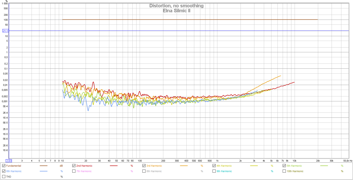

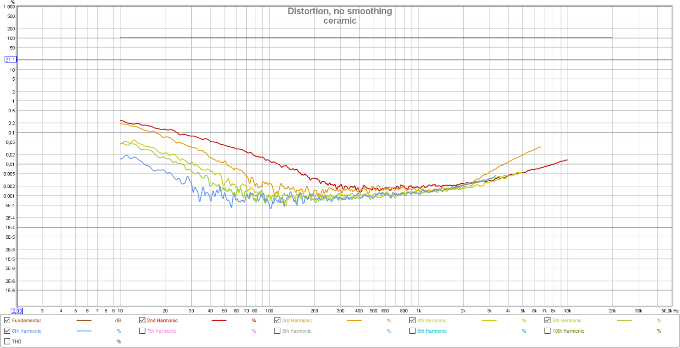

My mini tweak amplifier AA-AB32313:
  1. Removed schottky diodes D5-D12
  2. Replace power capacitors on Nichicon PM 2200x50V (supply voltage 32V)
  3. Replace the input ceramic capacitors on Elna Silmic II 10x16V
  4. Replace the fan on low noise - Noctua NF-A6x25 FLX
The two graphs. The first ceramic capacitors, the second with Elna Silmic II
What is the function of those Schottky diodes? They are not present in the ST reference circuit. Are they to prevent the outputs of one STA516BE from the other one during power-on?
Which ones are the input ceramic capacitors?
Most of the difference between the two graphs appear to be the lower frequency range (below 300Hz), what do you think was the main culprit?
This effect it only on the replacement of ceramic capacitors. It is easy to check. SW1 switch disables the effect of these capacitors.
This is normal for signal ac caps (high pass). Large cap is better for LF, but it will affect the HF as signal is going through longer path on a capacitor. So, an adequate value is essential. On the other hand, does the distortion on LF really matter? Despite of those modding tips, I'd also try upgrading the LM317s (if any).
