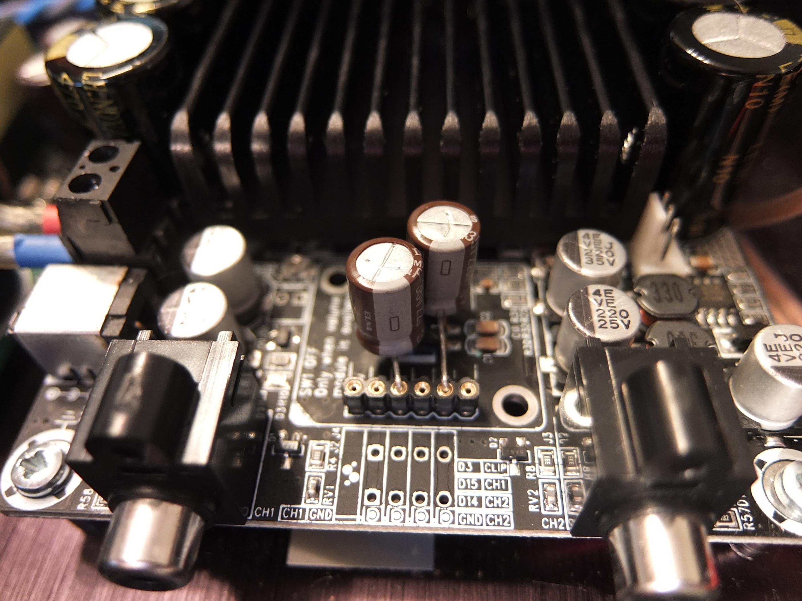

I am also very pleased with the sound of AA-AB32313. I have tried a lot of different amplifiers Class D. AA-AB32313 it is better that I could hear. The main amplifier in my house - Class A Pass Aleph. In direct comparison, AA-AB32313 and Pass Aleph, of course wins Class A. But the benefits are very small. In a blind test with a pause of 5 minutes I was probably not unlike those amplifiers.
Be sure to replace the input ceramic capacitors - SW1 OFF and install Elna Silmic II.

Power supply SMPS300R 30V adjustment at least 27V.
Linear power supply for this amplifier is not recommend to use.
canvas, I just got this amp. I am planning to his tweak. But without schematic diagrams make it difficult, it will take time.
The first thing I did was replacing the input ceramic capacitors for high-quality audio electrolytic - Elna Silmic II.
