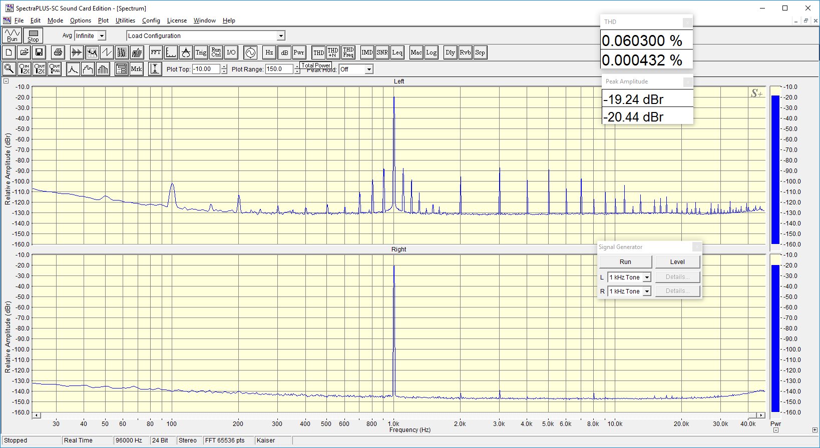

But I noticed that the THD at this amplifier about 0.02% at 5-10 watt. Mostly the second harmonic. In the same way as in the Pass Aleph.

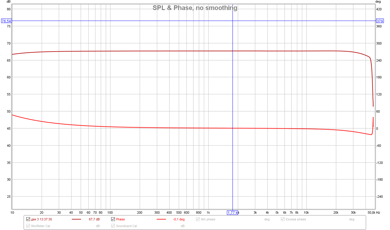

I make measurements Sure Electronics AA-AB32313.
All measurements are made at 10 watts of power and a load of 3.9 ohm.
The right channel (bottom) - loopback soundcard.
