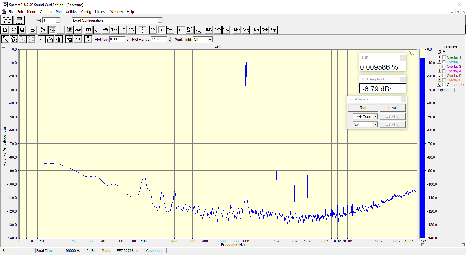

Sure Electronics AA-AB32313 2x400

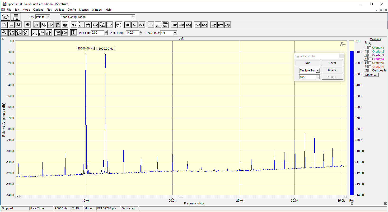

I make measurements Sure Electronics AA-AB32313.
All measurements are made at 10 watts of power and a load of 3.9 ohm.
The right channel (bottom) - loopback soundcard.
Thanks!
The fifth harmonic distortion appears to be a little on the high side, can you see anything else that is not as expected based on the specs?

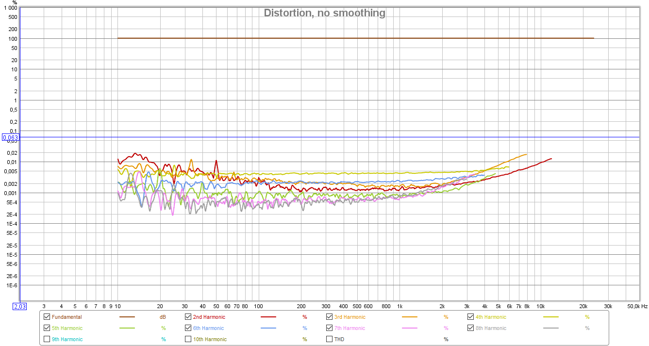

Is there any way you can repeat the measurements with a 8-ohm load?

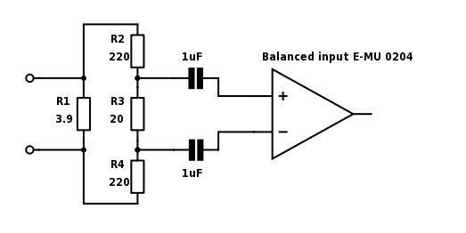

I think I made a mistake in the measurement.
For measuring amplifier in BTL mode I used this divider.
Do you think this schematic is correct?

I made measurements at 10 watts. The dependence on the power supply type is minimal. Recent measurements are made with a linear power supply of 45V from the amplifier NAD 326bee.
I was just wondering how much the supply voltage matters. The allowed range in the data sheet is quite large but I read somewhere that it "sounds" better with the voltage at the upper end.
