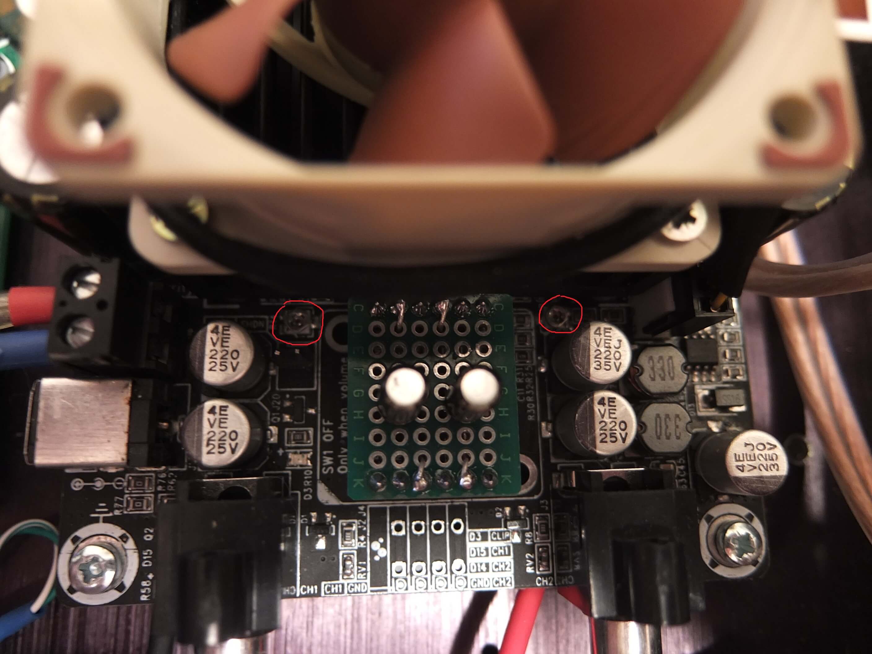

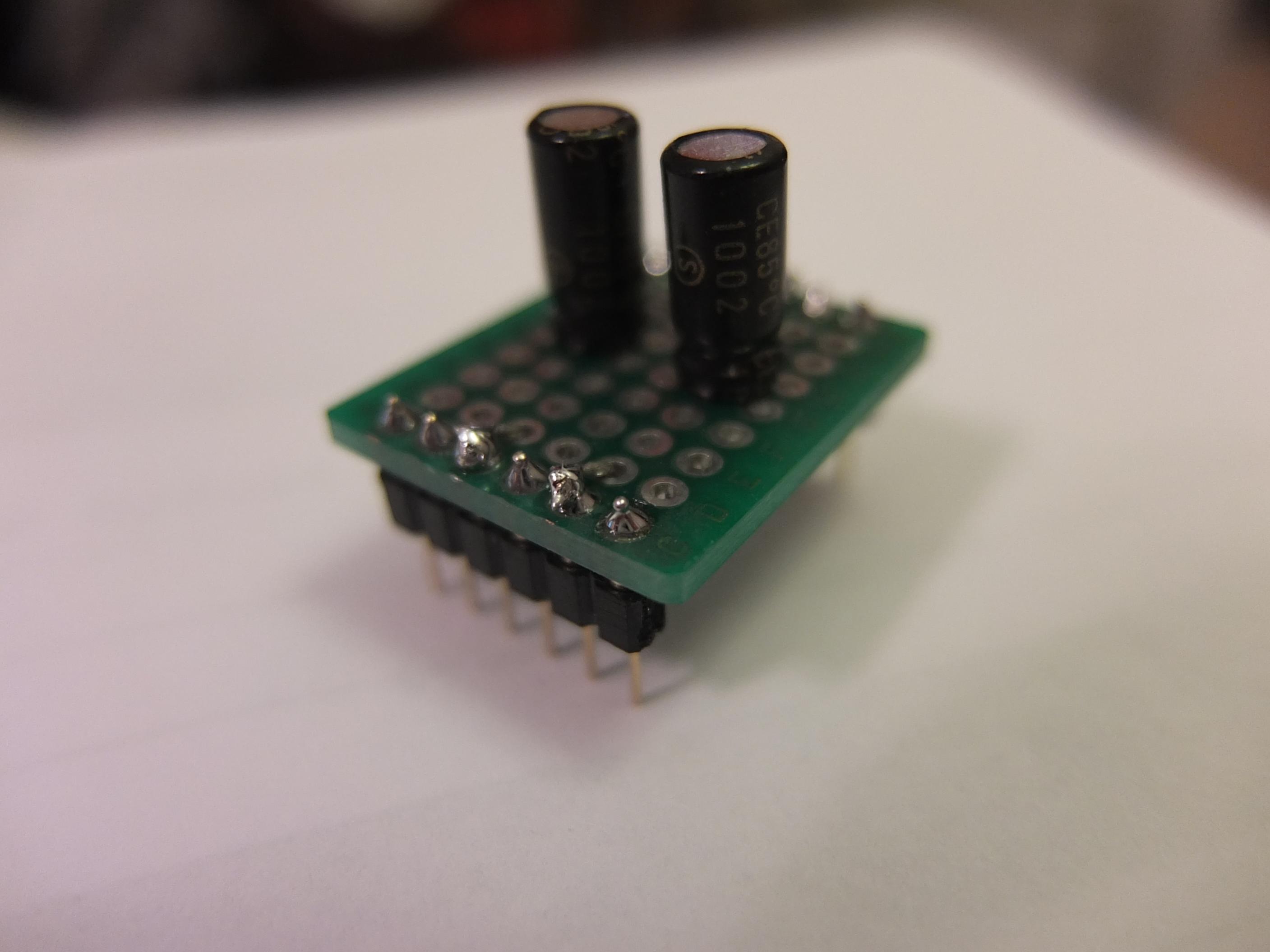

Hi!
I think you dont need to install it on the board! I need to take a closer look... But first idea was to use a dact style stepper... Let the big caps (all in stock) imho you only need 1uF -2.2uF outside in front of the rca ... Connect gnd of the dact with sure input gnd... Bypass c1/c2 with a bridge.
Regards

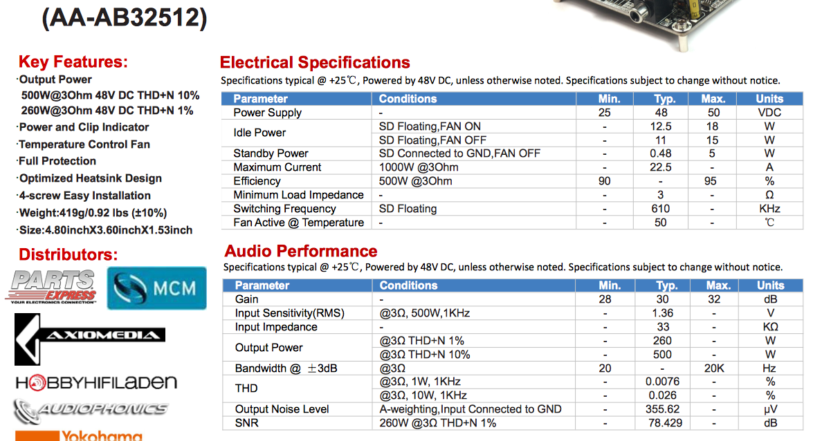

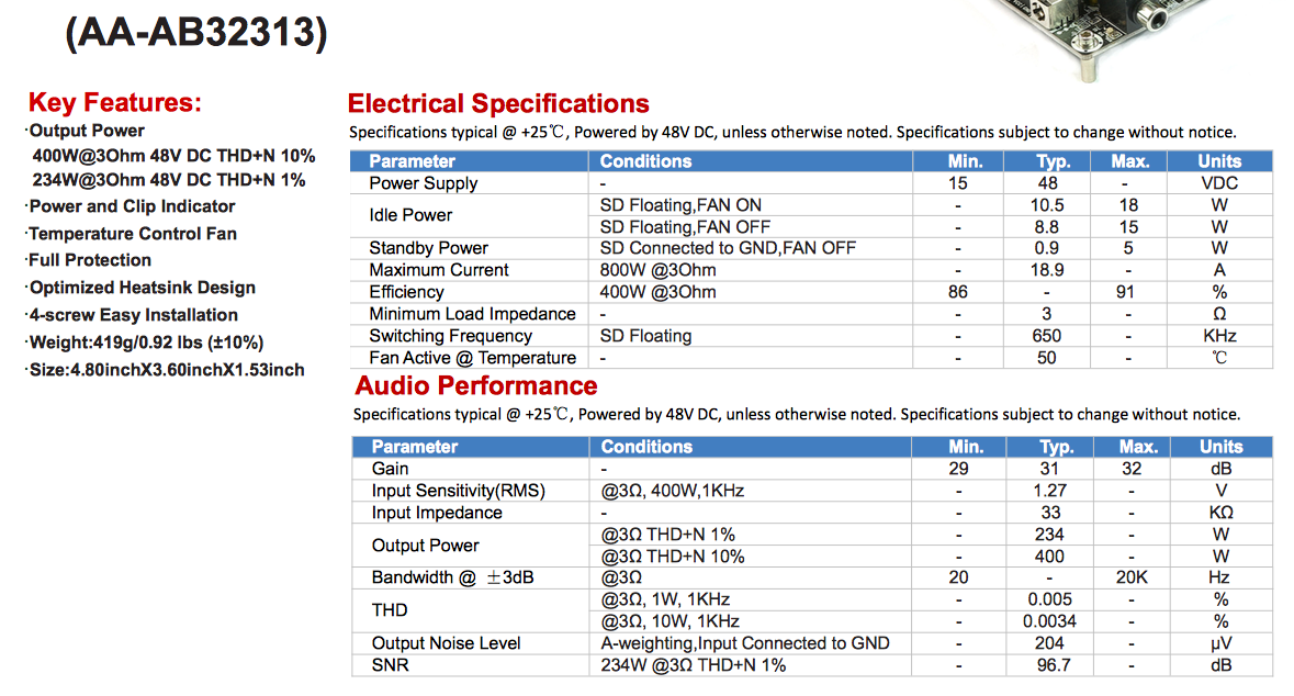

I am about to order the 32512 but before I ordered, I also asked the power rating of the 32313 to see their rating at 4&8 ohms speakers. Sure Elec. said the lower power rating for these amps are the same. For both boards, 36V 4Ohm 1% is 200W; at 36V 8Ohm 1% is 100W
Anybody thinks 32512 is still better over the 32313?

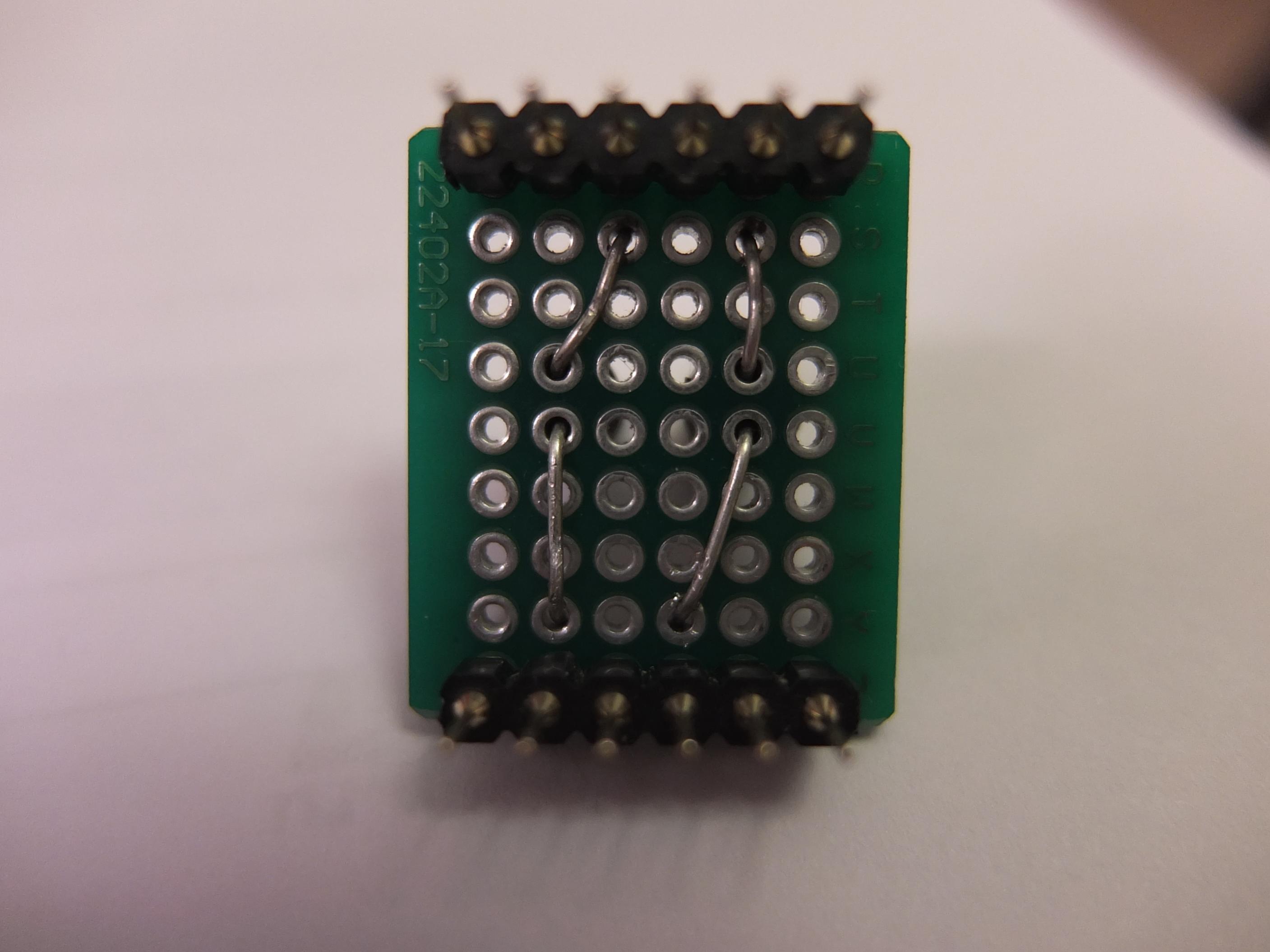

Be sure to replace the input ceramic capacitors - SW1 OFF and install Elna Silmic II.
Hi PPY,
Could you share the connection for the Elna input leads - i can only see one side.
Thank you
Hi PPY,
Thank you
