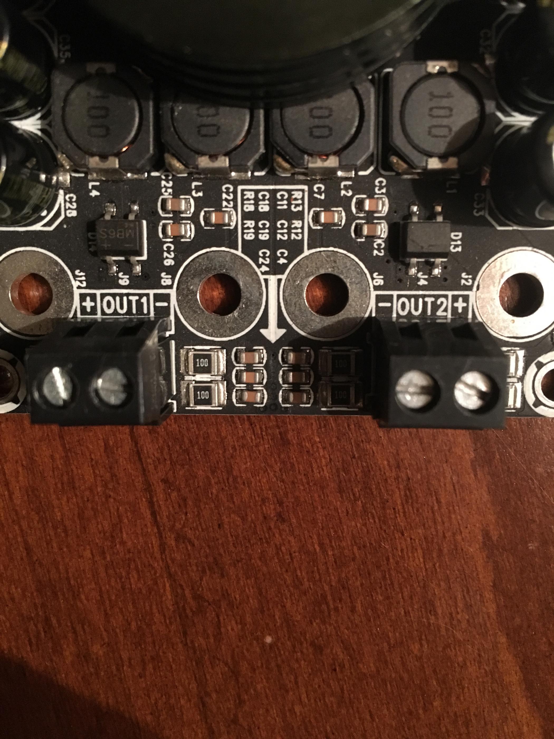

You probably don't know but some of Sure's TPA3116 boards including mine has +/- signs on right speaker channel (maybe left can't remember now) on the board but it is supposed to be the other way around. So, that's why I wanted to be extra careful.
That's right. - and GND are not always the same! On pretty much every bridge tied amplifier you may not connect the speaker negative (-) to the ground (GND).

No, what I mean was that Sure on some TPA3116 boards printed the signs wrong on the board. See the photo attached. Wrong speaker connection is not going to hurt anything physically but wrong AC connection will🙂
Wrong speaker connection is not going to hurt anything physically [...]
Well, as I mentioned above, if you connect the output wrong on a bridged amplifier, you will most likely fry it. So yes, a wrong speaker connection will hurt physically. I feel obligated to say that even knowing you 'only' meant switched + and - speaker connectors.
Edit: There are amplifiers which have layouts on which a + - - + connection for the speakers is in fact actually correct.
Yes I know the polarity for some PCB TPA3226 , but I have this PCB ans my friend too (2x400 le 2x500w, same PCB).
On this PCB, each indication are good. 🙂
