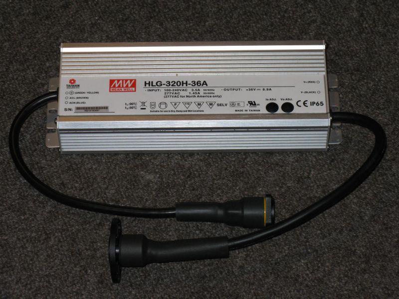

I finally ordered the AA-AB323512. I should receive it in few days. I am hoping I am getting the correct board (since there is a talk the 32512 orders turns out to be 32313, don't know which one is better) 🙂.
I am also thinking to buy the 36V Led Driver to use as PS. I wanted to ask a question about how to terminate these. Is there a certain way like the attached picture or can I just use typical male plug/connector as the AC Source/wall and the other end soldered to the board. Or can I just terminate with small DC plug/connector and just plug it to the DC jack that is already on the board?

I received my board today. It turns out they sent me a 32313 instead of the 32312 that I ordered.
Will contact them to get a refund for the price difference between the boards.
Looking forward to hear what board you get. Seems like it's a lottery.
Tomorrow comes the Mean Well HLG320H-36A I ordered from another supplier. Hopefully I'll find the time to try them next weekend together with a pre amp from Emblas Audio.
