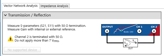

Good. Maybe you might want to investigate Omicron's "Bode 100" (web link) test equipment. A couple DIYA members have one, and use it to extract the loop gain and phase plots of real hardware (amplifiers, power supplies, test gear, etc). Occasionally they upload the Bode 100 plots here. Looks like slick gear, and sidesteps many of the doubts & worries about simulations.
I'd rather lose an arm than my Bode 100... ;-)
Jan
I found an old omicron application note on how to use it as an S-Parameter analyzer.
Isn't that standard? Are you running the latest V3 software?
Jan

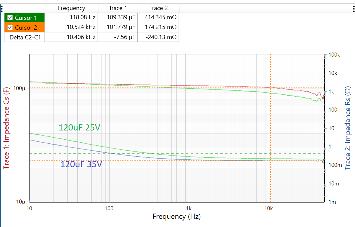

Jan, I noticed in one of your replies in another PS thread, you stated that the 120uF caps in the "Super Regulator" should not have low ESR.
First...120uF caps aren't as common as 100uF caps.
Second...after doing some searches at Mouser, I came up with these 120uF caps which have a ESR of 514mOhms:
860020675017 Wurth Electronics | Mouser
I've never heard of or purchased Wurth caps before, but do you think they will work okay in the "Super Regulator"?

I certainly don't need 200 pieces, but it's good to know that you have a good supply.
My understanding is that the Panasonic FC, FM and FR caps are all low ESR caps.
Are you saying that low ESR caps will work just as well as higher ESR caps in the SR?

The low ESR comment was for the cap on the output. This cap plays a role in the stability and should not be low ESR like some boutique film caps. This is most easily fulfilled by using any cheap electrolytic at that position.
The other electrolytics can be good quality and low ESR if preferred, but will have very little if any impact on performance.
Jan
You only need 4 per regulator, for a total of 8.
