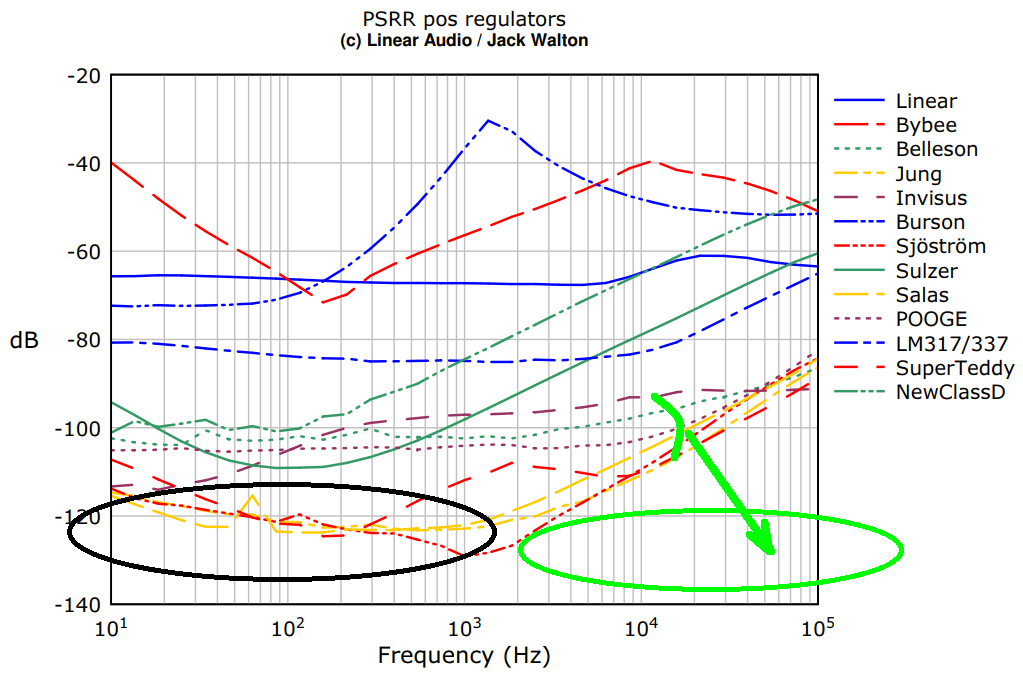

Since the graphs in the LA article clearly and unambiguously show that the awesome Jung/Didden Super Regulator's least-awesome feature is high frequency line rejection, I offer the respectful observation that any pre-regulator shenanigans should focus upon that.
Unfortunately, LM317-LM337 are particularly poor at HF line rejection, so (in my opinion!) they are rotten candidates for preregulating a Jung/Didden Super Regulator.
A few circuits that are excellent (in my opinion!) at HF line rejection include (i) properly damped LC filters; (ii) RF feedthru capacitors; (iii) capacitance multipliers / no-feedback Zener+BJT "regulators" using high-Early-voltage BJTs.

Certainly the instrumentation used in Linear Audio v.4, can't measure many kinds of improvements to HF Line Rejection, because the Rail Driver (used to inject a sine wave onto the Raw DC input) cannot drive more than 0.1 microfarads. See TAA 1/95 page 15 (on Walt Jung's website) for an explanation.
Fortunately, we know this. And we can arrange the series cascade of HF Line Rejection filters (located upstream of the Super Regulator, where the LM317 preregulator used to go), such that the first one has a teeny tiny input capacitance: less than 0.001 microfarads. This presents an especially easy load to the Rail Driver. With the Rail Driver working in its comfort zone, there is good reason to be optimistic that the complete instrumentation apparatus will be able to measure excellent Line Rejection at the right end of the plot (green oval), just as it already measures excellent Line Rejection at the left end of the plot (black oval).

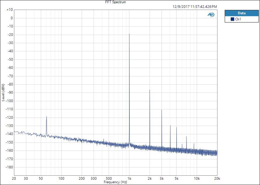

I started this quest a year plus ago attempting to improve the sound of a headphone amplifier, the overall SNR and THD+N were not bad for a tube. I posted a FFT here on diyAudio, a fellow poster asked what all the junk was on the noise floor. Averaging removed the real random noise. What remained were mains frequency/harmonics and intermodulation distortion spikes.
The test results show that the power supply is an integral part of the amplifier performance.
