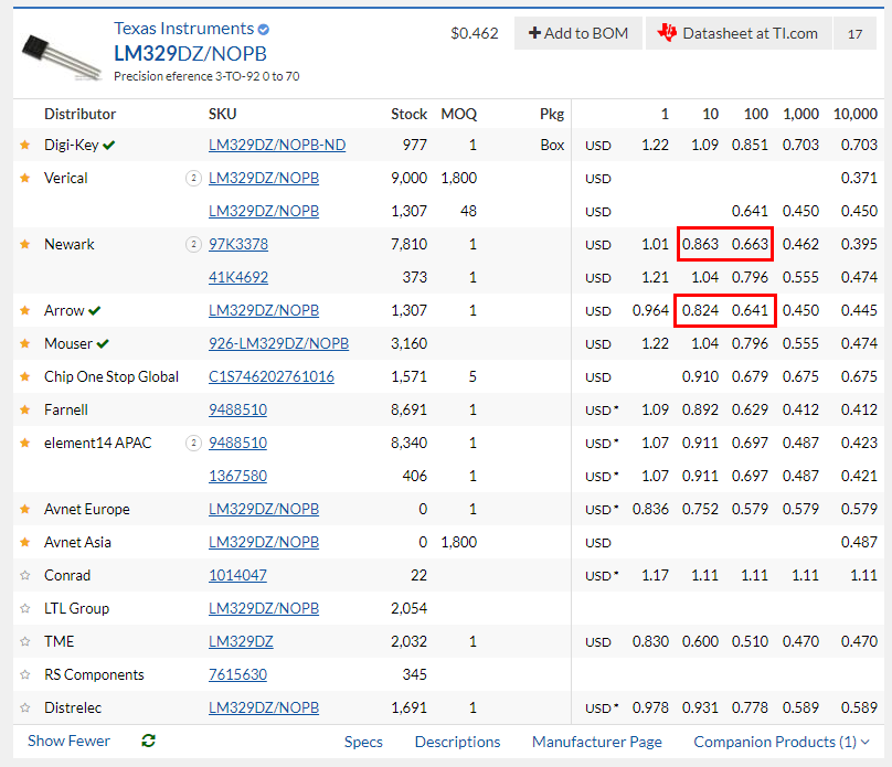

Since the old National LM329 is now on T.I.'s "chopping block" and soon to be discontinued, what is a suitable replacement and what if any resistor values will need to be changed for the replacement?

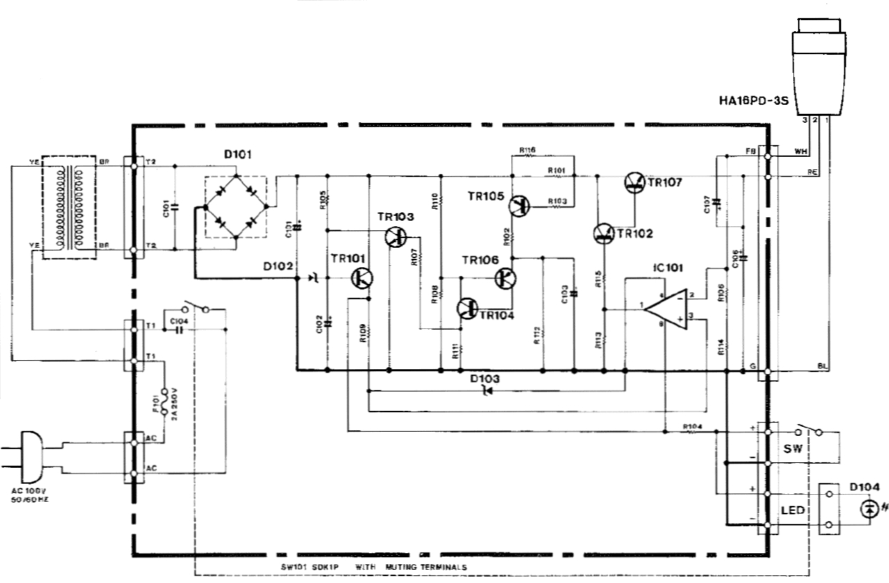

I‘m in the process to change one of my sr-boards to serve for 24 V outputs. I need it to feed my turntable. It has a 3 pole power connector, +24, sense, Ground. The sense line provides not 24, but 6V when working with the original part, so one part of the resistive divider is inside the turntable. I would prefer not to open it. Any idea how to apply this to the superreg? The circuit of the original device has 9k between pin 2 (of the sensing opamp) and ground, so I guess it‘s 27k inside the turntable. I‘d need a 12 V zener at the opamps output, choose an appropriate bias resistor for the ref-diode, and choose a lower voltage ref-diode, but can it work at all? What is the net-aquivalent restistance of the whole assembly? Or, if I form a resistive divider with another 27k resistor (pin 2 of the connector to ground in the diagram of post #1462), would it work or would I loose any meaningful regulation capability due to the now high-impedance node?
(Sadly, a SM for the table seems unobtainable. Another user tried by simply feeding the 24V while ignoring the sense line, and the table did not work at all. But this is OT)
I could rebuild the original, but if there‘s shortcut using an old superreg-board i prefer that.
Looking at the schematics, you have more or less a super regulator and I'll doubt that you real can get an audible improvement.
Note I don‘t have this device, just came across the schematic. And instead of cloning it (which would be possible) I want to use a superreg.
LM329 is still an active part at LT ??
LM329 - 6.9V Precision Voltage Reference - Linear Technology
It can be replaced by a superreg; the only difference is that one of the feedback resistors (the top one) is actually in the unit. So you need to set the bottom resistor to the value for the required Vout, knowing that the top R is 6k iirc.
Because this is in fact 'remote sensing' you should fit the remote sense RC to avoid any instability due to long leads.

‚Remote sense RC‘ do you refer to R12/C15 (post #1462)?
Are you saying it has to sit close to the load (inside the table)? In this case I would have to open it anyway.
As i understand it, the sense line from table represents the net point of R9, R8, R35 and as such wouldn‘t be easy to adapt to the way the superreg sensing arrangement is done.
Or am I misinterpreting you?
