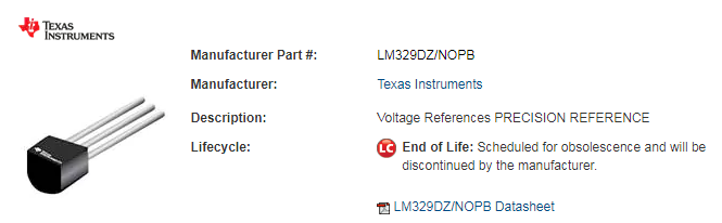

LM329 is still an active part at LT ??
LM329 - 6.9V Precision Voltage Reference - Linear Technology
Patrick
It may be at LT, but they're quite expensive.
I was referring to the T.I. version of the LM329DZ/NOPB soon to be discoed by them.
UPDATE: This evening I just won an eBay auction for 140 pcs. of LM329DZ made by National Semiconductor. These were obviously made before T.I.'s buyout of National and their change over to all that lead-free garbage.

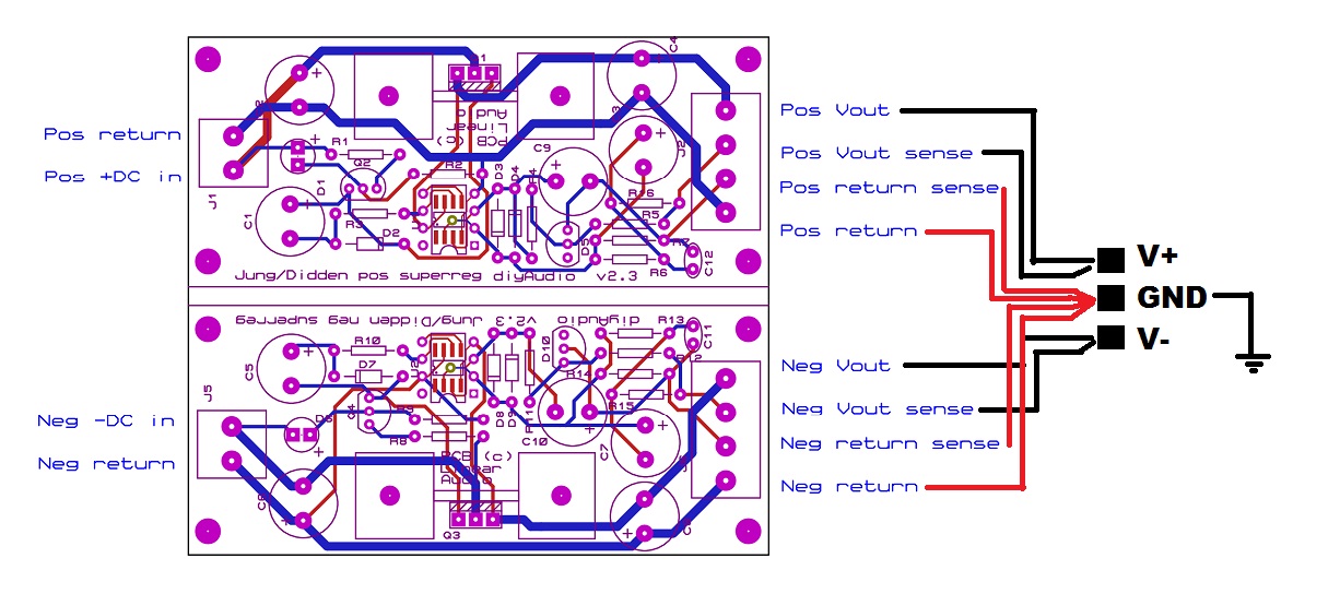

This looks perfectly OK. The point to remember is, that the point where you have the cleanest power is where the sense lines are connected to. The word 'sense' is quite literally: that is where the reg senses the voltage and regulates it.
By using remote sense you also correct for voltage drop due to R and L of the power connecting wires. This doesn't work well for very high frequencies due to the L, so that is why you need the little filter in the sense line, but for (high above) audio it is fine.

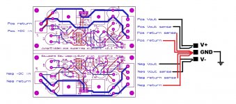

Thanks Jan for your reply,
The design of this super reg that look like a universal design for many purpose more than only for split supply. Can i joint POS return and NEG return at one point and route to GND of load? It will help me saving one wire.
It will save you one wire but the pos reg will try to compensate for voltage drop due to the neg return current and vice versa. Keeping the returns separate is crucial for best performance.
Read my previous post again carefully ;-)
Jan
The low noise reference voltage LM329DZ has already EOL, so what can be replaced for this job?!

Checking findchips.com, there appear to be about 30,000 LM329DZ available at US distributors.
When a semiconductor product goes EOL, it doesn't go to heaven, it goes to Rochester Electronics.
Where do you read that? I read "Not recommend for new designs" at TI.comThe low noise reference voltage LM329DZ has already EOL, so what can be replaced for this job?...

Mark, did you find this info at TI?figure 1 and figure 2, attached.
