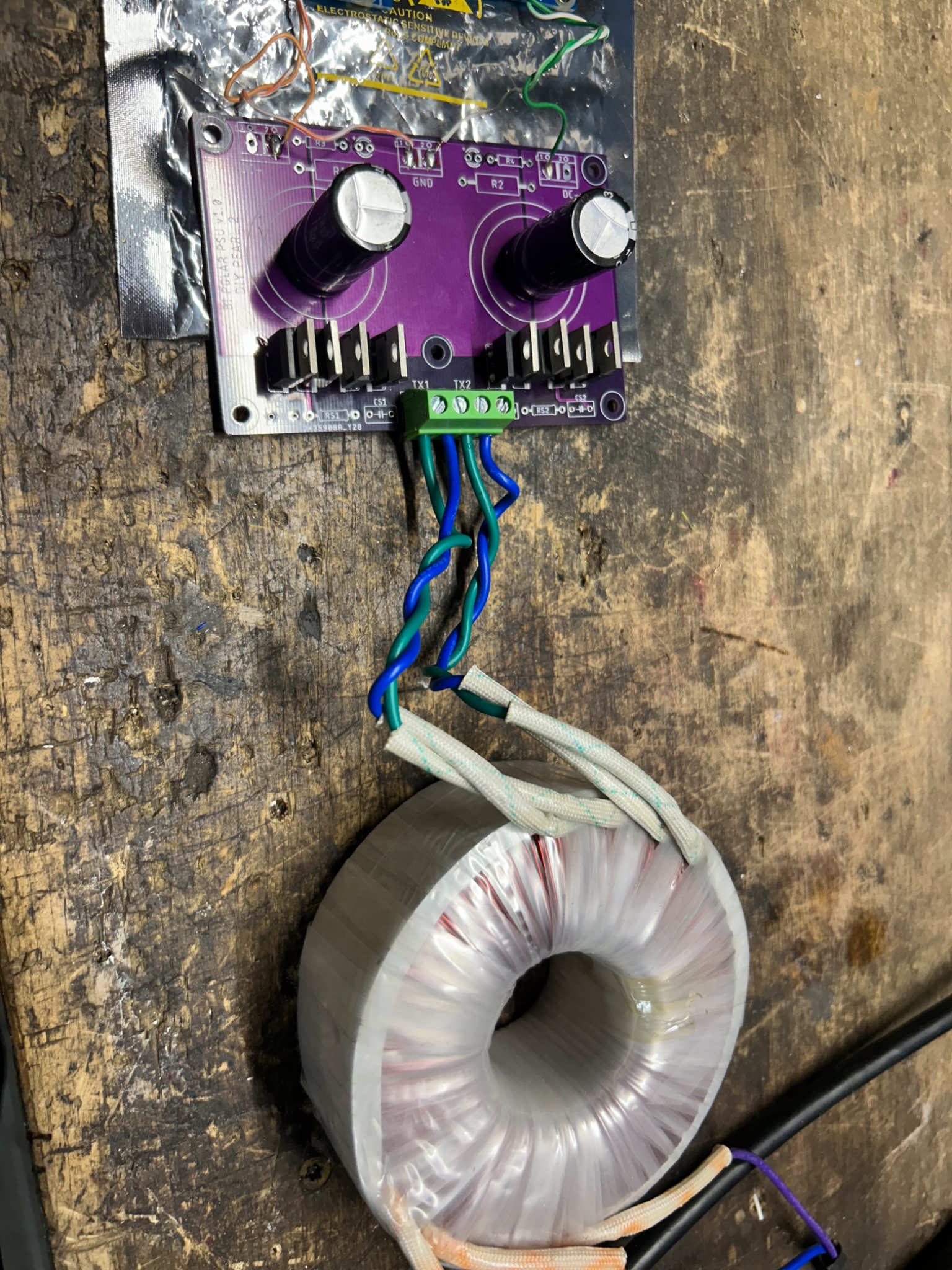

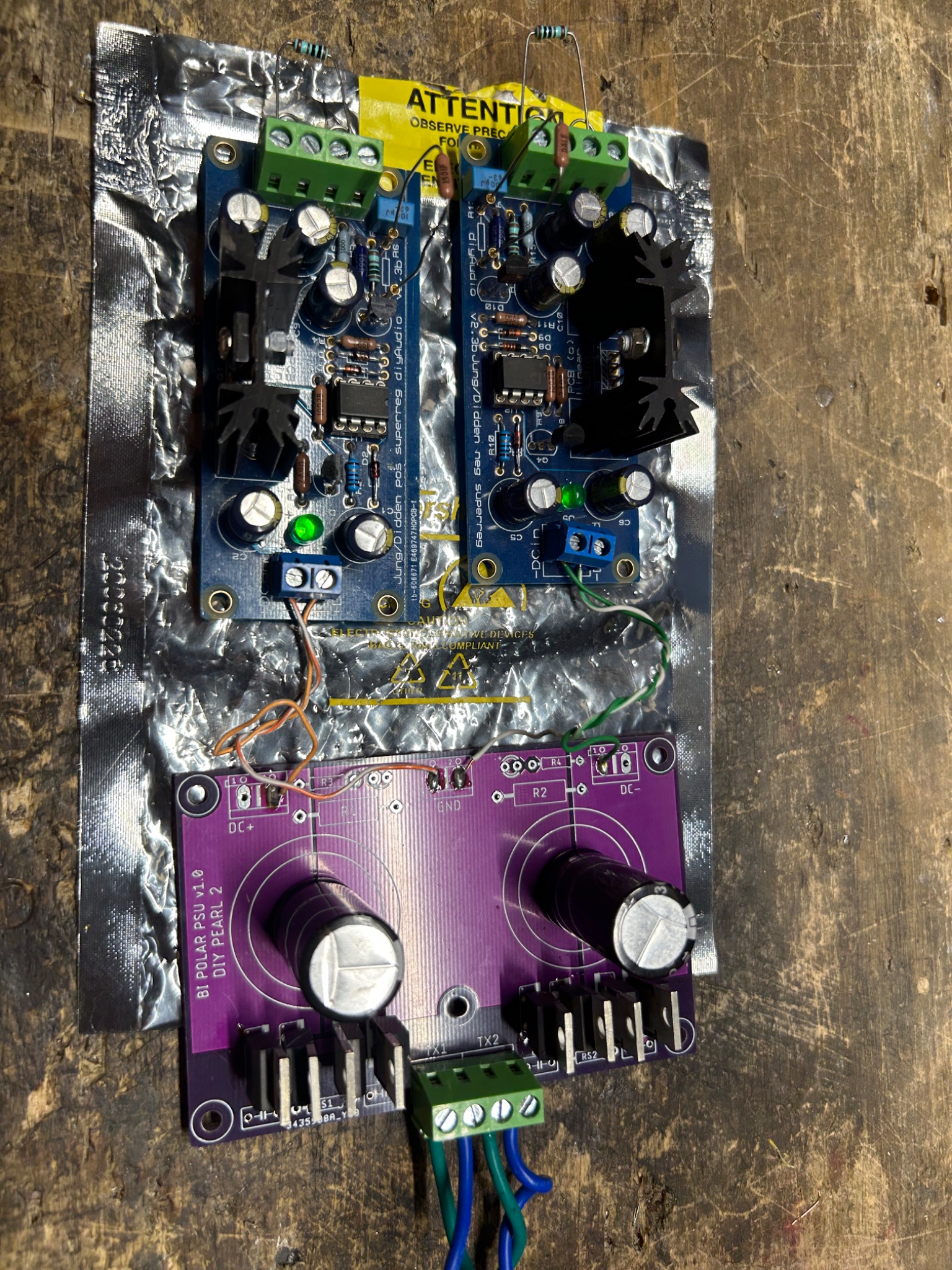

I finally got my super regulators going after 4 years of holding onto the boards. I am thinking I want to build a Pass Front End with this PSU or the BA3 Front end, so I am looking for correct parts for 24V+-.
Here is what I have now:
  • 6.9V Zener
  • AD 817 opamp
  • R7 - 1k
  • R16 - 100 ohm
  • R6 - 2.4k
I am seeing approx. 24V on the outputs with 26.5V input. I plan to increase the input voltage by getting a slightly larger transformer, but I wanted to first see if I should make any changes to my Zener or my opamp. I saw somewhere a 10V zener is better for 24V.
I have some OPA1611 I can use which I saw were recommended over the AD817.
Thank you.

AD817 is a bit noisier than the AD848 Walt used in the seminal articles from 1995 (15nV/RtHz vs 5nV/RtHz). In the final analysis it should work fine. While AD797 tests best, it can break into oscillation if you look at it cross-wise.
I have used LME49710 with great results.
BTW, you are "gaining up" the noise of the Zener diode. Analog Devices webstore had a few pieces of LM329 in stock. Use www.findchips.com search engine.
I just went through my parts draw and I have almost every part to go with a Wayne’s preamp with 18V+-
I think I’ll go this route to be safe, keep the 6.9V zeneer and use the opa1611.
Any issue with using 26.75V input to drop to 18V-20V with these parts?
I have a 20VAC dual secondary Antek I would like to use.
