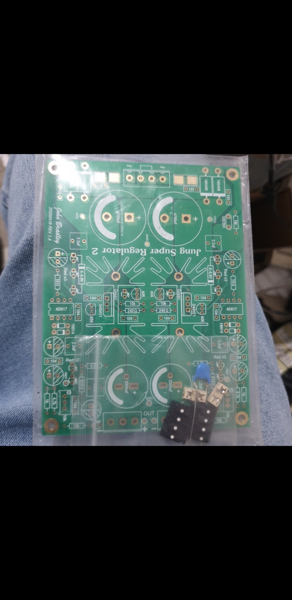

Hi. Everyone telling different things and I am confused. I have 10 empty boards and I have SMD lm4562 3pcs and dip lm4562 2pcs and dip ne5534 10pcs. And SMD opa627 8pcs. Which ones may be more suitable? I am not looking for something too good - ultra high end. Just want 3-5x better than lm317 may be ok for me.
I think ad817 is ok for me as I read they don't oscillate but I should buy them. Here my boards. I will use them for dual 15v typical active crossover boards or preamps and maybe 6/24 crossover and some for Jlh amps.Opamps are a bit expensive

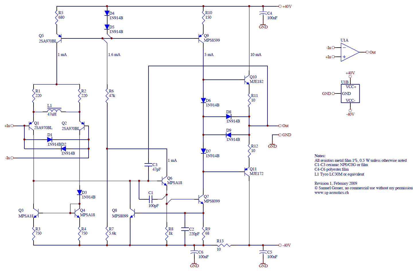

If that's true then I find it misleading to claim "Most audio devices work with an internal operating voltage of +/-15 volts and can thus process a maximum input level of +21.5 dBu." Especially since Jensen + John Hardy have been selling discrete JE-990 opamps with ±24V power supplies to the professional audio market since 1980. So has Samuel Groner; I've attached a ±40V discrete opamp of his. The pro audio guys have had excellent alternatives to ±15V IC opamps for 45 years.
I think it would be far more honest to say "Most IC opamps use +/- 15V power supplies, which can create maximum input level limitations when connected to professional audio gear whose circuitry can run on ±24V power supplies or larger. Therefore we designed our own proprietary opamps using discrete devices, and chose to run them at ±60V supplies. This ensures compatibility with everything in the pro audio domain, and it also gives us something unique to boast about in sales literature."

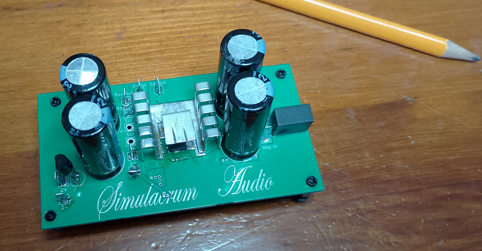

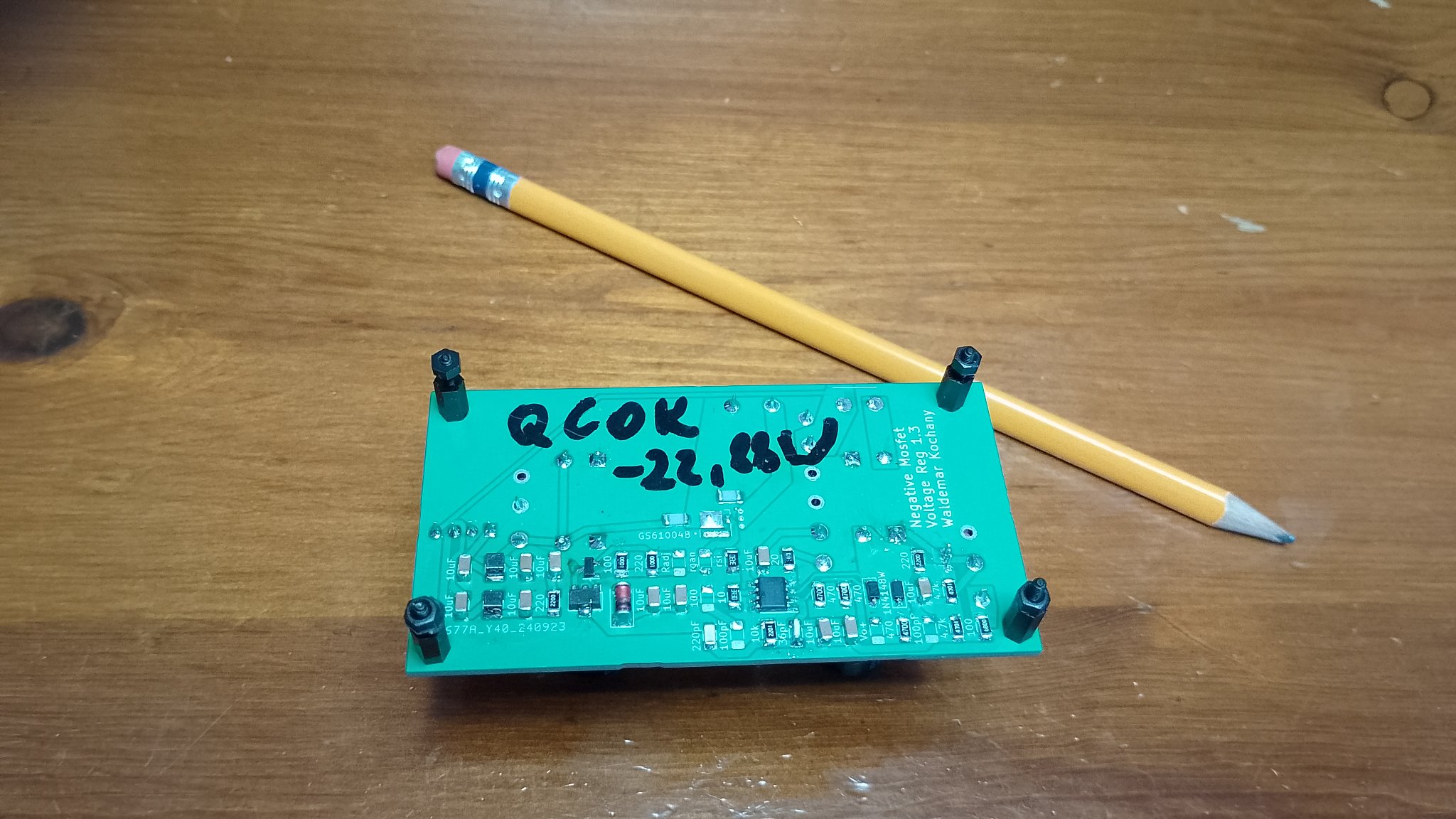

Here two photos of my earlier attempts, just for the eye joy and perhaps inspiration ;-)

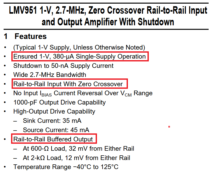

It should be possible in principle but I don't know if you can find an opamp that will run on 1.1V and accept 1V inputs.
That should be the first issue to solve.
Check the low voltage opamps at ADI and TI for instance, there may be some.
Of course you can always supply the opamp from the regulator input voltage whih can be much higher, for instance around 5V.
Jan
