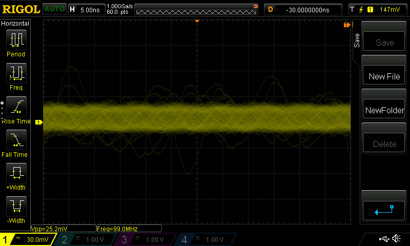

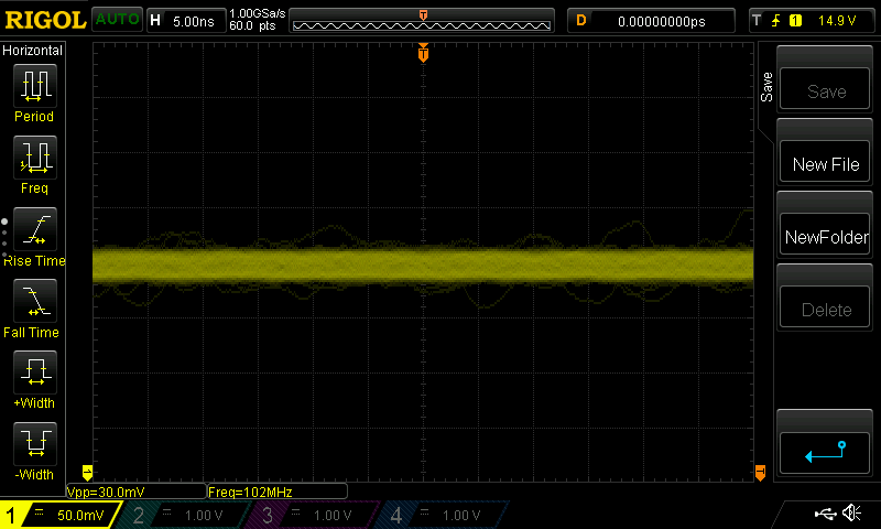

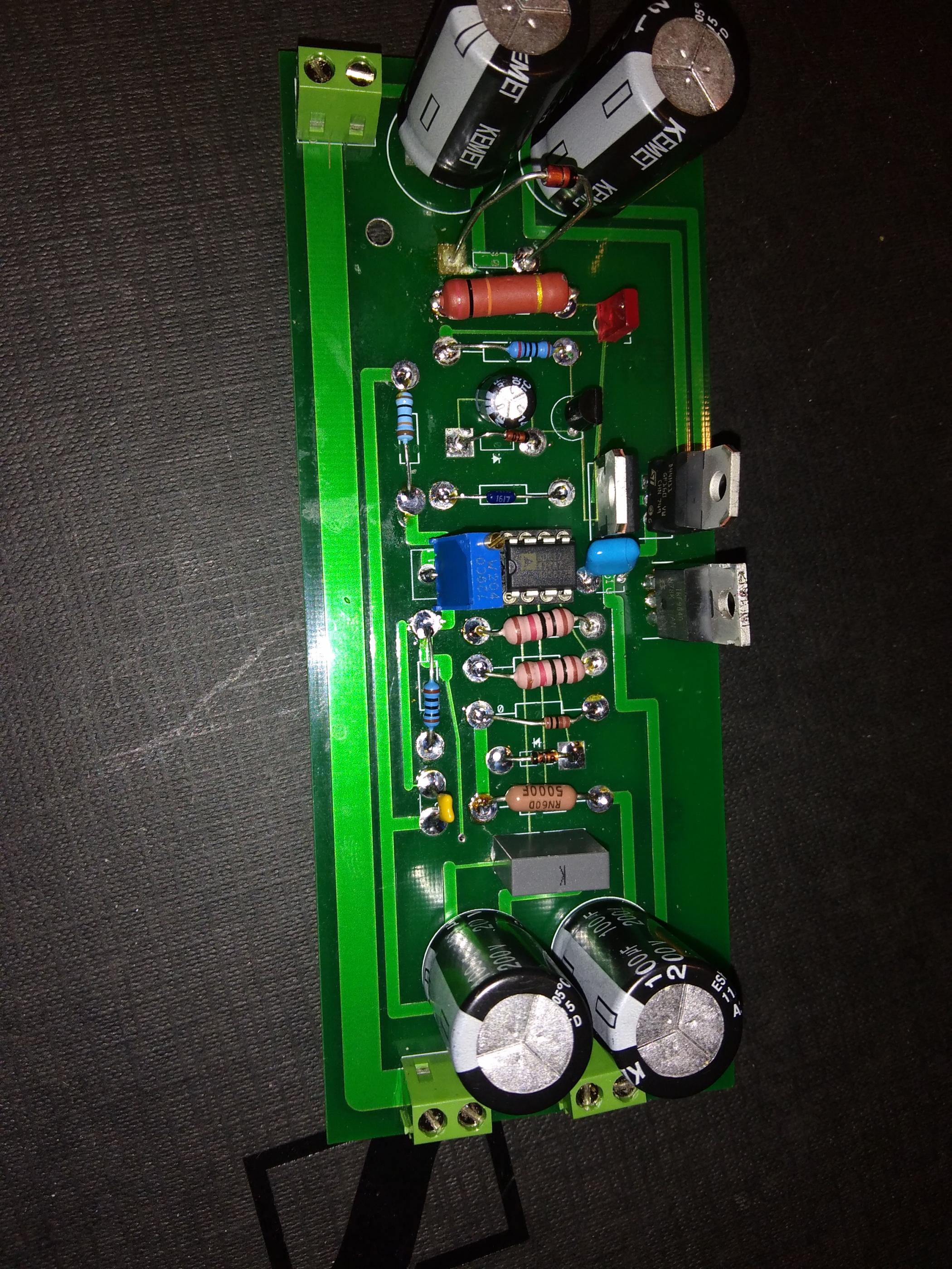

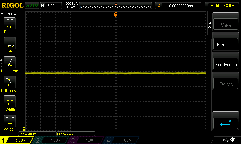

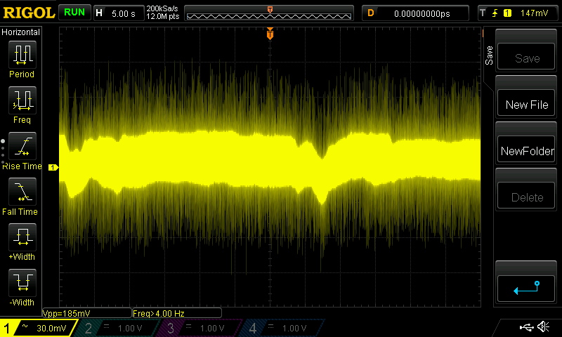

I had my own PCB super reg made with the purpose of running 105v @ 2A.
It's essentially the same as the one sold here but with a darlington output a circuit to prevent the opamp from overvolting.
I ran the scope on it and received some confusing results.
The top picture is of my 105v super reg.
The bottom picture is of the the 15v super reg sold here on the site.
On my version the scope shows no visual noise even at the max resolution of 5ns, it is so low the scope won't even register a frequency value. But it is showing a numerical value of 600mv of noise.
The 15v version is showing visual noise at 5ns but the numerical value is much lower at 30mv.
This is a confusing result. How can this be? What is true? Am I using the scope wrongly in some fundamental way?

Well in the top your vertical sens is 5V/div and 600mV seems realistic.
The bottom vert sens is 50mV/div. You're comparing two wildly different measurements.
BTW I appreciate you are rightly proud of your unit, but showing a schematic instead of a pic if you have a tech question is much more useful for those of us wanting to help ;-)
Jan
Why does the p-p voltage change with the time scale?
It doesn't. Look at the peaks, they really are the same. There's just not so many when you go to a faster timebase, and some of the higher ones are just missed.
The scope only 'sees' what is in the display window and when some of the highest are missed the lower ones are thought to 'be it'.

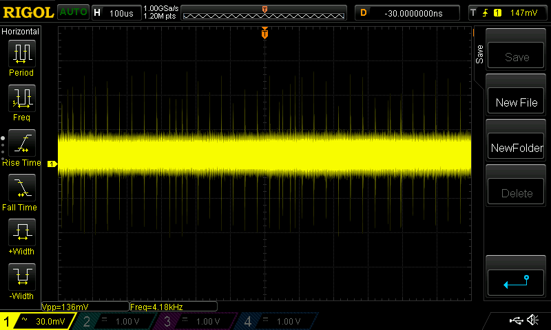

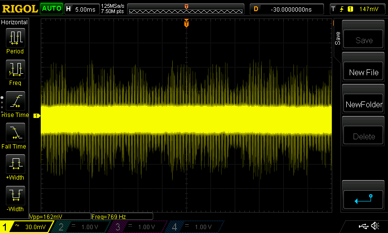

The measurement looks to be the same with the power supply off. Looks like background noise is screwing me here. At least that means the performance is probably where I want it to be, hopefully in the microvolt range.
Not sure how to get rid of the background oscillations though.
Almost looks like some switching stuff. Any dimmers nearby? An SMPS-powered solder iron? What do you see when you short the scope probe to its ground clip?

I'm in the basement so not unless it's coming through the floor. Although the master breaker board for the house is 3 feet away from my bench...Almost looks like some switching stuff. Any dimmers nearby? An SMPS-powered solder iron?
About 12mv of noise. 50% less than I get when it is not shorted.What do you see when you short the scope probe to its ground clip?
Thanks, I made a mistake in the picture though, R11 and R12 is connected to the output of the reg, not at the input.BTW Nice schematic.
I probably want to put some darlington discharge resistors in to make it faster, I didn't know that was a thing until after I had the PCB made.
Plus I get some weird latch up issue sometimes when I turn it on and the output gets stuck @ 15v until I short the collector and emitter of Q5. I'm guessing this has something to do with the fact that the discharge resistors are not in place.
If there's any way you can think of to improve it let me know.
