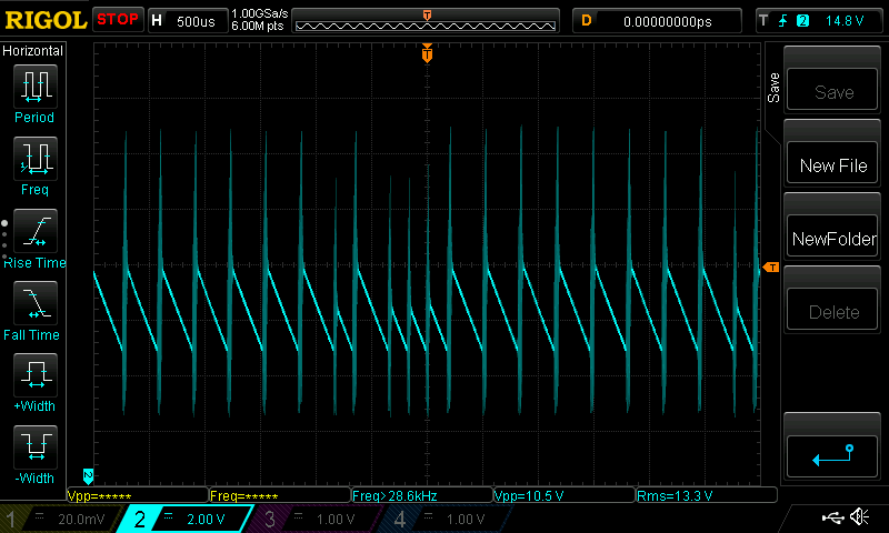

I also have another problem. I have a couple of super reg boards I made that a just like the positive reg I posted but without the virtual ground circuitry. It's just a normal super reg with a darlington. I had it up and running @ 1.1 amps no problem, today it is squealing like a dying pig.
I replaced all active components on board but it changed nothing.
The entire circuit is glued in place so literally nothing has changed before it started acting up.
Any idea what could cause this?
Yeah obviously something changed, I was just expressing my point of view. I certainly didn't change anything and I glued the circuit in place to prevent changing variables. I replaced all components on board and it still is oscillating. I was hoping to get some insight into what can cause such an oscillation so I can figure out how to fix it.

What is the oscillation frequency
I posted a pic of it above. It is not a "dimmer" or something, the opamp itself is literally acting as a very loud and annoying transducer. I wasn't kidding when I said it is squealing like a dying pig.
