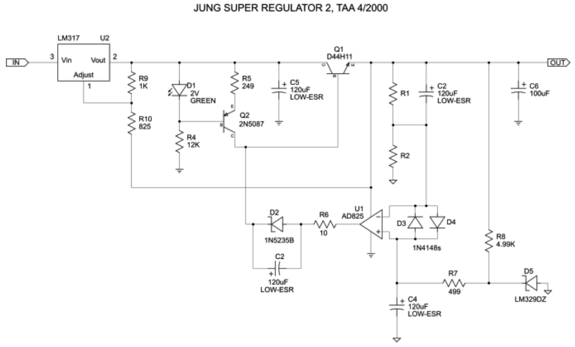

The schematic below shows a green LED with a 2V forward voltage.
Does the forward voltage have to be exactly 2V?
I see red LED's forward voltage can vary from 1.8-2.2V.

@kamis, you should have 5 volt or more difference between in and out and notice that this included the minimum voltage of the ripple. Can easily be determined by an oscilloscope.
I remember that Walt Jung described 1995 version as a LDO regulator. Input on my 30V regulators is only 37V without mains voltage drop reserve.
Depends on your definition of LDO - things have changed the last 20 years.
The theoretical absolute minimum dropout of a superreg is of course the LED voltage + pass device Vbe. So about 2.5V absolute minimum, depending on the type of LED. The 5V recommendation is a good one.

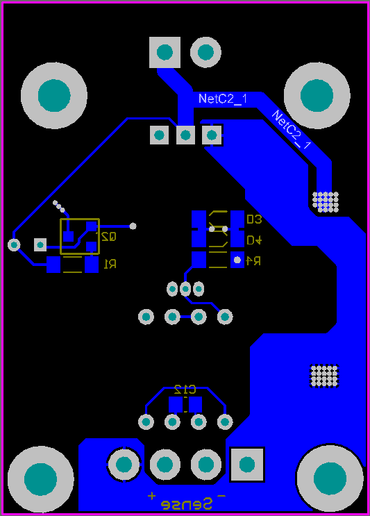

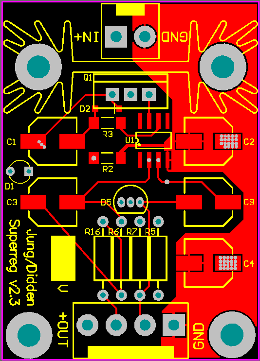

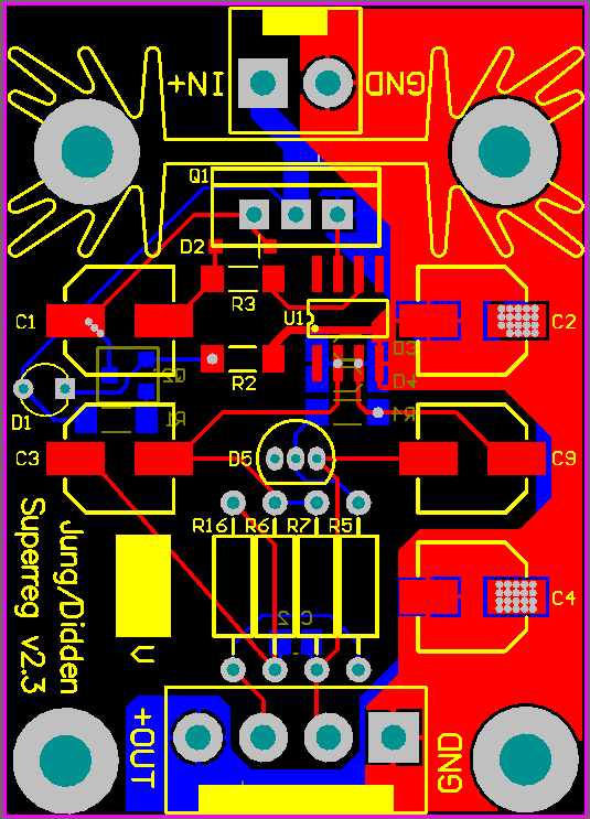

Hello all,
I'm building a new control/preamp unit with a RIAA and a DAC onboard and needs no less than 7 single regulators and I really wanted to use the excellent Jung/Didden superreg.
As the enclosure is given for the unit (read: small/medium size) 7 superegs in the original size wont fit. So I decided to make a SMD version.
The symmetrical placement of the components wasn't a goal of the design itself and just became natural during the layout process.
A few leaded resistors remains in the design to keep the noise as low as possible but I've properly screwed the performance with my PCB layout. 😀
Board size is: 35*49.3 mm
Now I need to do a sanity check of my layout and make the negative PCB version.

Kim have you considered using a SilentSwitcher for compactness and totally mains free operation?
What voltages do you need?
Jan
Jan
Jan
I indeed considered the SilentSwitcher. Nice toy! 😀
I need 5V, 9V, 12V and 15-18V.
On paper the supereg still looks as the reg with lowest noise and lowest impedance? The supereg also came out best of breed soundwise in linear audio... I'm in doubt about the SS.
I know it's all academic but my CDO(!) disorder always seems to get the last word in discussions with myself...
Can the SilentSwitcher compete soundwise with the supereg?
