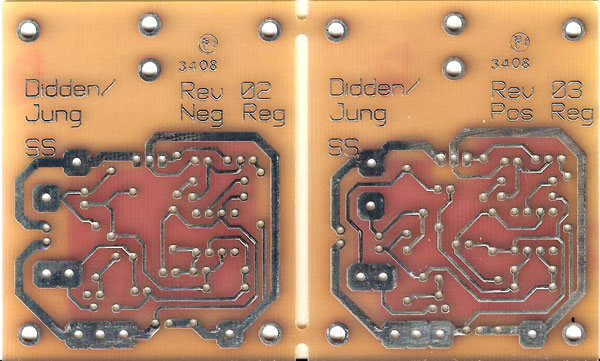

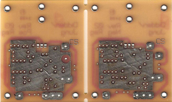

Attached are images of the original SR boards which were supplied by Old Colony back in the 1990's:

I know those PCBs 😎

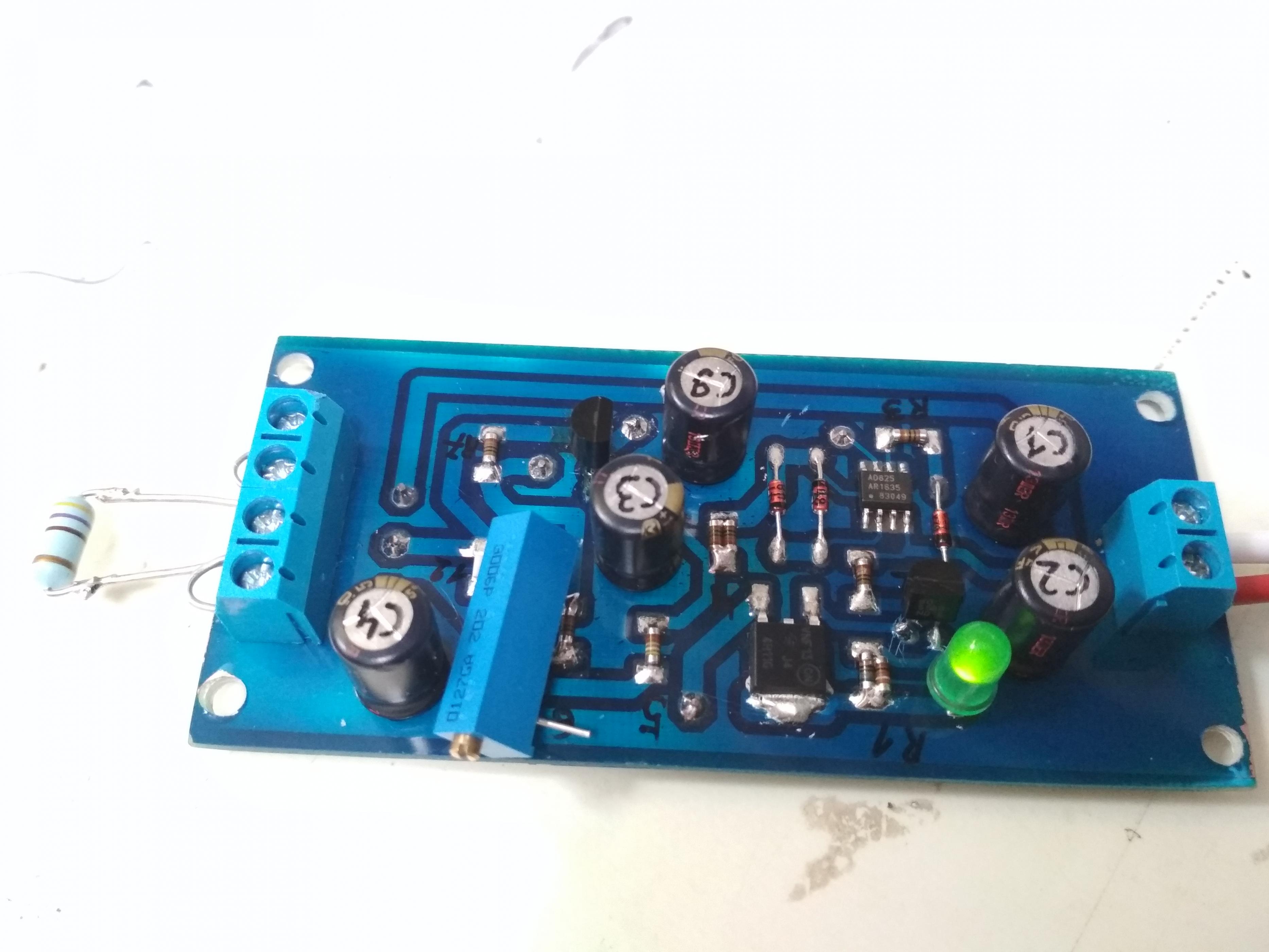

Hello, recently I build regulator (first positive side) and have no regulation at output. Green led lights up but are dim.
Measured some voltages:
Vin: 19.2V
Vout with 470ohm load: 18.2V
Gnd to op-amp pin2: 11.03V
Gnd to pin 3: 11.56V
op-amp supply: 18.2V
Gnd to pin6: 17.08v
Gnd to LM329 pin2: 12.15.
Any suggestions?

There should be not more than 7V across the '329. Did you measure on the pcb or on the pins of the device itself? Is the LM329 soldered correctly? Is there continuity from the leads at the body to the pcb tracks?
If you measured on the '329 pins and its more than 7V, it is broken.

I measure on pins and across j2-4 to R4, same result. But now I try to measure voltage on LM329 pin 3(gnd) to pin 1 (unused) and I read 5.72V, but this value is to low. Maybe my LM329 is different from datasheets found on internet.
Why are you measuring an unused pin??
What is the voltage between the two used pins?
Are you sure the '329 is inserted correctly? Are you using the diyaudio PCB?

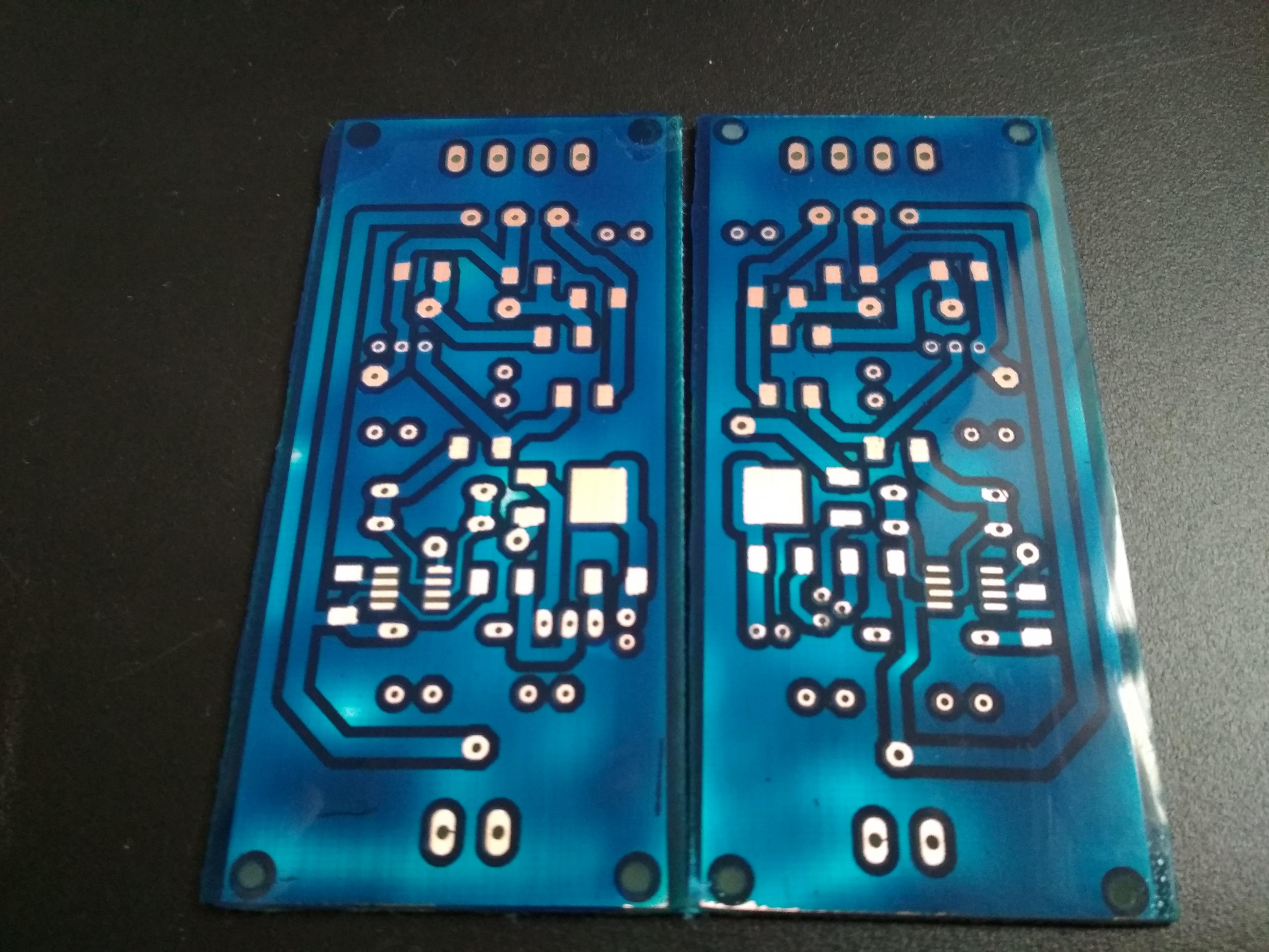

Some photos of my build. It is dual sided home made pcb 😀 Anyone know how much current I can go without heatsink on pass transistor? I will power with dual supply 6 op-amps I fink about ad797B.

Dissipation is current through pass device * voltage across the pass device.
How much current is 6 * AD797? Is in the data sheet, supply current.
How much voltage across the pass device? Vout = 6V, what is the input voltage?
You can do the sums. Once you know the dissipation, we can see if a heatsink is required or not.
(And please you guys out there who want to promote your favorite heatsink: I am trying to help him find it himself. Please don't spoil it).
