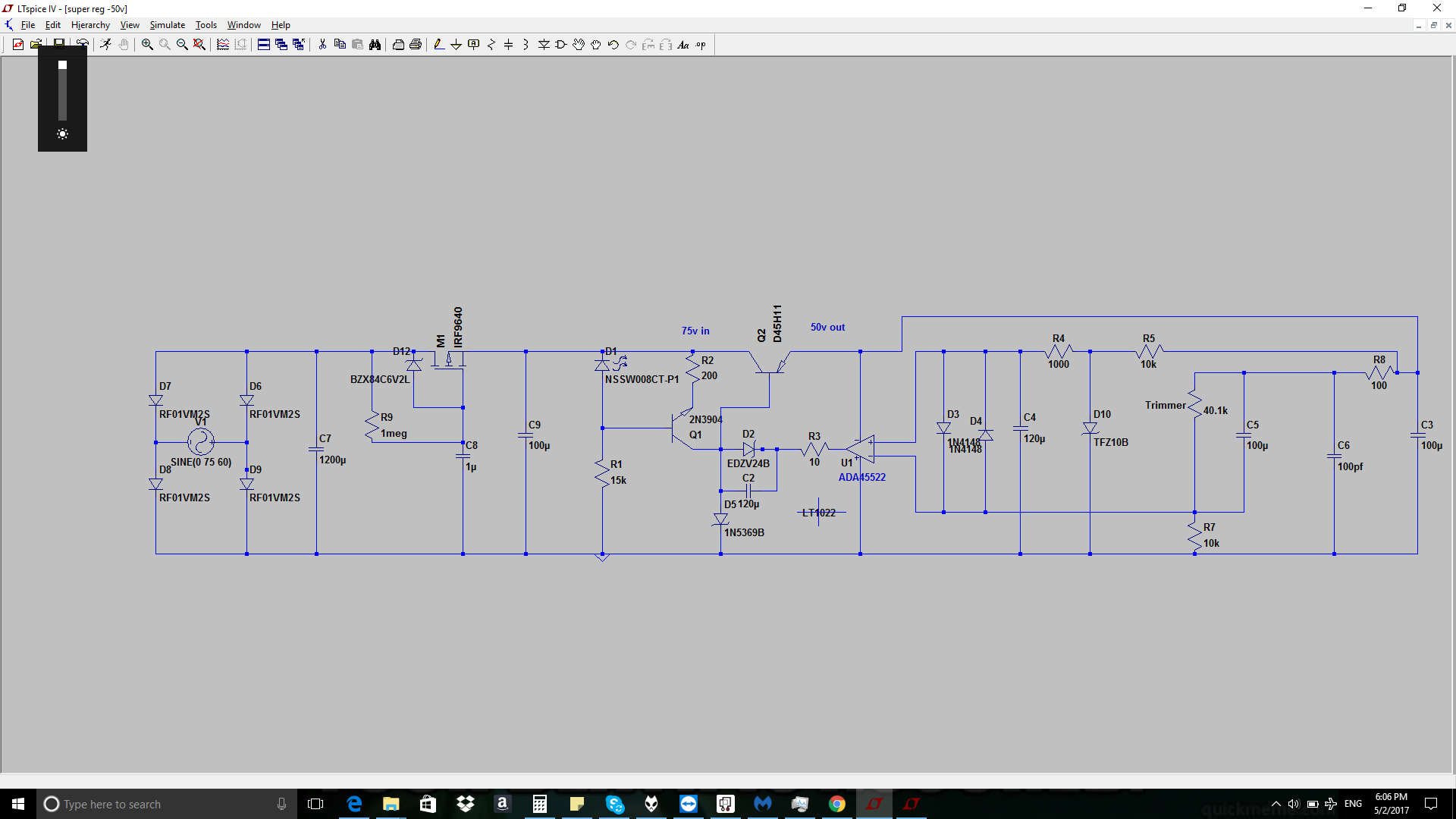

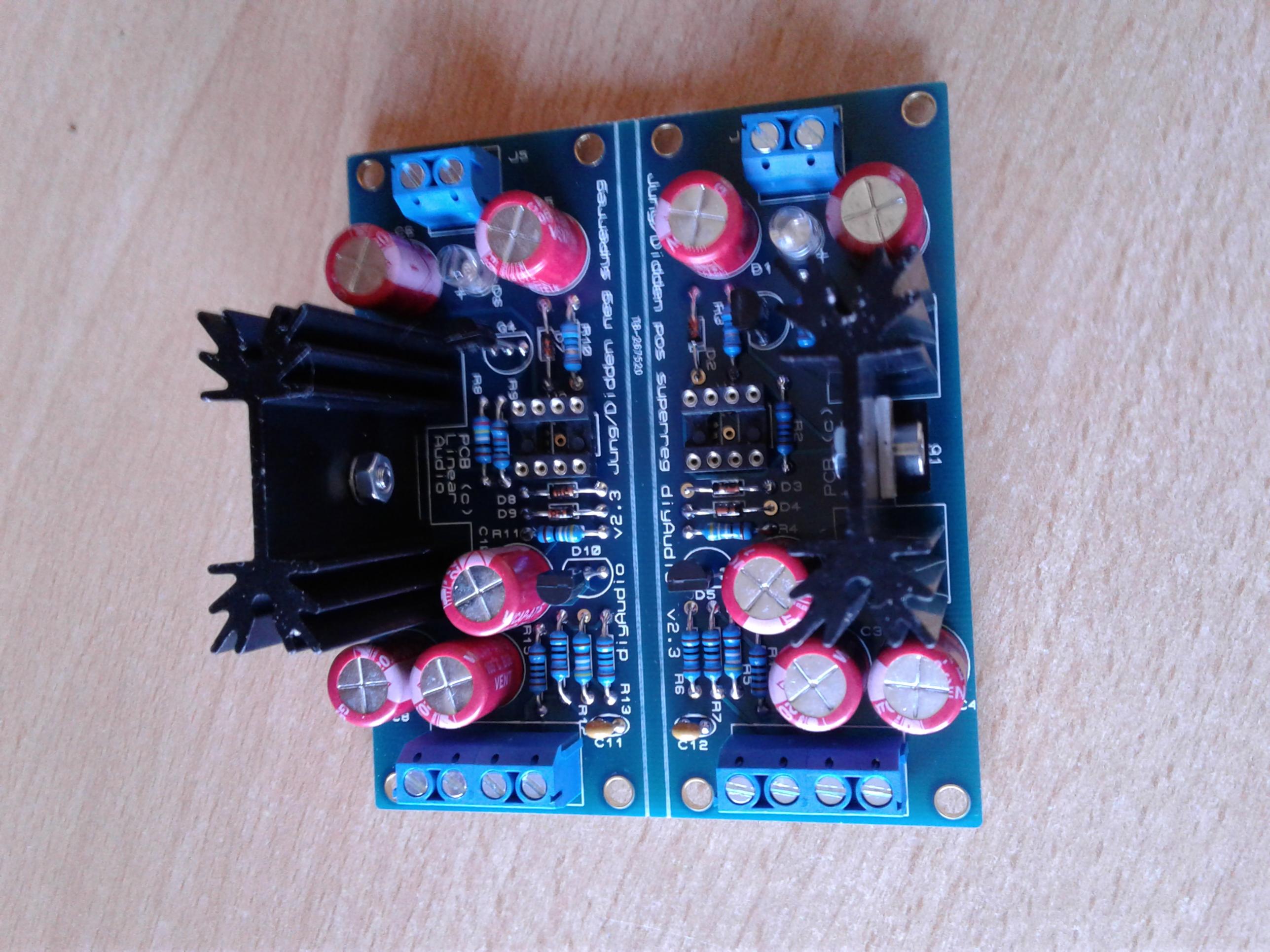

One side working, the other side: voltage too high
I'm having a problem with my super regulator.
I'm new to this, so not sure how to proceed.
Input DC is 31.4 V on both sides of the SR.
Output DC on the side that is working correctly is my expected 24.3 V and stable.
Output on the side not working correctly is 30.9 V and stable.
Symptoms:
LED on the side that is not working lights up, then flickers a few times as the capacitors charge when power is turned on (working side LED is steady throughout). After a few seconds the LED remains constantly lit.
When power is turned off the LED on the working side slowly fades. On the not working sided it goes off instantly (as if no capacitors are routing power to this LED).
Voltage across the 12 V zener diode is 12.4 V in the working side and 4.1 V on the not working side.
Any ideas what I should test or try to fix this?

What is the voltage at the opamp inputs and output?
What appears to happen is that the opamp draws down its output in an effort to lower the output voltage but not succeeding. So something is wrong around the current source feeding the base of the pass device, or the pass device itself. Check stuff around that area, compare with the good side.

Op Amp voltages (bad side):
pin 2 =0.78 V
pin 3=0.93 V
pin 6 =24.1 V (on good side output is about 9.9 V, inputs about 0.78 V)
Zener Diode
bad side: 23.9 V and 29.5 V (about 6 V across)
good side: 9.8 V and 22.3 V (about 12 V across)
Pass Transistor:
bad side: center pin = 31.8; pin to V-out = 30.8 V; 3rd pin = 29.5 V
good side: center pin = 31.8 V; pin to V-out = 24.4 V; 3rd pin = 22.2 V
Something is off either with the op amp, or near the zener and pass transistor, but I don't know what??
Per-Anders - I should have mentioned that I do not have the SR outputs or sense connections hooked up to anything yet. So, just measuring from the output terminals.

I'm a bit busy right now, but if the opamp pin 3 is above pin 2 I expect the output to go high, which is what I see, so opamp seems OK.
So the opamp output goes high in an effort to open up the pass device more so that voltage at pin 2 also goes up to match the voltage at pin 3 but it is not happening. Again, it seems the CS feeding the base of the pass device is kaput or at least not supplying enough current.
You could try with the opamp removed and a bit of load, you should see almost the same output as the input voltage of the reg. If not, definitely the CS.
Or the pass device itself.
Jan
Edit: missed the point that the 6.9V reference of the LM329 to pin 3 is not there! Why not?? Is the LM329 in backwards?
