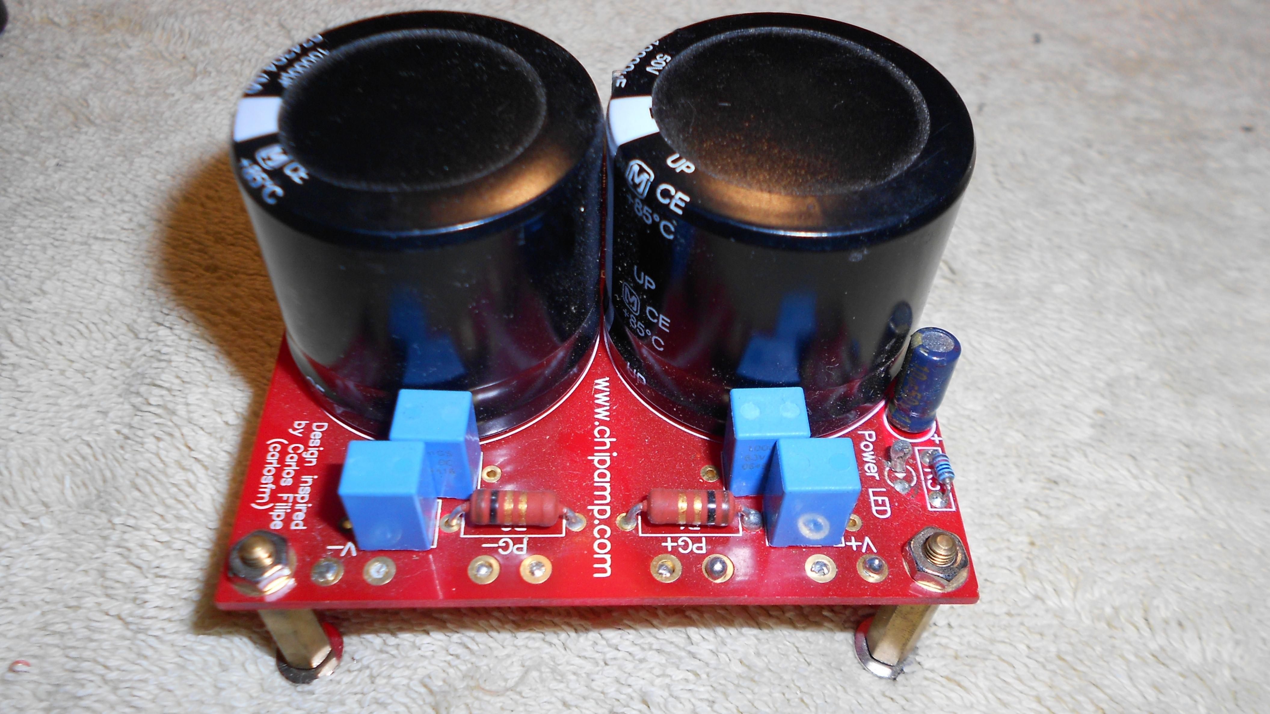

I have a couple of these boards unpopulated. The so called CF snubber is just a RC network (1R in series of 0.1uF) across each filter cap of each rail. Not sure it is wrong location or not, but definitely not the location that I usually associate to snubber.
NYV, yes, you can use this PSU. Just connect V+ <-> PG+ to the +ve SR, and V- <-> PG- to the -ve SR.

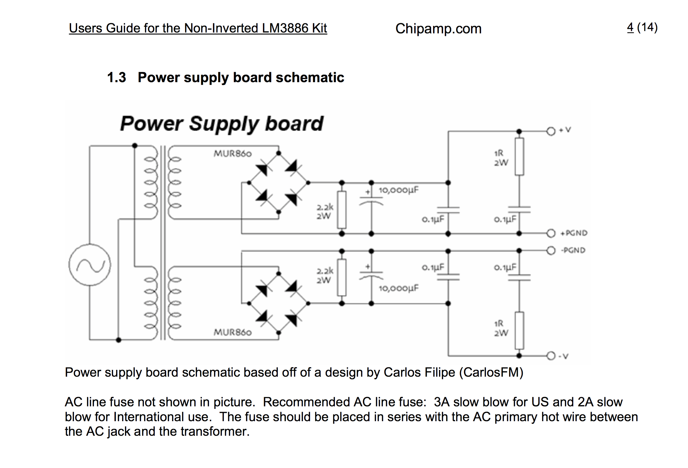

Here is the schematic.Unfortunately the powersupply came as it is - fully assembled but without any information or schematics.

Wrong design??
Is the design wrong for super regulator application?
In fact, the design is wrong also. Link here for more info.

That's the version that has the lower rectifier bridge drawn reversed.Here is the schematic.
It is also included in PA's enhanced schematic.
The snubber is in the wrong place.
It should be before the rectifier.
The 0u1F may cause ringing rather than removing it.
The snubber is in the wrong location.
The ringing when a step change happens is between the inductance of the transformer winding and the rectifier diode when it switches off leaving the diode capacitance to ring in that LC combination. It's that LC ringing that requires damping. That is where the snubber should be.
Thanks for the direction AndrewT, now I am tempted to put my SR project aside and build a Quasimodo. It will also redirect me to pulling out my oscilloscopes and dusting them off. For now, I will have to figure a way of relocating the filter components - there are some excellent diagrams in the Quasimodo thread that illustrates filter locations before rectifiers. I am considering moving the offending parts to the appropriate location to under the pcb.

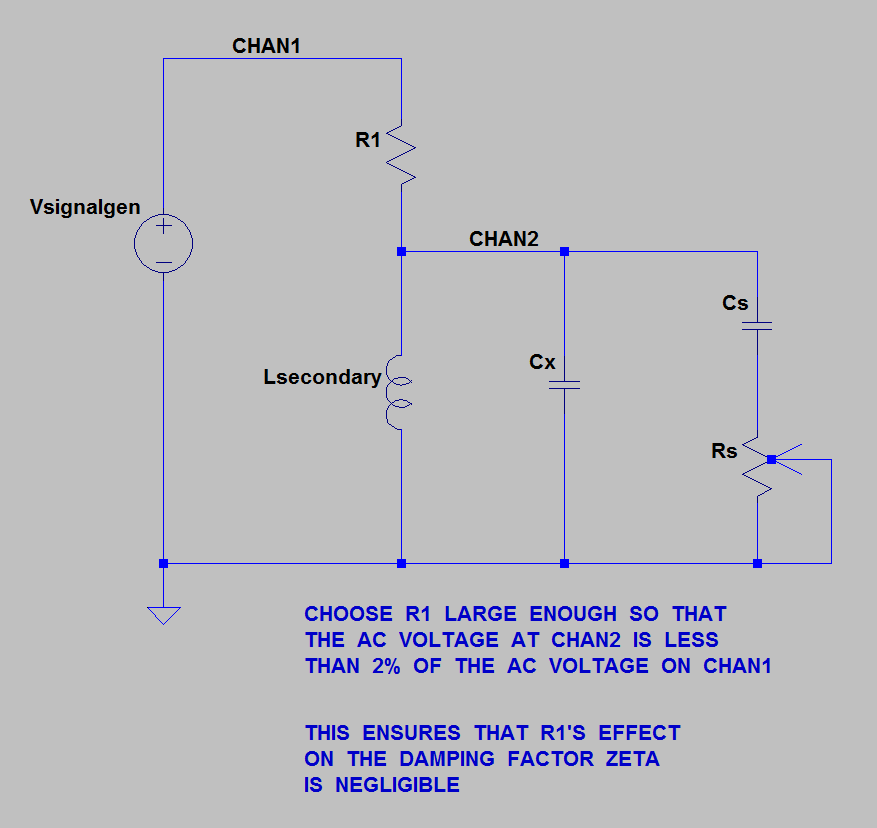

If you've already got a signal generator and two channel oscilloscope, you can use the "ExtraLight" test procedure without building a Quasomodo (or CheapoModo) printed circuit board. It's described in post #561 here. The basic idea is shown in the figure below.
Series resistor R1 works with the square wave generator to inject a current step into the transformer secondary + snubber. This very large dI/dt stimulates the RLC resonant circuit into oscillatory ringing, which you can damp by twirling the knob of 20-turn trimmer potentiometer Rs. The whole arrangement uses test equipment you already have on your bench, today, without requiring you to fab a new PCB or source any new components.

1. Not that I am aware of
2. You need frequency > 150 Hz; Amplitude > 10V into 600 ohm load. Check whether an iPhone can achieve these specs.
3. Start a new thread or piggyback onto an existing thread. Me, I bought a Gratten ATF20B new (Amazon link), and a Wavetek 395 used (documentation). Or you could spend two hours doing the circuit design of a 12V NE555 oscillator with discrete MOSFET output stage (BS250 + 2N7000), slap it together on your solderless breadboard, and implement Quasimodo ExtraLight without buying a signal generator at all. (But if you're going to build an oscillator + output driver on your protoboard you may as well build a full Quasimodo or Cheapomodo).
