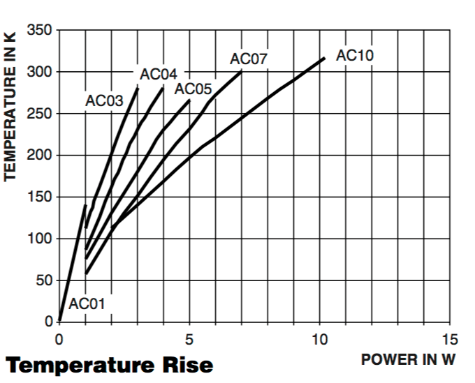

Guys, have you read any datasheets?
Vishay Draloric AC series
http://www.vishay.com/docs/28730/acseries.pdf

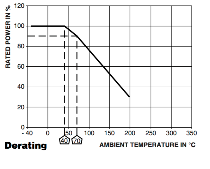

The power in a resistor is rated at an certain ambient temperature and in this case you have a derating curve up to 200 deg C. Notice that the temperature rise can be quite high for the bigger types, up to 300 degrees.

The resistor datasheet has graph that shows that the resistor shouldn't fail until 150 degree. But I am always worried when a resistor gets 90 degree, because it is nearly boiling temperature![]()
I don't know if the Zout gets lower. Maybe it does; maybe not, but at any rate the difference would be minuscule. What is the total current draw?
And why would the boiling point of water be 'special' for a resistor??

In that datasheet, should TEMPERATURE IN K be TEMPERATURE IN Celsius?
My WW resistor is rated 5W so it is simular to that AC05, with 1.5W dissipation having the temperature close to 100 degree Celsius. If that is correct, then the resistor can stand much higher temperature before failing.

About Kelvin vs. Celcius, I think you can figure out this. Ice is freezing at 273 K
That is to say that they have mistaken C to K in that data sheet.
