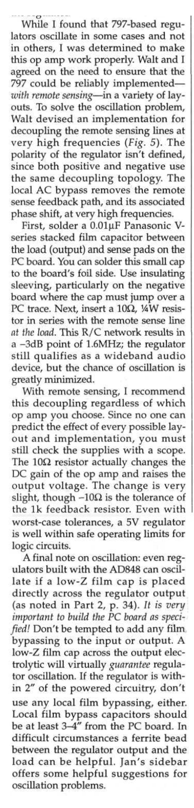

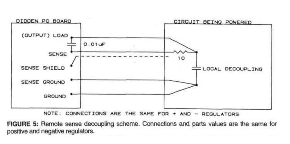

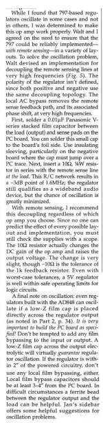

Here is the circuit schematic, and also Gary Galo's verbatim explanation, from his article (super regs part 4). Click on the "expand me to full size" white X at bottom left of the images.

Thanks, Mr. Didden, for the explanation.
My circuit is within two inches of the outputs so I think I have no concerns about this.

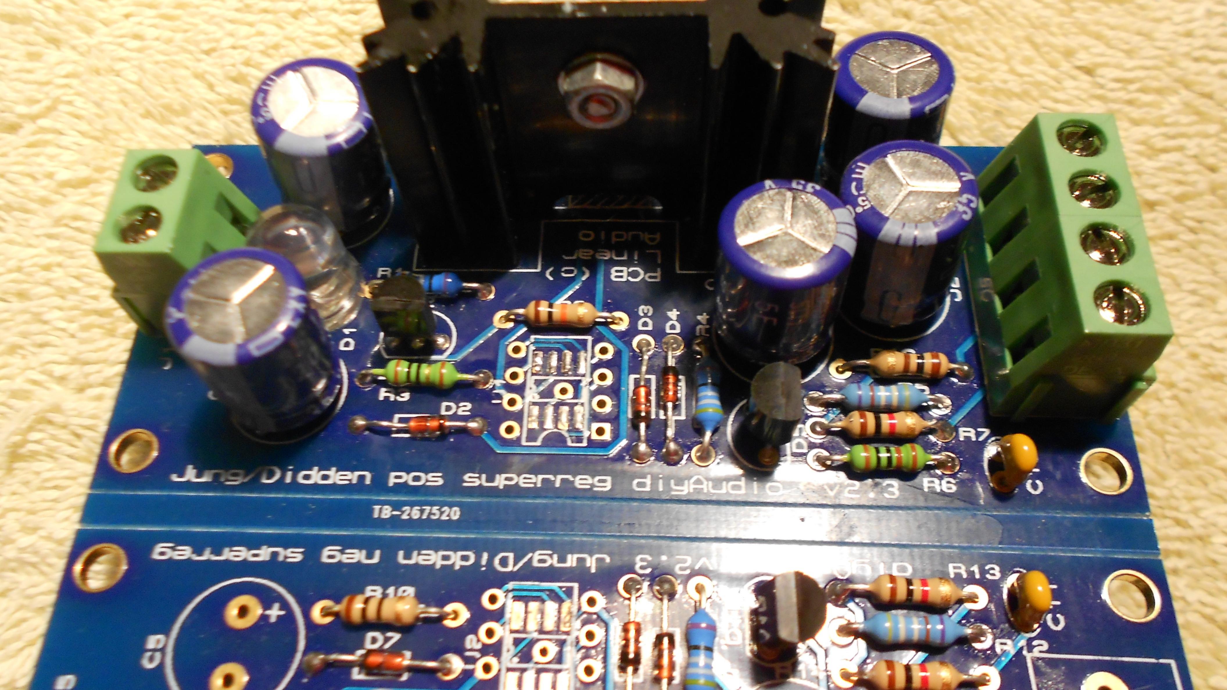

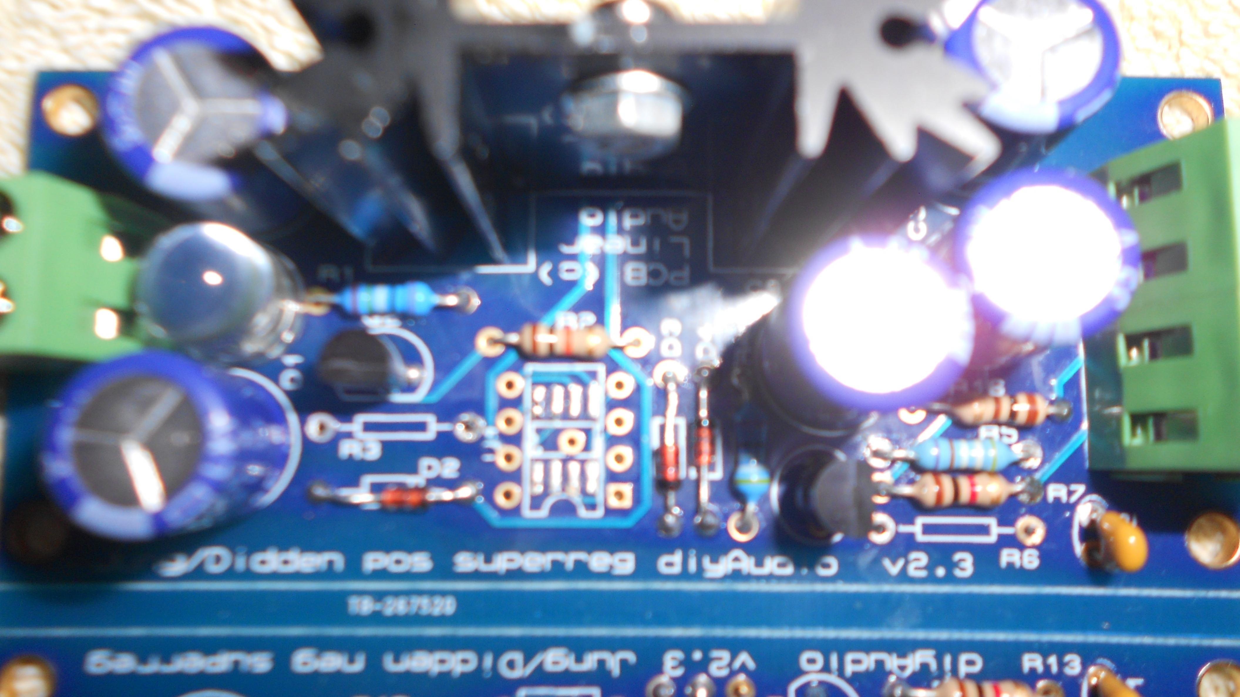

you should use metal film 1% resistors for R6, R7 , not 5% carbon films . this isn't what's wrong with your regulator , but these set the output voltage and Walt was specific about them being good quality and oversized (1/2Watt) if possible
MMM! Thanks for picking that up ticknpop. I followed the BOM that was provided on the site when I ordered the pcbs. I foresee problems with trying to push a 1/2watt resistor through the via that has already been soldered 🙁???
I do recall reading that comment while researching the super regulators.

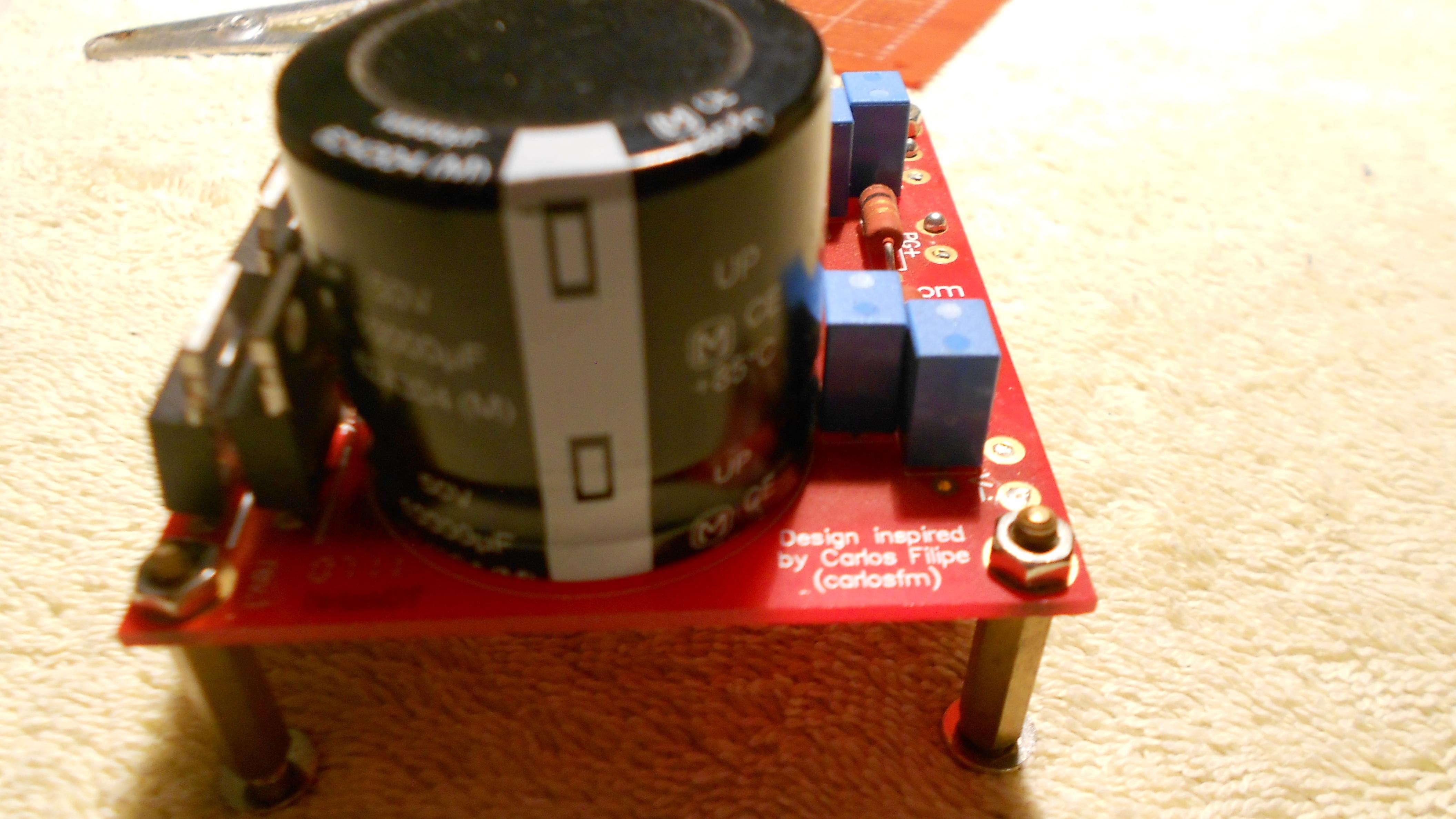

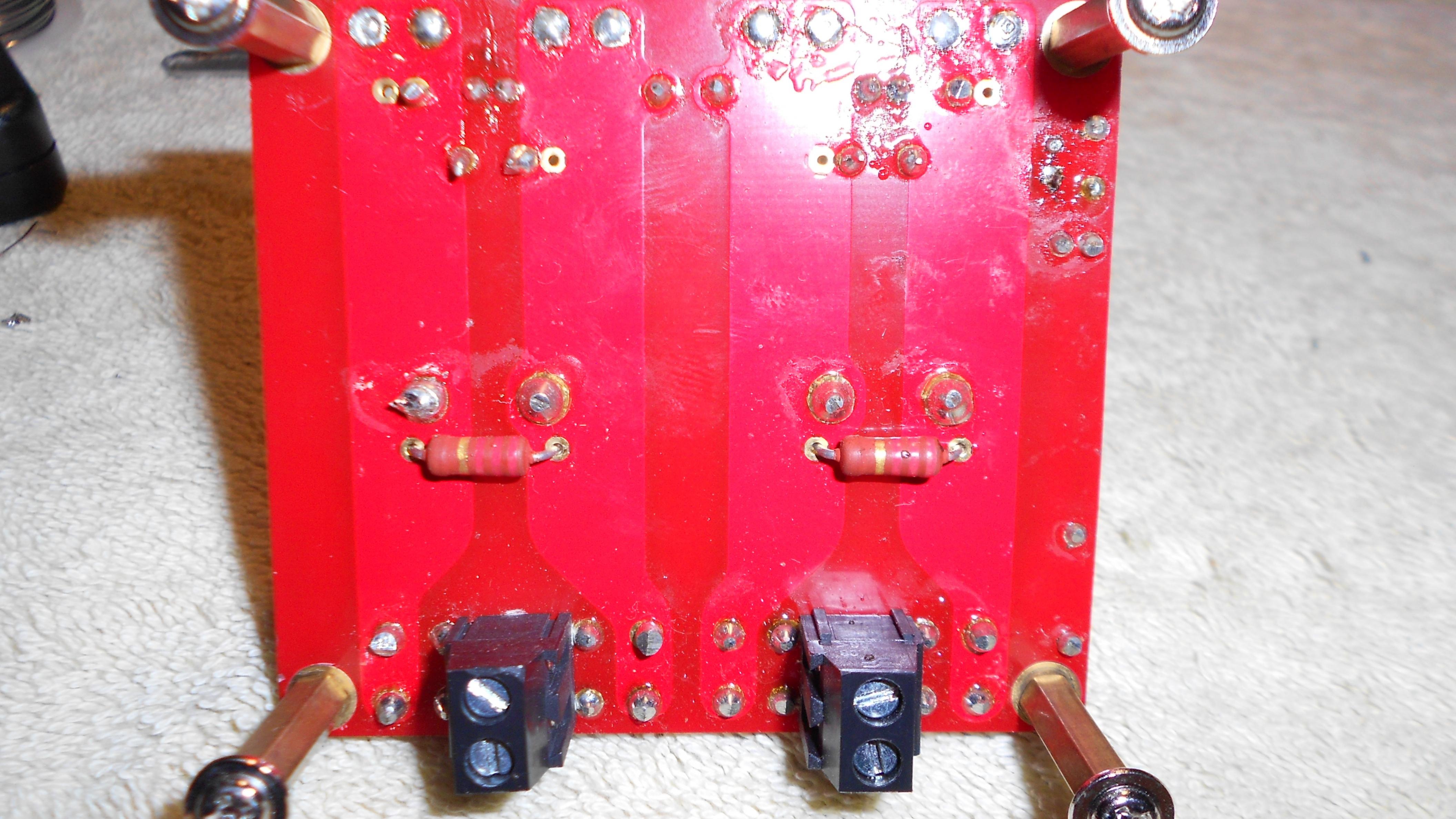

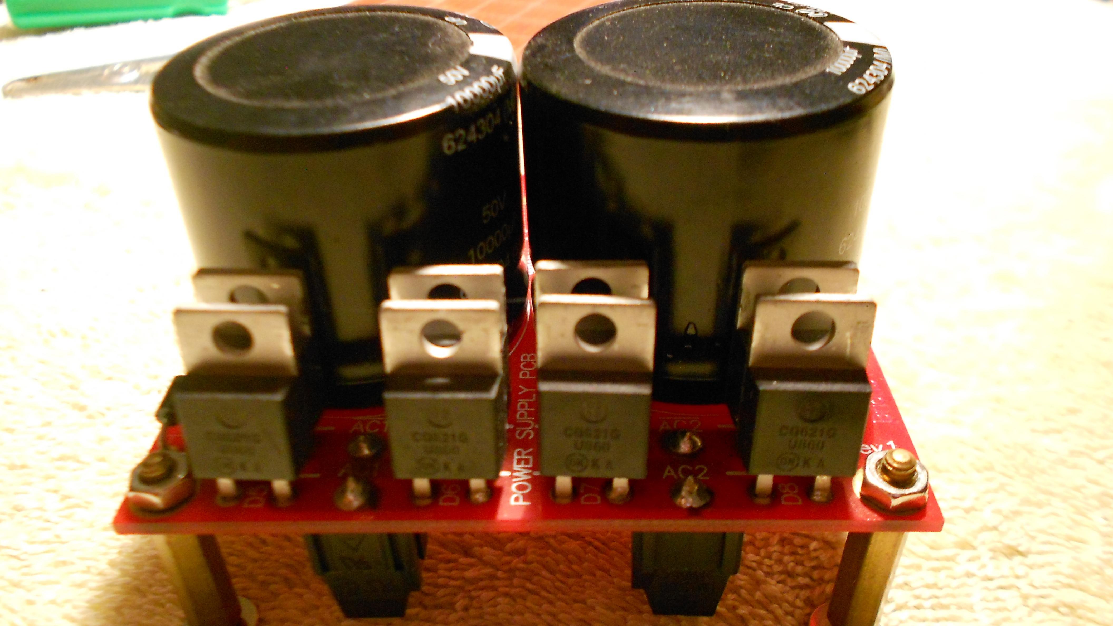

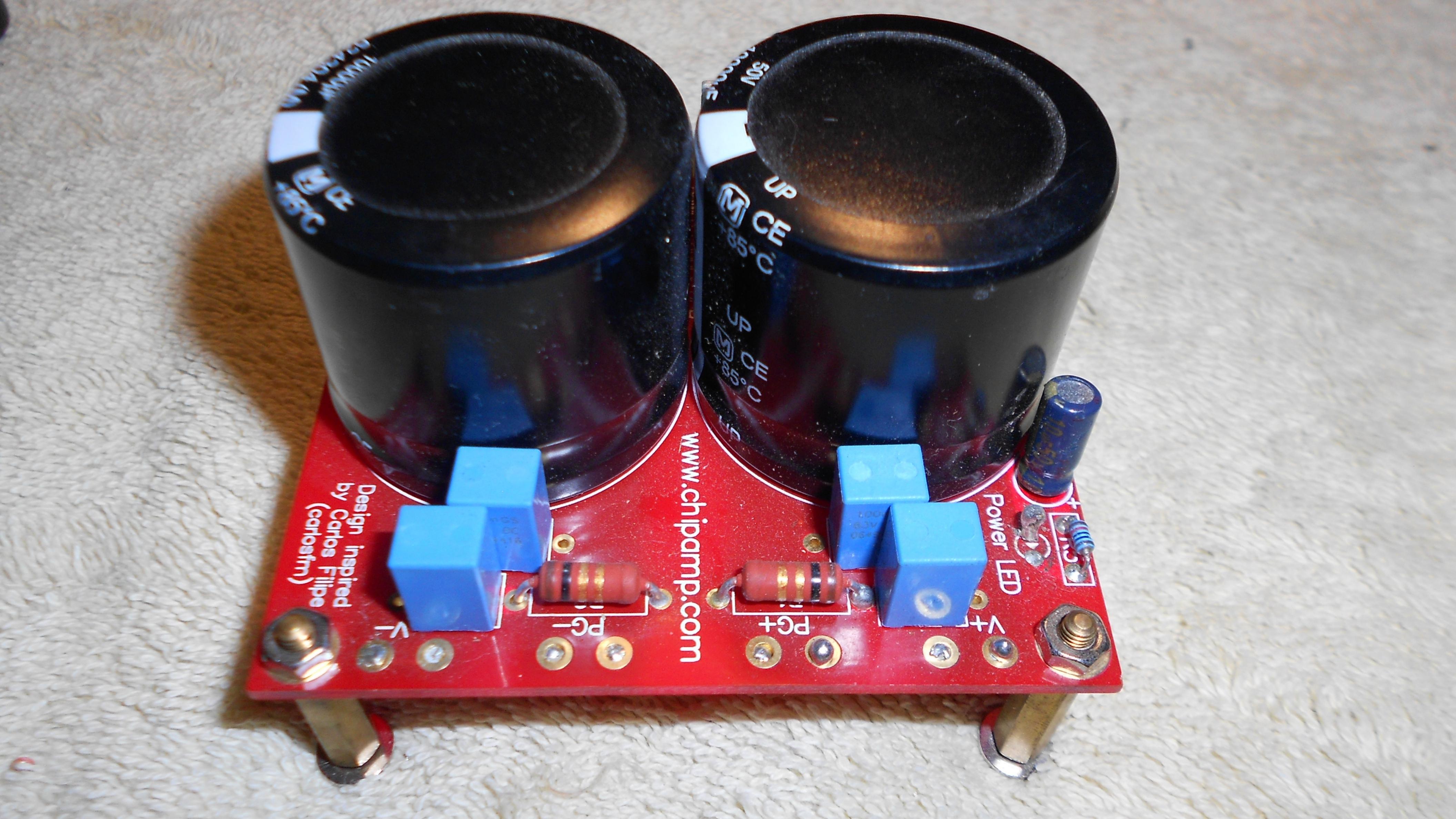

I found this while scratching through my spare parts bin looking for metal film resistors for the super regulators. I bought it about fiver years ago from a seller on diyaudio. Would this be suitable to power the super regs? Or would it need some modification?
It is from Chip Amp and has Carlos Felipe name.

I have a couple of these boards unpopulated. The so called CF snubber is just a RC network (1R in series of 0.1uF) across each filter cap of each rail. Not sure it is wrong location or not, but definitely not the location that I usually associate to snubber.
NYV, yes, you can use this PSU. Just connect V+ <-> PG+ to the +ve SR, and V- <-> PG- to the -ve SR.
