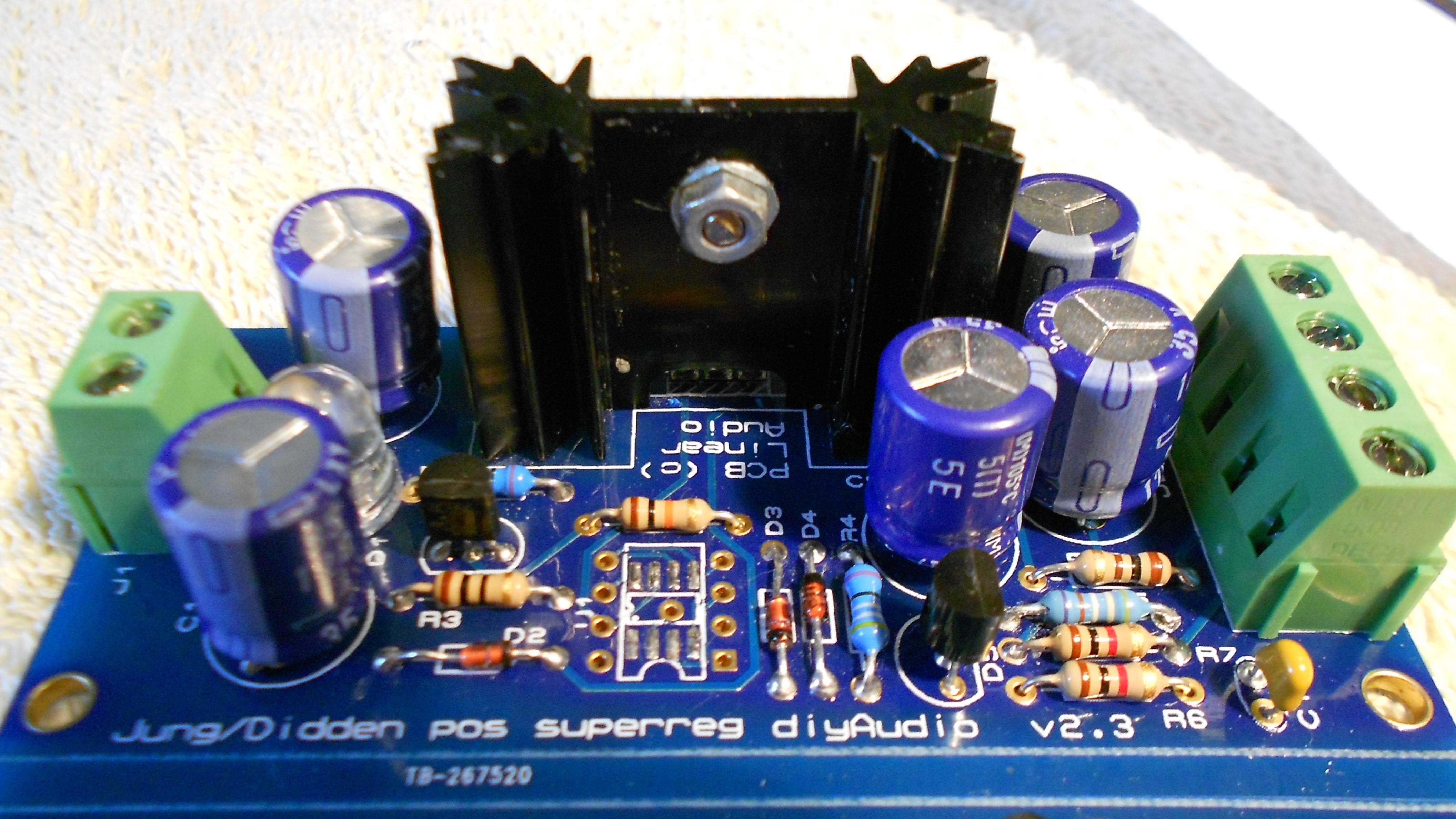

Testing my super regulator
Pics of the positive regulator minus the opamp.

Without the opamp loaded, pin 3 of the opamp should measure about 6.9volts assuming:
- you have used the LM329 reference
- you have shorted the +ve output to the +ve sense input on J2
- the +ve return is shorted to the +ve return sense on J2
J2 has 4 connections, pin 1 at one end, pin 4 at the other. Short pins 1 and 2. Short pins 3 and 4. ie in this instance it does not matter which end you call pin 1
Also check the output voltage.
Because the opamp is not loaded the output is unregulated and will be higher than the regulated voltage.

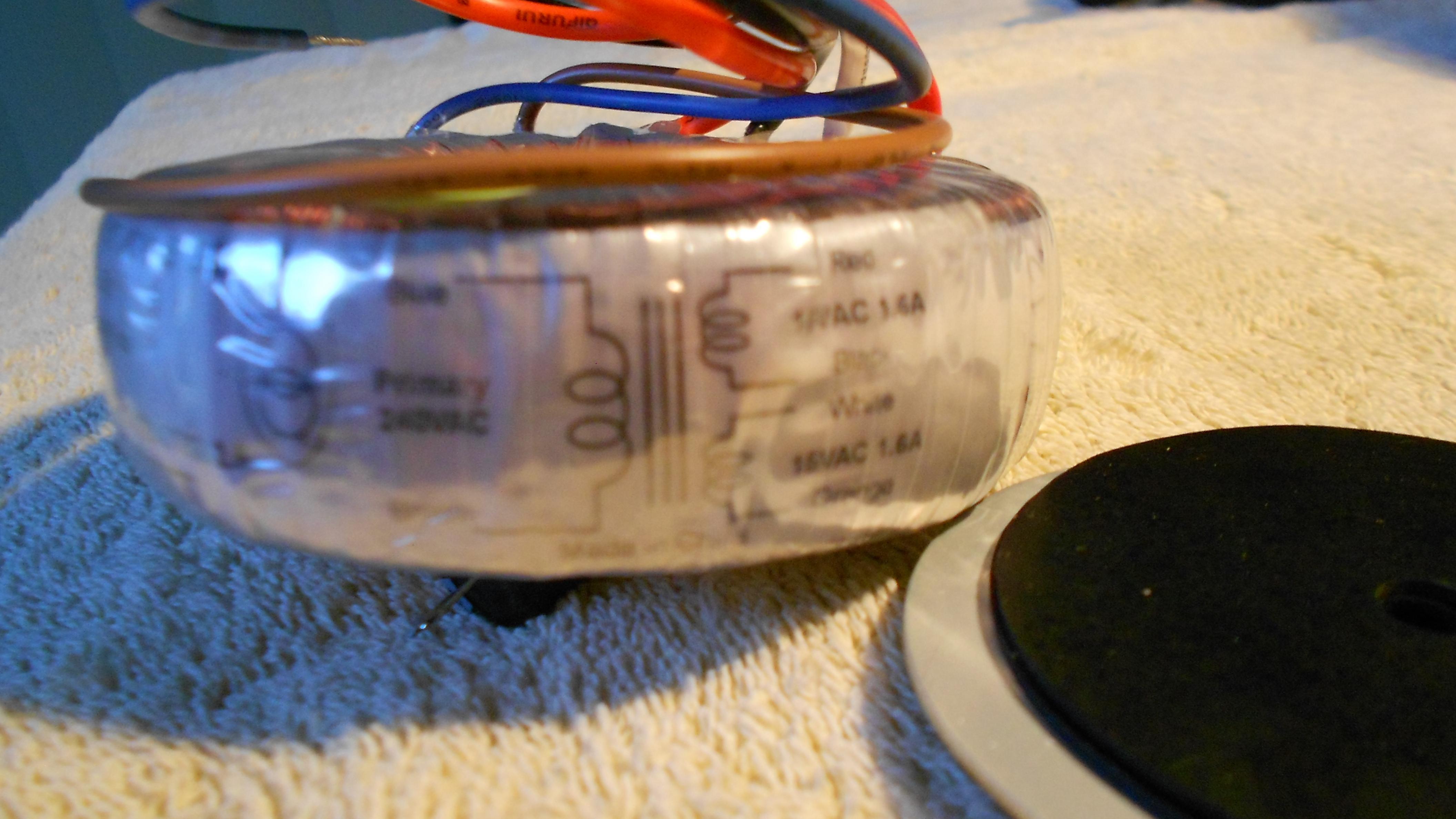

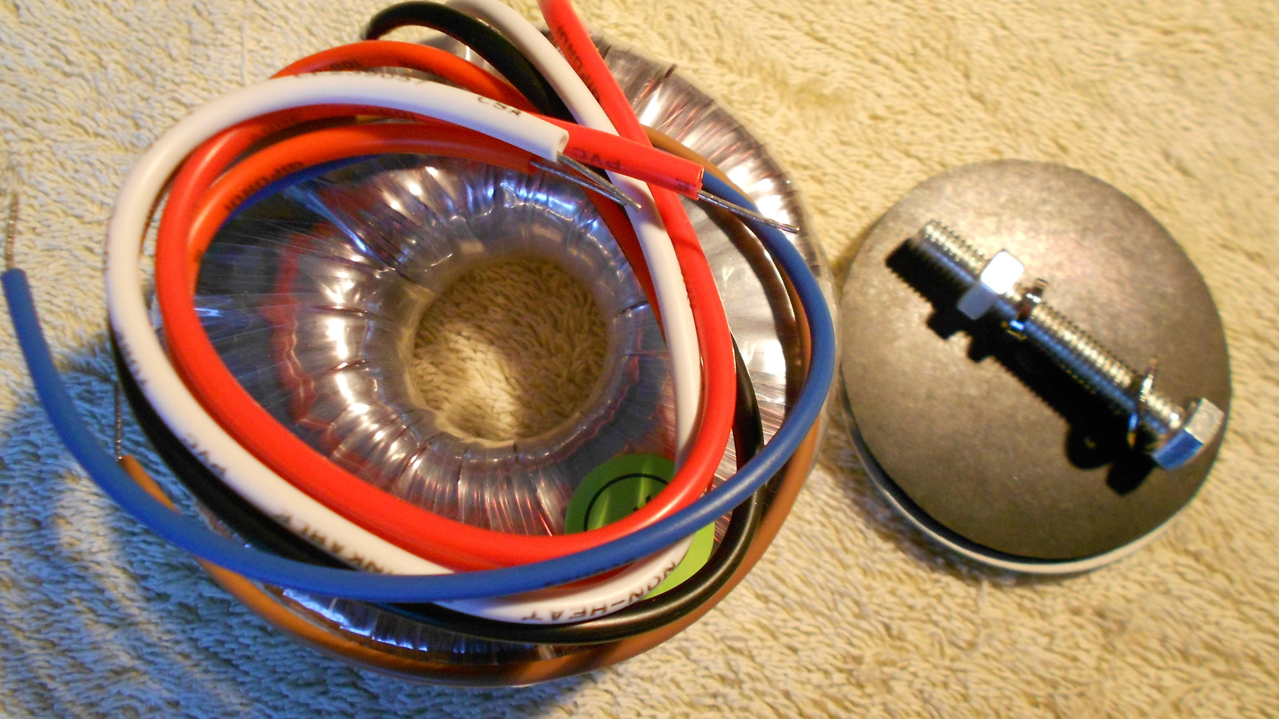

I plan to instal the regs in a marantz cd63 or cd67.
Would an 18v 'wallwart' power supply be suitable option for testing?
I also have a 0.75va 2x15v encapsulated transformer that I could use to build a quick and simple power supply for this purpose.

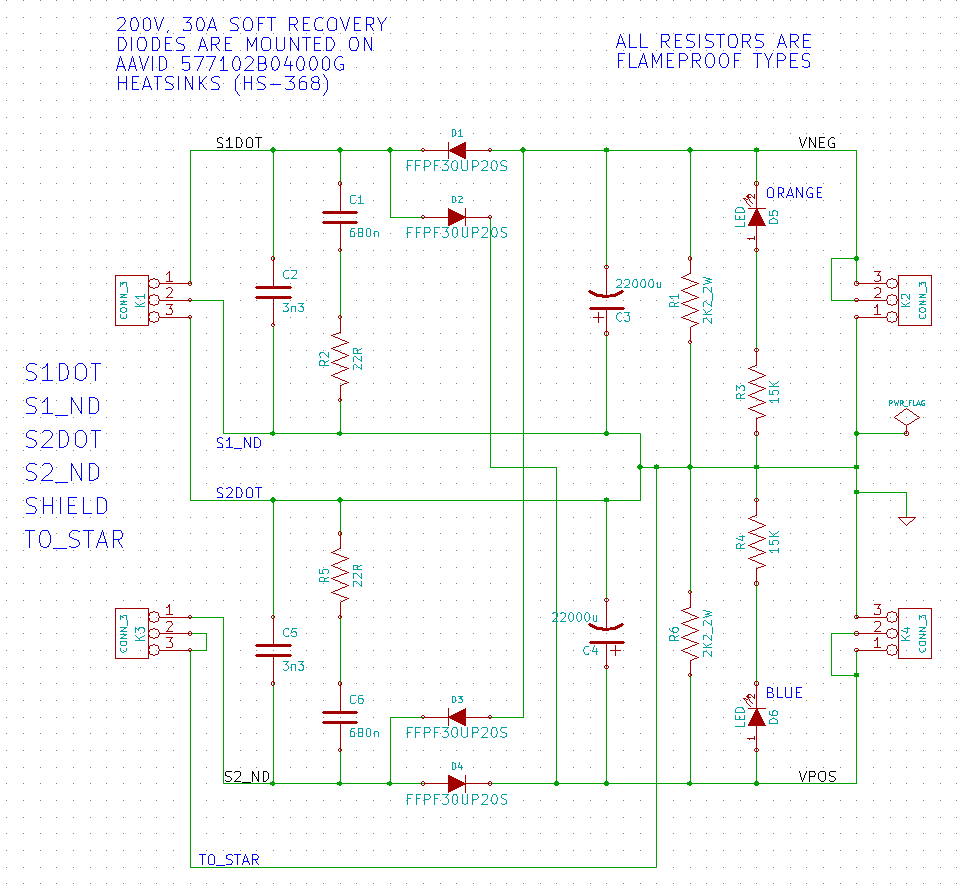

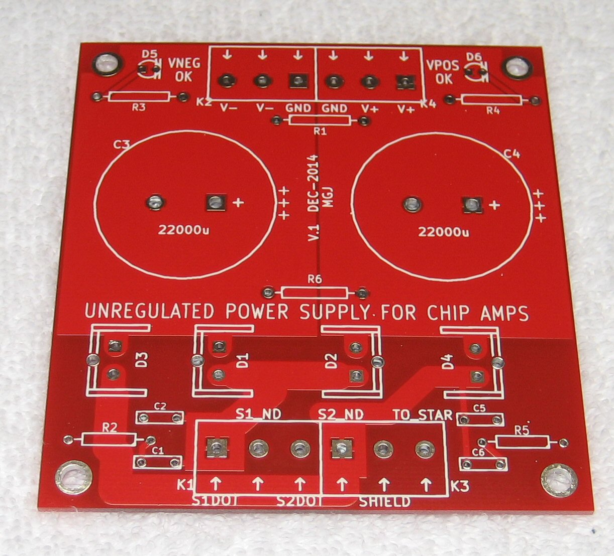

"a simple power supply for the super regs" sounds like you mean rectifiers, filter capacitors, and possibly other components, that produce filtered, but not regulated, "raw DC" as input to the super regulators.
A fairly standard design, with typical components and typical circuit topology, is attached. "S1Dot" is the phase-dot end of secondary#1 , while "S1_ND" is the no-phase-dot end of secondary#1. Secondary#2 wires are named "S2Dot" and "S2_ND". "Shield" is the transformer's electrostatic shield (purple wire on an Antek AS toroid), if present. "To_Star" is the star ground. As shown, the supply produces +28V @ 4 amps and -28V @ 4 amps. With a 500mA Jung/Didden super reg, you would draw less than 4 amps, so maybe you might modify the circuit to use smaller capacitors and scrawnier diodes.
If you decide to keep the transformer snubbers (C1, C2, R2, etc) you will need to tune them for the particular transformer you are using. Search the forum for "snubber" and/or "Quasimodo" to learn more.
