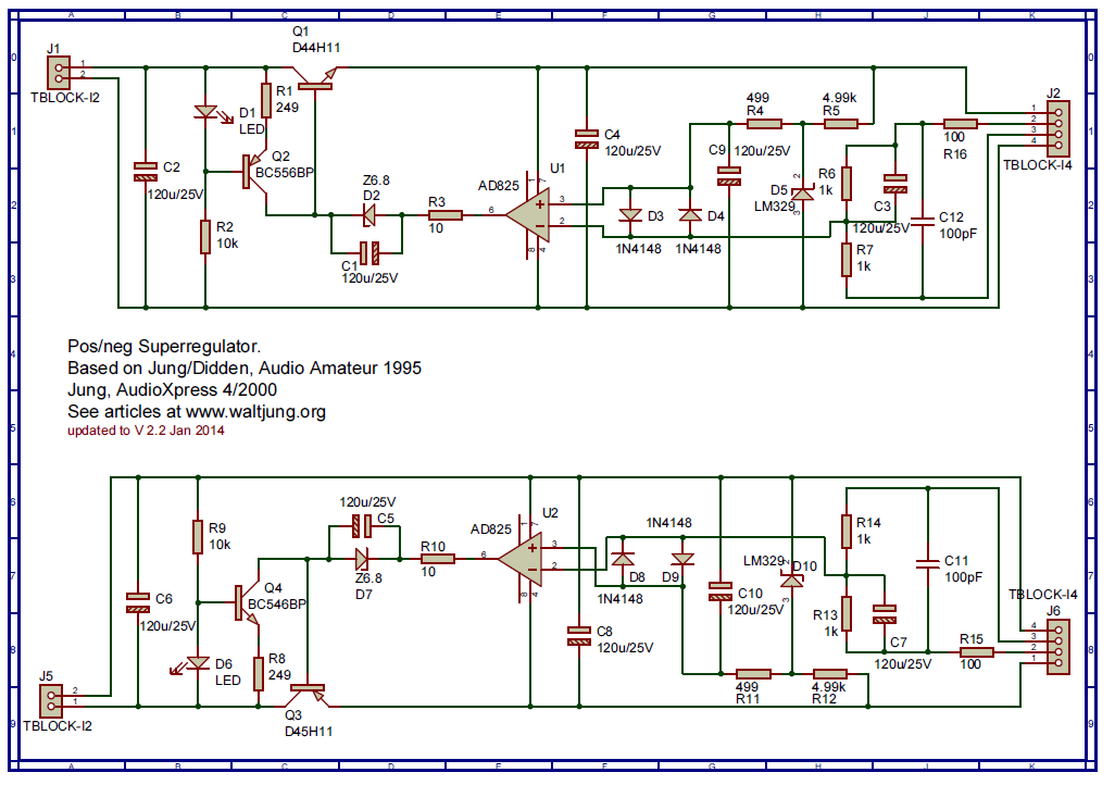

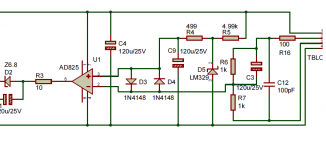

PS: you know, it would be helpful to those trying help you out to see your actual schematic. You mention the RC net used for remote sensing, but it isn't shown anywhere.
Here is the schematic Jidden posted and a PCB available in the diyAudio store.
I followed this schematic but do not have the 100pF 100R on board. I later tried to have them at the load without success.

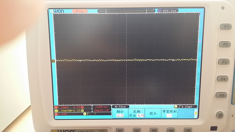

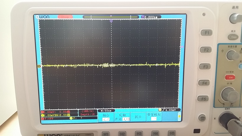

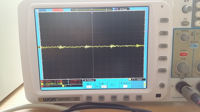

O.K. I took out the 0.1uF + R on the rails. Also took out 1 pair of electrolytic capacitor. Leaving 47uF at the output of the JSR, and 2 x 22uF at the load. These 3 capacitors are classified as low impedance capacitors. I also wired the sensing wires within the JSR board, i.e. no remote sensing now.
It seems the oscillations have reduced. There may still be mild oscillations but they can also be measurement artefacts, I am not sure.
My scope has a limit of 2mV per grid when I use probe setting at X1 but it imposes a 20MHz limit on bandwidth. This is the setting I used.
If I chose probe setting at X10 then it would be 10mV per grid and 150MHz bandwidth. This is the setting I didn't use.
I will post the scope pictures below.

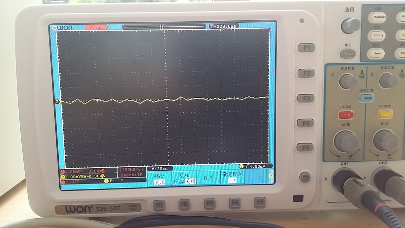

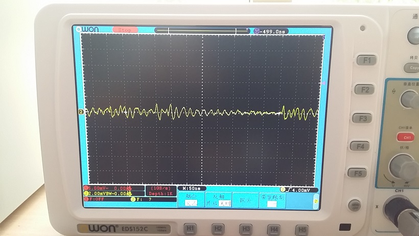

The first picture shows some mild resonances with peak to peak waves no more than 1mV.
The second picture is the zone-in of the first picture. Note M:20ns so the resonance seems to be around 60MHz.
But then if my scope was limited to 20MHz I am not sure if these make sense or not.
Although my scope was theoretically capable of 150MHz and the probe it comes with could measure that high frequency, I have not used the little coil supplied with it but only the ordinary probe and earth lead. So I am not sure if its RF reading is still reliable or not.

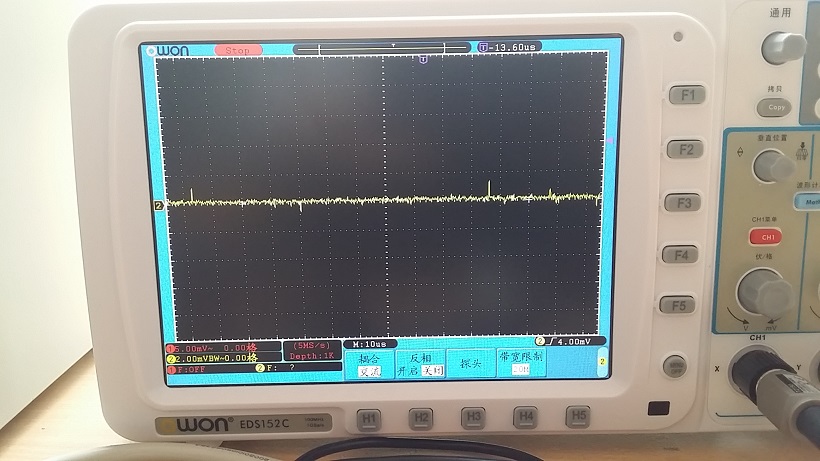

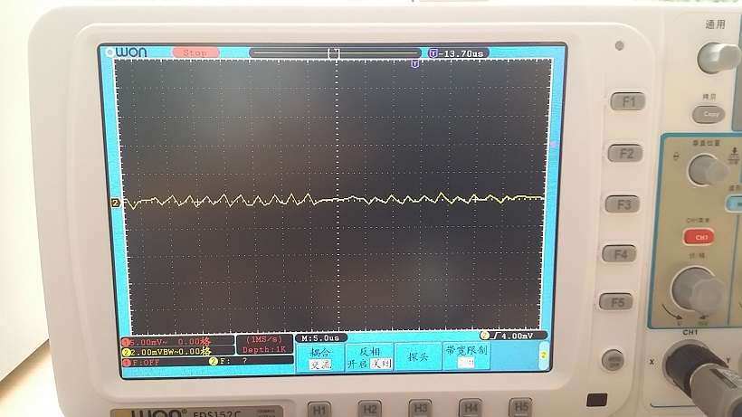

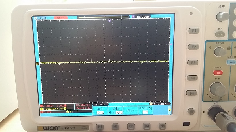

When I set it to 50ns, I see some low level noise. Most of the time it looks like the first photo. Sometimes, I can fetch something like the second photo.
Should I discard these because the scope was limited to 20MHz? or Are they resonances I must get rid of?

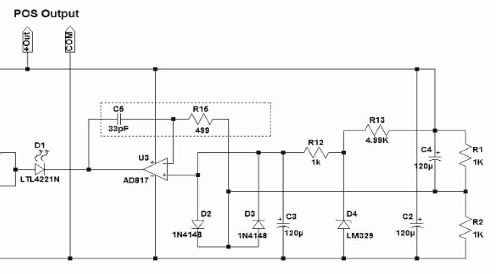

It definitely works with resistive load and there is no resonance. But it can resonate with inappropriate load, such as a load with high Q capacitors.
Does the resonance happen in the error amplifier or the pass transistor?
If it happens in the error amplifier, then I guess the latest circuit from Jung's shunt regulator may reduce the chance of resonance.
Can it be a direct replacement?
The resonance is 'in the loop' not in a specific part. It is the loop transfer function which is determined by the whole circuit that determines stability.

How to do remote sensing correctly, etc.
Remote sensing: This article covers the use of remote sensing, in Fig. 5. It uses an 10 ohm / 0.01uF RC combination, with the R going off the regulator card proper to the remote sense point at the load, and the 0.01uF cap connected between the top of the sense network / 10 ohm R and the Vout terminal of the regulator. This scheme effectively removes the loading wiring etc. from the feedback path at high frequencies, and this improves overall stability. Note that this scheme is at odds with the schematic as shown in post #832. I do not think the setup in #832 is correct, and I wouldn't recommend use of it.

Wrapping up: I agree with Jan's general assessment that HiFiNut's regulator is now likely operating up to snuff, sans the high-Q caps. There does not appear to be any dominant repetitious frequency at Vout, as would be present with a continuous regulator oscillation. But then, one can hardly troubleshoot multiple scope traces from the other side of the world, from an unsure context, at a Gatling gun rep rate. 🙂
