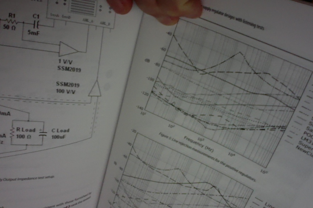

Besides in Walt Jung's/Jan Didden's articles you can find recent measurements made by jackinnj in the Bookzine Linear Audio vol. 4.
http://linearaudio.net/volumes/785

It is also worth noticing that the jackinnj tests show very clearly how important the opamp is besides the pcb layout. The AD825 is lower open-loop gain than the AD797 which gives less feedback in lower frequencies. The AD825 has also a bit high noise.

Got similar results in my attempts to simulate a variant of the circuit.
