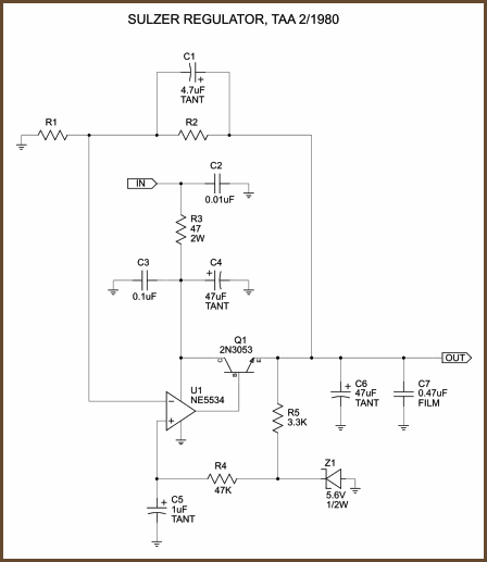

Hi Jack, I bought a lot of pin compatible single-opamps and tested each of them in my not-exactly-Jung regulator design. For some stupid reason I stopped at the AD817, instead of continuing all the way (for only USD 20 more) to the AD797. Here's the link.
You'll see that, unlike the Jung design, I powered the opamp from the input instead of the output. I also made the "Sulzer" design decision to bias the VREF generator from a regulated version of the input not the output. And finally I used a high transconductance MOSFET as the series pass element, instead of a 35 year old BJT. But hey that's just me.
Sulzer VREF diode is powered from the output side of regulator.

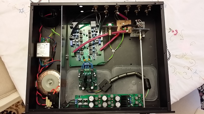

The first picture below shows the JSR powering an active crossover board with 6 opamps (OPA627, OPA2134) per channel on a 4 layer PCB.

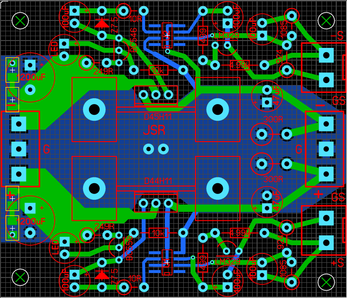

The second picture shows the JSR PCB I came up. I could not use Jidden's PCB because I wanted the +rail on the bottom and -rail on top to follow the same pattern of my other PCBs.
I lately found the sound of my system downgraded obviously. I then used my scope for trouble shooting and found the problem of the JSR negative rail mildly ringing. I see ripples of up to 2mV ptp at 660kHz.
When I disconnected the active crossover board and used the onboard dummy load of 300R on 16.5V rail with 55mA current, the ripples were gone.
I then reconnected the load and soldered the 100R and 100pF at the sensing point. This did not change the ringing behaviour.

I suspect there are some minor issues with the layout, but more importantly, what error amplifier are you using?

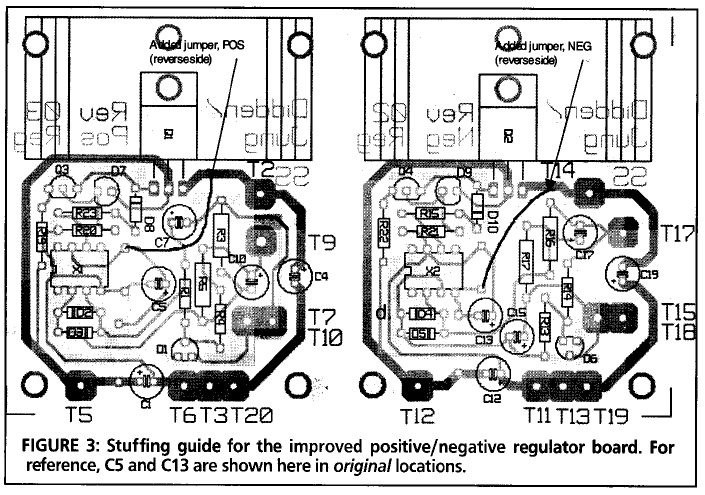

Your layout is not exactly "tight", for reference, here are images of the original boards from Old Colony (which was an Audio Amateur board house):

I will check Jidden's old board to see how I can tighten up my PCB tracks. I thought mine were pretty tight.

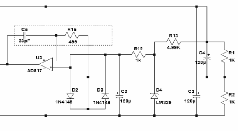

Refer to the portion of the schematic below. This is what Mr. Jung published not that long ago in his "A Universal Shunt Regulator for Audio Applications".
This portion of the schematic is almost identical to the JSR's. The added 33pF provides compensation and should provide stability.
I guess if I implement this in the JSR then I may be able to get rid of the ringing.
What do you think?

I still don't understand what was happening with the ringing.
Given that the resonant frequency is around 660kHz, it is unlikely to be due to parasitic of the electrolytic capacitors or even track inductance, as their resonance frequencies should be much higher. 660kHz seems to be too low. The JSR works with resistive load, but only rings with the actual load. As you can see from the first picture I posted, there should not be large inductance to cause ringing at 660kHz.
When I did my PCB I did make reference to Jidden's design. I was trying to make tracks shorter, not longer, to the best I could, to reduce inductance.
Of course, there may always be areas I overlooked. Please point out my errors if you find any.

By the way, the sensing circuit in your latest shunt regulator is slightly different from the original SuperReg in that it has a 33pF capacitor between the opamp output and the opamp negative input. Would this give better stability? Can I use it in your SuperReg?
